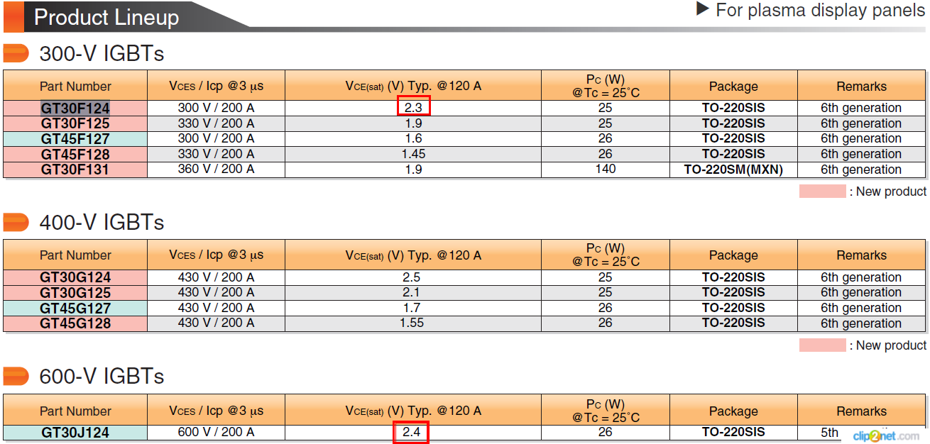

    Hi guys,
    A few days ago i asked a real hard question regarding plasma tv's but nobody could respond. I need to ask if anyone has replaced this IGBT with another type that actually worked.
    The industry is awash with fake chinese knock offs.
    I am so frustrated.
    Kind Regards
    A Anagnostou

    GT30F124 these transistors are now impossible to find original, they sell fakes everywhere, you need to look on donor boards, they are definitely original.

      Thank you Lotas for your response. Now i know why technicians are reluctant to repair plasma's. They are a real pain in the ass.
      I ordered some other GT30F124 from one of our more reputable suppliers. Maybe it is old stock and original.
      Tell me, the original GT30F124 does it come with bent legs or are they straight?

        Originally posted by angelos
        T
        Bent.
