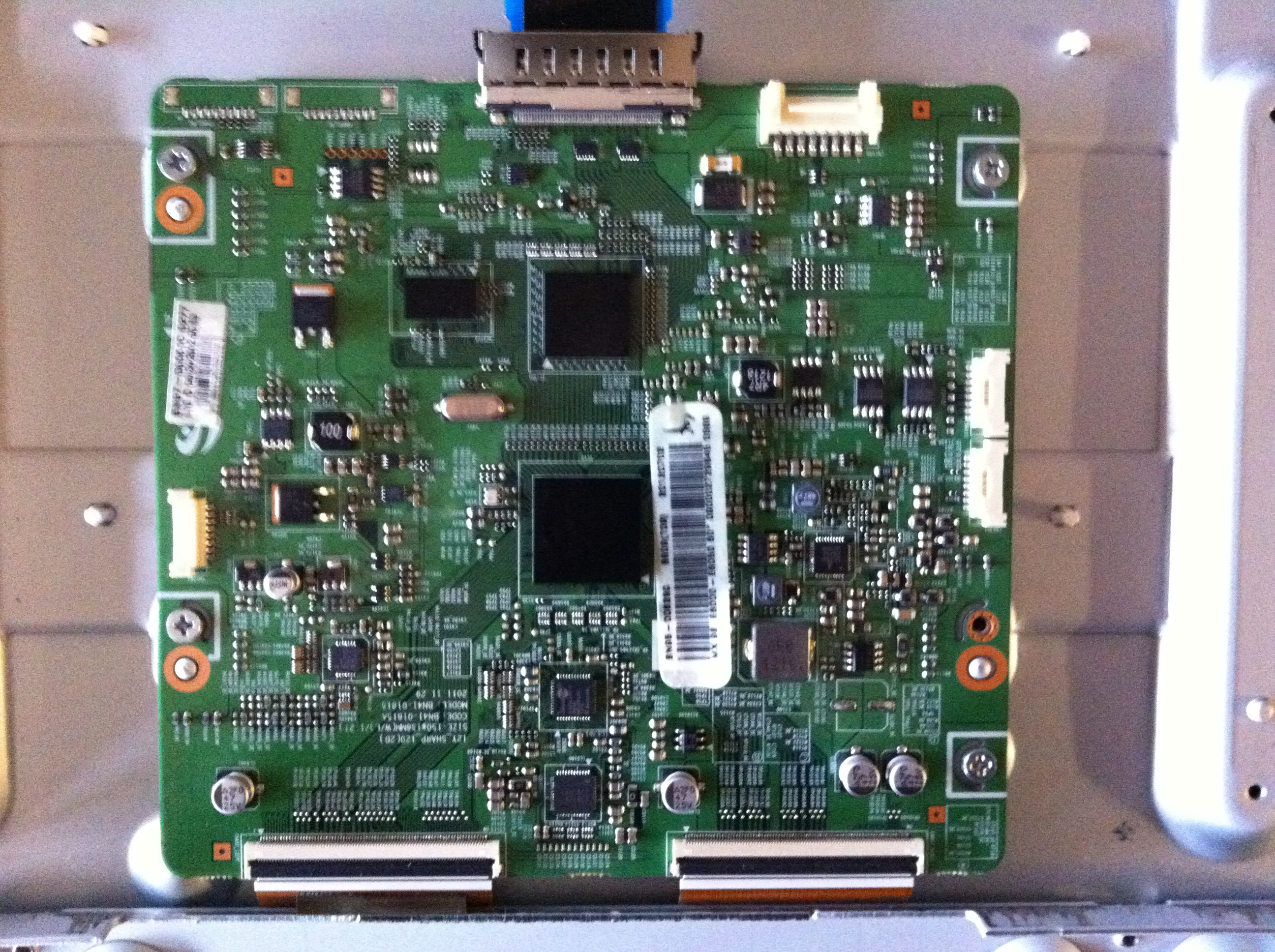

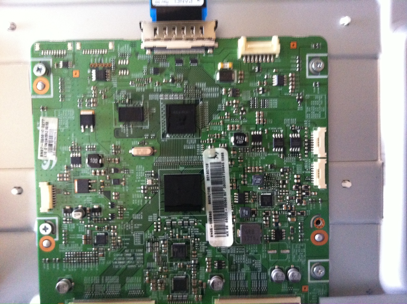

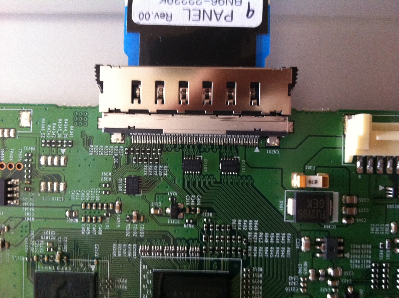

          Opened the back and checked for bulging caps, loose connections etc. All seems good. Kinda felt like the Tcon top connection was lose, but reconnecting it did nothing. You can see it in the "Tcon close" image.
          When you guys say "clean the connections" what do you recommend? Canned Air? Some type of wipe? I do have a fireplace in the same room so figured I would try that too.

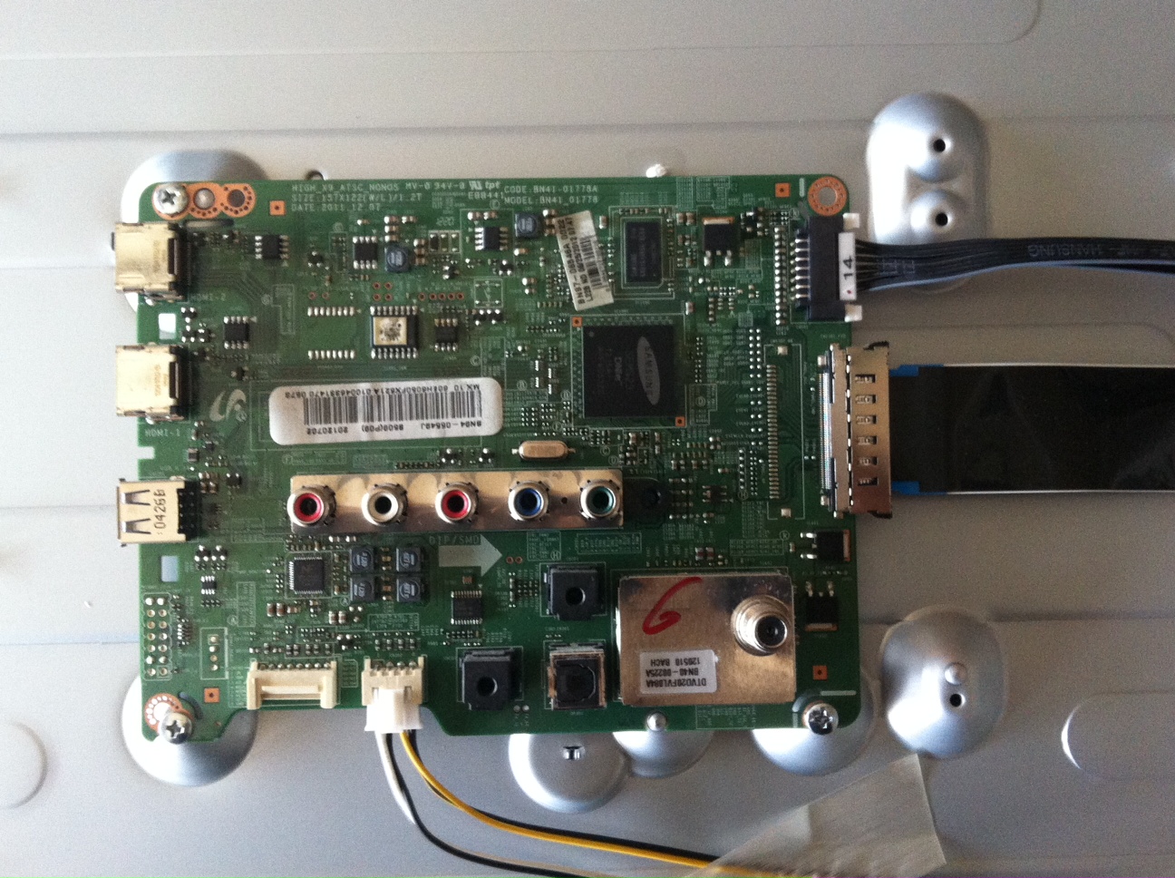

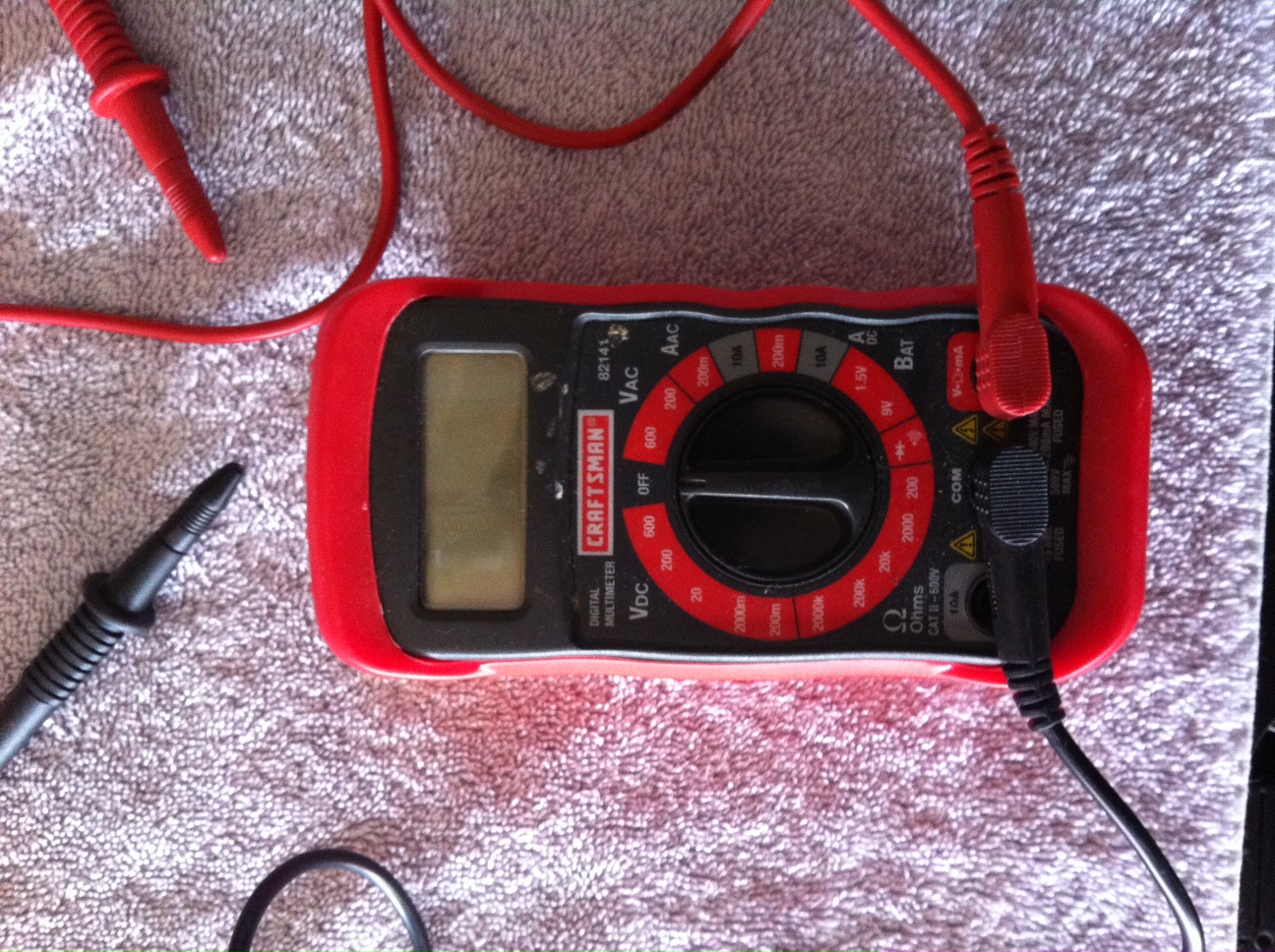

          Posting the pictures now that I think I'll go forward with checking it myself. Also threw in my cheap multimeter so you know what I'm working with here. Definitely a rookie.
          Thanks for any advice or best guess if you think it could be the panel.
            Re: Samsung UN60EH6050F Sound-no picture
            OK, just be sure, you can see the screen glow when look at the back of the panel or ont he front, just no pictures on the screen, if that is the case, you then need to check the DC voltage on both ends of the SMD fuse on the T-CON board. It is the board under the metal shield that you can see one black flat cable connected to and two brown flat cables connected to the opposite side of the board.

                "Is the fuse labeled FJ01, rectangular, and just below the main connection to the right?" I see F301 white rectangular fuse to the right of the connector.
                You can check with Ohm meter first, TV not plugged in.

                    TV turned on, black probe on the chassis, red probe on the ends of the fuse. It should be either 5VDC or 12VDC depends on panel design.
                    • Chris24
                      • Feb 2014
                      • 42
                      Thanks again bud, sorry for delay.
                      On SMD fuse I got 12VDC on both ends, and 0 for ohm test and a beep for continuity.

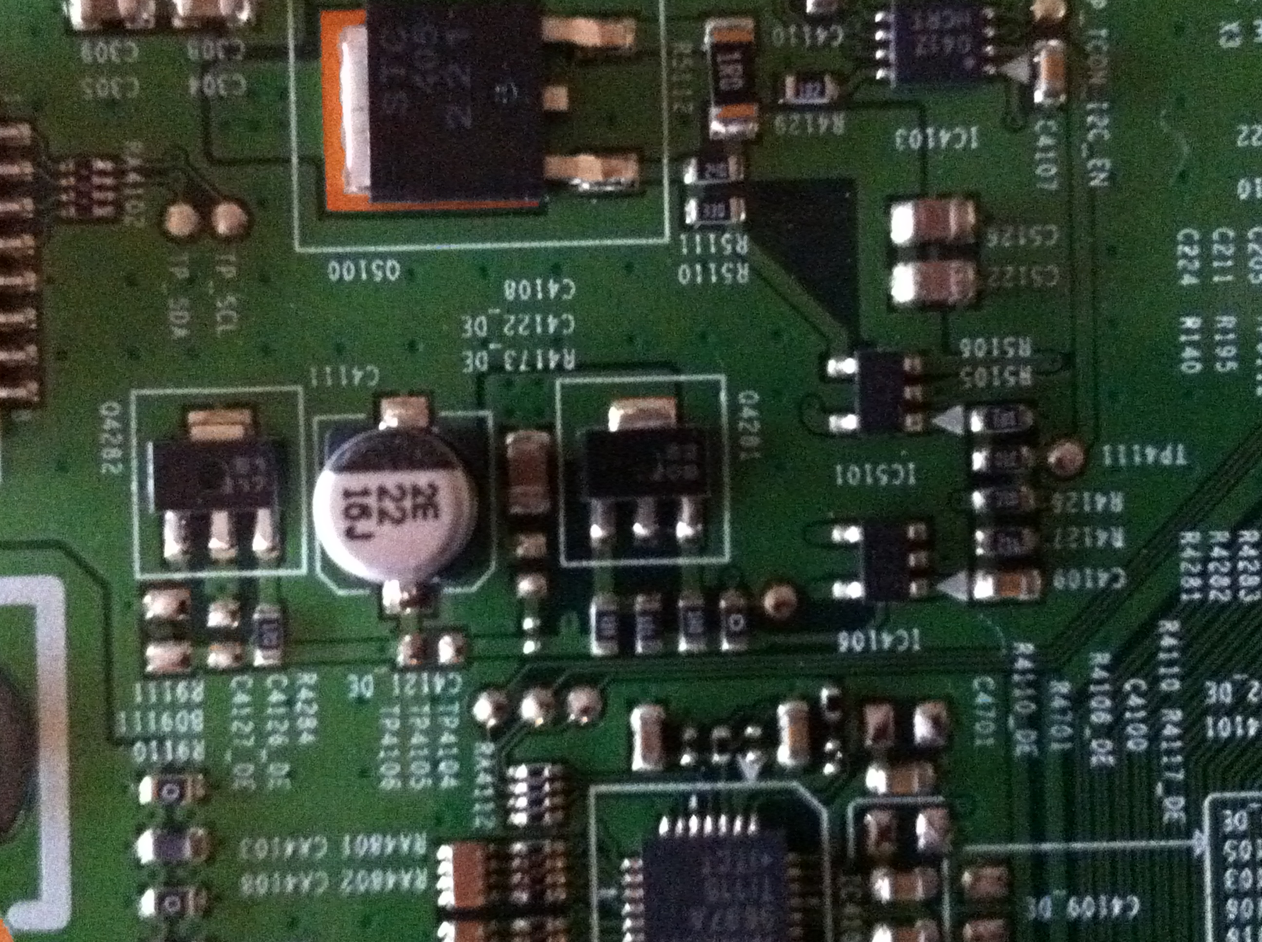

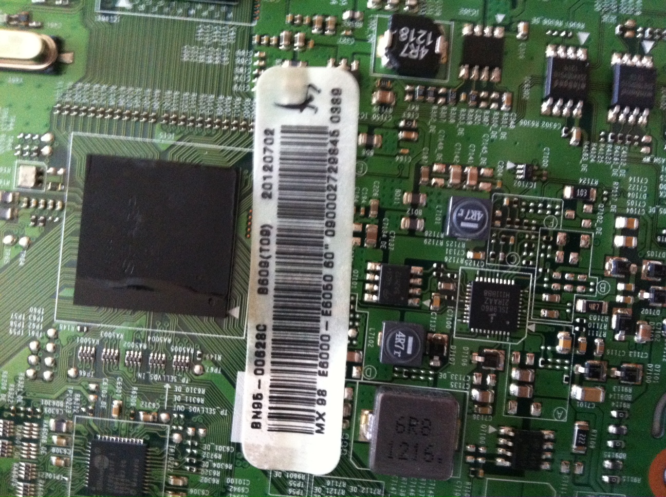

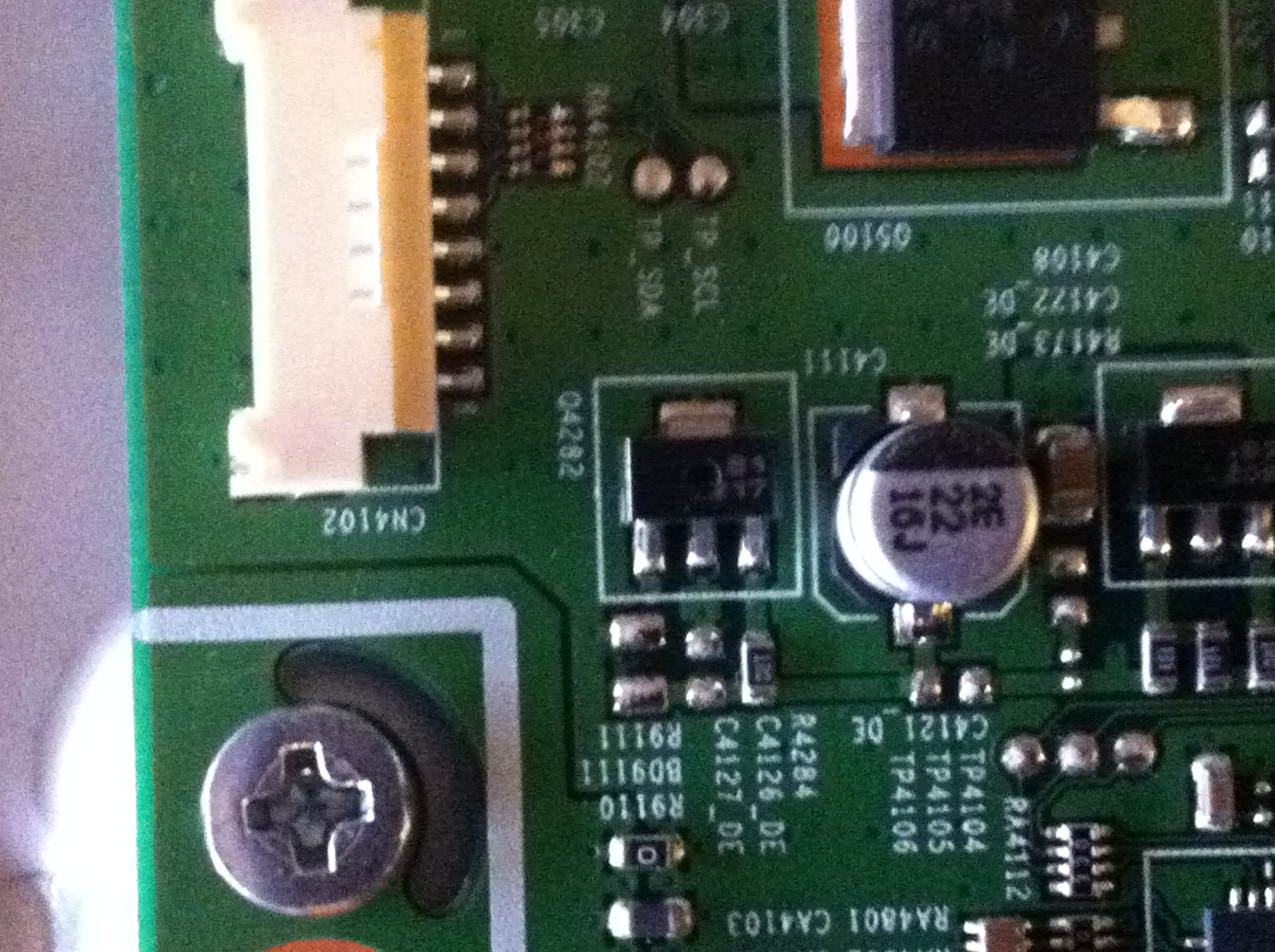

                          OK, so the T-con is getting the power to it. On the T-CON board I can see about 4 3-pin devices (2 small, 2 large one) which are voltage regulators I believe. You need to take the reading and the P/N on each one of those devices.
                          Report the reading according to the thread here:
                          https://www.badcaps.net/forum/showth...999#post300999
                          • Chris24
                            • Feb 2014
                            • 42

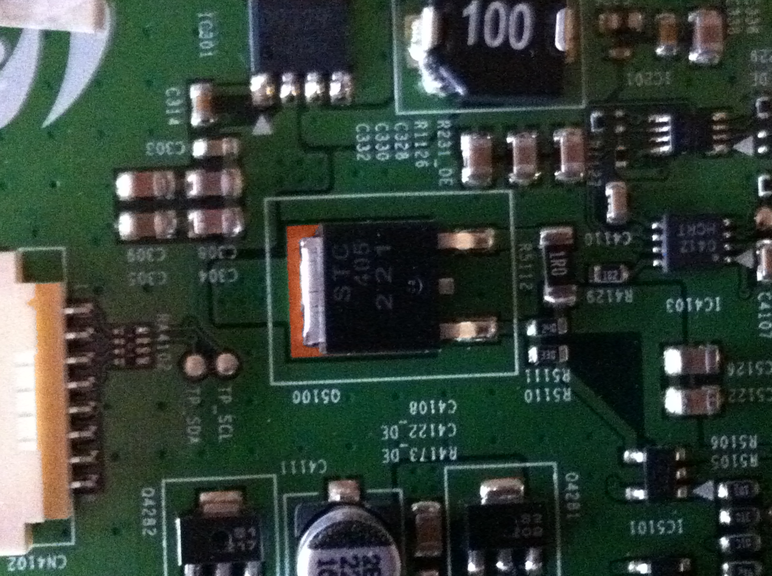

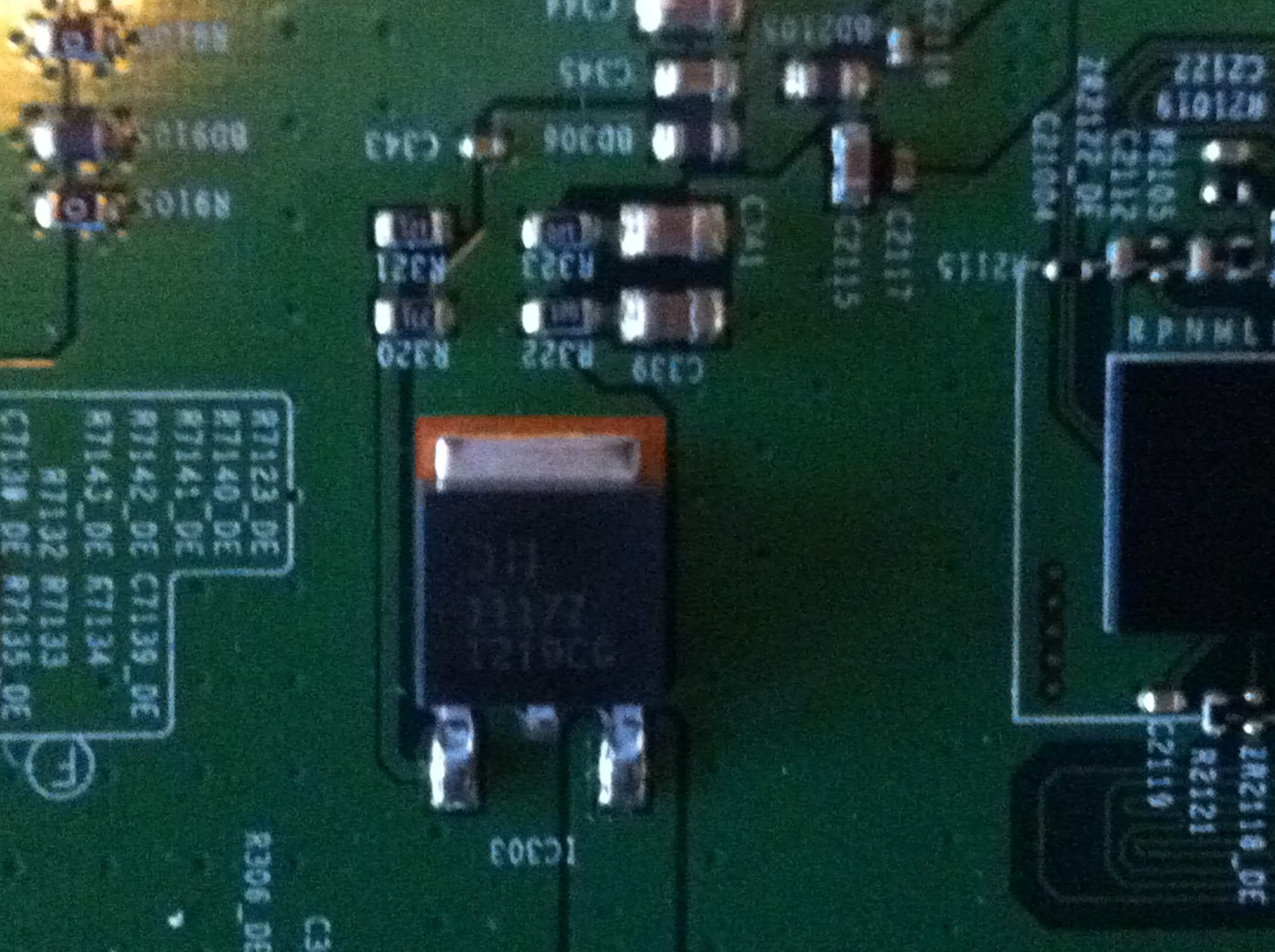

                            Here are the results from testing the four voltage regulators you specified. Thanks for the link to the guide. I numbered the regulators from top to bottom, right to left based on distance from LVDS. The 2 large ones are #1 and 2, and the small ones are #3 and 4 (right to left). I included a close up picture of each in case I misread the lines, and a clearer Tcon picture (although still not great). Since a lot of the readings are 0.00, I rechecked multiple times to be sure. Also rechecked the main SMD fuse when I was done and it was 12.74 both sides still.
                            11172
                            1219CG
                            pin 1 = 0.56
                            pin 2 (stub) = 1.82
                            pin 3 = 3.3
                            405
                            221
                            pin 1 = 0.00
                            pin 2 (stub) = 12.74
                            pin 3 = 0.00
                            81
                            217
                            pin 1 = 0.00
                            pin 2 = 0.00
                            pin 3 = 0.00
                            82
                            208
                            pin 1 = 0.00
                            pin 2 = 12.74
                            pin 3 = 0.00

                                The 2, 3, and 4 P/N do not looks like the P/N for the regulator IC, not sure what they are. #1 has correct reading.
                                • Chris24
                                  • Feb 2014
                                  • 42
                                  A search for "STC 405 datasheet" (#2) brings up a sheet for a transistor. Could the others be transistors and would they typically read 0.00.
