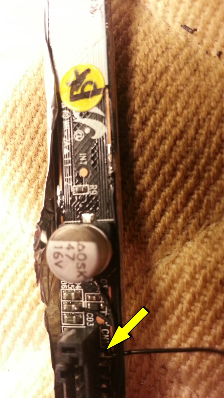

                                    • Friend4Cap
                                      Tuf gaming b550-pro damage circuit trace help!
                                      by Friend4Cap
                                      If anyone can help it will be very appreciate!!
                                      Motherboard - (TUF GAMING B550-PRO) client connected Floppy Drive 4-Pin Power Connector to RGB_Header_1 +12V G . R . B and Burn one N6V8 and Damage all circuit trace, please check pictures, Motherboard not turning on & everything check ok, no short to ground, I need to repair all circuit trace and replace burn N6V8 but don't know where this 5 circuit trace connect to N6V8. If anyone with TUF GAMING B550-PRO can check. β€œThank you in advance”...
