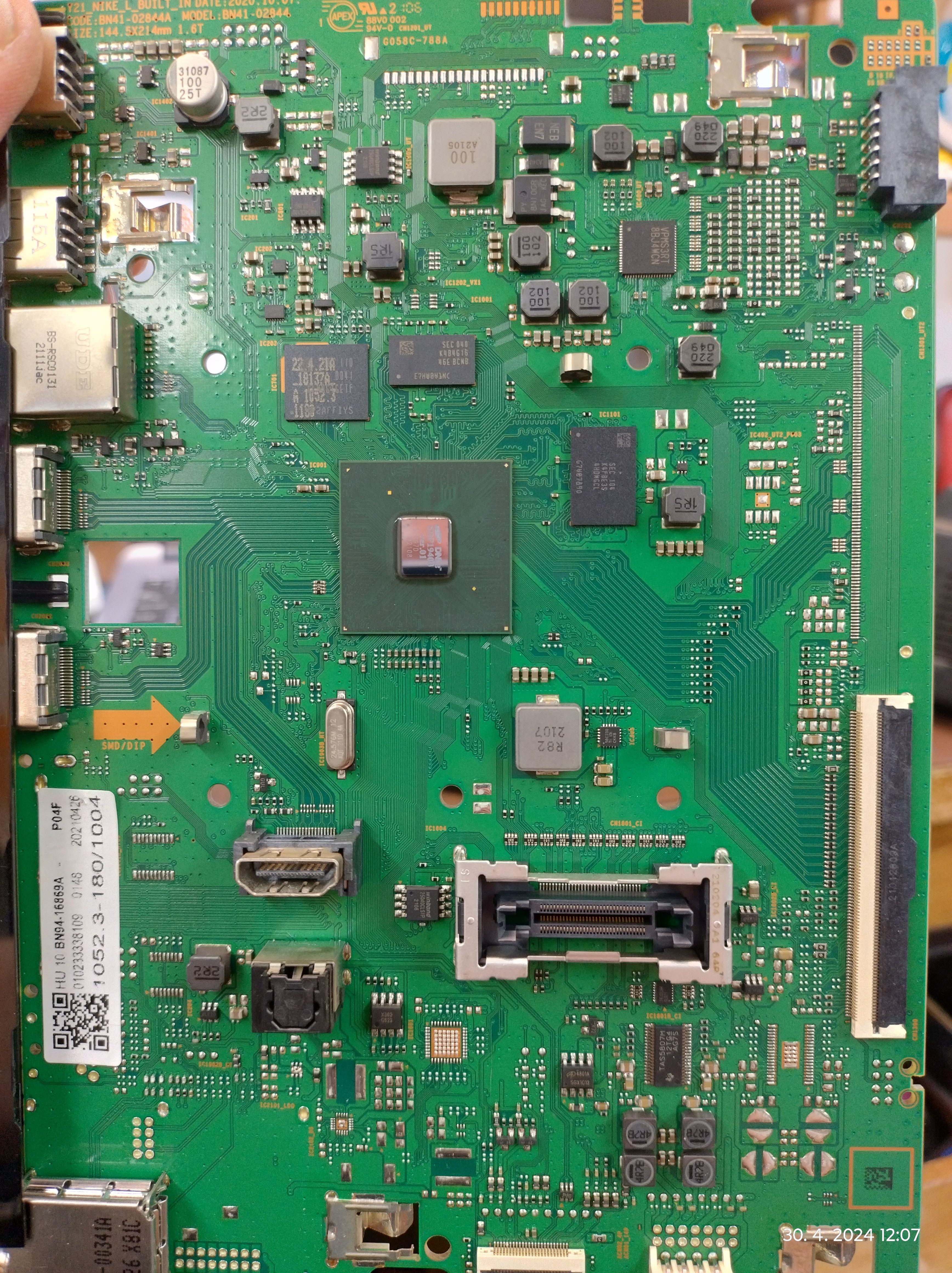

    HI
    I have a problem with the lcd turning on after a power outage.
    Panel backlight ok. Voltage main and PS too.
    Response to the remote control is fine.
    The led control flashes.
    Main board Y21 NIKE_BUILT_IN
    CODE:BN41-02844A
    BN94-16869A
    Thanks for the ideas
    Vendak75

    Pass on opening those zips lol, post using pic or YouTube.
    Does it flash red 2 times and restart?

          This isn't true. This rules out the PSU (led section) and LEDs on a tv. Not the main board. The PSU section going to main board could still be bad, the main board itself, the TCON (usually part of main now) or the panel can be bad.
          Essentially this test can rule out half the PSU and the leds

            Ahoj
            Po odpojení základní desky od napájení je podsvícení v pořádku
            Kontrolka bliká -bez restartu bez loga-černá obrazovka
            Po odpojení lvd kabelu od displeje žádná
            změna
            • vendak
              • Jan 2023
              • 12
              • Česko
              Hello
              After disconnecting the motherboard from the power supply, the backlight is fine
              Light flashes - no reboot no logo - black screen
              After disconnecting the lvd cable from the display, none
              change​

                Hi
                Photo mainboard

                  What is the led control flashing? So hit power and the screen just continuously flashes? I just repaired an AU 8000 and my symptoms was..
                  Hit power and backlight flashes repeatedly, no reboot just constant flashing. This was the LEDs had blown.
                  Here's what I did to test. You'll have to figure the best way to do this..
                  I took the power board off, so that it was disconnected from the LED connection. I then hooked the main board up, and grounded the PSU using alligator clips. I plugged it in so that everything was hooked up except for the LEDs and I took a flashlight to the screen. Lo and behold there was picture and sound.
                  Rare it happens that LEDs flash constantly and nothing turns on (not reboot). I guess if this what you mean.
                  If this isn't what you mean, probably no need to do this test.

                    Wake up! It needs spi eprom sw...
