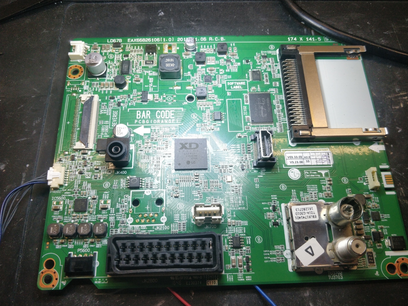

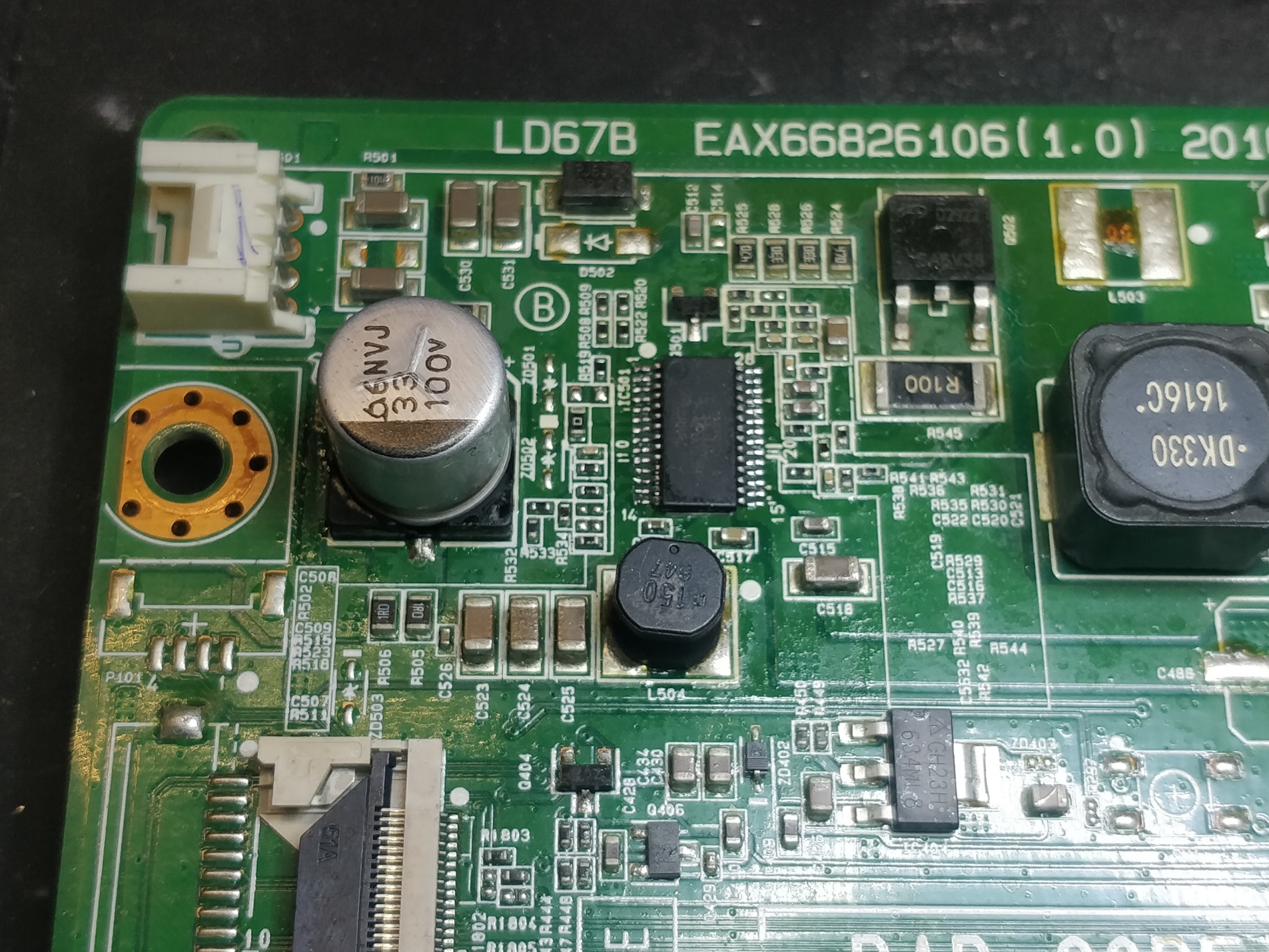

    I'm trying to fix a small LG TV with wierd issue.
    So I check that the display is OK by fashing a lamp at the screen. LCD is okay OSD is showing up.
    Now since the BL is dark, I disconneted the BL from the mainboard and I injected voltage to it with my blacklight tester.
    The BL turns on, the tester shows around 80V. So the led strips are okay it seems.
    Now I started to suspect the BL driver IC which is a MP3378.
    I have a donor board (dead cpu) with the same IC, so I swapped the driver IC but it did not solve the issue.
    Some measurements:
    I read around 18.86V at the black light connector. With the BL connected and disconnected too.
    I checked the surrounding parts around the driver but I cannot find anything out of ordinary
    What do you guys think?😊
ID:	3255788Click image for larger version
    (Ignore the red and blue wire at the bottom of the left picture, its my benchtop PSU.)​

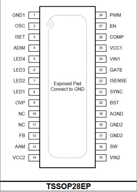

      check pin 16 on the MP3378 if there are <5V

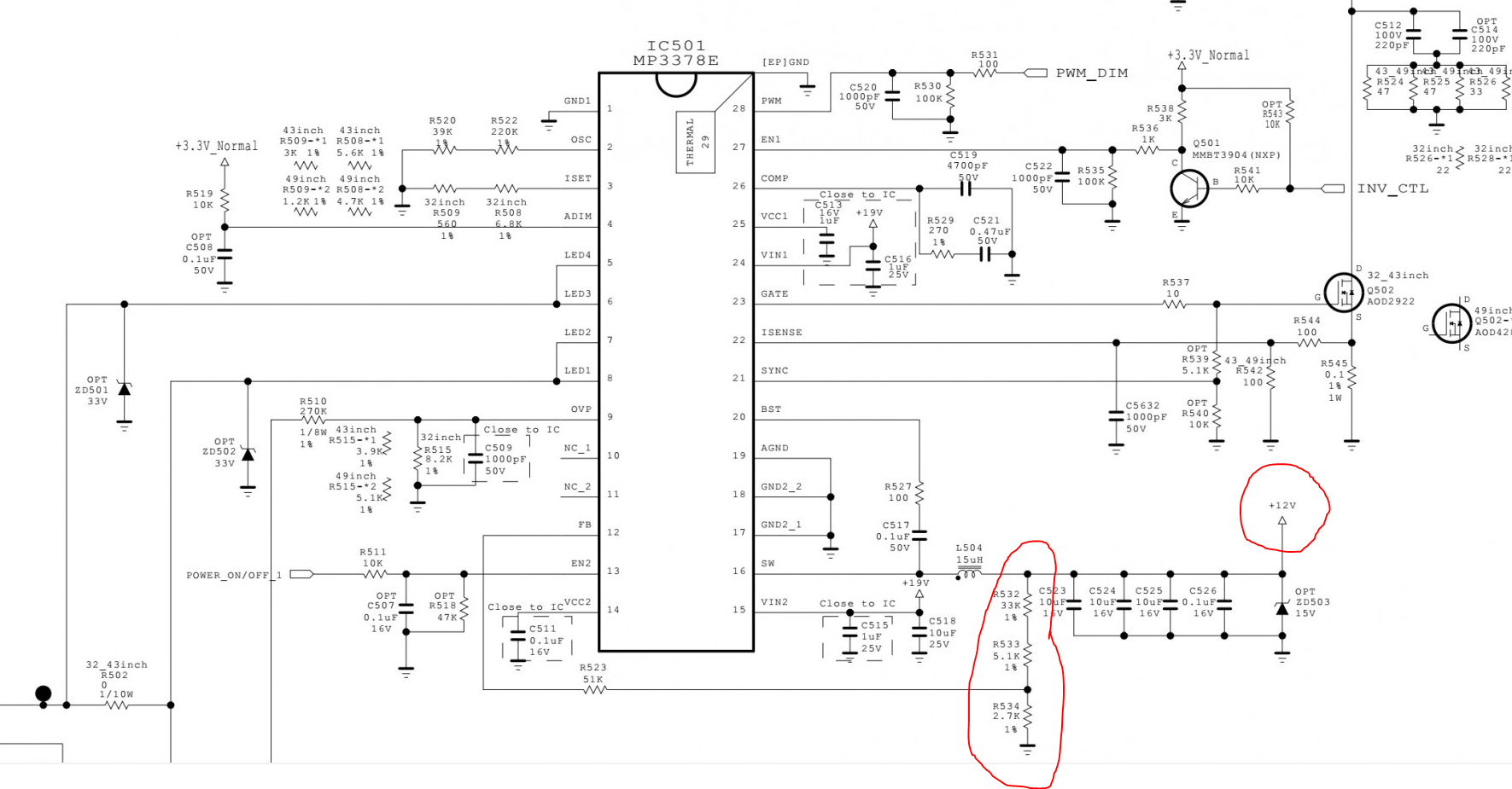

                  i measure 12v on pin 16.
                  • Diah
                    • Feb 2013
                    • 6365
                    12V !!!!! the IC operate under 5V so the specification said... however LG use LED with zener protect diode build in.... you need to take the screen apart and test LEDs one by one with diode mode..
                    • lotas
                      • Jan 2016
                      • 4593
                      • Russia
                      12V !!!!! the IC operate under 5V .
                      Everything is correct on 16 pin and should be 12v (output power on 16 pin is set by a resistor divider).
                      • EazyBone
                        • Jun 2023
                        • 1324
                        • United states
                        Where do you get these schematics from?
                        • lotas
                          • Jan 2016
                          • 4593
                          • Russia
                          From the Internet and repair forums.

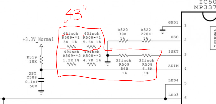

                              Turns out you guys were right about the backlight.
                              I ditched my BL tester and used my bech powersupply with 20V/0.60A.
                              Out of the three LED stripes the middle one had a faulty LED which only showed it's fault with the lab PSU, not with the tester.
                              Now I fixed the BL, but I wonder if I could increase the longevity of the LEDs bz decreaseing the current it supplyied by the TV board.
                              I'm not sure about which resistors should I remove. I cannot measure voltage on R525/8/6/4, so i don't think they are part of the backlight circuit.
                              • lotas
                                • Jan 2016
                                • 4593
                                • Russia
                                Increase the resistance of R508 a little.
                                • unimatrix93
                                  • Oct 2021
                                  • 343
                                  • MagyarorszĂĄg
                                  Thank you,
                                  I replaced R508 (5.6kohm) with a 8kOhm resistor.
                                  Current draw dropped from around 900mA to 700mA.
