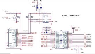

    Hi there.
    Looking for schematics or service manual for BenQ th585 projector. Can't find it anywhere.
    My friend tried to clean it and knocked off quite few components of the board. Hdmi area is affected so no signal from both hdmi but VGA works fine.I saw some photos of boards from AliExpress but there is no way to know what values them components are. Can send some photos if required. Thanks for help

        can you show the circuit close to HDMI socket... over all benq they will use same way and parts.

          That's photo I hope resolution is fine.If you need anymore or from different perspective just gimme a shout.
          Components marked as C1590,C1591,C165,C167 and L140,L141,L143 thery are all missing I tapped it with solder to clean remains also in left hand top corner there are 3 missing as well.

            check the 3 filters L they have 5V on same line side?

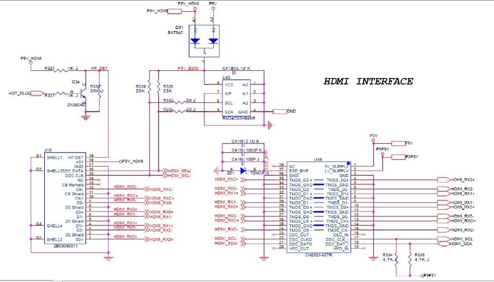

              so you need to DIY it , L you can use any from scraps boards of TVs .. C as well... here what i have of Benq HDMI Interface... where you can see it depend on 5V which you need as i mentioned before to trace it.
