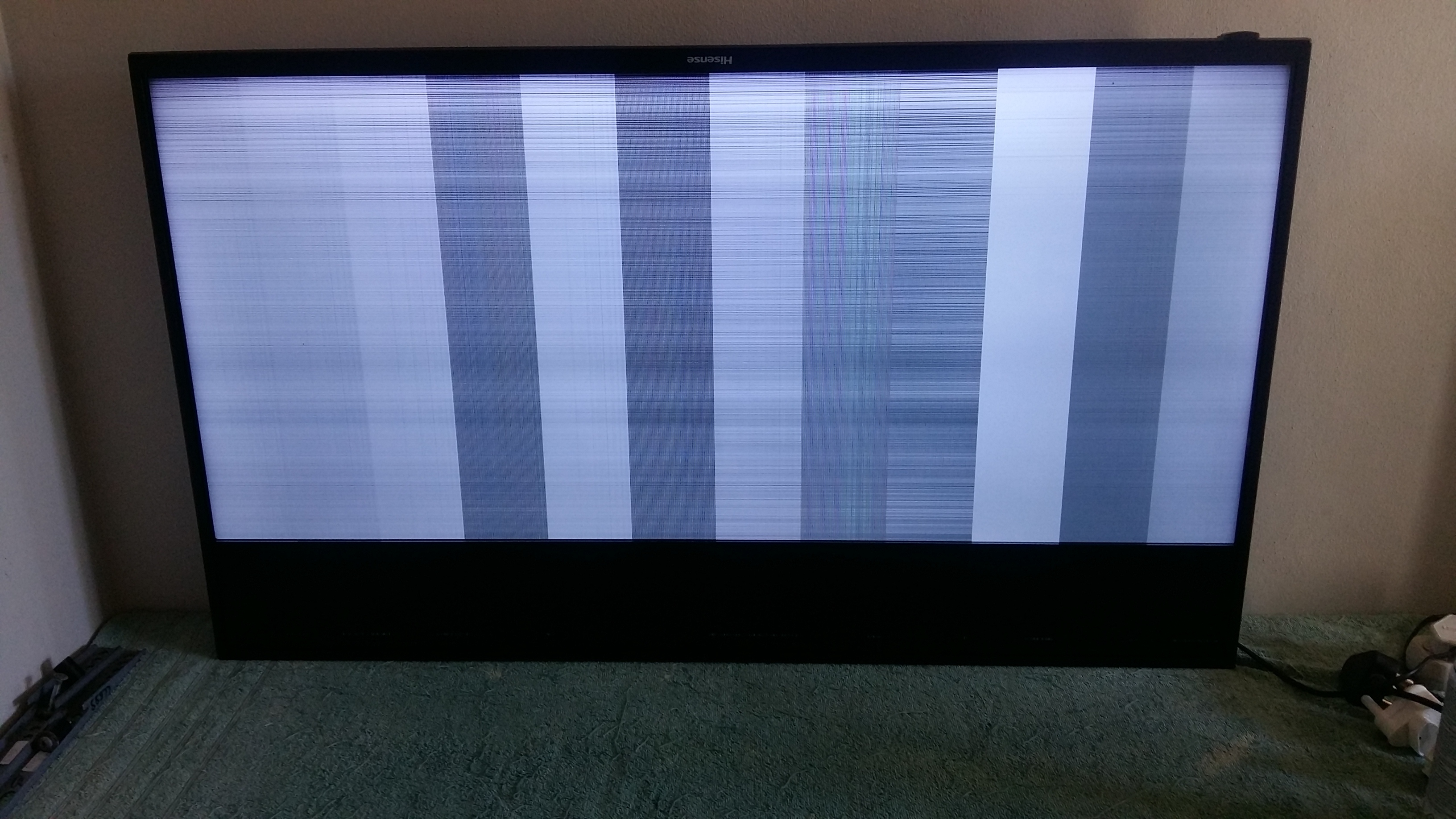

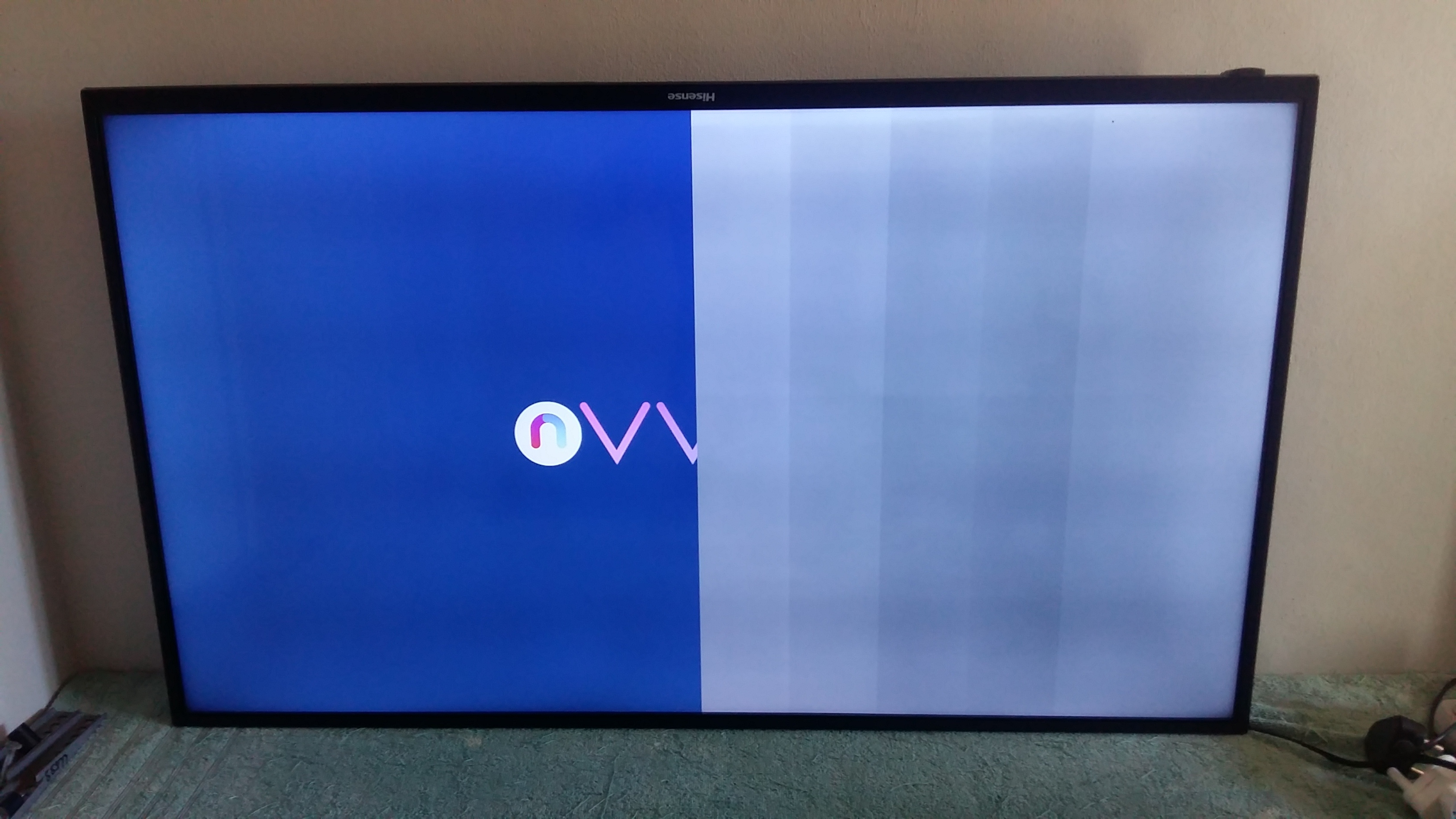

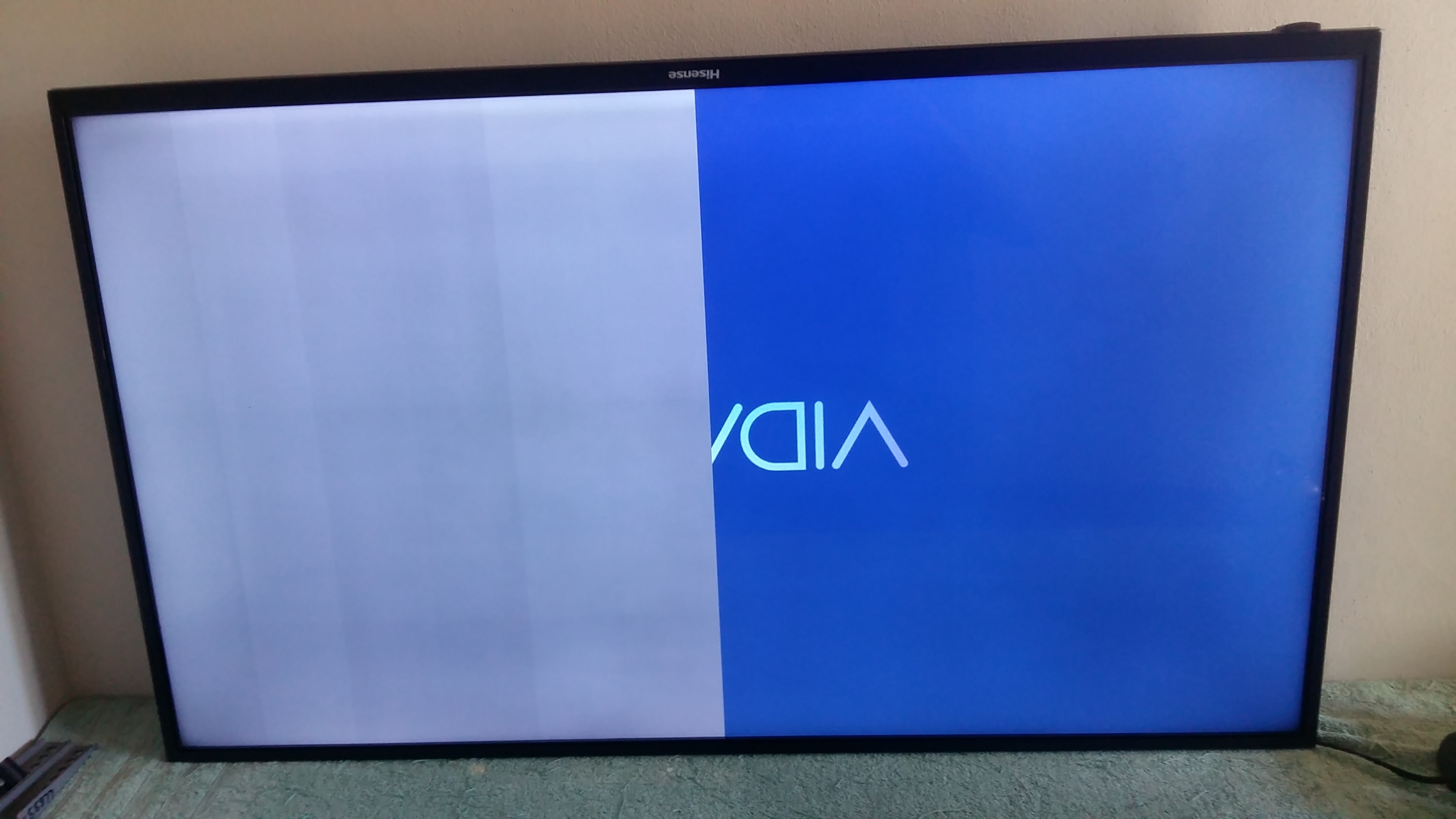

    Hisense HE43A6100UTWS Panel problems
    Panel shows two good half pictures when alternatively plugged in but poor/ distorted picture when both sides of panel are plugged in. Is this a panel or drive fault?

    Is the right side upright or upside down?
    • Diah
      • Feb 2013
      • 6421
      half buffer issue caused by all in one boards (MB) try first with firmware to downgrade.. if not solved.. replace all in one boards.
        No set was upside down so as not to put pressure on the knob at the bottom. Thanks

                    Hi, post a picture or more of the back side view of boards.. my guess is bad tcon board.. bye...

                        ..more than TCON i suspect bad panel stripe boards..

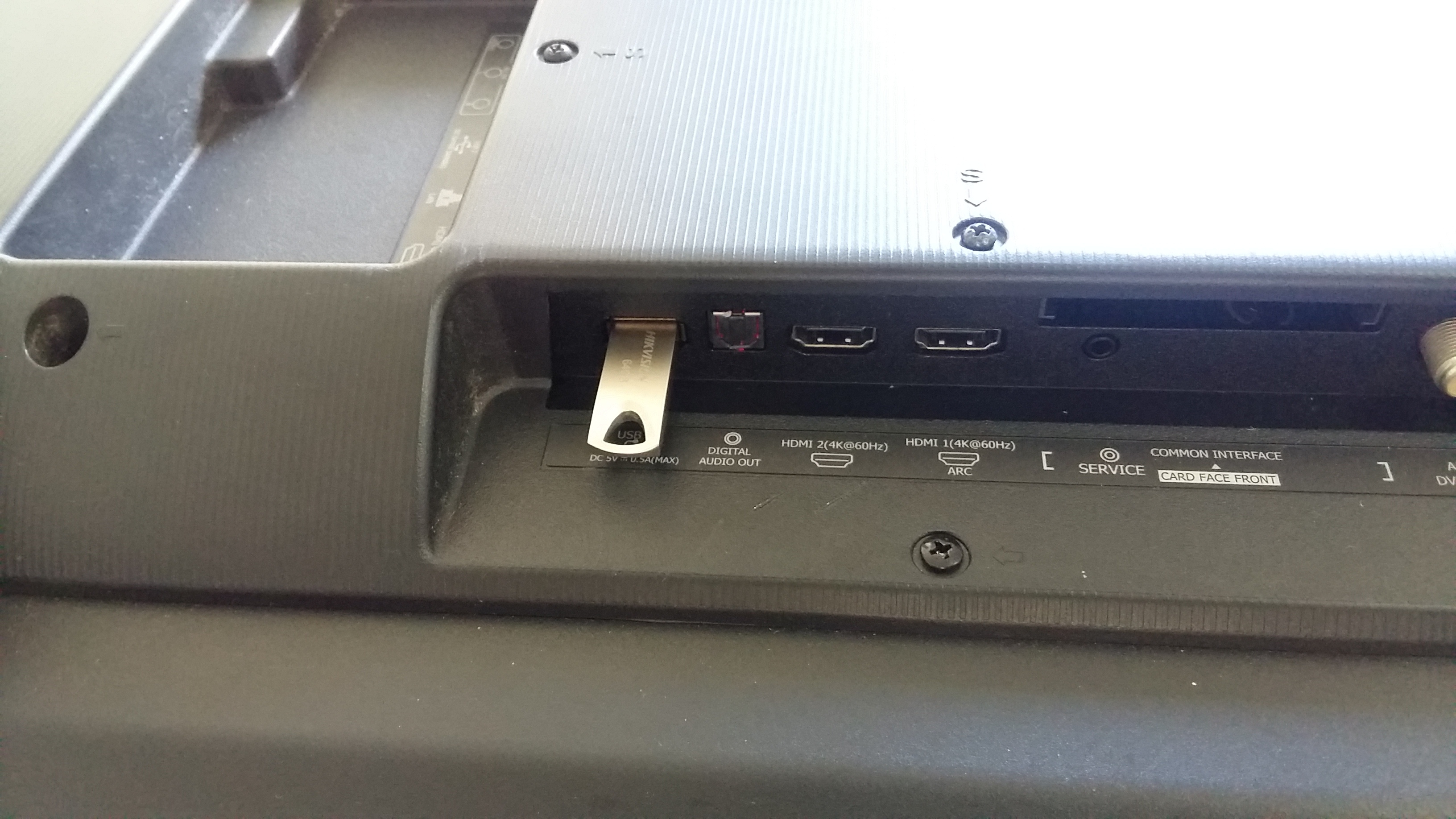

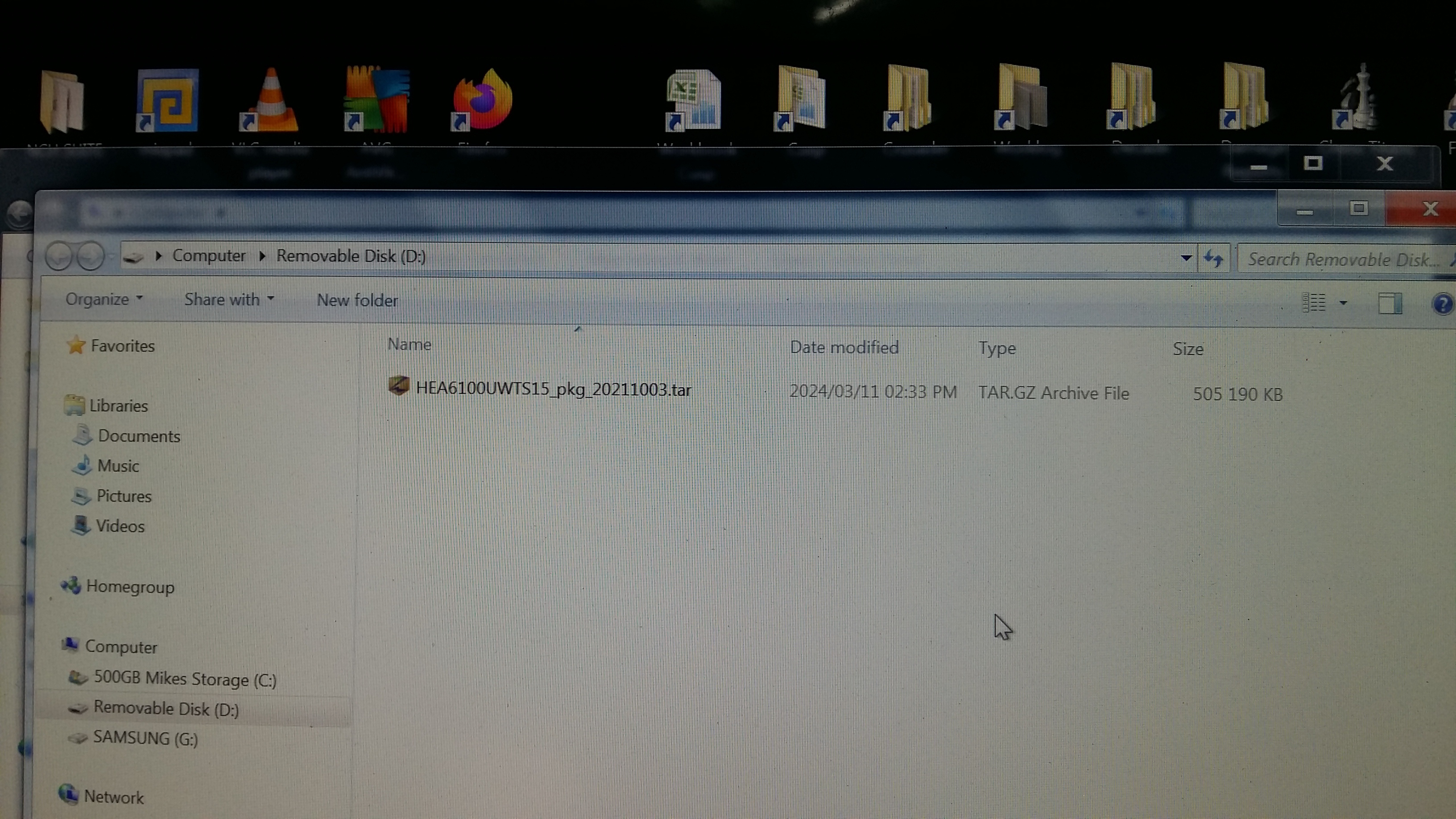

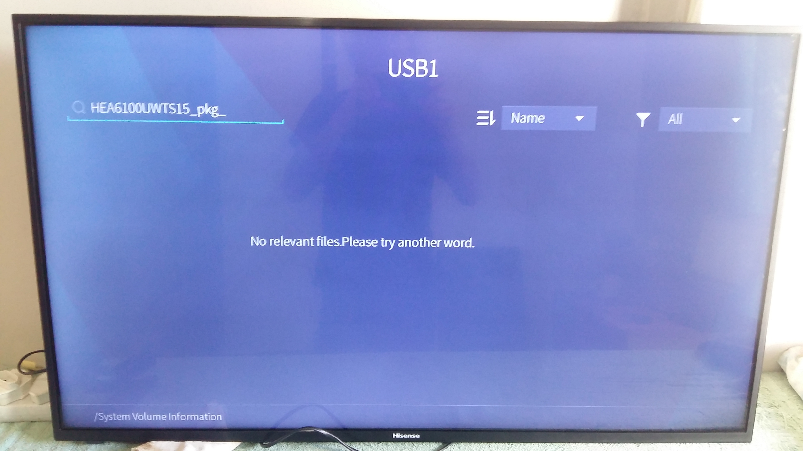

                            • Grunder
                              • Jan 2016
                              • 323
                              • south africa
                              Thanks Diah, Davi and Vincent. Sorry slow response, eventually got tar file. Funny thing is when I switched the TV on it had a perfect picture...until it started playing up again.
                              I beginning to think it's a poor connection somewhere? Can software be intermittent? Long story short, I wasnt able to get the TV to digest the tar file, mp pc said the tar file was there, but TV couldn't find it.
                              I've done a factory reset, will this "repair" the firmware?
                              The TV is on my workbench and if the fault comes up again I will check the print on the tcon as Davi suggested.

                                Pc says it's on the usb, TV says it isn't, but problem seems to solved for the meantime, thanks all

                                  half buffer issue are caused when firmware cliche .. now it show correct because USB view in other resolution..
                                  the .tar file you have now should extract with 7zip to have the end format file

                                    Thanks Diah, I will try to extract bin from tar. Have been using my phone to work with and need to get my pc online to do this properly.
                                    The TV freakishly ran for about 3 hrs last night and I was able to watch utube flawlessly then it flunked out again. I turned t upside down and back and that appeared to work for awhile, then flunks out. All kinds of twisting and contortion from there didn't help. It appear that when I was flipping through the menu that certain images woukd have a different effect on the screen( a few very bars to blank screen) so maybe like you suggest different resolutions would have different effect on the buffer.
                                    I would really like to do the binfile rewrite but the repair is now 2 weeks on my bench. I've requested am order for a new main board and looks like I might just replace the board to satisfy my customer. Will let know final outcome. Thanks, Mike
