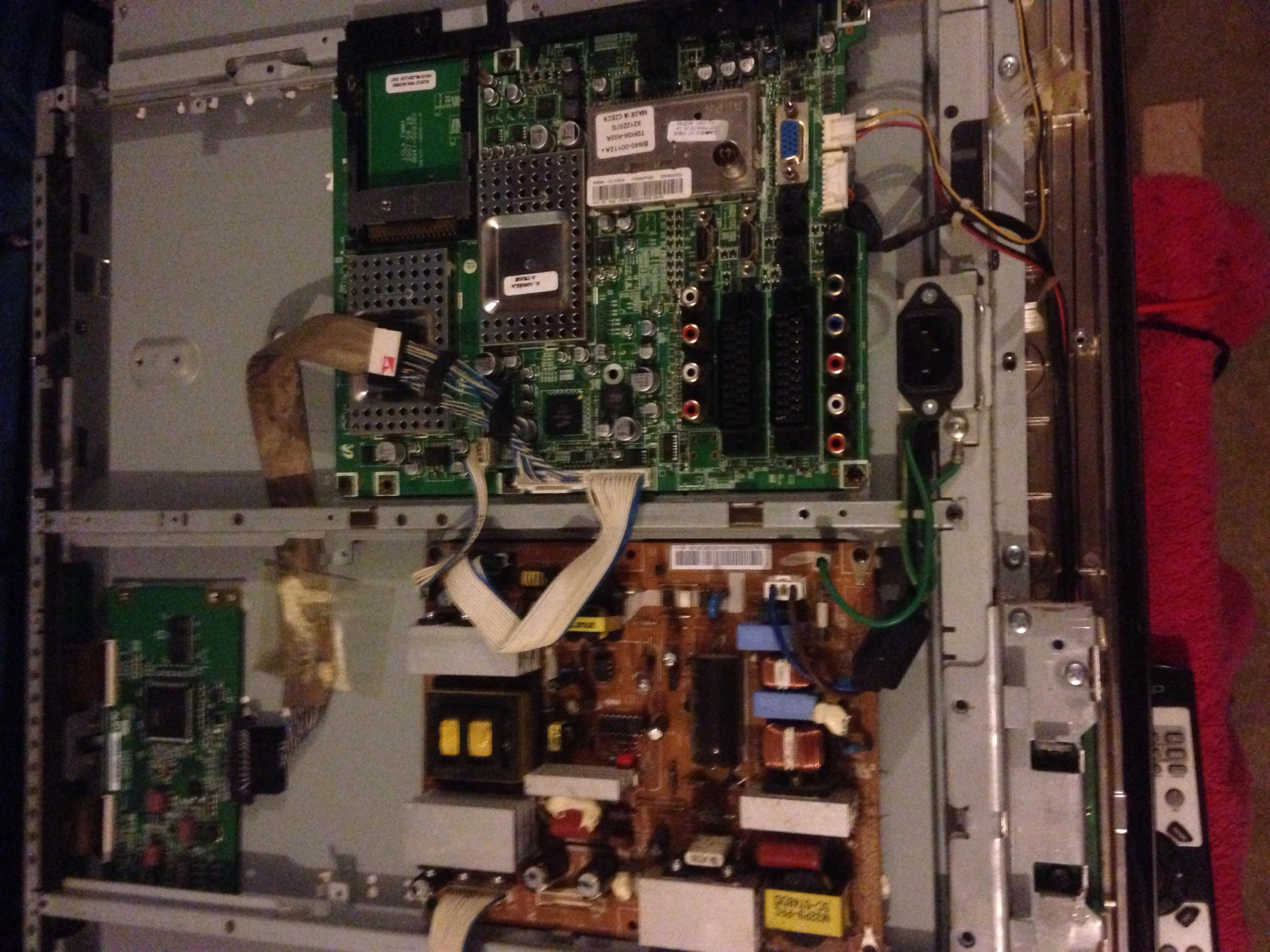

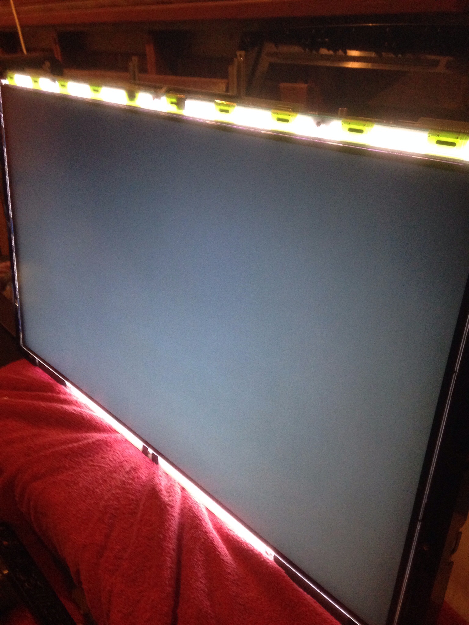

    I have a SAMSUNG LE32S86BDX. The tv powers up ok and I have backlight and sound.
    In the first instance I suspected the tcon board after researching similar issues.
    On replacing the tcon I still have no image.
    Is this likely to be the panel?
    I did notice some flicker to to the screen when scrolling through input on the controller.
    Can anyone help plz

    Can we have a picture of the Tv with the back off please, does this look to have a secondary video board after the main and before the T-con board?

      Re: Samsung le32s86bdx
      Hi and thanks for your reply
      I will get a pic up ASAP I'm at work at the min.
      From what I can see there is no secondary board

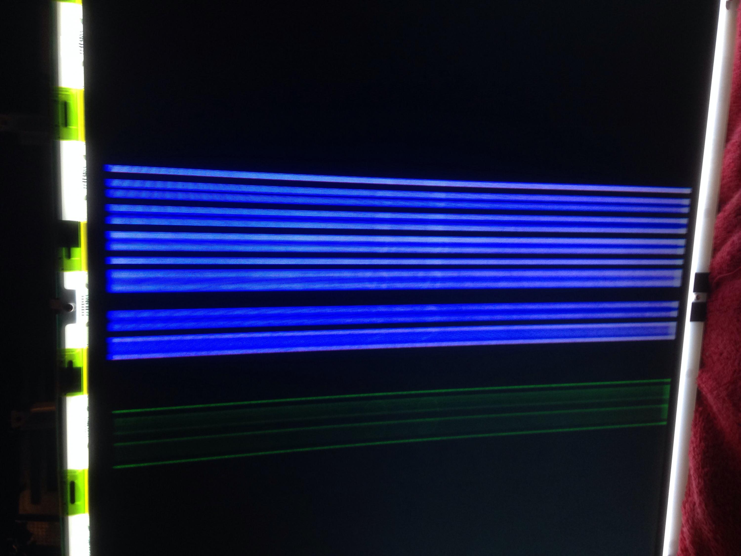

        This is with the tcon unhooked from av main
            And this when tcon is connected to av main
                I am placing a bet on the panel being bad. Possibly T-con if VGL/VGH voltage is low from T-con. Possibly tab bond too.
                  Ok thanks for that
                  I know tcon is good and looked at tab bonds can't see anything with them too.
                  Looks like one for spares.
                  Thanks again
                    How do you know the t-con is good?
