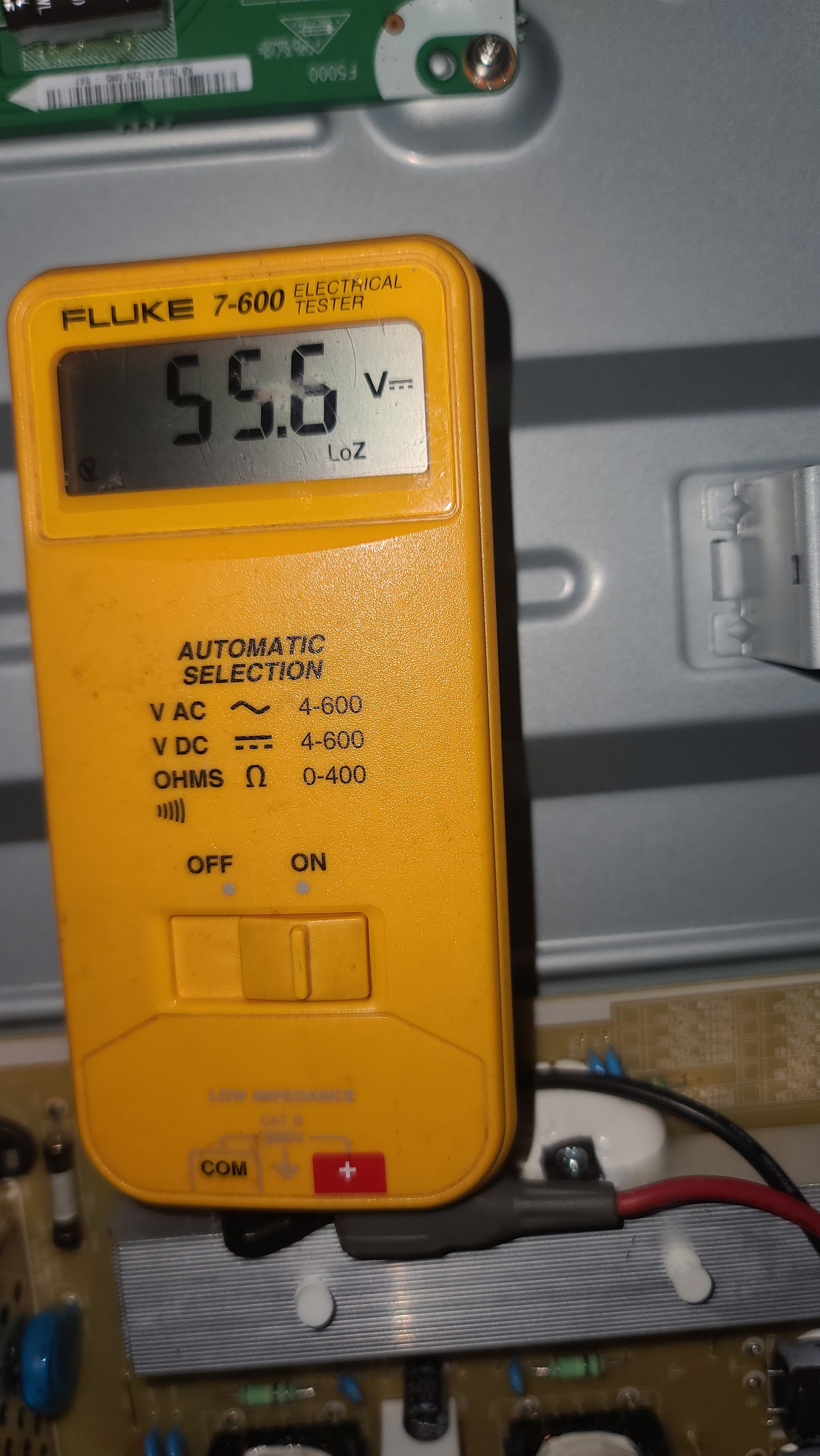

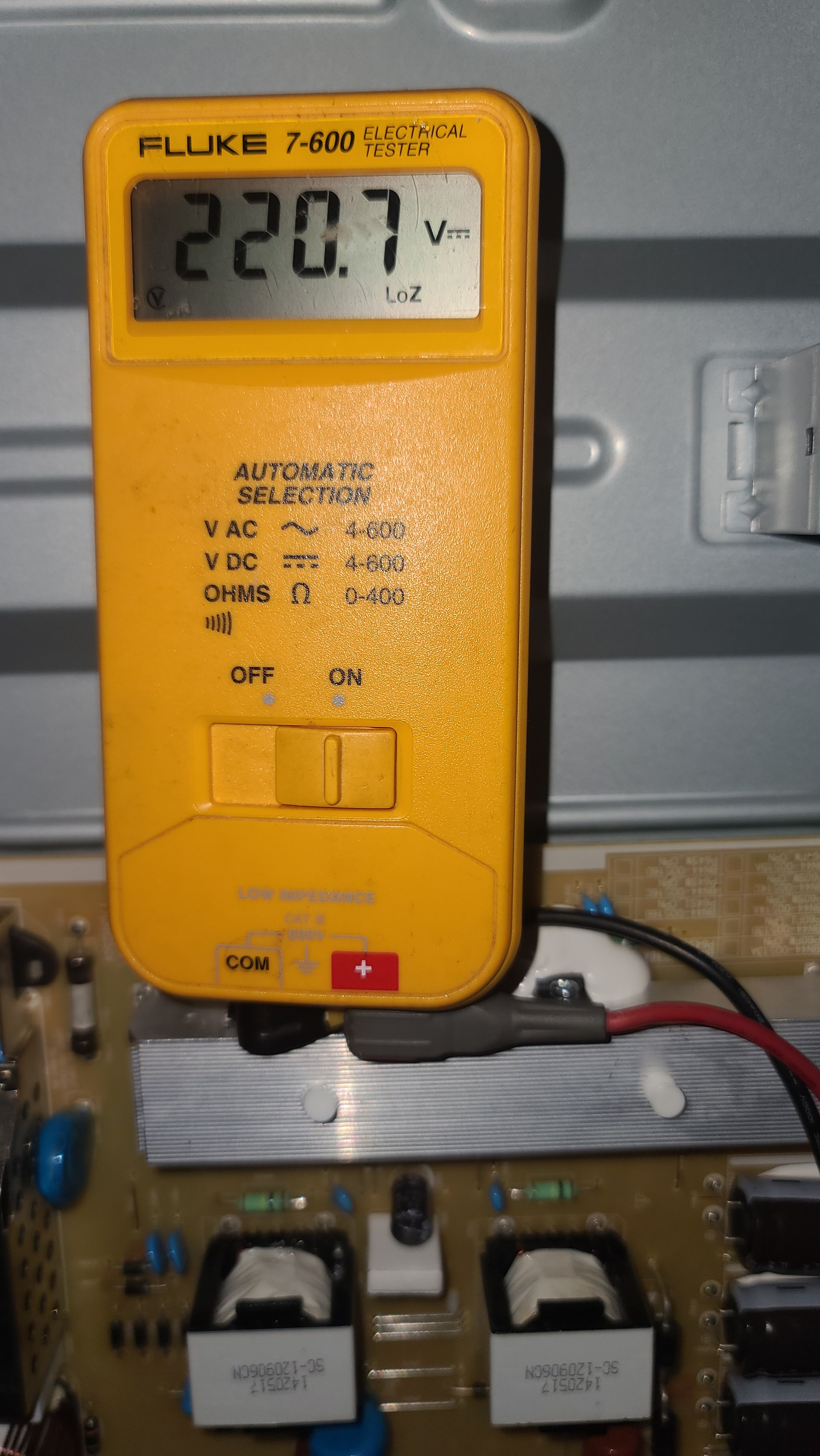

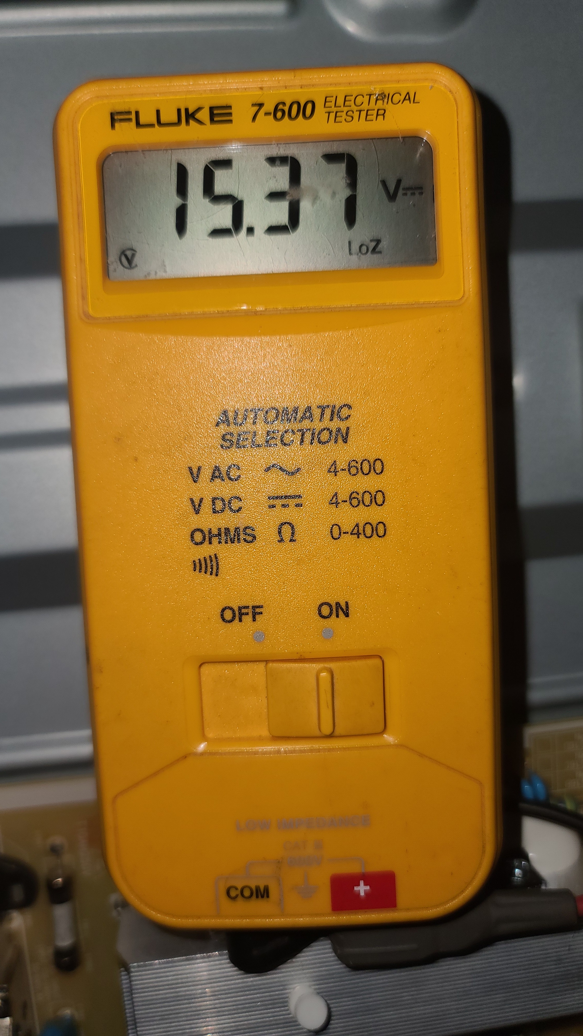

    I have one from a pn64e533. I replaced the 3BR2565JF and the two 18n50 (used 22n60 that I had on hand). I now have standby, vs, va, and 15 volt rails. When I reinstall it the relay just clicks. Swapped it out with a good power supply and the tv works. What do I have to do now to repair it?

            I did test it on the workbench first. The vs is 220. Tha va is 55. I also have the 15 volt rail.

              220 are much low,,, since u replaced 3BR2565JF i would check all smt parts around it

                Vs should be 217 va should be 55 according to the samsung panel sticker.
