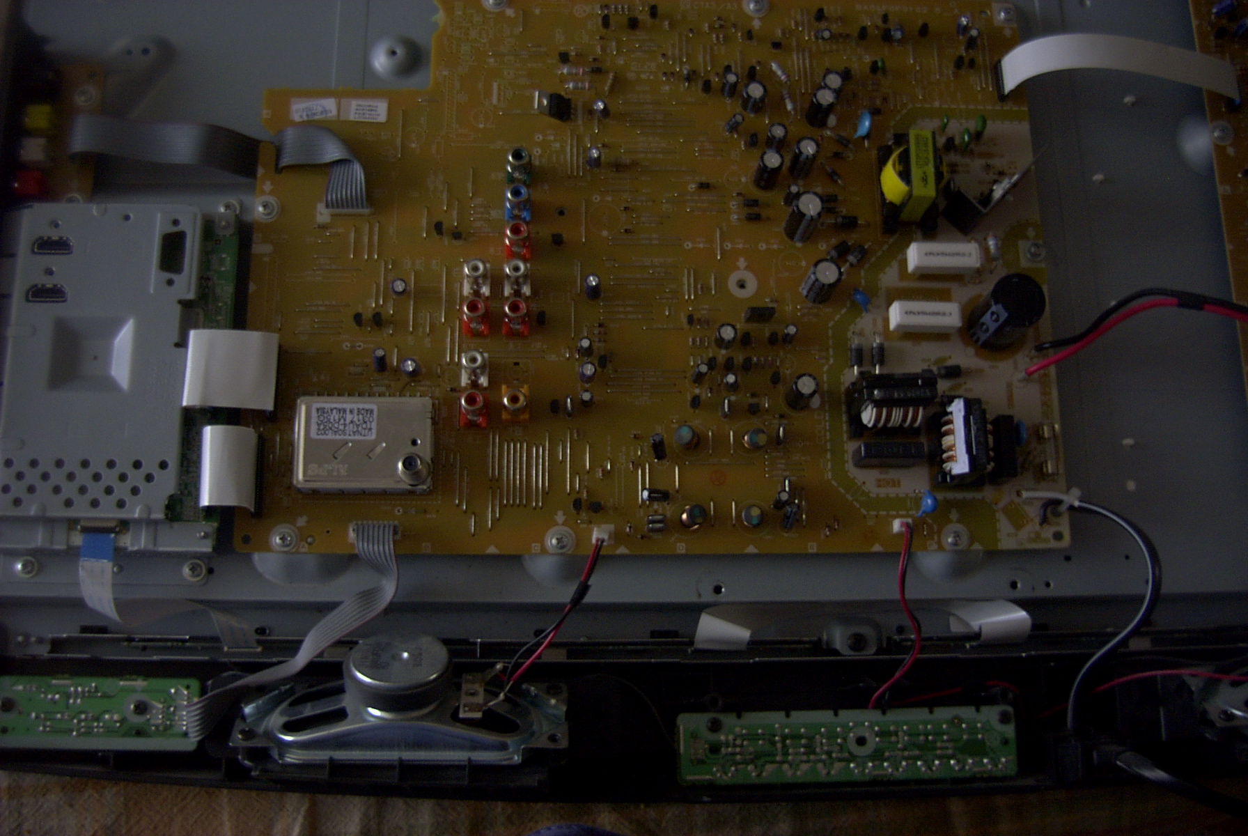

          ok i understand now. in order to troubleshoot it you're gonna have to take a good clear pic of all of the boards and individual pics of each board and go to manage attachments in the go advanced section and add them to your post then someone will be able to help
          • jack1
            • Mar 2013
            • 30
            • usa
            Re: Sylvania lc320sl1 wont turn on

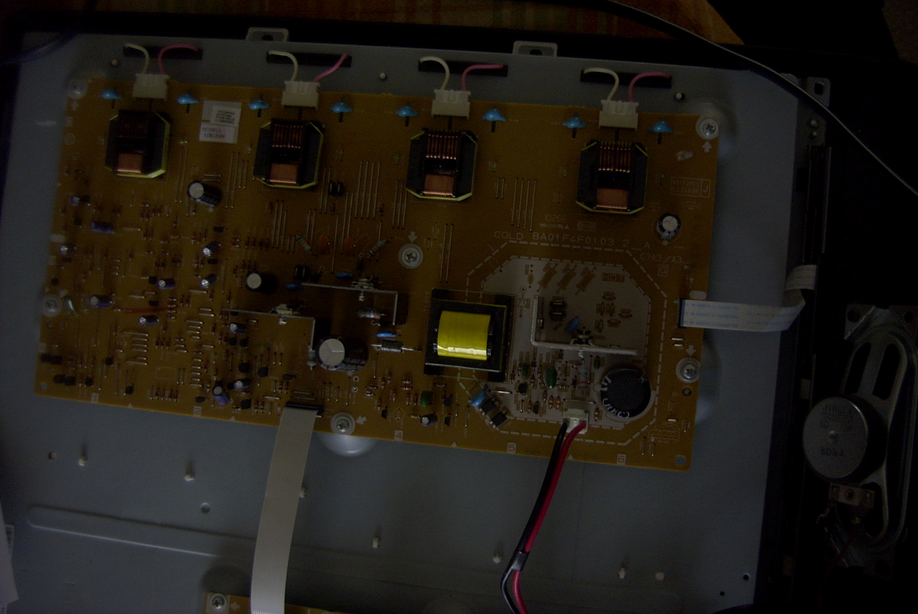

            got my camera working here are the photos
              Re solder all inverter transformers then ohm them out when done. They should all read the same. Roughly 5 meg ohms.
              • jack1
                • Mar 2013
                • 30
                • usa
                sorry i have been away. these coils are on backlight board? right they ohm out at 2.95. should i ohm them off the board?
                • Ltank
                  • Jun 2013
                  • 776
                  Primary winding should show a low resistance. The secondary side will be much higher. There should not be a primary to secondary short. Just to give you an idea what to expect.
                  • jack1
                    • Mar 2013
                    • 30
                    • usa
                    i have been busy. i resoldred coils stays on now. thank you very much. i have new problem. the power button turns it on but wont turn it off but does volume and menu but the other buttoms do nothing
