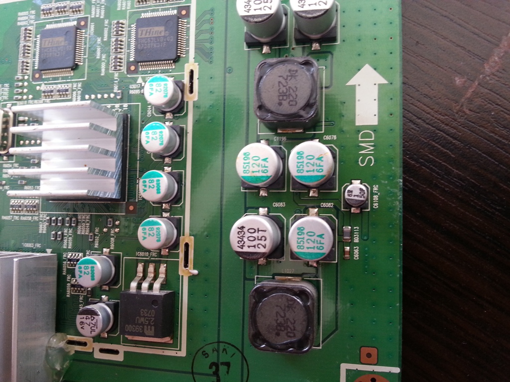

              Hello guys!
              I think i got the solution to this M87BD with this symptoms:
              -Constant rebooting.
              -Turning on after circa 30min with stripes and faulty image.
              Fortunately i have a similar one in my workshop with a faulty T-con, the infamous AS15, but thats another story. I started swapping boards. PSU was ok. i didnt want to remove the mainboard so next was the scaler bn41-00895b.
              This was the culprit. TV went on and picture was ok.
              My guess was reflowing and reballing the DNIe and the Micronas chips.
              But no luck. Anyway thanks to the fellows of the Polish site, i managed to succeed with removing the capacitor C6108_FRC (1uF/50V). I soldered another electrolytic similar one. TV is running flawless.
              I hope this helps. Credits go to the polish technician, i just used google translate.

                I have almost the same simptoms with this model (continous loop, only starts with heat blower on the scaler board, and after a while it displays some horizontal lines) i replaced the capacitor today and i hope it will work, i'm excited, i was looking for a solution for about 6 months.
                I'll get back with an answer.

                  It works !!! Thank you !!! Thanks also to the polish guy!
                    #69
                    Re: Samsung LE32M87BD - stuck in standby - blinking LED
                    Thanks for the tips, did you measure the cap to see what kind of failure it has?
                      #70
                      I've measured the cap and it had 0.8 uF. I just tried heating the bad cap and when heated it goes at 1uF.
                        #71
                        Probably more of an ESR thing than anything. Could cause a voltage regulator to become unstable.
                          #72
                          Thanks for info about 1uF cap. I changed this cap to new one and TV work again. Than I measured the Capacity and ESR of the original cap and measurement shows increased ESR value than expected. Once again thank for tip.
