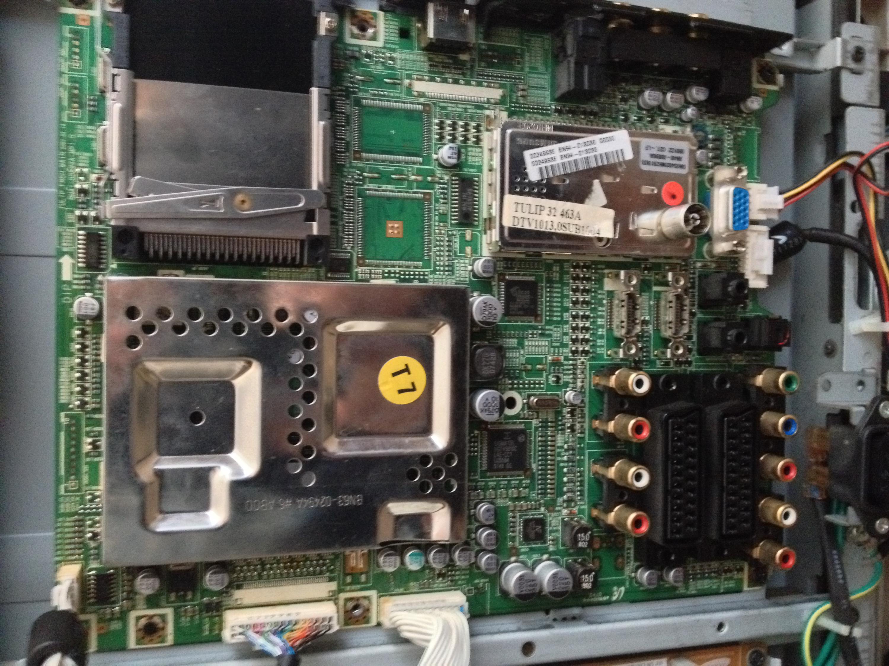

      Re: Samsung LE32M87BD - stuck in standby - blinking LED
      yeah removed shield
      then covered all board apart from where the shield sits
      applied flux allowing some to run behind the chips
      then was in over ( pre heated ) for 15 min
      strange this was tho i put it back in while it was still very warm - but it didnt come on it did the same thing
      i have now put shield back on and tried again still the same cycle
      now the hair dryer took longer but it seemed to come on again when i pointed it lower ( just below the shield )

        Maybe it's not the processor - where are you pointing heat at?
            its hard to tell as alot of things get heated up at once but just below the shield

                  #48
                  Originally posted by noledud
                  yeah removed shield
                  when I last done it i let the flux run everywhere in that area, but my fault was not as bad as this as it would restart after 2-3 hours of use, whereas yours is instant.
                  i've had one previously too that couldn't be repaired, still sitting in my cupboard, probably a new board is needed

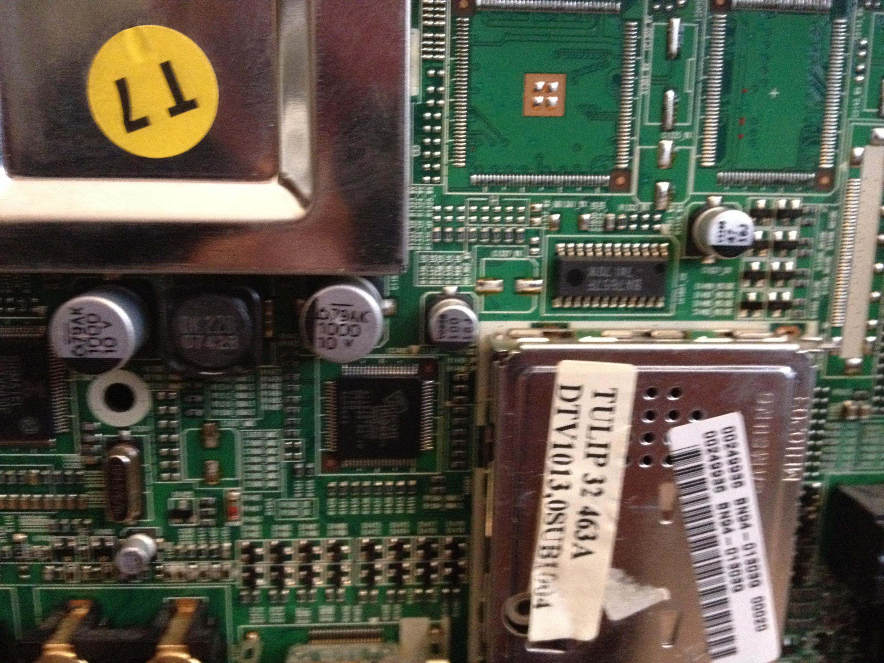

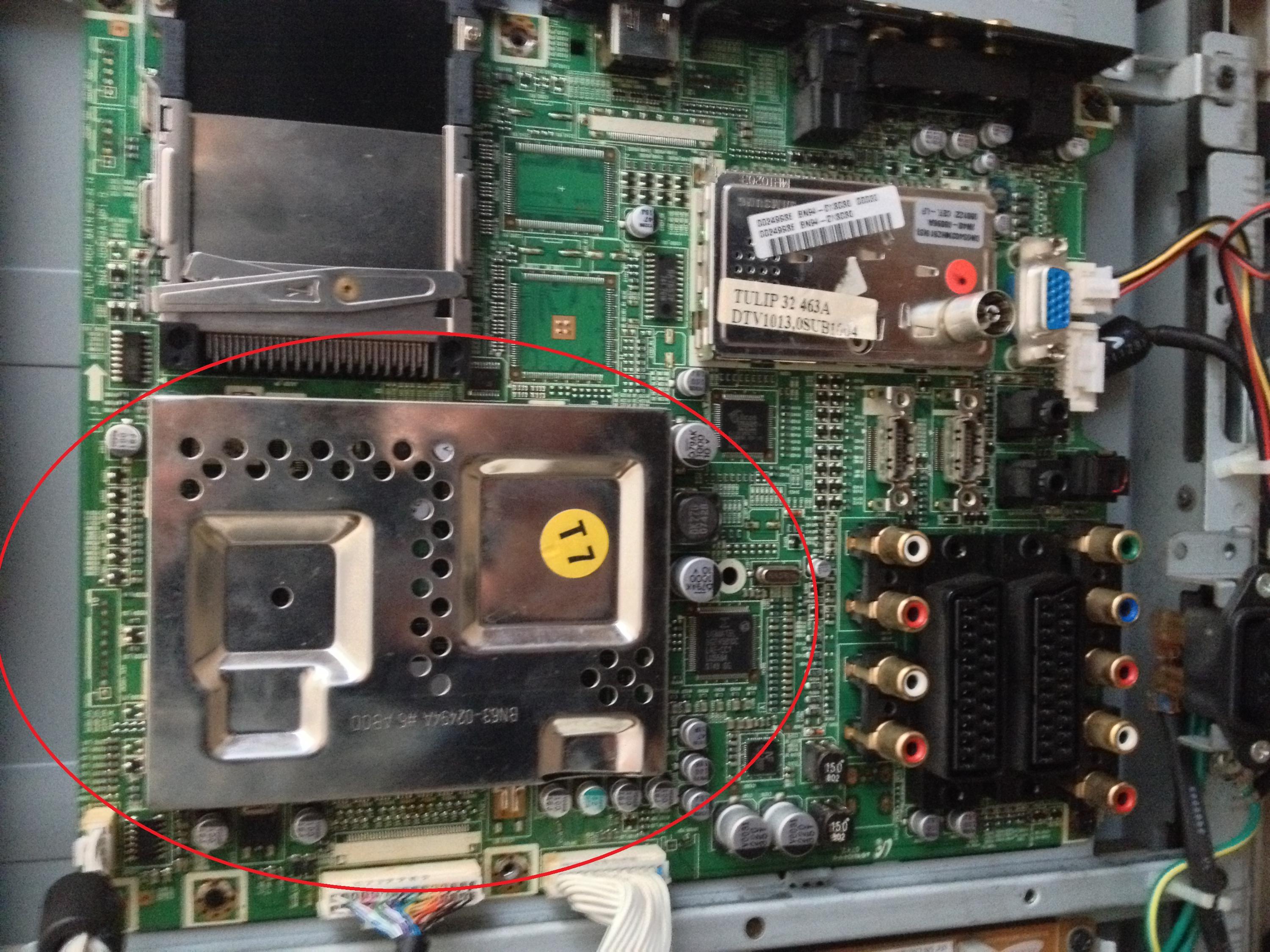

                    can you circle for me in my pic ?

                      #50
                      when i get it going it then stays on and the heat shield gets very hot as the processor is running
                      but if i turn it off i cant get it back on again so something is cooling down - ( but the processor makes its own heat and in fact gets hotter )
                      it just went off again and i tried heating towards the bottom right just to the left of the turner and it seemed to come on quicker

                        #51
                        in this general area,

                          #52
                          yeah in that general area - nothing to lose baking again but this time let more of the board get the heat, i dont think the prob is under the shield has something to do around the shield as they are the bits that cool down again.

                            #53
                            went off again and tried heating the caps near the power connector - no change
                            then when i heated the caps around the turner it came on so im slowly narrowing it down
                            so tom66 the electrolytics can be replaced ? can i just get them from maplin ?

                                when i apply heat in this general area the tv works until they cool - so is there anything there that stands out that i can replace - or am i wasting my time
                                  #56
                                  Try narrowing heat down to just those 1000uF 10V caps - check voltage across them while working and while faulty.
