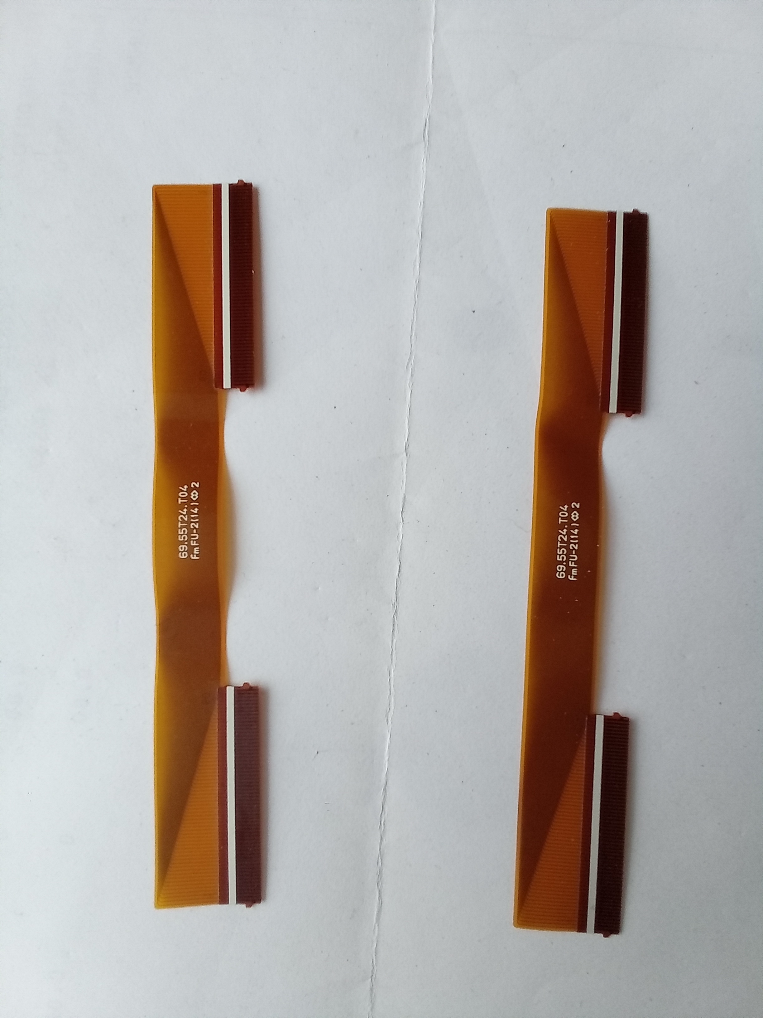

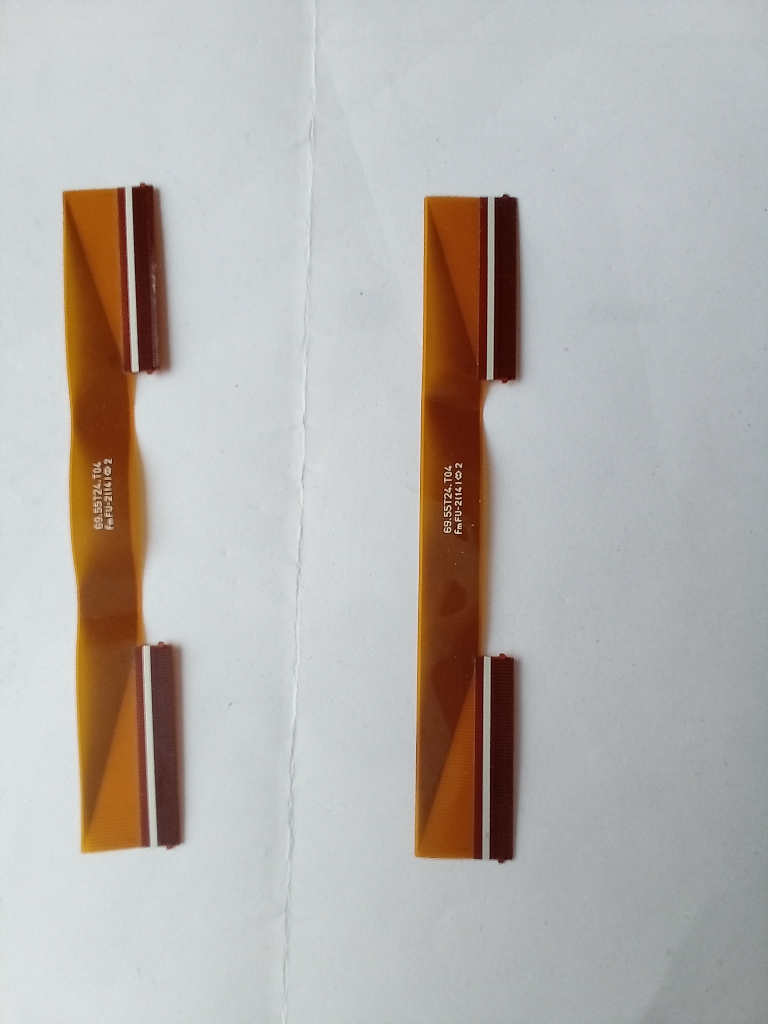

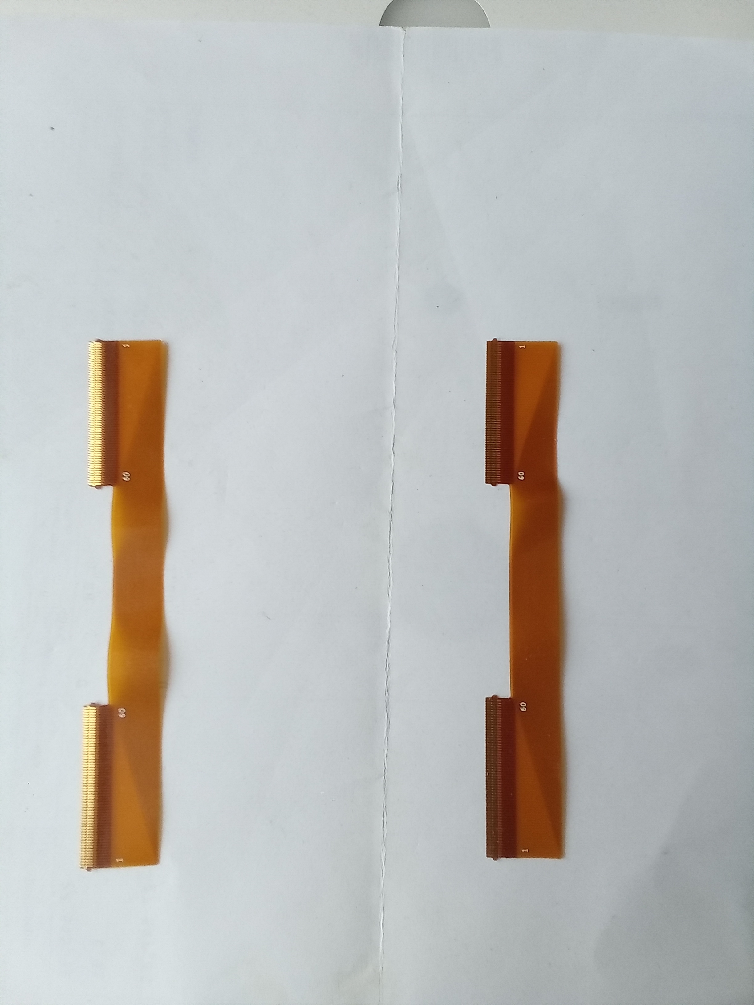

What these connections are called
  • bohaboha
    • Nov 2012
    • 973
    • sweden
    What these connections are called
    Hi everyone, does anyone know the names of those contacts
  • Biruslapio
    • Nov 2013
    • 552
    • Brasil
    They are cables, called ribbon or flat cables, 60 pins.
    I've torn one of these by mistake and just replaced with one with the same pin count and spacing from a plasma tv, it fit perfectly and the tv worked.
    • bohaboha
      • Nov 2012
      • 973
      • sweden
      Originally posted by Biruslapio
      They are cables, called ribbon or flat cables, 60 pins.
      I've torn one of these by mistake and just replaced with one with the same pin count and spacing from a plasma tv, it fit perfectly and the tv worked.
      do all of them have 60 pins? I'm trying to put an ad on ebay but I can't find the right name so people get it others call them " buffer connection cables" or ffc cables
      Which is true, I don't know
      Last edited by bohaboha; 02-09-2024, 10:11 PM.
      • diif
        • Feb 2014
        • 6978
        • England
        Any cable that is flat and flexible is an FFC.
        • kasfamily
          • Aug 2014
          • 765
          • Russia
          For example
          qpwbm006zzpn
          https://aliexpress.ru/wholesale?Sear...LDJBKhFw%3D%3D
          Last edited by kasfamily; 02-10-2024, 12:39 AM.
          • diif
            • Feb 2014
            • 6978
            • England
            The part number looks to be 69.55t24.t04 as doing a search online for that brings up results.
            • bohaboha
              • Nov 2012
              • 973
              • sweden
              Originally posted by diif
              The part number looks to be 69.55t24.t04 as doing a search online for that brings up results.
              thank you all for your help .diif​ exatly what you say I haven't found this reference. has been put on ebay already sold .another question ar they compatible if the connectors would fit another screen ? as Biruslapio has said in the first answer " I've torn one of these by mistake and just replaced with one with the same pin count and spacing from a plasma tv, it fit perfectly and the tv worked" good to know
              • diif
                • Feb 2014
                • 6978
                • England
                That part number seems to be linked to different sizes of Samsung and also a Vizio TV.
                • scubacamper
                  Sharp Aquos LC-70C6400U Half Screen Dark
                  by scubacamper
                  I found another post on this site the other day which has been very helpful in troubleshooting this issue I am having with my tv. The left half of the screen is dark, and the other half is VERY slow to generate it's image - and it only generates part of its image at that.
                  Based on this yt video, I have narrowed it down to an issue (short?) on the left side of the display, somewhere in the system of ribbon cables.
                  when I remove the bezel and the rear cover, I can get the image to display correctly by manipulating the ribbon cables on the left side which connects the left lower display...
                  05-03-2025, 12:19 PM
                • thstuff
                  Sony OLED XR-77A80J - Initially dead, now 4 Flashes
                  by thstuff
                  A) TV initially dead
                  B) On a hunch of a locked up Google OS, plugged in a USB memory stick with latest FW and plugged it in. It booted into the update screen, completed the update and restarted to Home screen.
                  C) Was able to perform a Reset from Settings menu and completed out of box configuration.
                  D) Ran a 4K screen saver demo for about 6 hours, then turned it off for the day. Did not notice any stripes, dead zones or other artifacts in the image.
                  E) Powered back on and it now runs for a few minutes before relay clicks, screen goes blank, Main Board Red Digital Optical...
                  12-26-2024, 09:10 PM
                • valvashon
                  Repair Success! Middle Atlantic UPS2200R-IP
                  by valvashon
                  Yesterday I successfully repaired a Middle Atlantic UPS2200R-IP that had inadvertently been used as a surge suppressor at our transmitter site. It has already been replaced with an updated one but it's coming home with me now instead of being e-cycled. To be specific, this is the MA model that has the blue backlit display and has been discontinued, although this design may have been used in many UPS units including the smaller Middle Atlantic ones in this series.
                  Here's what happened: We experienced a brownout/surge at the site, which damaged the UPS and took our broadcasting...
                  02-06-2024, 12:54 PM
                • Jackching
                  What is the end called on this wire?
                  by Jackching
                  Anyone know what the end is called on this gps wire?
                  https://www.amazon.ca/dp/B01N3QHLDE
                  I see you can buy gps antennas that have wires exposed and no cable ends. I need this end for my hondex plotter.
                  08-05-2024, 11:53 AM
                • howardc64
                  by howardc64
                  Problem
                  08-04-2024, 10:36 PM
