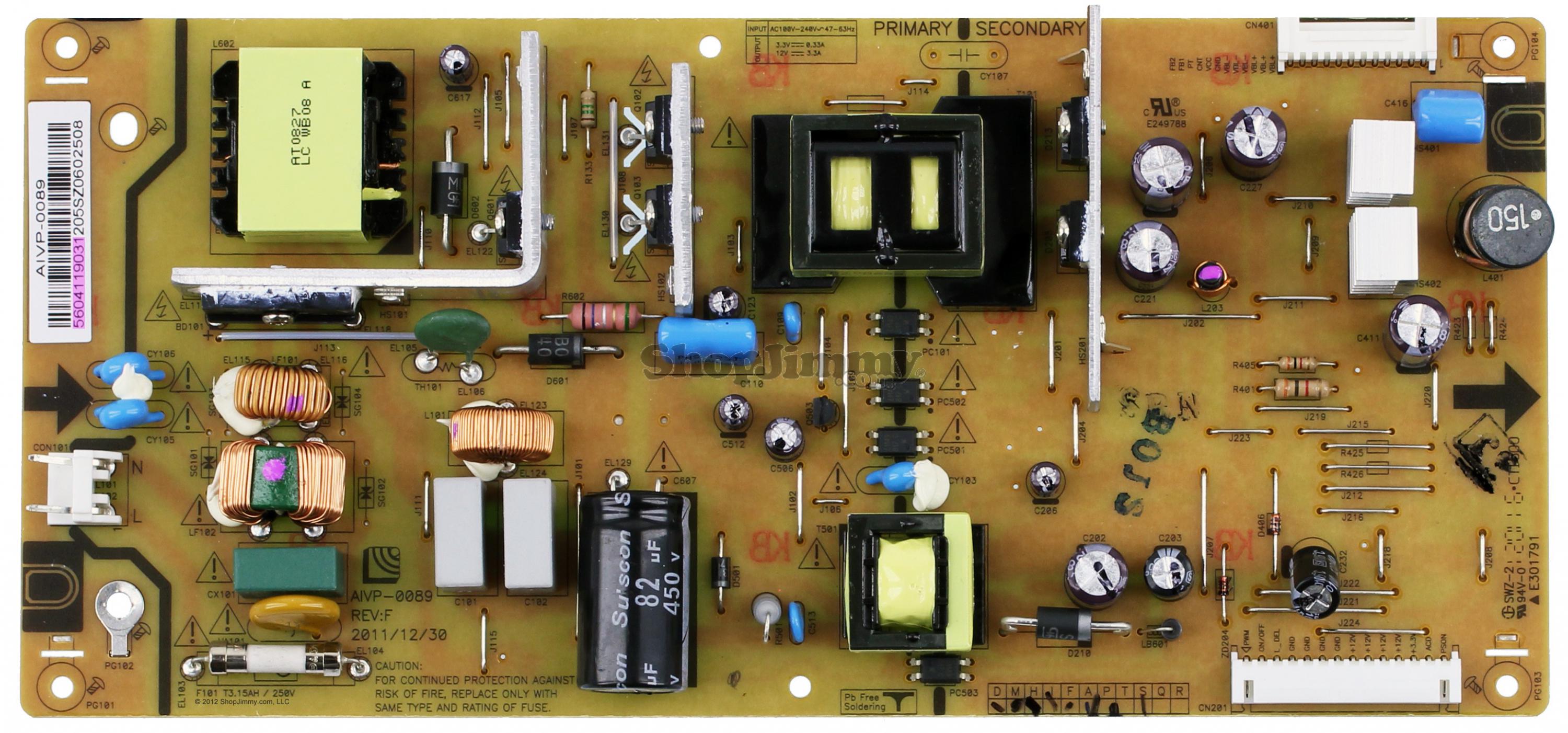

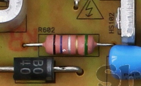

                        Re: Vizio E322Ar Picture Problem

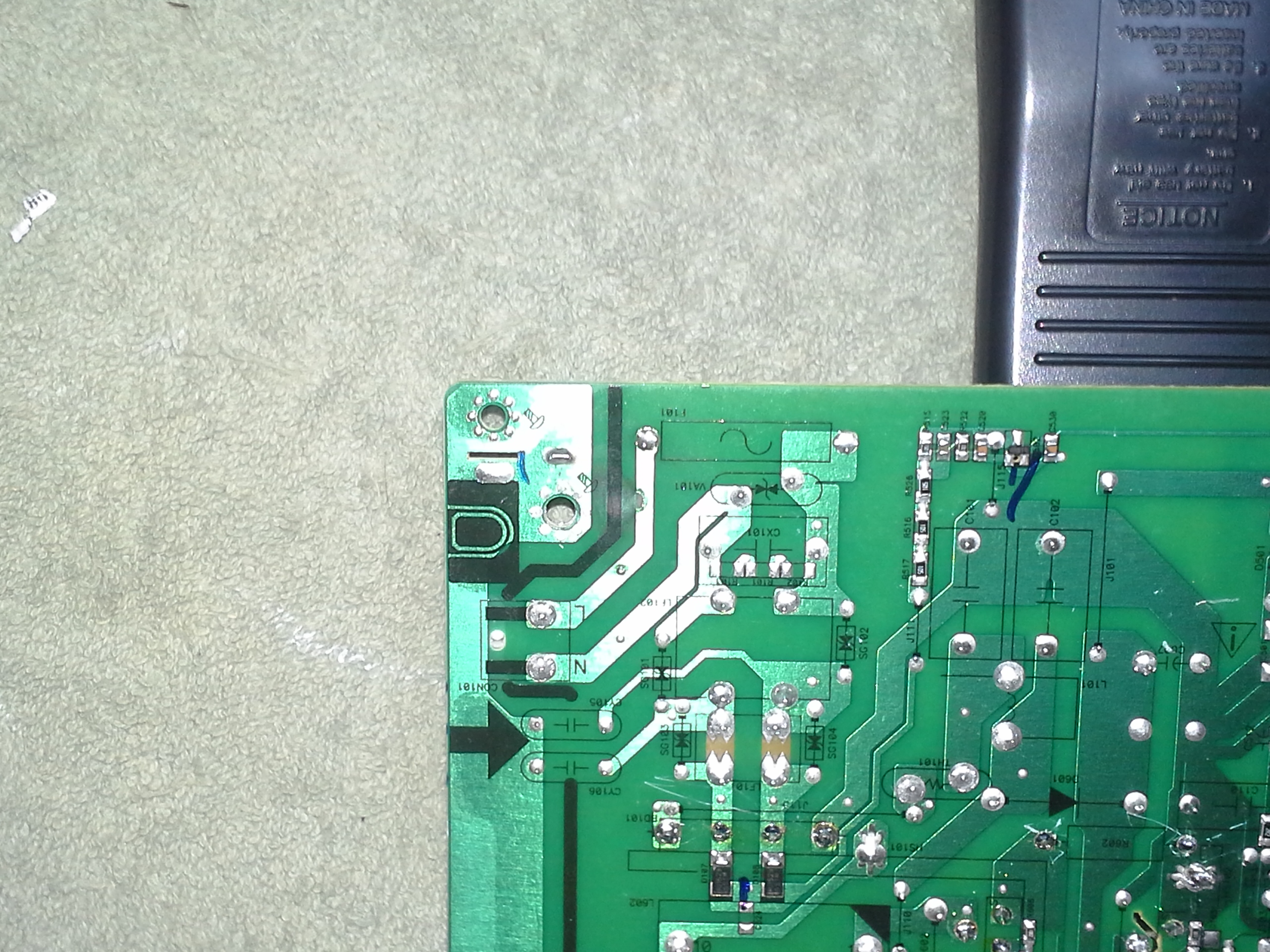

                        I have a problem with a power board on this same TV. The resistor in the picture tests at 000.1 ohm removed from the board. I'm having a hard time identifying the value. I think it's supposed to be 6.8 ohm 1 watt. The body is 10mm x 4mm dia. The color bands are hard for me to decipher. The board is # Vizio 56.04119.071 (AIVP-0089) Power Supply. I would like to get a schematic also . Can anyone help me with this? E
                        The resistor is is pink one in space R602
                          The colors on mine are Black,Blue,Silver or Grey?, gold,green
                            #33
                            You should set you meter to better resolution to read <1 Ohm resistor.
                            You also need to find out what your meter probe resistances are.
                            If the resistor does not not show as open circuit and show <1 Ohm then it is good. Doubt that this resistor is the problem.
                            It is fusible resistor for feed the Q102, 103 MOSFETs for VBL SMPS section.
                            What is this power supply or the TV not doing?

                              Thanks for the reply. I will post more info when I get home from work. E

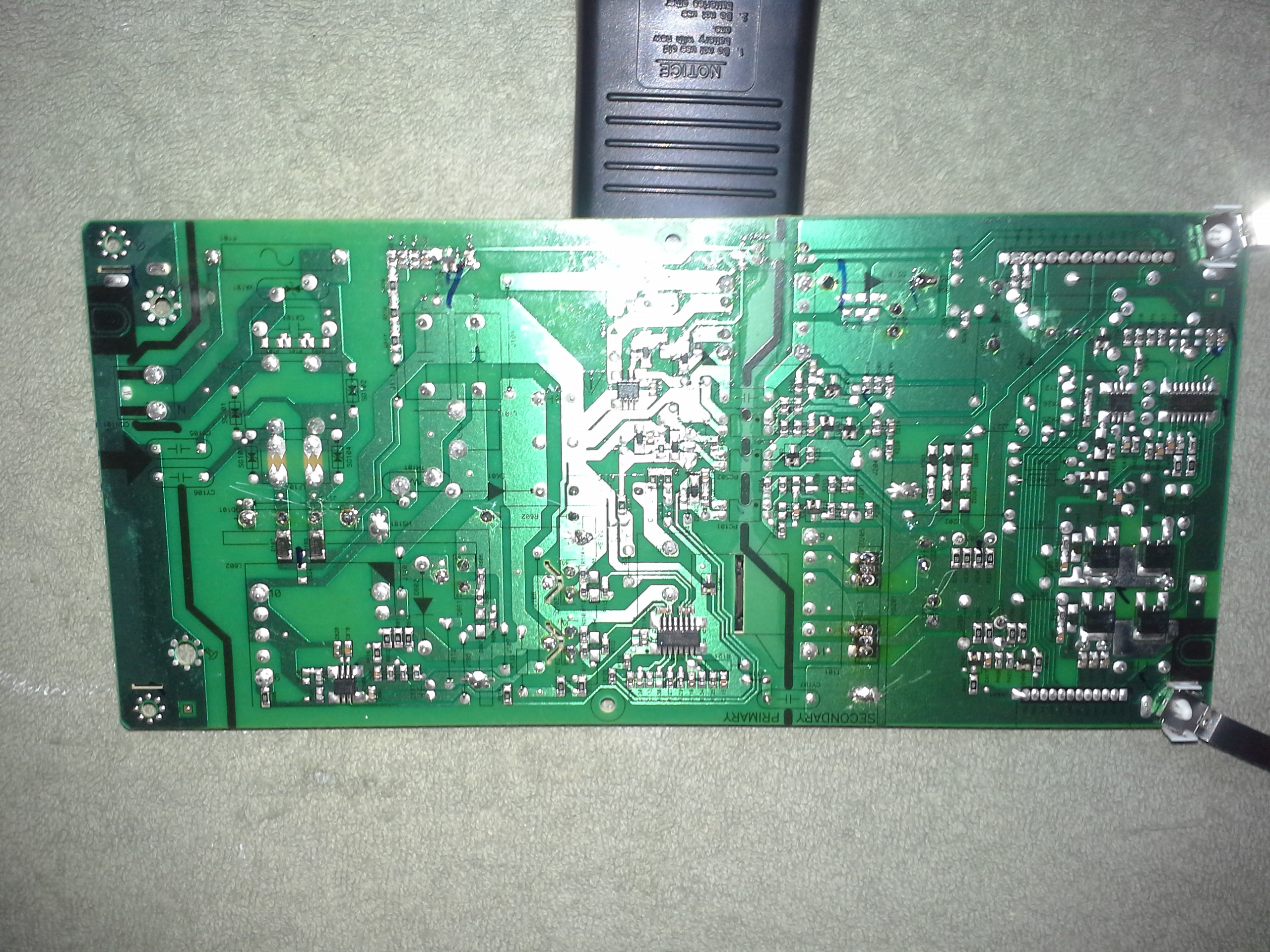

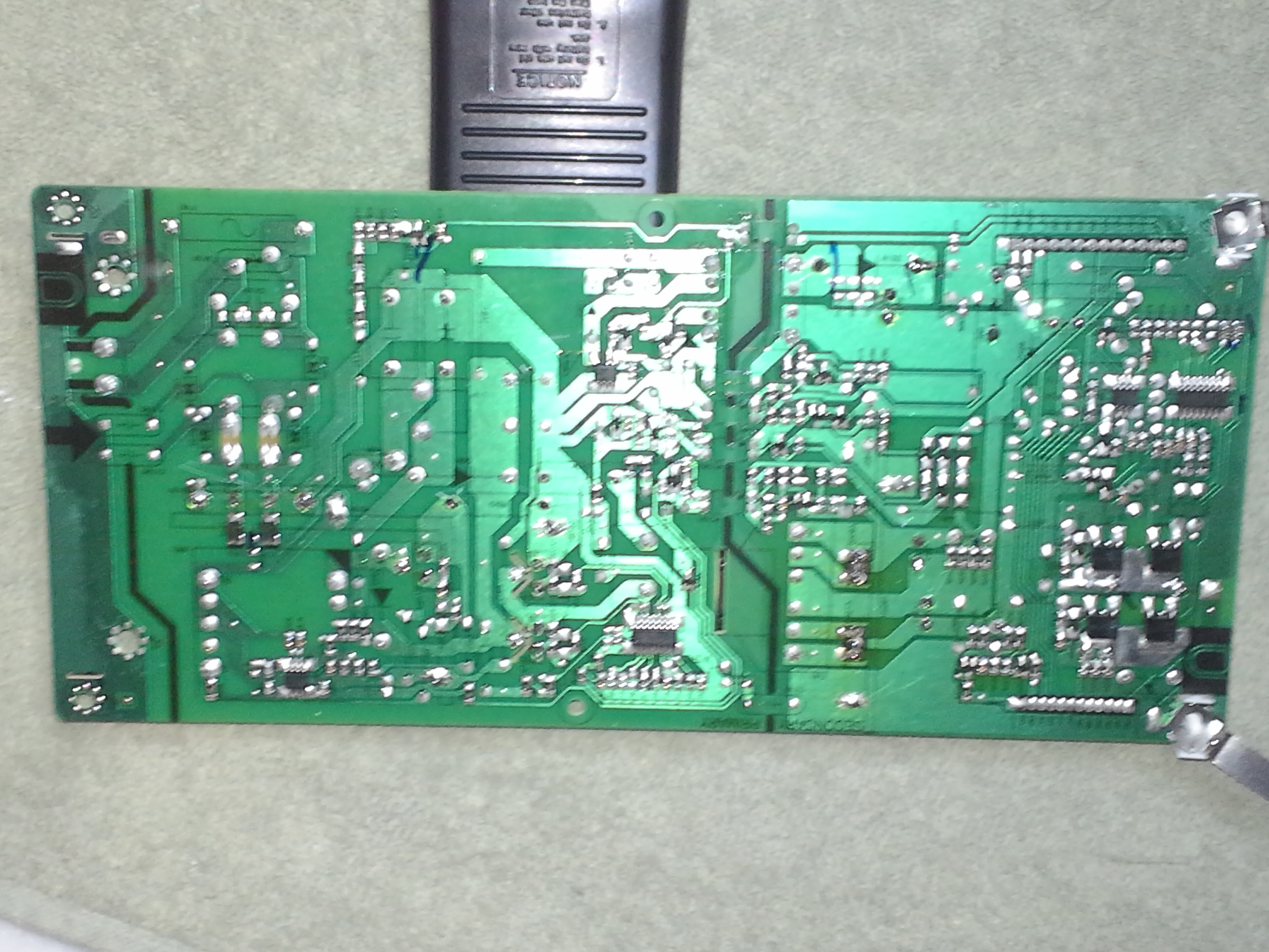

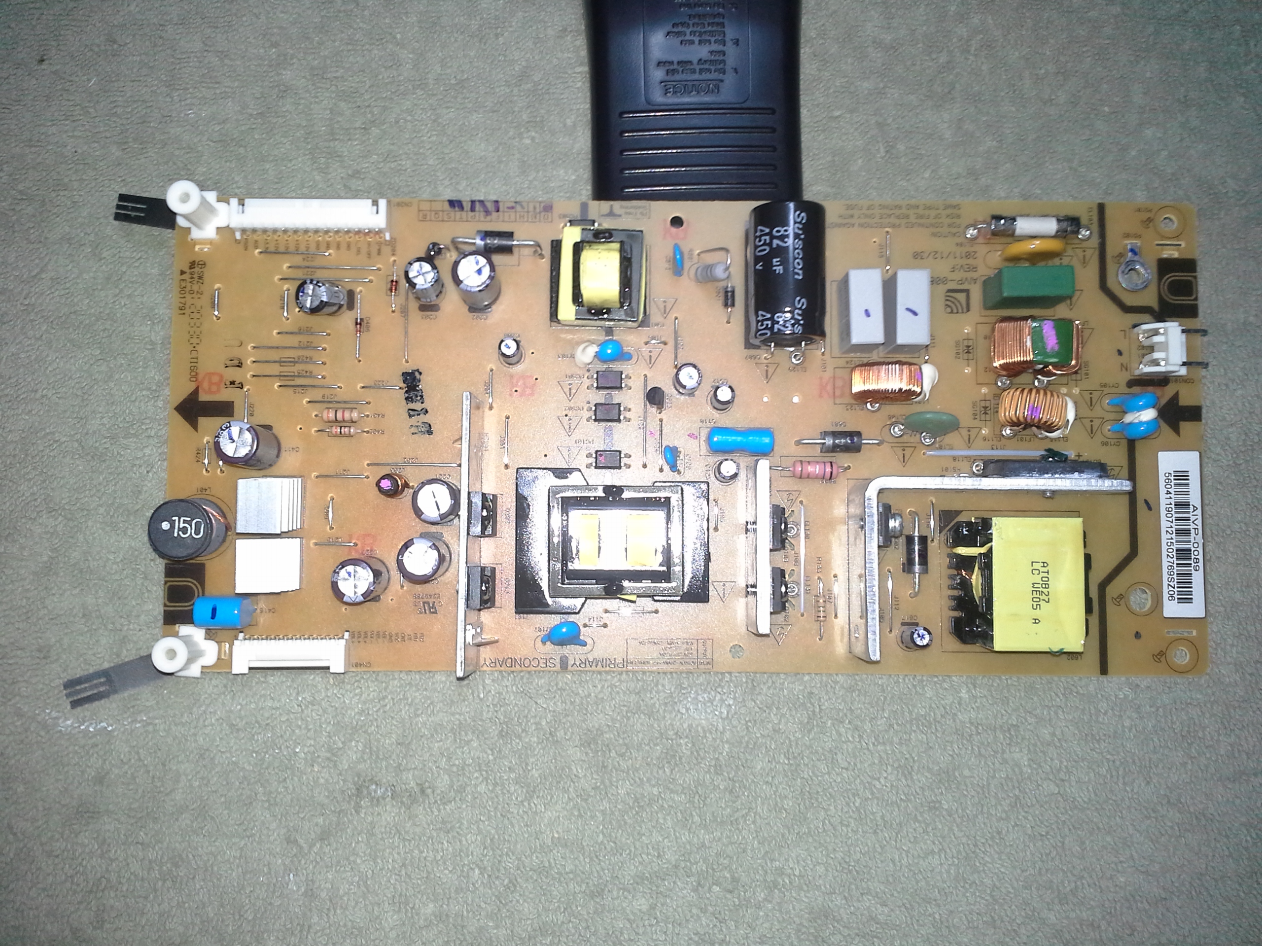

                                #35
                                My skills are limited to testing and replacing components trying to learn as I go. Before I found this forums I removed all the larger caps and diodes and tested,all read good. I removed the mosfets and tested on off with the test leads, all tested good. Removed and checked rectifier and power transistors using diode and resistor settings ,good. I have 168vdc at the rectifier at the output pins I get varying volts between 1.3 and 2.9 vdc. This board took at voltage hit of some kind, probably lightning since this Florida. I started testing the surface mount resistors yesterday and more than half test bad.I have no experience with these type of resistors. Can that many be bad? One will test bad and the one right next to it tests good using the resistance setting and varying ranges to be sure.Am I testing them wrong ?
                                PIC 1 my board back
                                PIC 2 burning spot from voltage spike ?
                                PIC 2 my cheapy meter I got to replace my broken one
                                PIC 4 my board front
                                PIC 5 my board back not blurry (Don't know how to delete and replace pics)
                                • EGreen
                                  • Dec 2014
                                  • 33
                                    From Budm
                                    No standby light no power
                                    • EGreen
                                      • Dec 2014
                                      • 33
