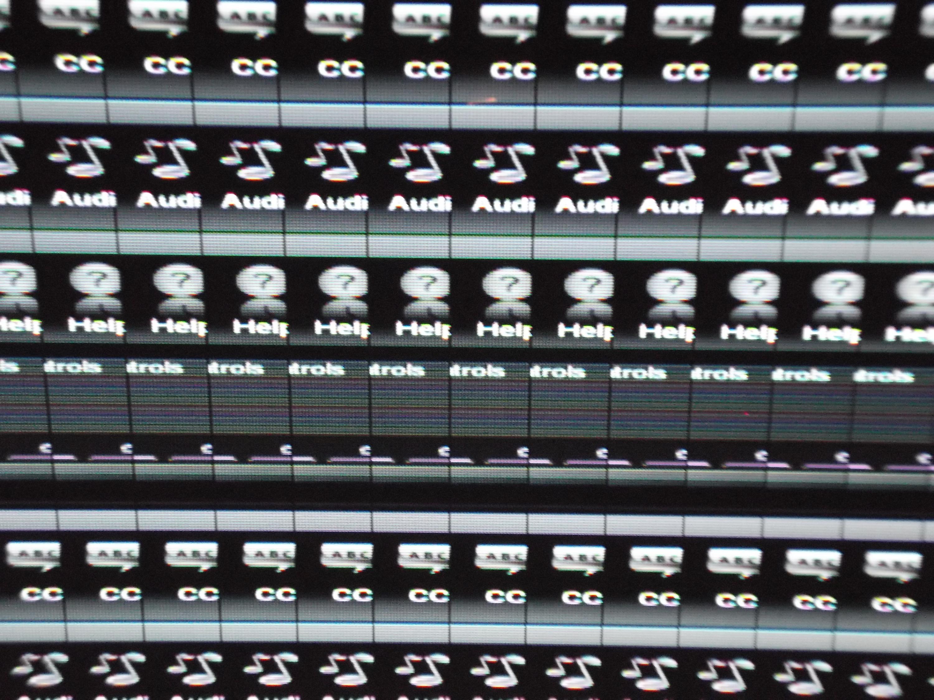

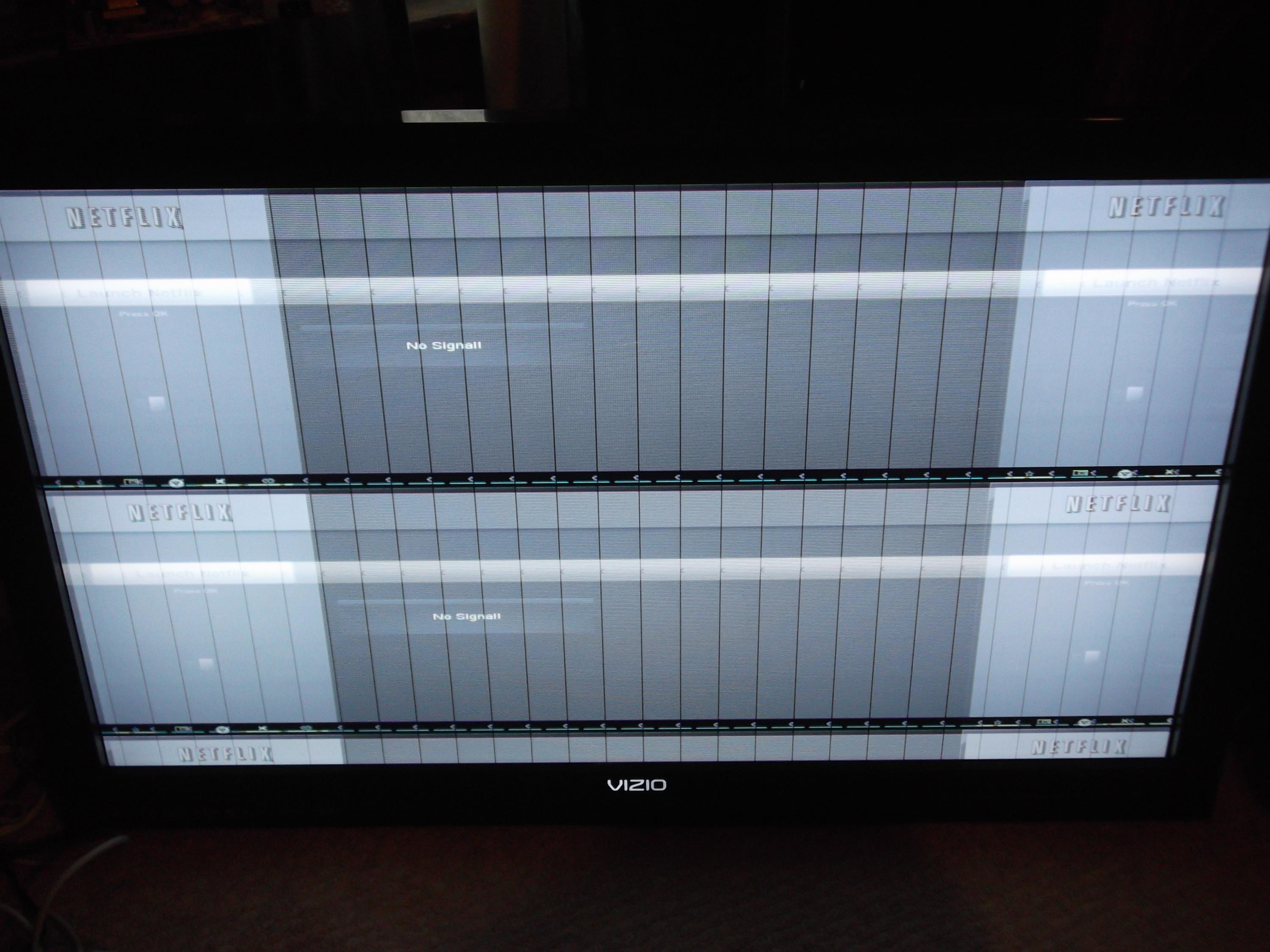

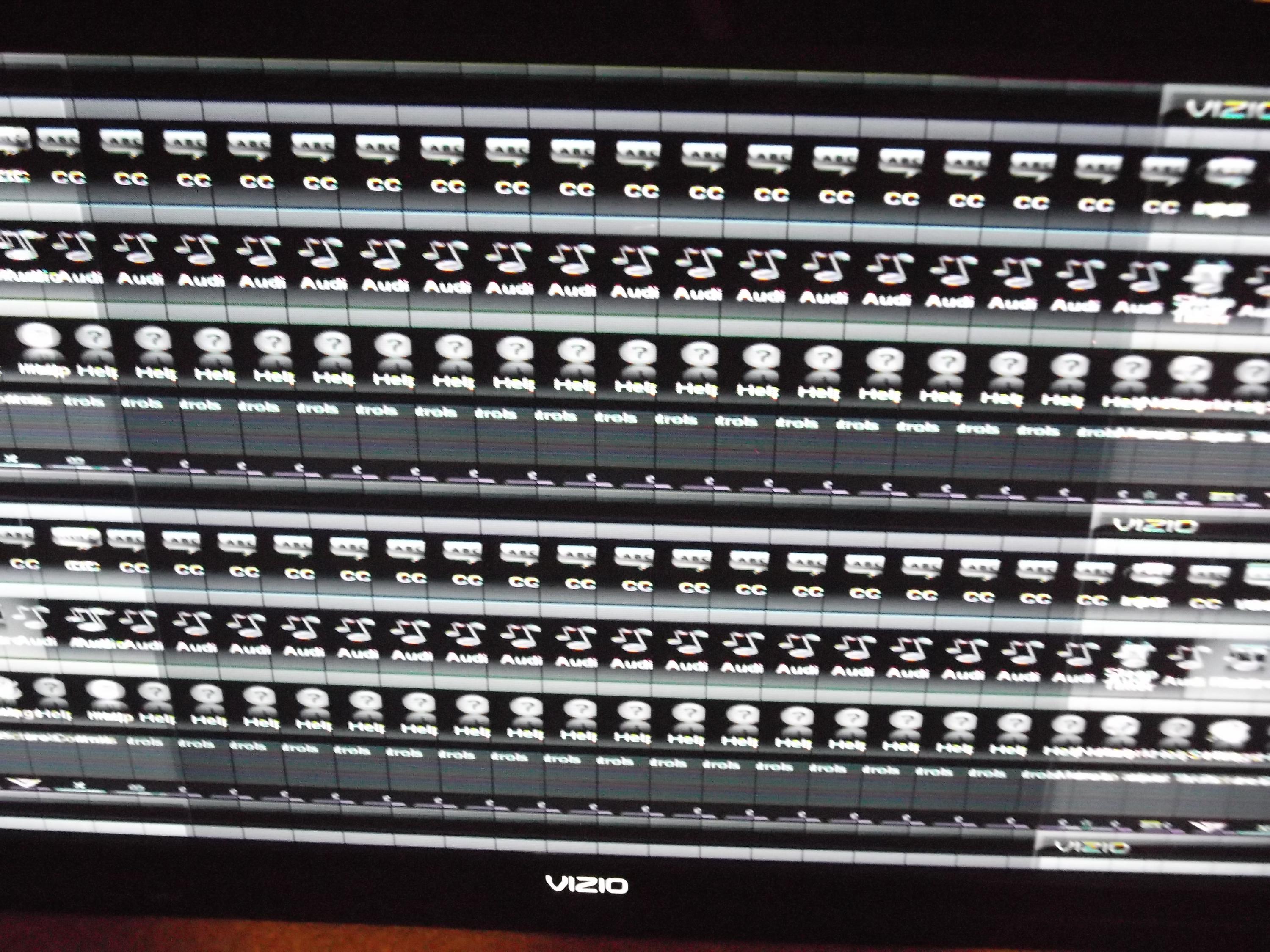

I have this tv that has a problem I have never seen before.It looks like 20 or so different images. All voltages check out. I have attached pics. and any help would be great. This tv doesn't have a separate tcon board. Thank You in advance for all your help.
Vizio E322Ar Picture Problem

did the tv do this out of no where ? or did it slowly happen ? usually if the display is starting to go you will see black lines over a normal image and they will get worse and worse so i would think its a board if it kind of happened out of no where
does it do it in all the different inputs ?

I tried cleaning and reseating the cable already. Yes it does it on all inputs, as soon as the tv turns on. There is no point that the pic. is good.
I can not tell you when it started I just got the tv.

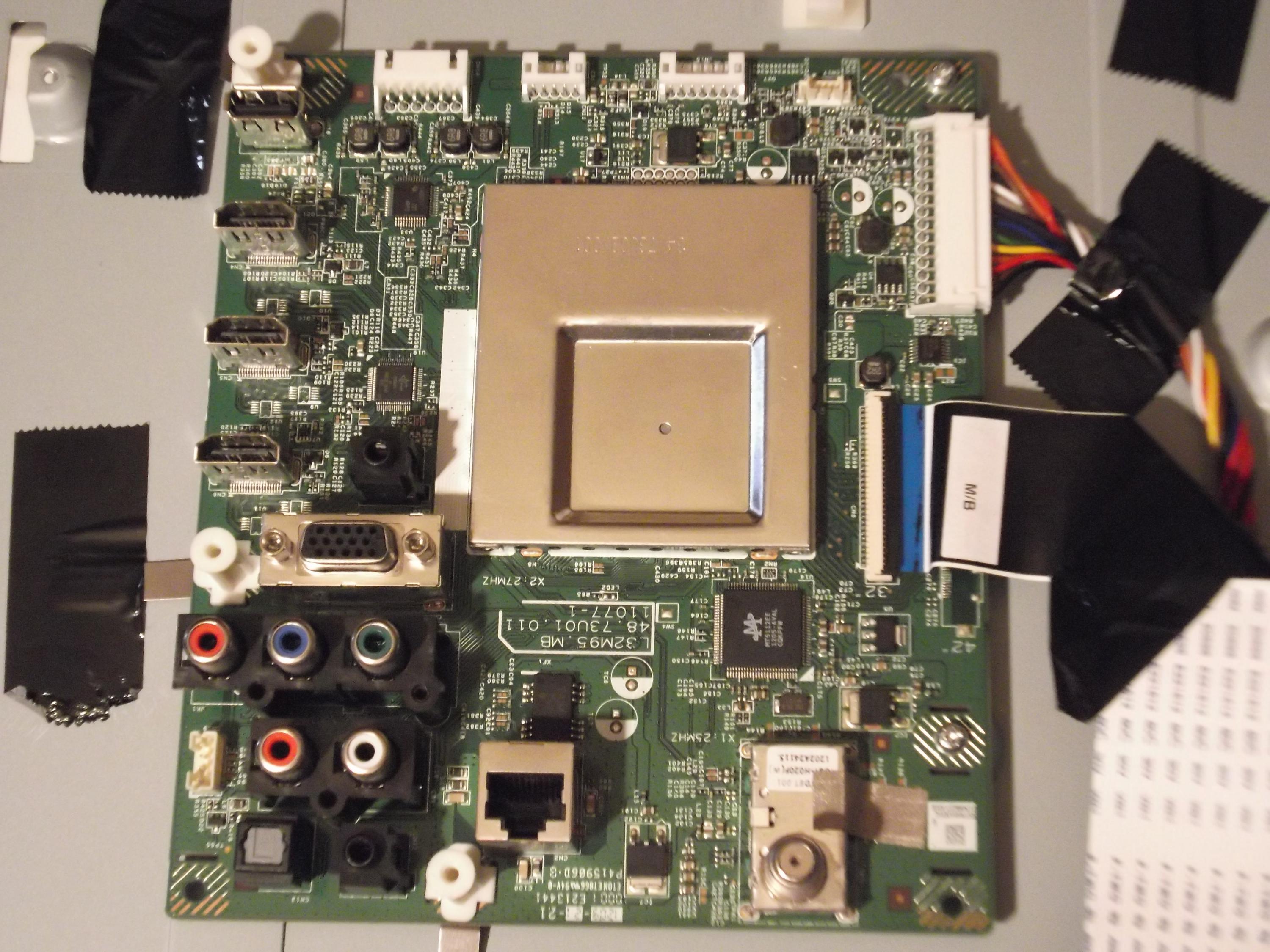

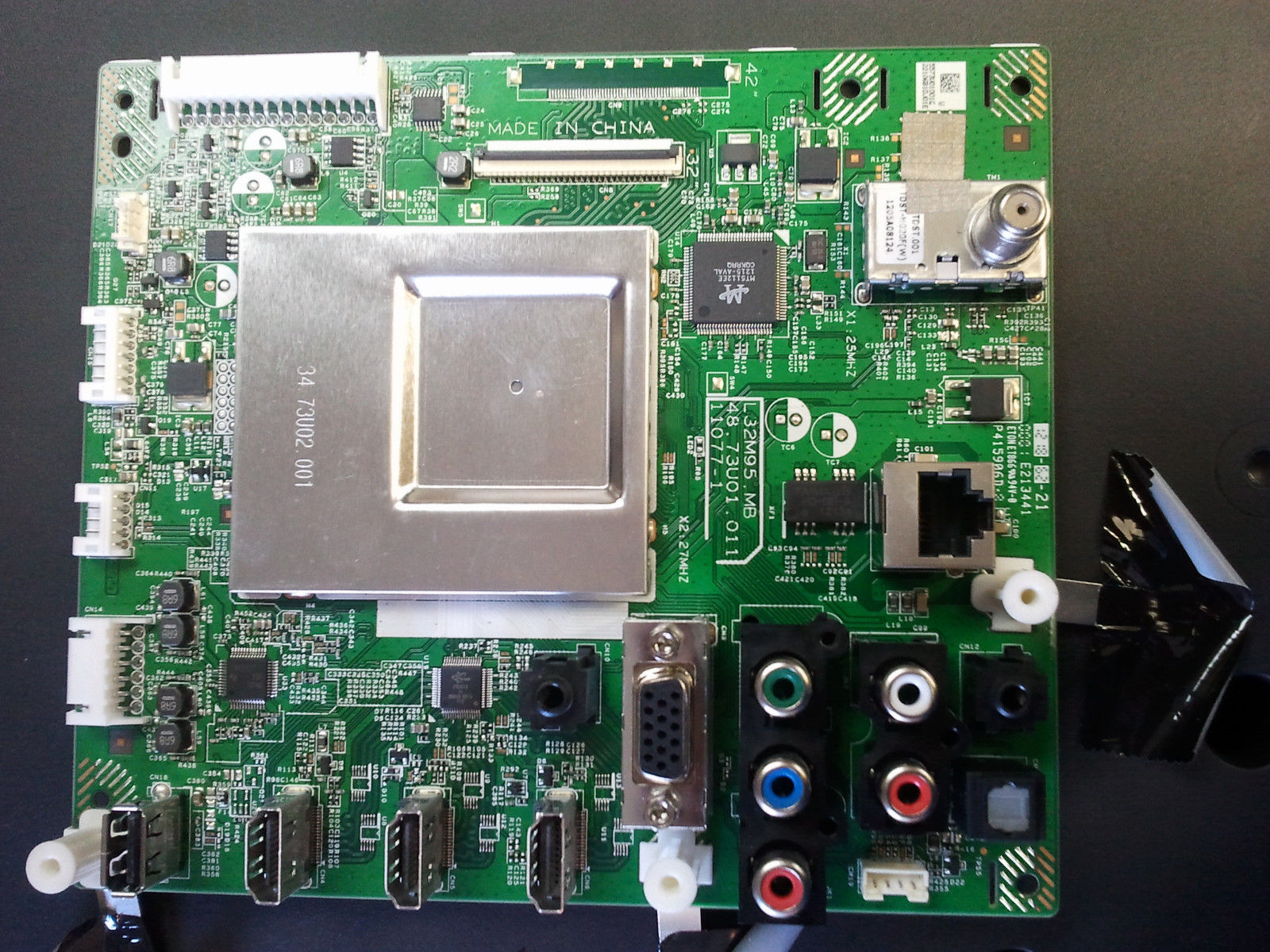

what do they look like - pics are not quite clear enough for trouble shooting but
there looks to be 2 VRs just below the ribbon cable socket on the main board.
Did you clean and reseat the other end of the ribbon where it goes into the panel - no board at that end?Please upload pictures using attachment function when ask for help on the repair

Can you get at the panel board for a pic of it?Please upload pictures using attachment function when ask for help on the repair
