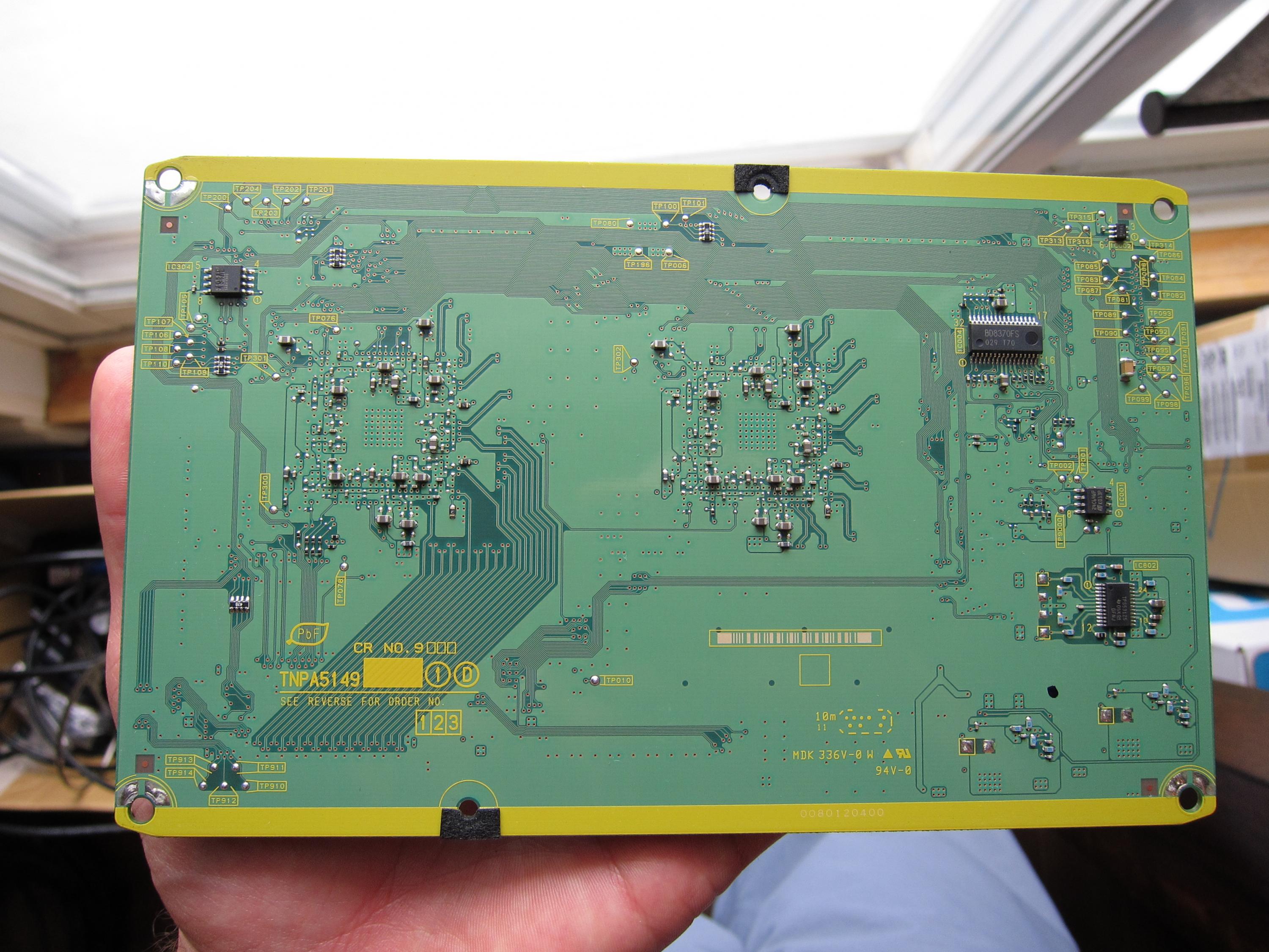

      IC304 looks like SPI flash - probably has the panel S/W on it. Doesn't look too hard to transport from one board to another. IC001 is an eeprom probably for panel hour count among others, used to adjust drive patterns as panel ages.
        Re: Panasonic TC-P54VT25 _1 Blinking Code
        Originally posted by Frank3y3 View Post
        Don't see any of this under the D-Board on the VT25.
        When i'm finished with this/that TV, I may wanna put it in the garbage afterall. Can't seem to find the problem god damn it. But if the TV still works, the problem must be somewhere.
        What I see is exactly what I expected, 2 chips that store data.
        One is even marked with the firmware version loaded. TVRR491.
        That's the panel data and will be different.
        If you opened the service manual and find, ic9304 & ic9001 you could get from the parts list the part number which is the firmware loaded to each.
        Then you could download the service manual for free from tosee if both are different.
        you should then find that in the 50VT20
        IC9001 TVRR477S
        IC9304 TVRR490S
        In the 54VT25
        IC9001 TVRR478S
        IC9304 TVRR491S ( you can see 491 stamped on the chip in the photo)
        Swapping both those will change the D-board to suit each model.
        If the fault is caused by one of those memory chips it will transfer across to the new board.
        This i proved when i did my A board conversion and discovered a bad IC9304 was producing SOS1 in my instance.

          Back to the topic, so if i understand correctly, i can swap these 2 D-board in and out between 54VT25 and 50VT20 without any problem or damage. I'm not quit sure i've understand the memory thing explain by tw2005. Is a new memory will be loaded in D board 50VT20 once i've installed it in the 54VT25, that can cause de SOS1. If so, will it be corrupt or something and when I put it back in the 50VT20 will everything will be ok ?

            The data is on the D board, so swapping the D board shouldn't cause any one board to be reprogrammed to fit the other A board.
            The thinking seems to be 1 blink might be related to memory if it were permanent, but intermittent issues like yours are more likely related to the actual hardware.

                It should work, aside from my mention of panel picture issues - but no concern if you just want to see if you can eliminate 1 blink code.
                I think the fault may well be lead free solder on one of those large BGAs. The same cause as Xbox 360 "red ring of death" / PS3 "yellow light of death" and also a problem in some Panasonic gear. Shockingly common in all electronics, in fact.

                        I'm suspicious too and would try to prove it either way, hardware or firmware.
                        If this was my TV, I'd swap the D-boards and see if the the 1 blink disappeared.
                        If it did, I'd swap IC9001,IC9304 across to the 50" board and see if it was still ok.
                        If it was then that would confirm the hardware was bad on the original board.
                        If the fault carried across, bad flash IC but combined cost of both chips are showing for under $20USD so I'd get both to be safe.
                        But it's not mine and I have not played with a 3D or that D board so a fair amount of untried theory.
