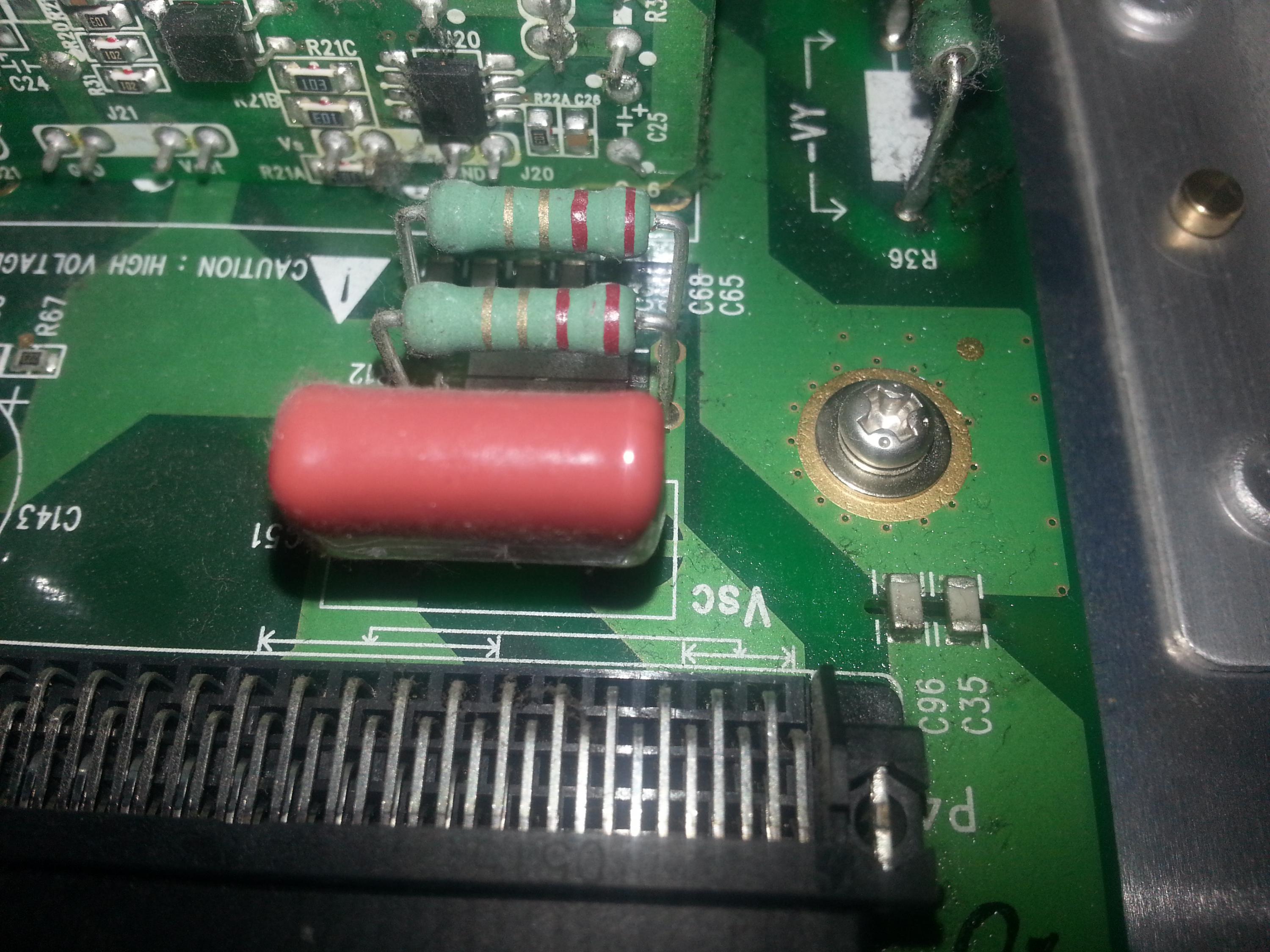

                  Re: L.G. 42PC1D, dark flickering pic.
                  Here ?
                  • Alastair E
                    Chief Womble
                    • Mar 2013
                    • 1963
                    • U.K.
                    #69
                    Thats it--Measure across that red film-cap.....
                    BTW--Adam--If you decide to scrap that 42PC1DA, I'll buy the faulty boards off you to do some more experiments on the IPM's--Or if you replace the boards I'll buy your old faulty ones--so long as they aint too much!.....
                    --I dont want to mess too much with my set as-is, because its working well.....
                    TELEFIX
                    • adamp91gvm
                      • Jan 2014
                      • 706
                      • uk
                      #70
                      I have its above

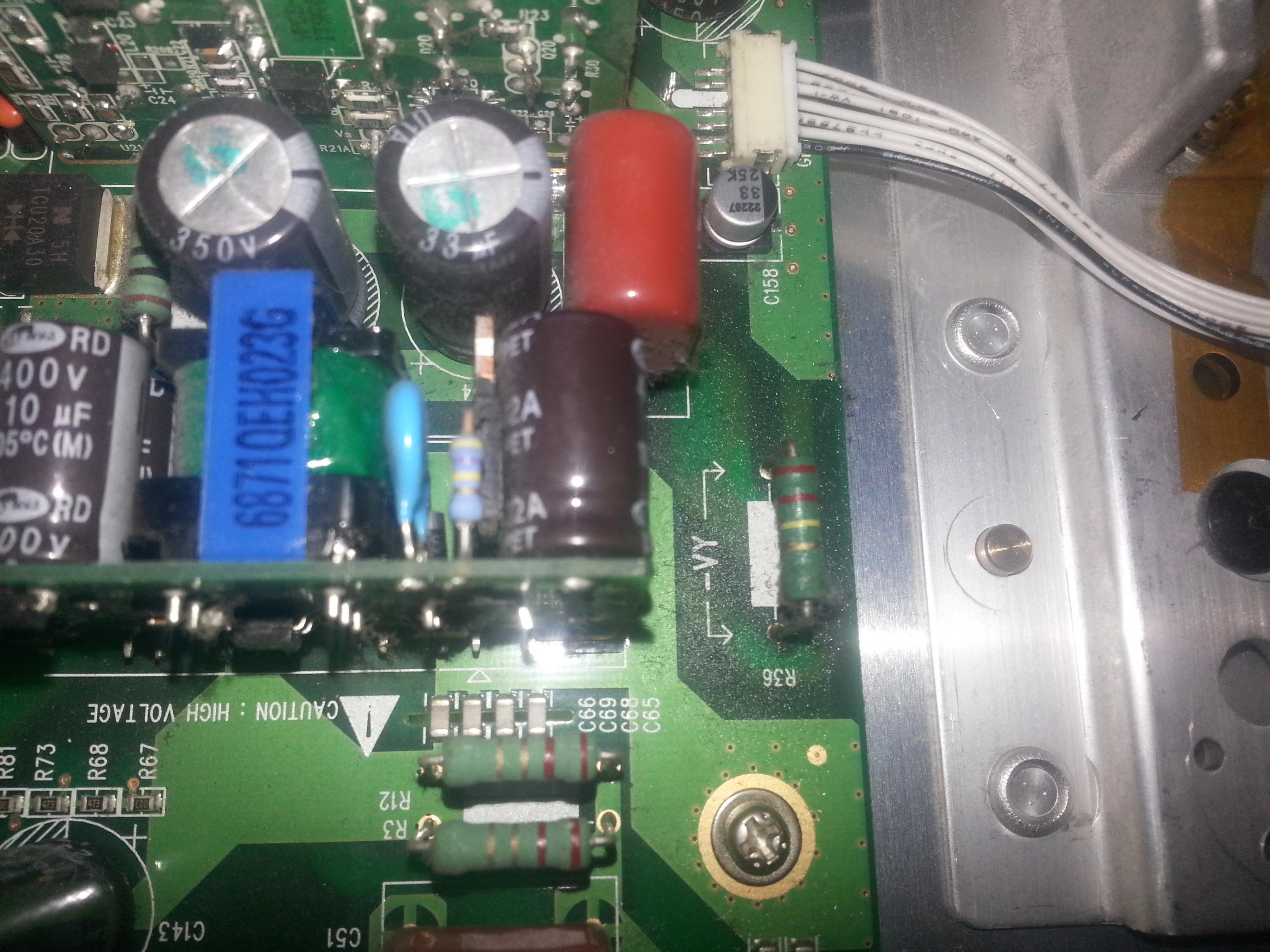

                                  #76
                                  One of the red packs ?
                                    #77
                                    No... the little PCBs that have a transformer on them, one for -Vy one for Vsc
                                    • adamp91gvm
                                      • Jan 2014
                                      • 706
                                      • uk
                                      #78
                                      Ahh the ones that are vertical off the board
                                        #79
                                        Yes. I don't think they're interchangeable unfortunately, you would need to find a Vsc pack for Vsc replacement.
