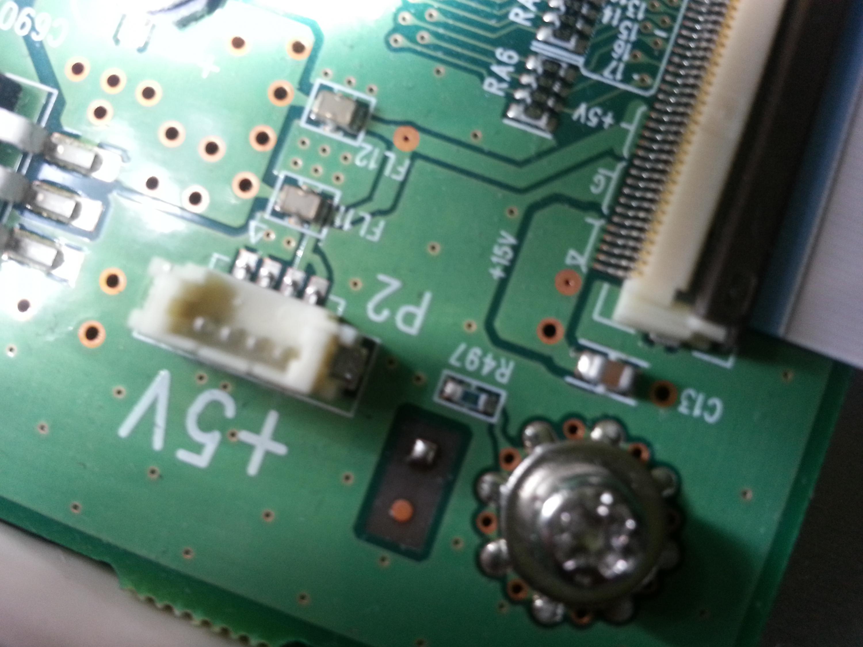

      I'm getting 8.89v max the the t con I thought it should be more than that correct me if I'm wrong
      • Alastair E
        Chief Womble
        • Mar 2013
        • 1963
        • U.K.
        #43
        Re: L.G. 42PC1D, dark flickering pic.
        The 'CONTROL-BOARD' (T-Con is LCD!) should have 5V, not 8.8V to it.....
        Check at the vacant socket marked, '5V'

          #44
          Lol u know what I mean well it says 15v on part of the control board
          • Alastair E
            Chief Womble
            • Mar 2013
            • 1963
            • U.K.
            #45
            Err--15V --on the socket marked 5v...?
            TELEFIX
            • adamp91gvm
              • Jan 2014
              • 706
              • uk
              #46
              Just therr where the ribbon comes in
                #47
                Using AC or DC mode? You should use DC mode. Also check multimeter battery, low battery can cause bad readings.
                • adamp91gvm
                  • Jan 2014
                  • 706
                  • uk
                  #48
                  Dc mode checked the volts on a new battery and there correct
                    #49
                    What you getting (volts mode) each end of device FL11 next to that connector?
                    • adamp91gvm
                      • Jan 2014
                      • 706
                      • uk
                      #50
                      4.85v

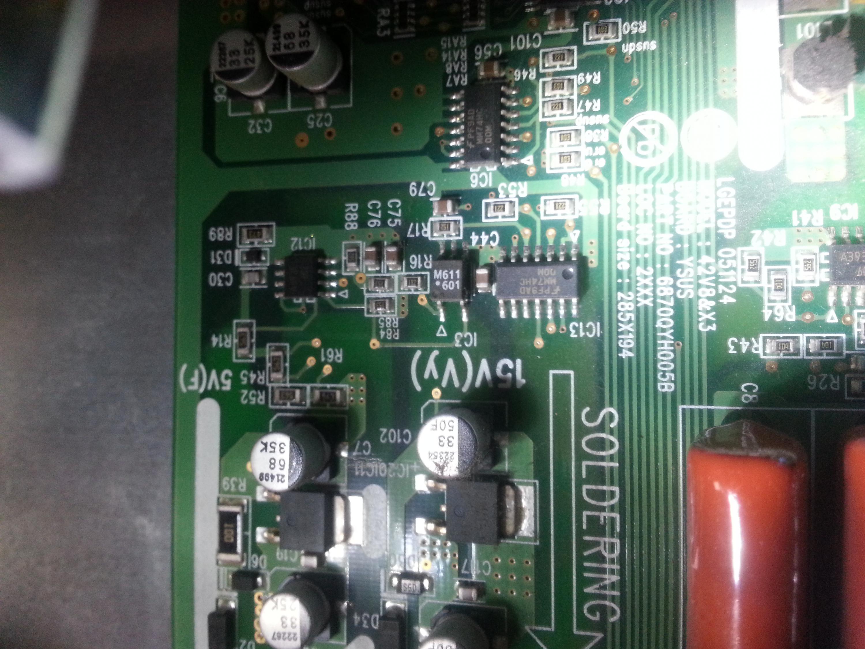

                              Looks like your 15V is low, that will cause problems. Can you see where 15V might be generated on PSU? Any 15V output on the pins?
                              Come to think of it - having only done one of these sets over 2 years ago - I believe the 15V could be generated by the Y-sustain board from the 5V input.

                                Yup--The 15V (two of them) plus an additional 5V rail are made on the Y-SUS from the 5V rail.
                                --Prob a faulty IPM dragging it down.

                                  #56
                                  Here ?
                                  • Alastair E
                                    Chief Womble
                                    • Mar 2013
                                    • 1963
                                    • U.K.
                                    #57
                                    Yup--But!
                                    These supplies ground--isnt ground, they are referenced to other supplies.
                                    You'll have to use the IC Tab as the ground when testing the voltage.
                                    --Suggest you remove board and supply it with 5V, Then test the supplies--for safety reasons.
                                    TELEFIX
                                      #58
                                      That's 15V relative to -Vy, if -Vy is around -190V it should measure about -175V (-190V + 15V)
                                        Dont think there's gonna be any -Vy, as the PSU shuts down.....
                                        These 15V supplies are pretty critical to the operation of the IPM's--they form the supplies to the high and low-side drivers, and if low will kill an IPM, due to poor/soft switching, and excess dissipation....
                                        No matter what--Replace all the caps around those three regs the 33uF caps, --use 47uF 50V the 68uF, use 100uF 50V, (both Rubycon ZL are recommended, just use a fair to good quality wire-ended, not SM types to replace) and don't forget the 330uF big one near the board edge--470uF is good for that these values I fitted to mine.
                                        --The 15V regs should easily supply a 5W 12V lamp to full brightness and full 15V--although do not test like this with board connected to set--ONLY by 5V from a separate PSU, board out of set.
                                        Still say the dead IPM is dragging down the 15V rail, leaving only 8V.
                                        TELEFIX
                                          #60
                                          Actually the 15V(-Vy) is for the PASS FETs and buffer board. Buffer board logic is run from 5V linear reg off the 15V(-Vy). IPM 15V is relative to normal chassis ground.
                                          Low -Vy would generally point to a bad buffer board though it's possible for an IPM to cause this fault too if the SUS or ERC node is shorted.
