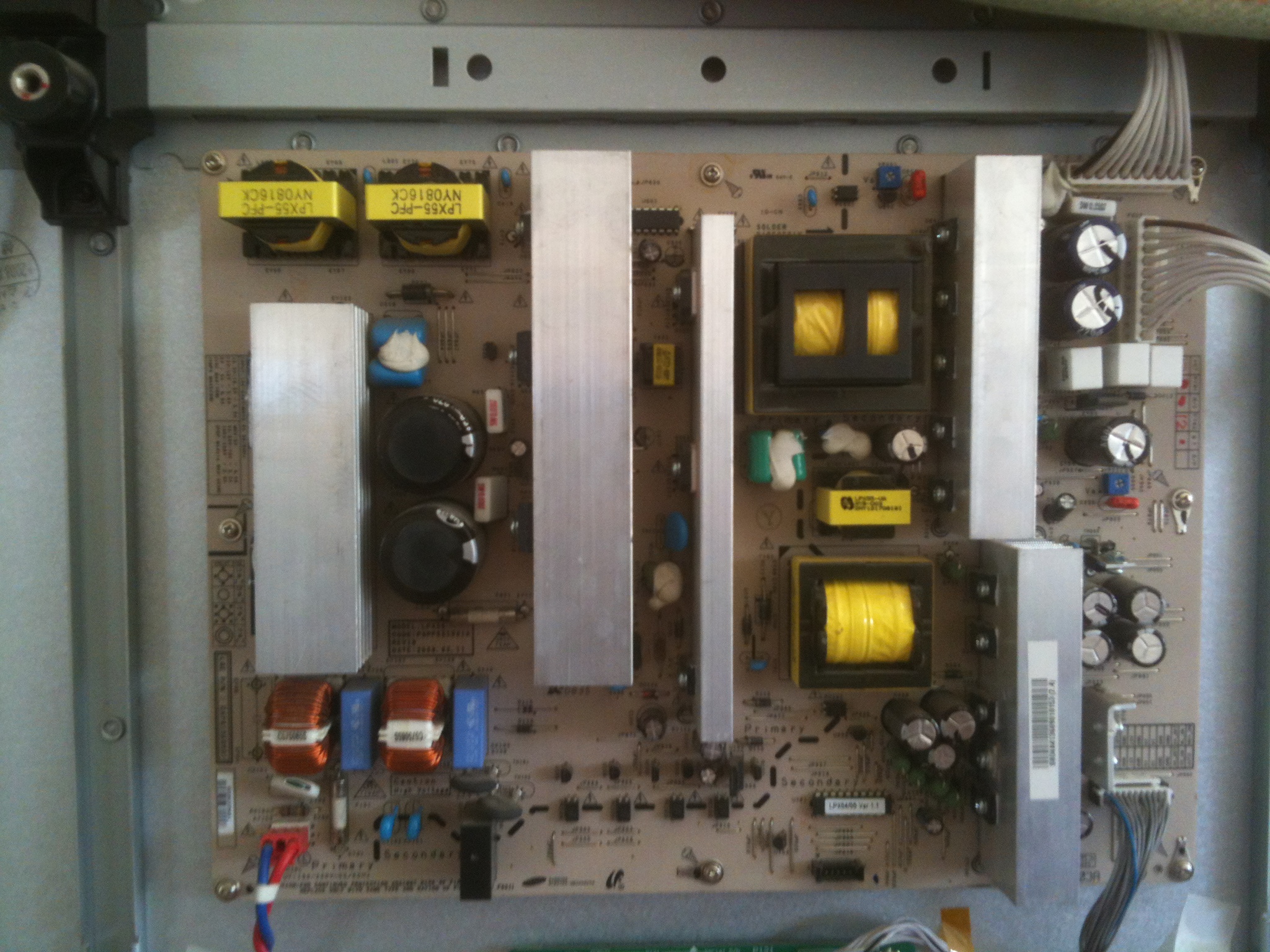

    The outputs of the Va & Vs are as follows... Va: 60 shows: 60.6 - Vs:194 shows: 194.5
    Isolated PS and Have done a static load light bulb test on it for 15 min and all voltages good

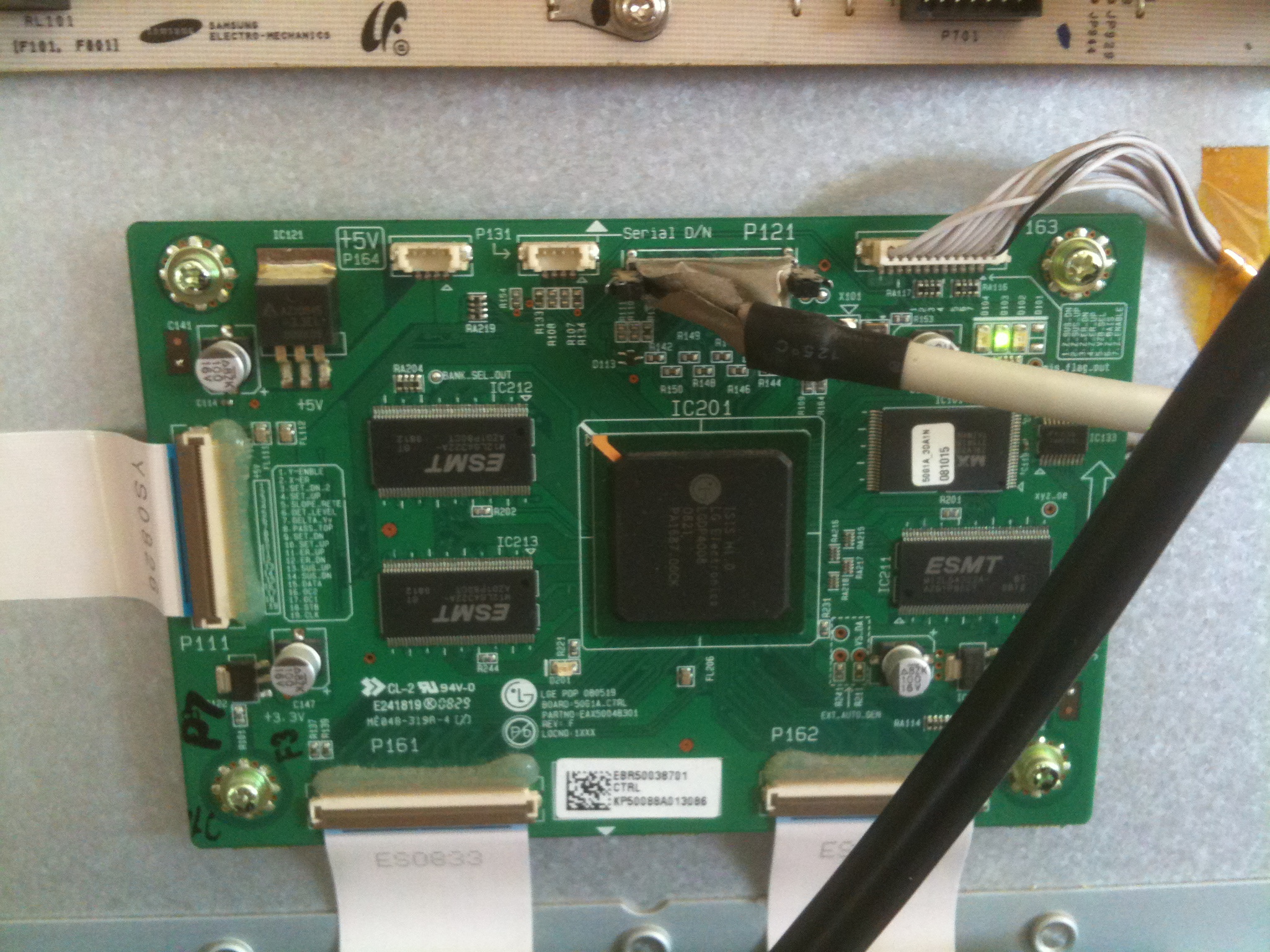

    I have isolated the Control board and checked FL111 and FL12 all good
    I also connected 5v from power supply to IC121 pin 1 and all good as i can tell, middle lcd lights up.
    Checked IC 121/151/171 and all seem fine

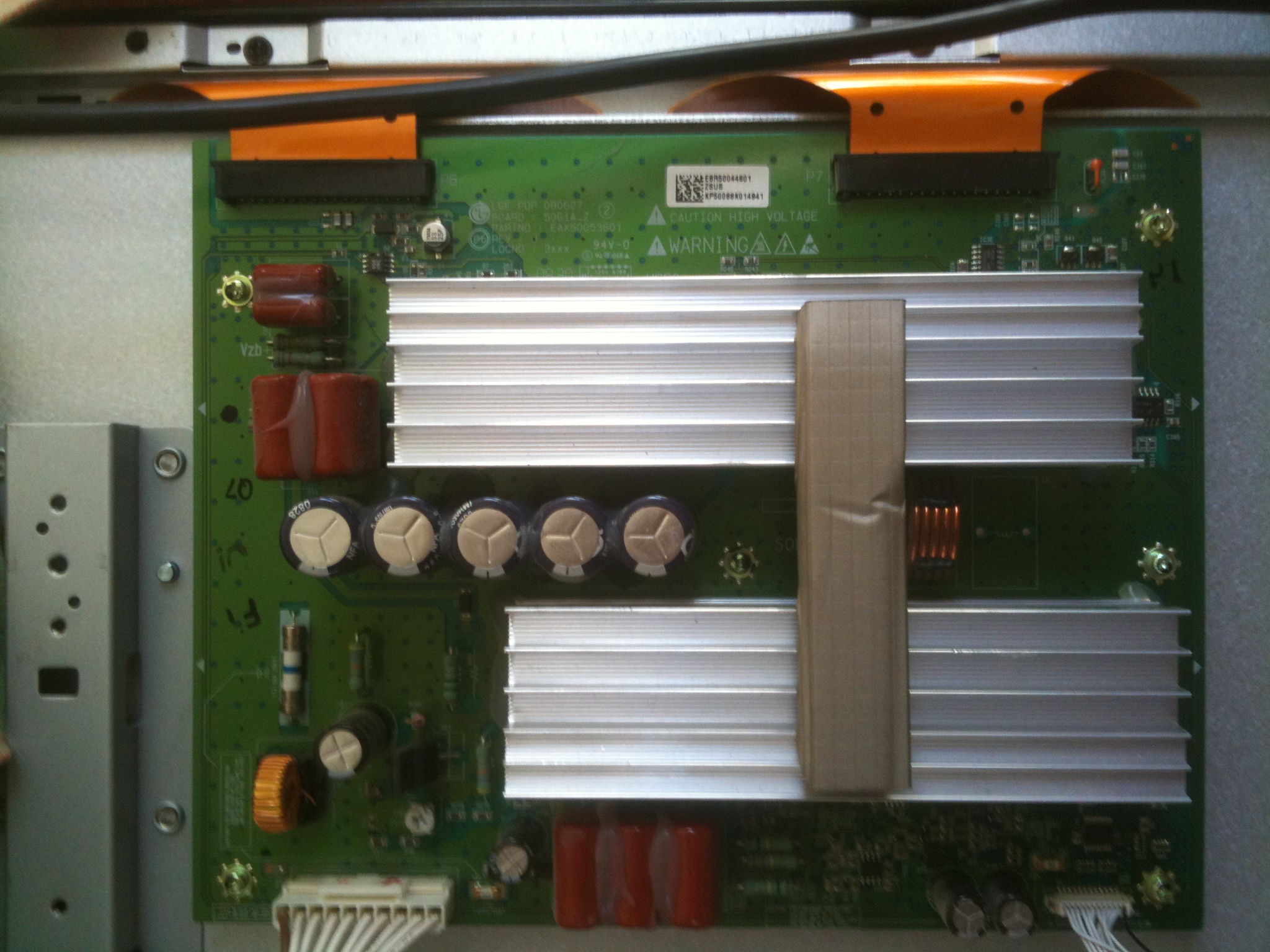

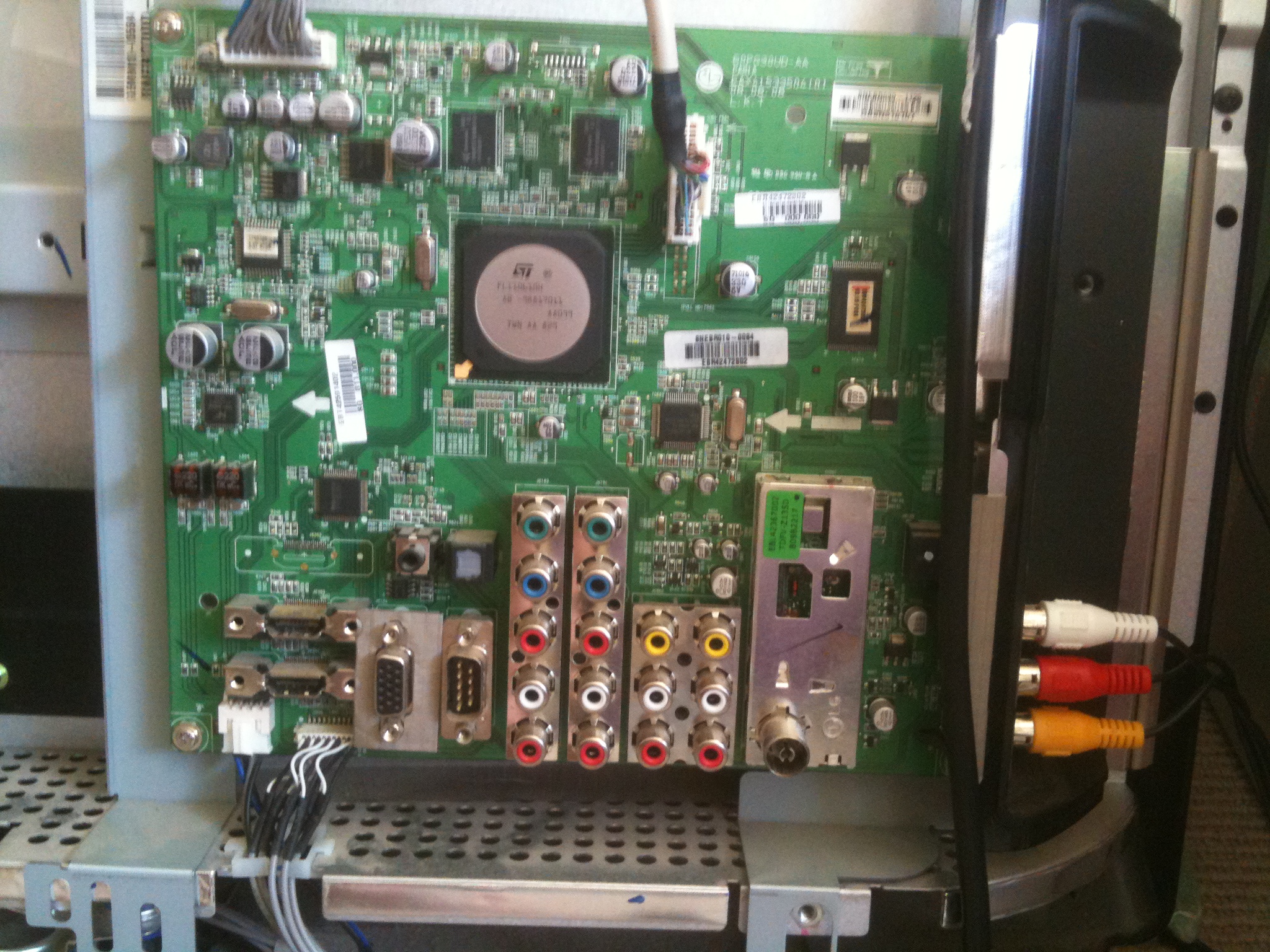

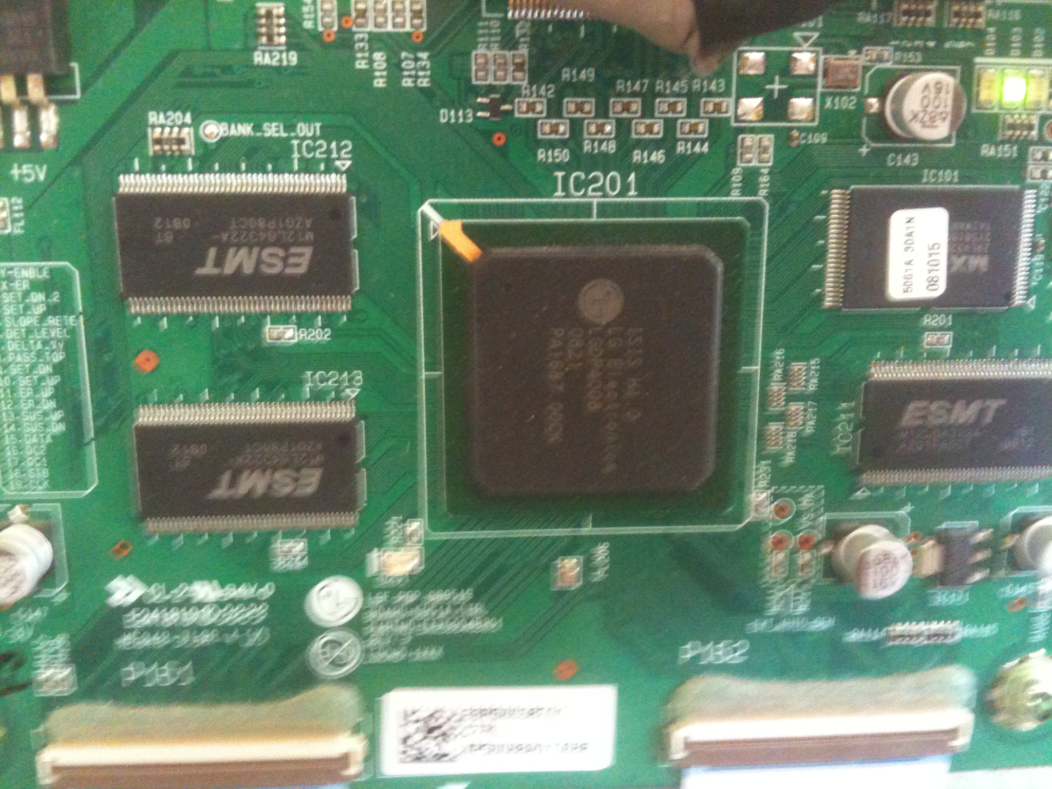

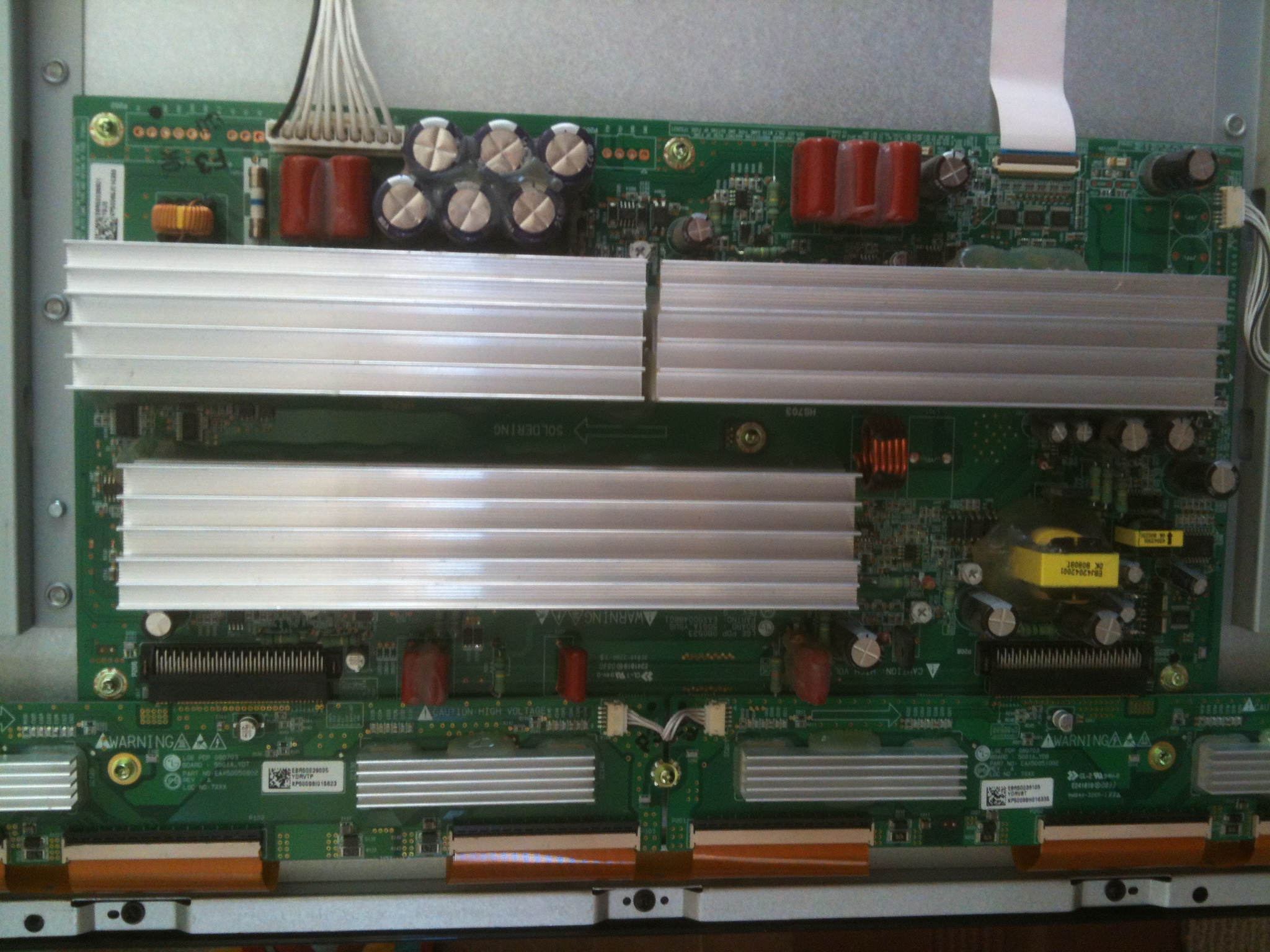

    Re: LG50PG20D Plasma which not showing picture but has sound!
    here are the pics of the boards while powered ...
        Hi Tom66, thank you for the quick reply, the Model no is PDP50G10343, attached are the pics of it.
                50G1 in this document.
                Check -Vy, Vsc per instructions.
                  Thanks Tom, -Vy is -.2 and Vsc was 0
                  does that mean Ysus board has gone?
                    i just had another look at the upper and lower buffer boards, i read somewhere that the correct way to disconnect them was from the Ysus board itself and not the panel, so i did that and...
                    Disconnecting the upper buffer with center cable attached = unrecognizable picture on top and white/grey screen on bottom which fades to dull grey
                    Disconnecting the upper buffer with centre cable pulled = only white/grey screen on bottom which fades to dull grey, heat sinks on upper buffer got extremely hot and YSus heatsinks got warm for the first time.
                    Disconnecting Lower Buffer with centre cable attached or pulled = NOTHING
                    i completely removed upper buffer and re tested the -Vy and Vsc and both fluctuate between 0 and 46v.
                    plugged a dvd player in and got a very garbled lower picture for a few seconds then tv switches into standby, turn tv back on and white/grey screen again, no garbled picture?
                    any suggestions anyone? Ysus plus upper Buffer??
                          Does -Vy, Vsc appear if buffer disconnected? Y-sustain fuse good?
                          • wezzo
                            • Jan 2014
                            • 13
                            • australia
                            thank you Tom,
                            -Vy and Vsc are the same with both buffer boards disconnected (reading fluctuate between 0 and 46v) Fuse is all good (measures 194.4 on both side and diode test with power off the continuity is good)
                              Bad Y-sustain with possibly buffer boards having damaged it, though that is rare nowadays.
