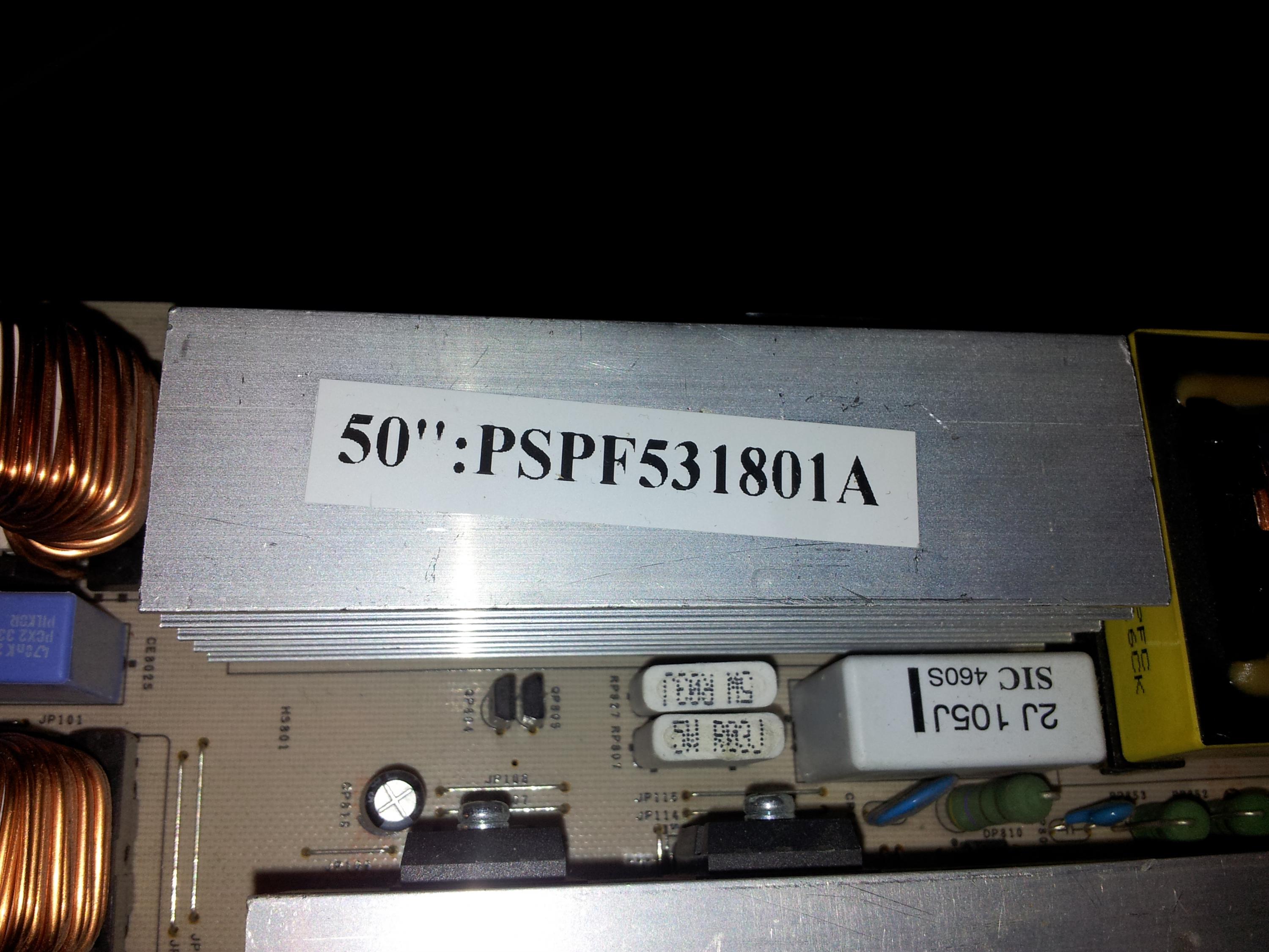

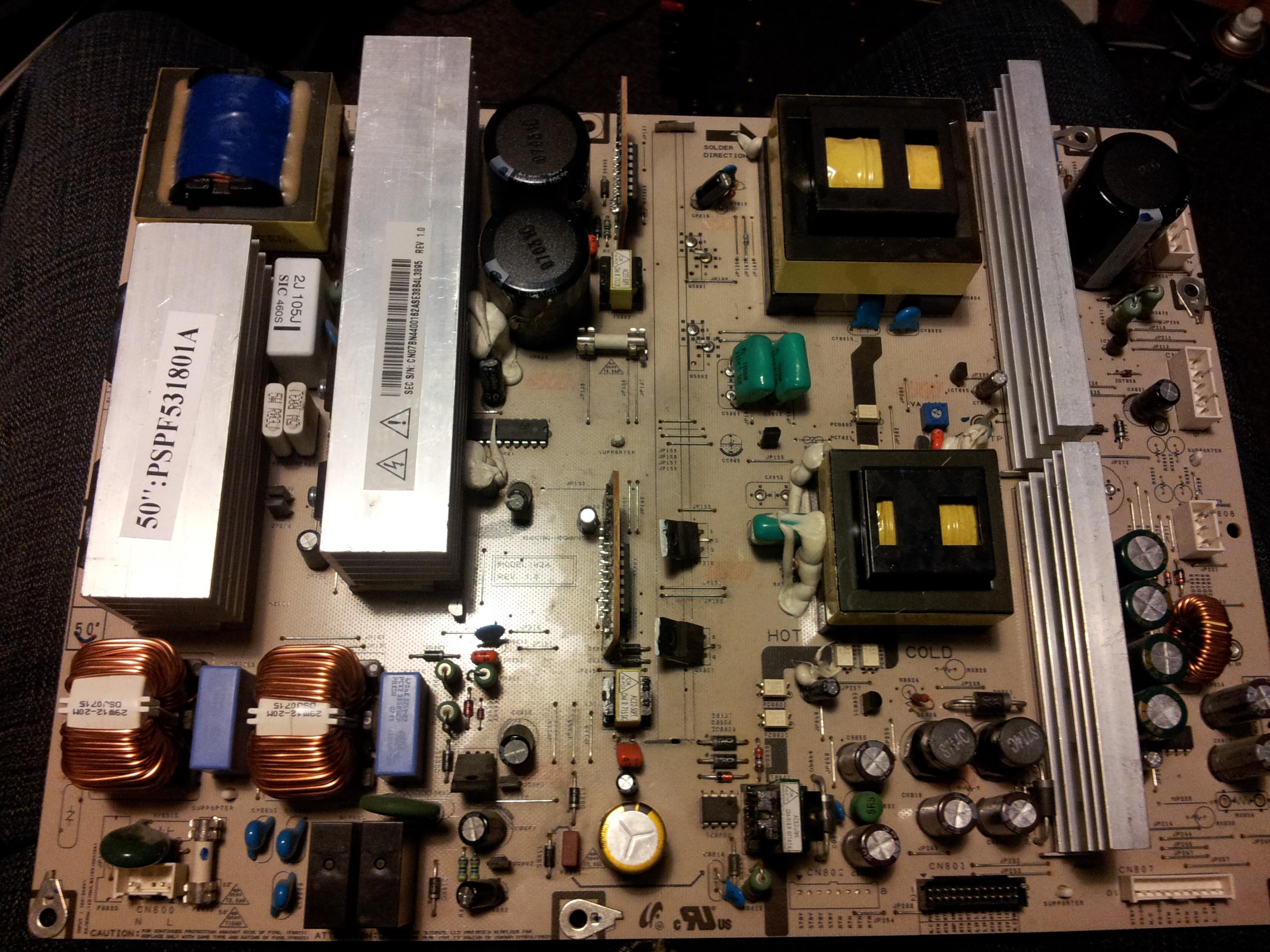

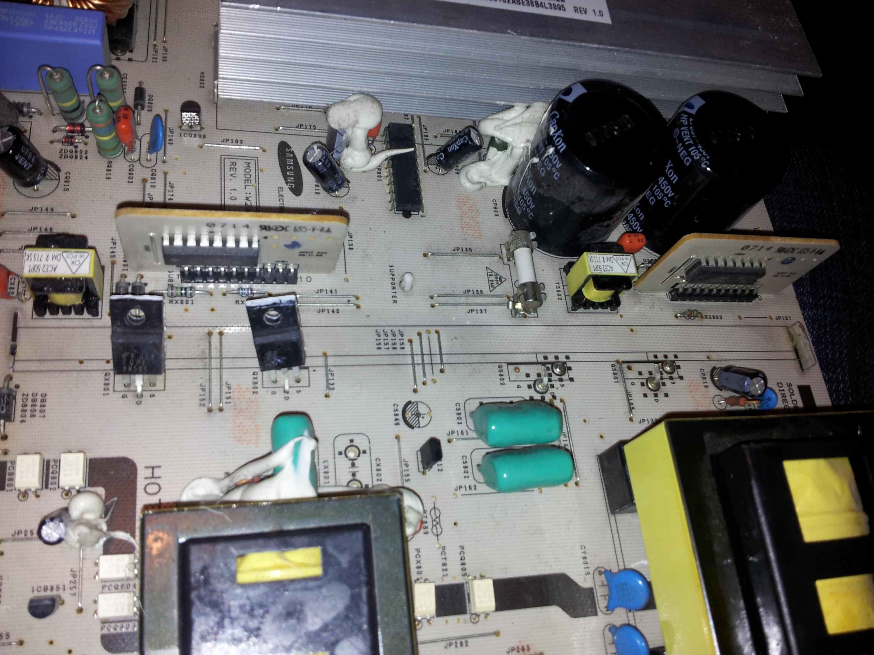

    Got this for FREE... thanks for the tip Vince

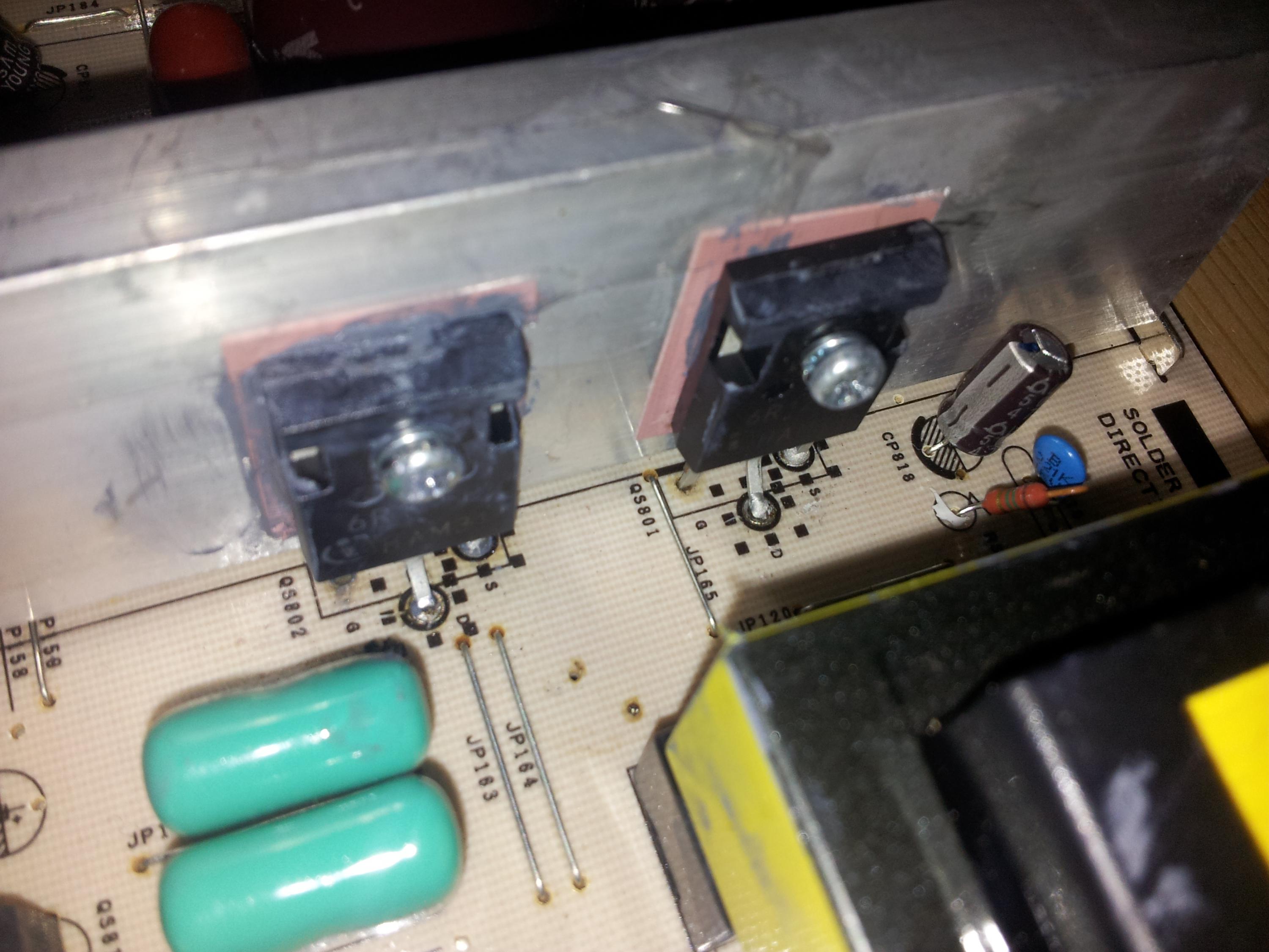

    Power supply has been MANGLED by some guy, but amazingly, the Y-main and Y-buffer all look OK... I managed to get a completely dead power board off a friend for a low price (shorted Vs FETs it appears) which shouldn't be too expensive to repair.
    Not as bad as the Panasonic, but it looks like they just tore off the heatsink - ouch!

      Got stand and back cover (yes, it came separately) but NO screws...! Will have to find some. It's an OK set. 50" 720p plasma. Average picture quality. A good LCD these days would beat it. They have minor sparklies issues but usually easy to tweak out with Yrr, Yfr, Vs, Vset, Vsc and Ve -- just find the best position for all 7!
      Very nice guy had his son look at it. Probably was just trying to repair common cold joint issue as these suffer from the problem of turning on for about 30 seconds to 10 minutes then shutting down randomly..

            Tried set on bulb tester ... clicks on and off flashing like crazy. Then released that the blown fuse for the Vs supply also feeds the Va, 15V, 5.3V, etc. transformer. So it now makes sense why it was clicking. (Main board not sensing those voltages and going into power cycle.)

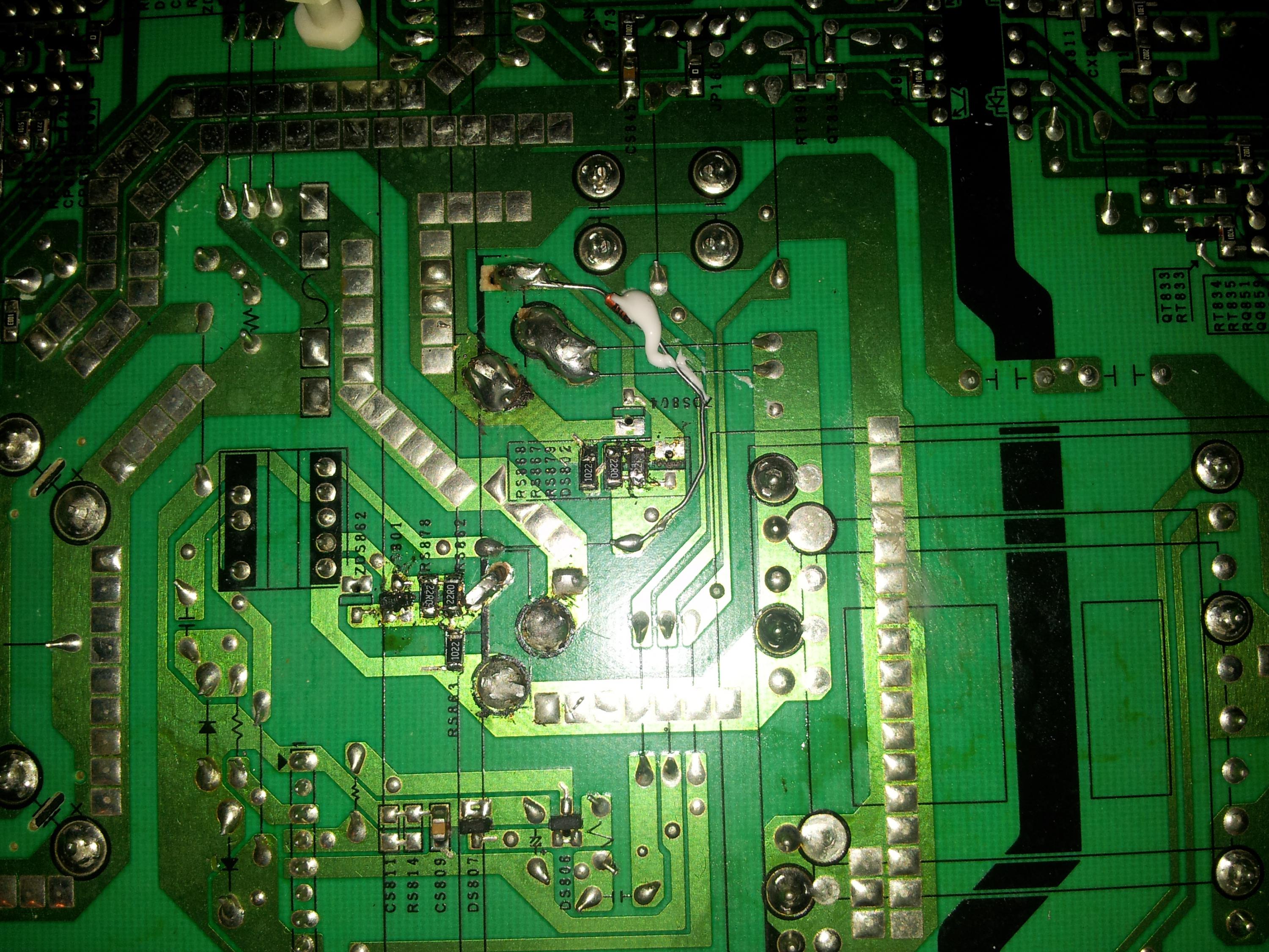

                                    Samsung 50" progress: FETs installed, SMDs done. Only one diode on FET gate drive was bad, but all main components replaced out of caution anyway. (The other diode tested OK out of circuit, so I left it.)
                                    FETs still to be bolted to heatsink, do not yet have plyers to get one screwed in good.
                                    Will perform smoke test tomorrow.

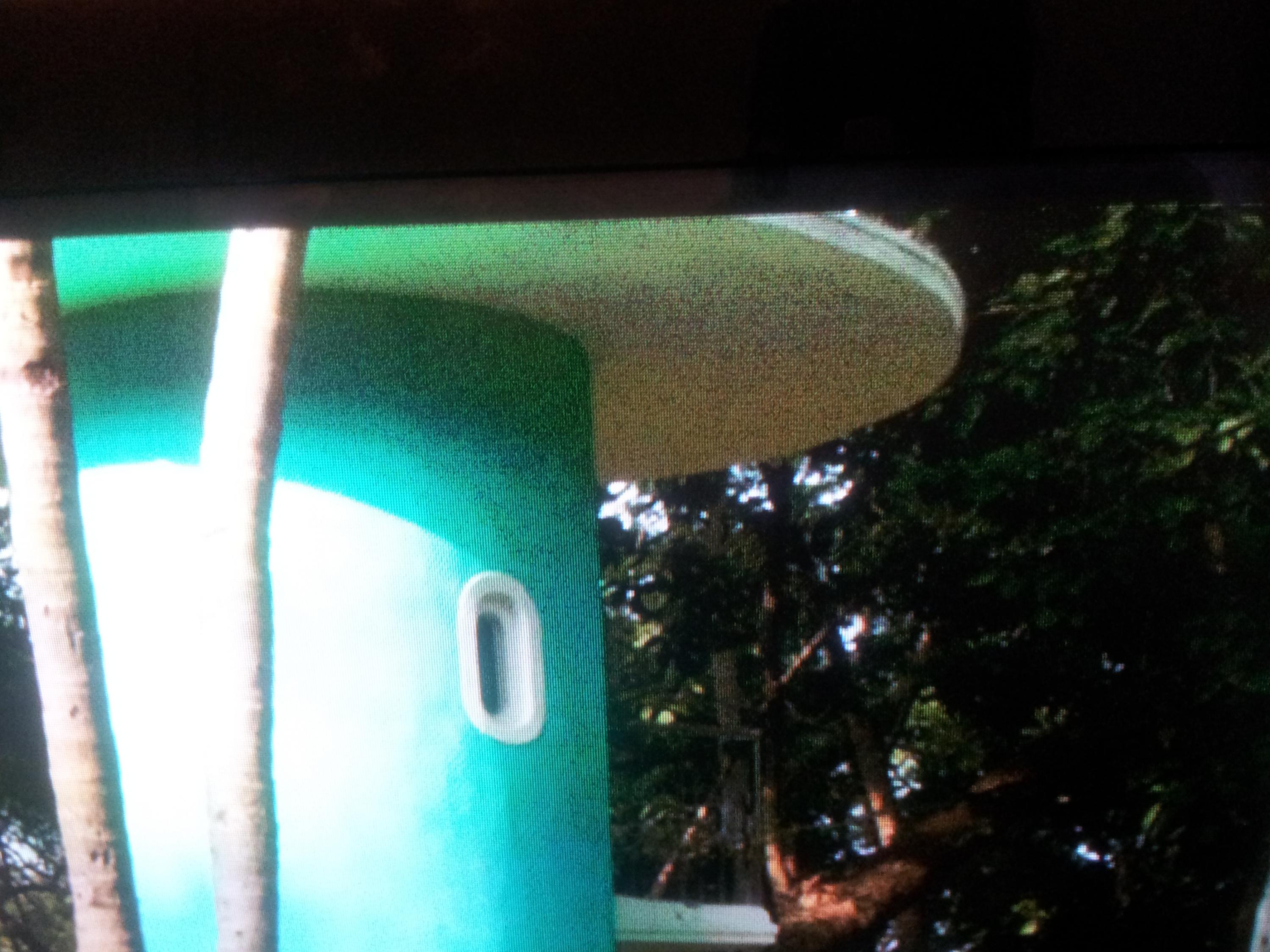

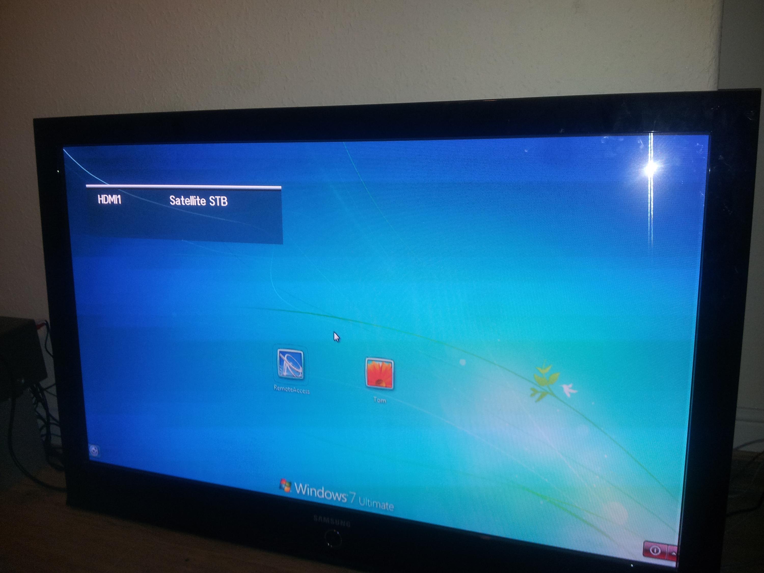

                                      Progress... TV has some sparklies issues, though.
                                      I was able to reduce them, but not completely eliminate them, with the following settings:
                                      Vs: 213V (from 207V)
                                      Ve: 105V (from 94V)
                                      -Vsc: -210V (from -190V)
                                      Ysc: turned UP before sparklies
                                      Yset: turned UP before sparklies
                                      But it's mostly working now. I was shocked to find Y-main still working! lol.…

                                        noticed on most plasmas of this size theres always some degree on sparklies may be the age but find you notice it when up close
