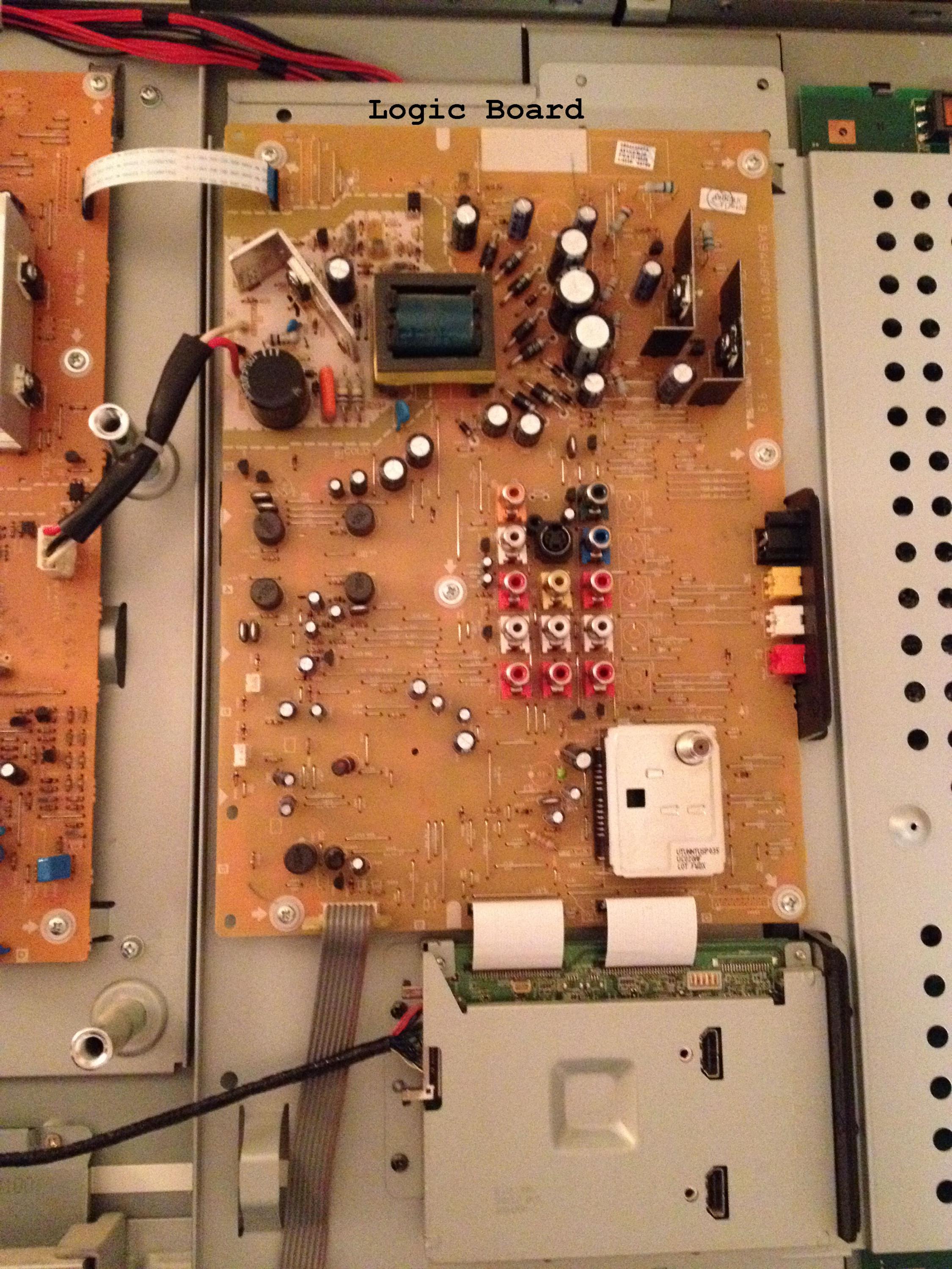

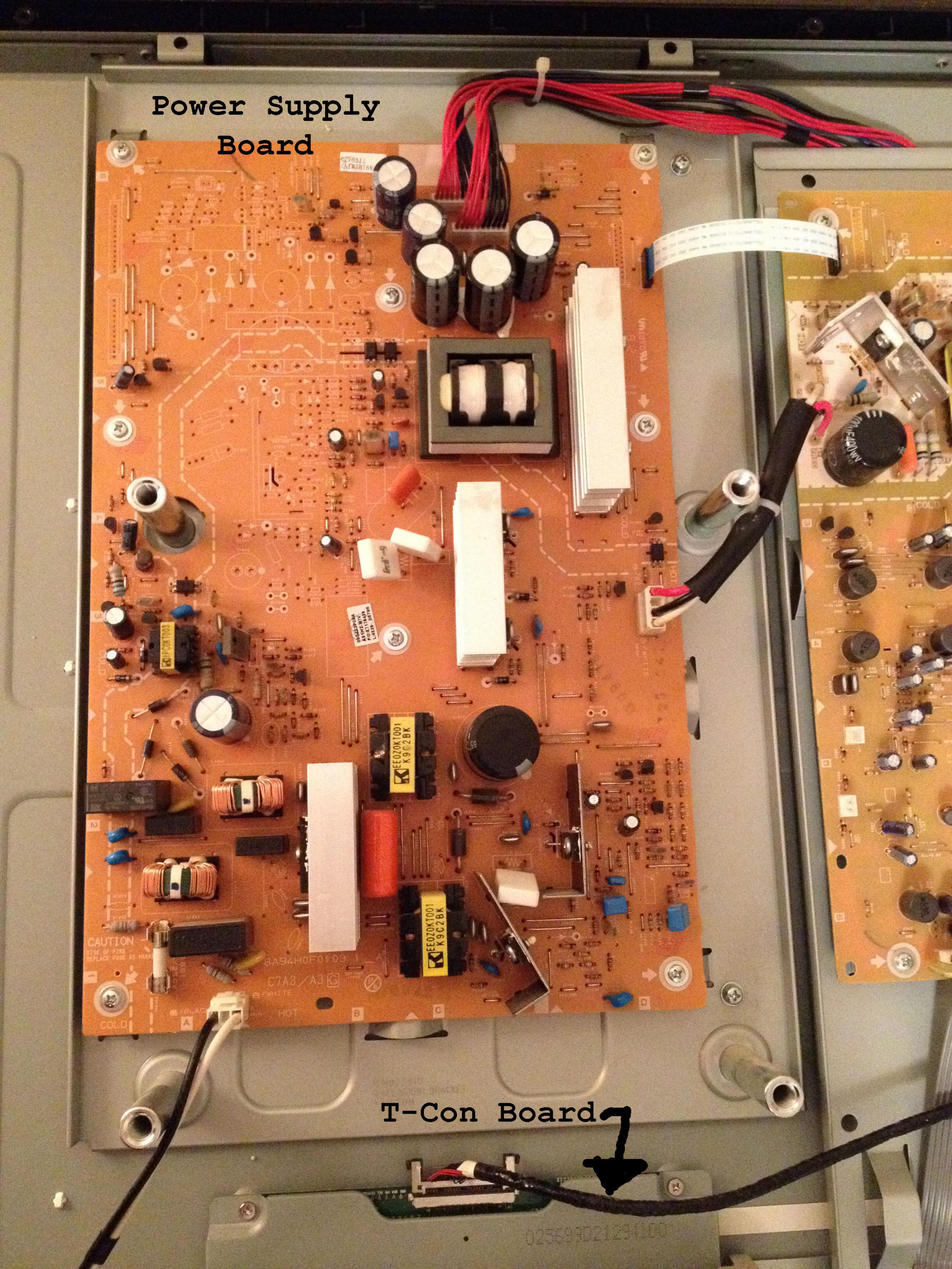

    I Acquired a 42" LCD with the Symptoms of No Picture No Back light. But there is Audio. I have been reading a lot of different post but i doing thing anyone as really answered the question. What part could it be. I am Novice to a lot of the talk and have been researching and trying to find all the different things and test points people have been mentioning.

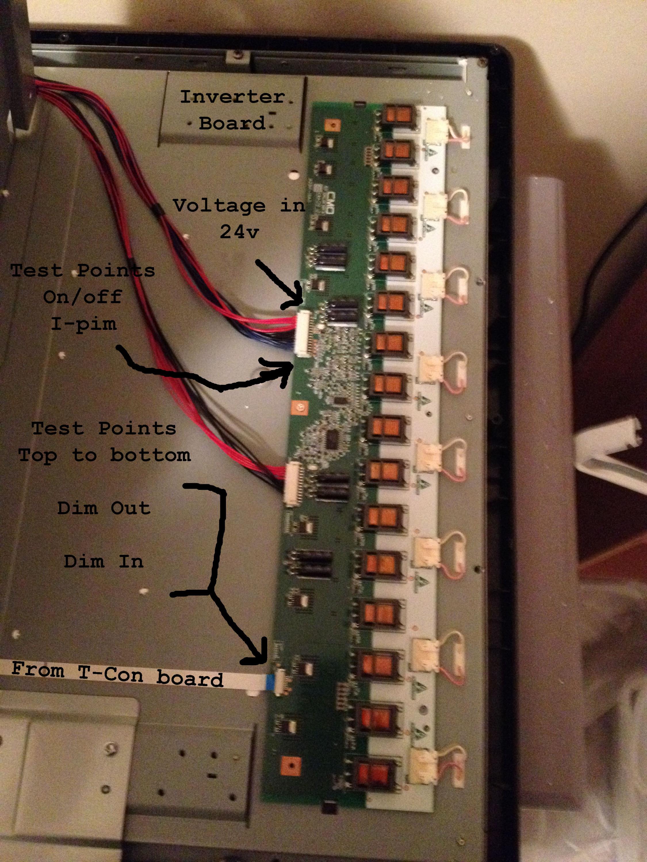

    So with the TV i have. i have been able to test the voltage to the Inverter Board and i Do have 24volts. I also found the (on/off) test point and read 2.7volts . then the (I-Pim) 2.1volts . I also found the DIM in and out by a ribbon from the T-con board. I Got no reading on either.
    Recap All check with tv powered on.
    24volts at inverter board.
    (on/off) 2.7volts
    (I-Pim) 2.1 volts
    DIM in- 0 volts
    DIM out- 0 Volts.
    What else should i check or need to check. Please help so i know what to do to fix.

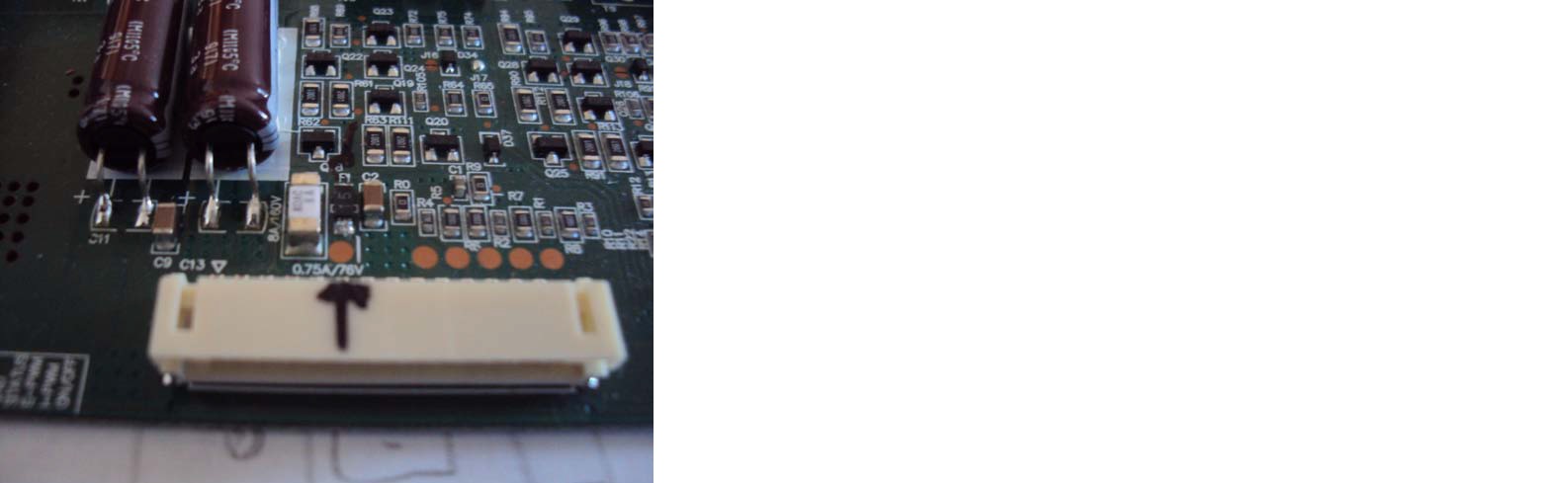

          I attached a Photo, Just for Clarification. I believe the fuse would be Labeled F1 on the board. Correct? Hopefully you can see it
            Re: Philips 42PFL3704D/F7 No pic/No Backlight, w/Audio
            yep thats the one,id expect to see 24v ish,both ends of that fuse
