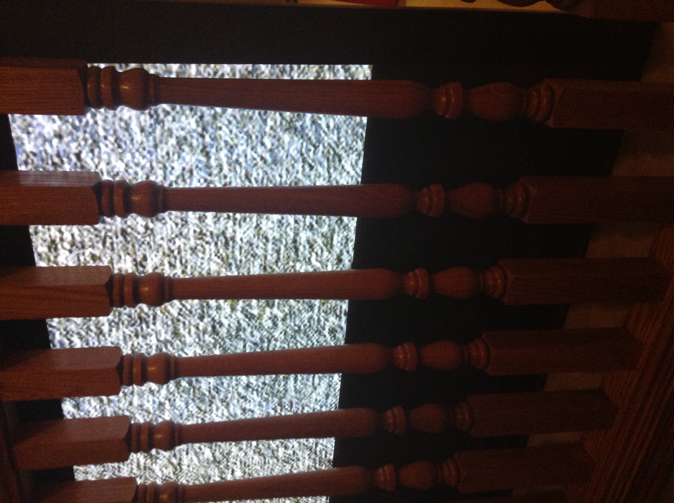

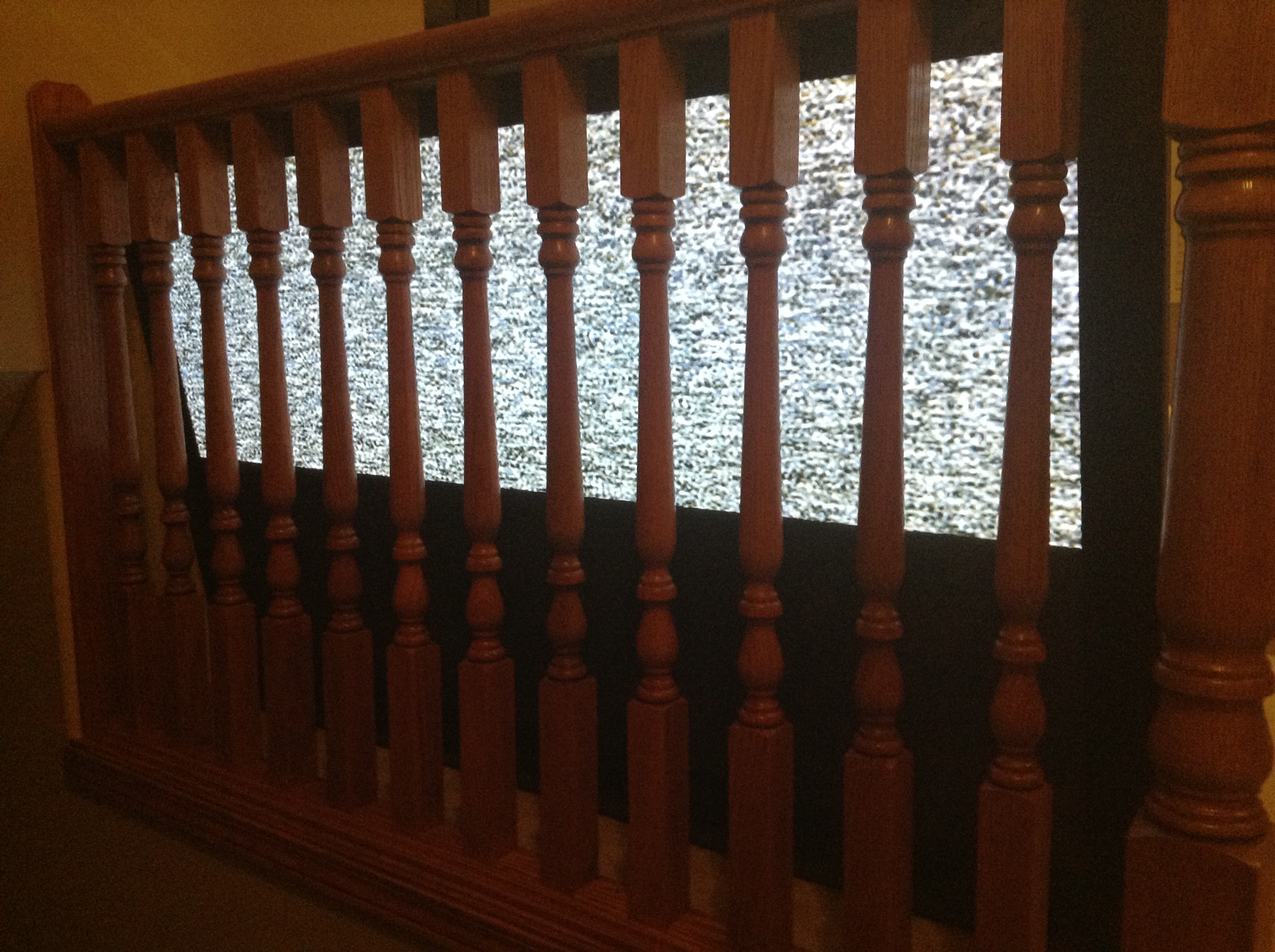

    Ok, I have an LG 60PG60F-UA. When turned on, regardless of selected input (including white broadcast snow) the lower half of the TV has no picture. Upper half looks fine. The division is sharp, along a single line of pixels.
    You can see this in the attached pictures (sorry about taking them through my railing, don't have a stand, tough to move this big sucker around). I can take clearer pictures if they would help.
    If I understand things correctly, I think I'm looking at a bad lower y-buffer board. Am I correct in this? Any advice would be great, this is my third attempted TV resurrection ever.

    Re: LG 60PG60F-UA, Lower section of screen is black
    A bad lower Y-buffer would be the most likely culprit.

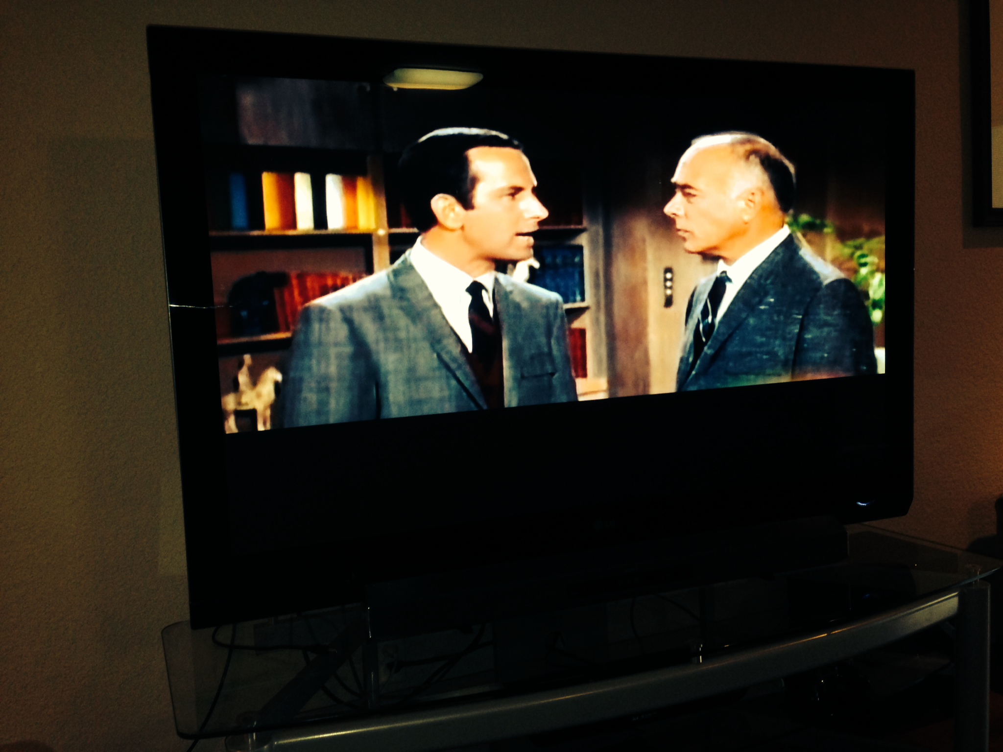

      LG 60PG60 approx. bottom 25% black. see the attached picture. Any suggestions would be appreciated.
        please see attached picture

          I would guesstimate the same diagnosis as above. If this were a Samsung it would likely kill the entire picture but maybe LG's are different.

              Reading through some of the information I THINK I may have the problem of a bad lower Y-buffer. About 1/3 of the lower screen is black. Every so often it will flicker, and by every so often I mean once in a two week period. Very very seldom does it do this.
              I have removed the back and checked for lose components hoping a little solder touch up would solve the issue but found no issues there.
              Can someone help me locate the lower buffer and maybe point me to a good place to purchase a board. I am not sure if it worth spending the money on the chance that it might be the lower y-buffer.

                I agree with it being a bad buffer board, fixed one with exact same problem a few months back and it was the lower buffer.

                          Here is where I am currently.
                          Put the replacement lower buffer card in and it appeared to fix the issue, but with the following. I now have horizontal lines on the screen.
                          I double checked the installation, things like making sure the 6 ribbon cables were connected properly, made sure the card was seeded well. I am at a loss of what i need to do next.
                          Is there a chance I may have gotten a bad replacement lower buffer. It does not look like the are a lot of ways to mess this up.
                          I have added an image to illustrate what the issue I am having.
                          http://butchseaman.com/gallery/60pg60f/Lines.jpg
                          Thanks for your help - Butch

                            Those certainly look like misaligned ribbon cables to the buffer board. when you seated them in did you make sure that it made that distinct click as they properly seated completely into the connectors? Are the tabs hanging over the ribbon connector nibs? One side or both sides? Is very easy not to get them to seat properly. I suppose if you have tried and tried again and don't change you can always have a bad buffer board still

                                Freakaft8 ... you were correct about the ribbon connectors. After spending almost an hour of connecting and testing i finally for the the lines not be seen.
                                Thanks to all for your help on this project.
