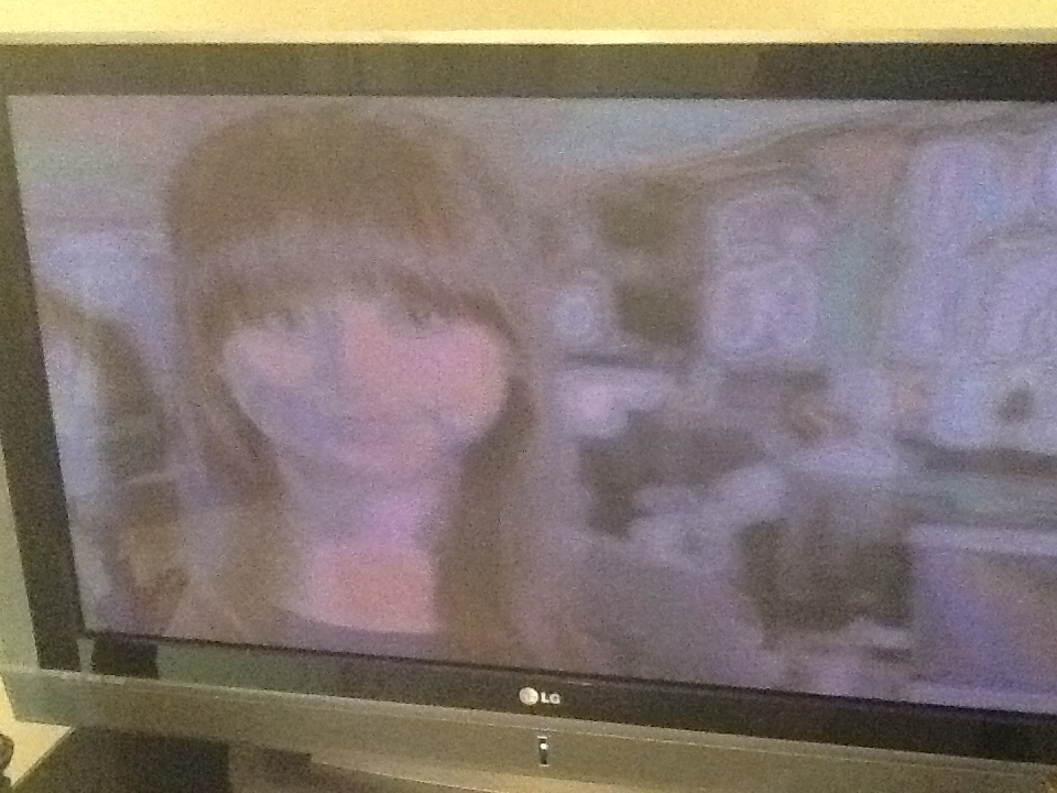

    LG42PC1DA Plasma
    Hi Guys.
    I am thinking that the fault on this one is the main AV board.Can any one comment on the attached picture?Thanks.

    Re: LG42PC1DA Plasma
    Pic quality is so bad--difficult to say!
      Dark washed our pictures are usually z sustain related but can also be a ysus issue as well
      Is the picture dark and muddy looking? Pink tint to the sceeen?
