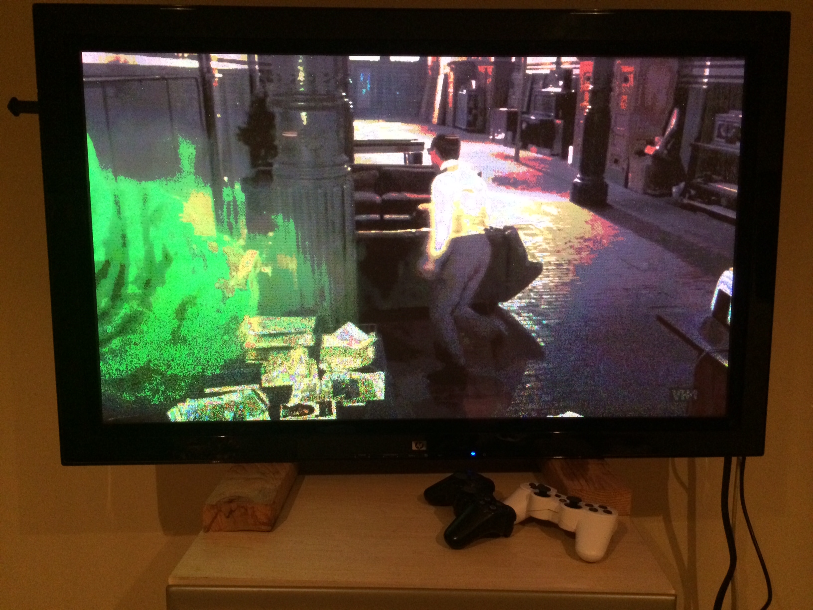

                              OK, I got the IPM in tonight and I can actually see the picture. It looks great except when there is movement on the screen. It seems like there is a refresh issue or something like that. If the screen is static and doesn't change it looks perfect. I will try to post a picture but its been problematic trying to capture a picture when its flickering. Any idea on what could be causing that? I changed my settings to 720p just to rule that out and then tried an xbox at 480p which both did the same refresh thing. Definitely close.

                                Re: HP Plasma PE0000
                                that looks like you have a voltage adjustment ooff. check the VS voltage against the label on the panel. also did you happen to adjust any of the pot on the Y sustain board?

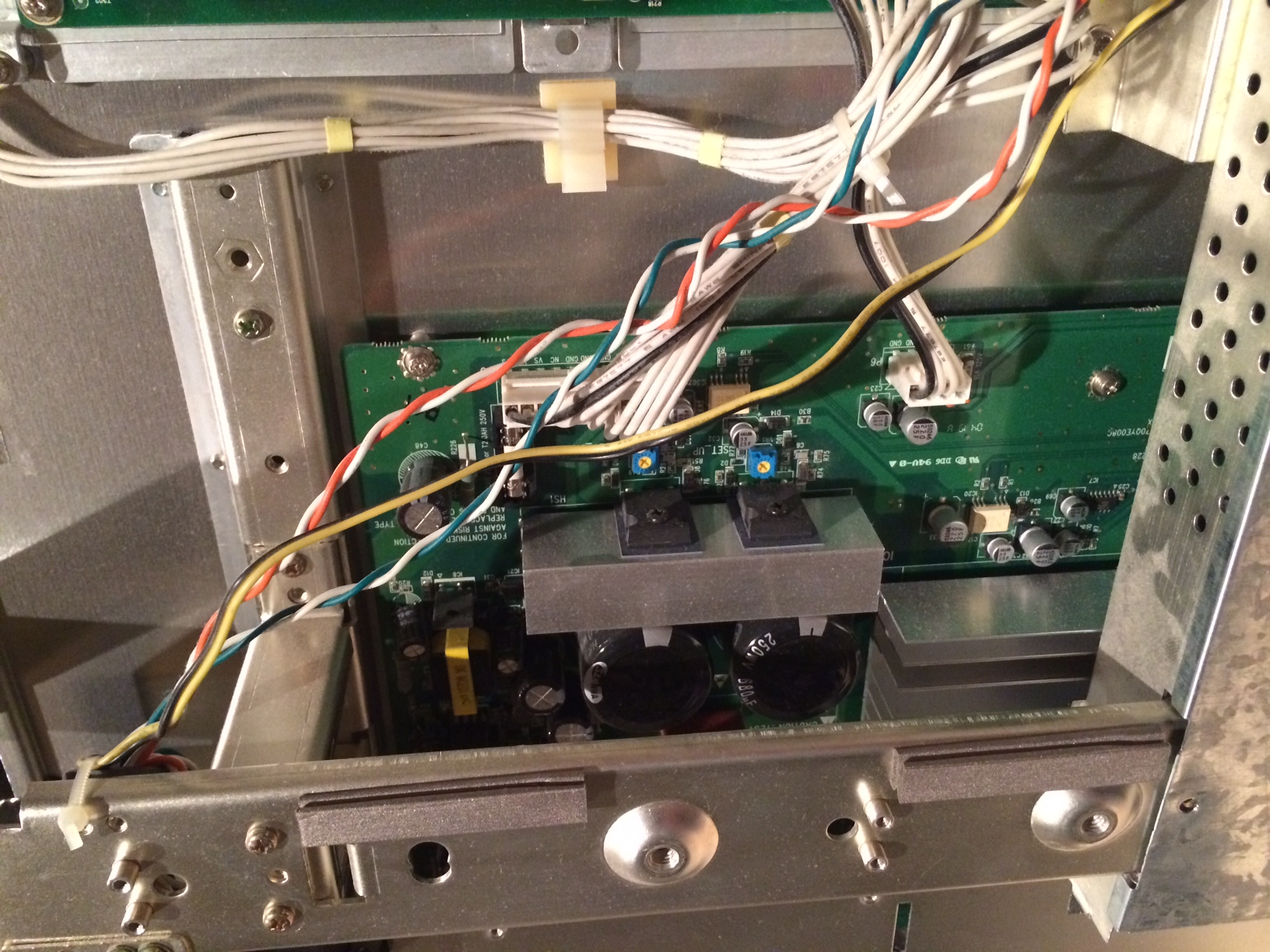

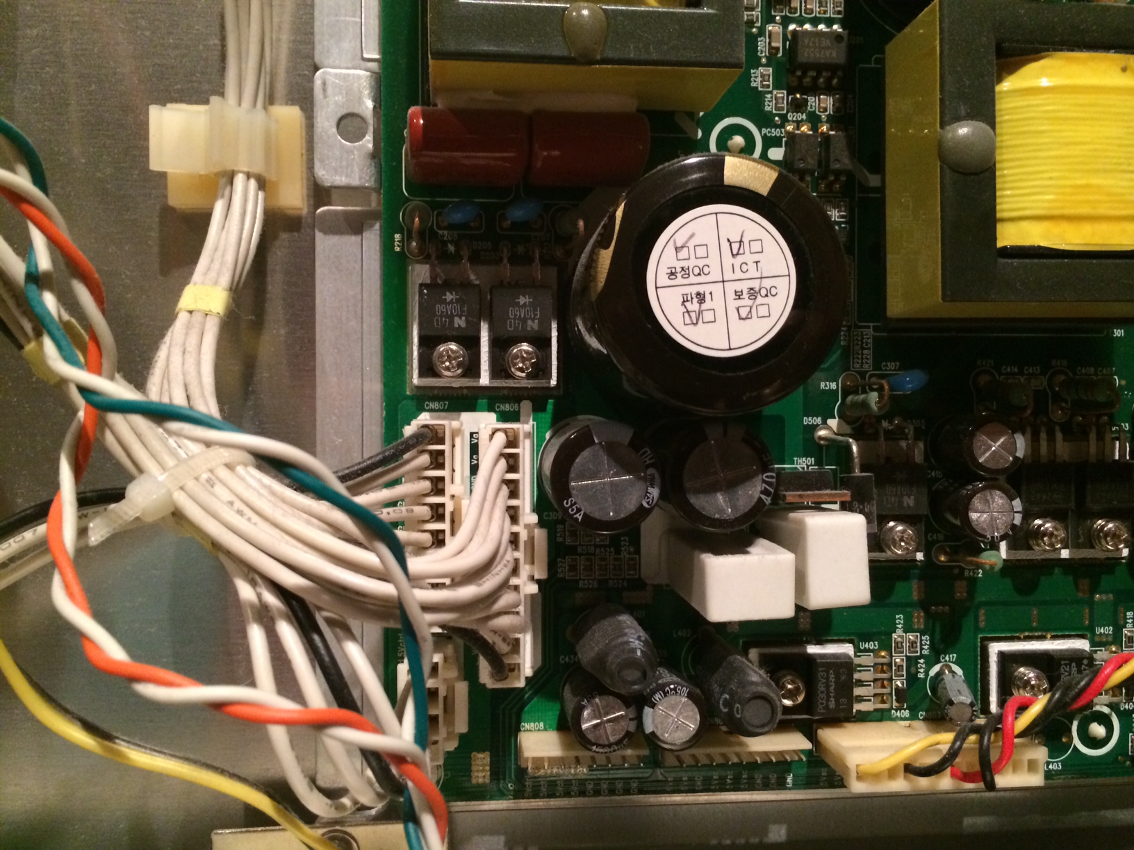

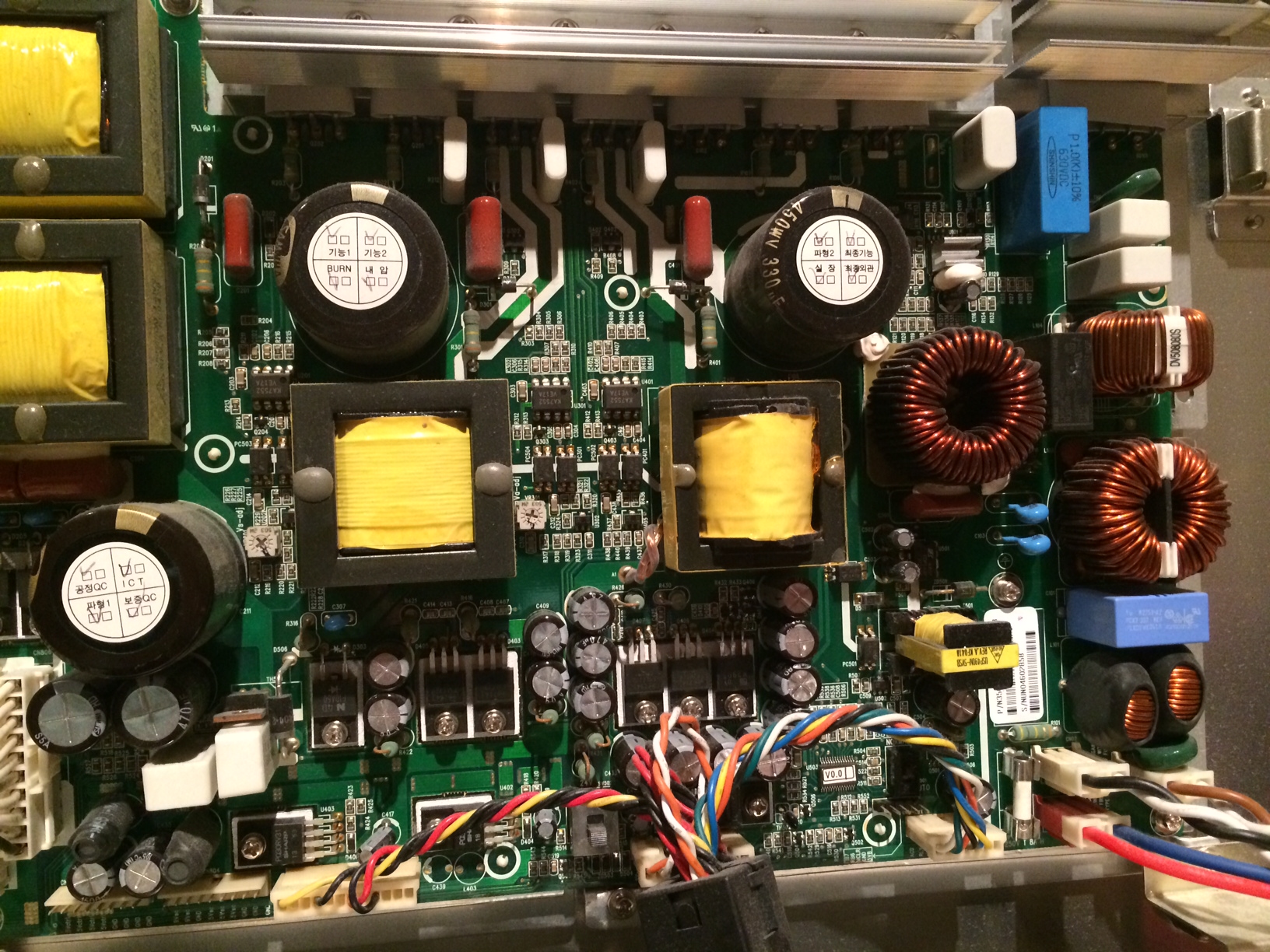

                                    #57
                                    I tried to do a little research on this but having trouble locating the VS test location on the power supply. Would it be called anything else?
                                    Here are a few pics if it helps any
                                    • freakaftr8
                                      • Oct 2012
                                      • 3743
                                      #58
                                      The wires coming g out of the connector on the lower left side of the.power supply in pic 1. There will be a pin labeled VS. Check that pin against the label on the back of the panel. Should be around 190 to 210vdc. Also check the VA output pin as well.
                                      Let's start there.
                                        OK, looks like TV is set for 187 based on the sticker inside and when I test both VS input's I am getting 177. VA is set for 65 and getting about 64 off of it.
                                          #60
                                          You should try increasing Vs until it meets panel spec, there is a little screw adjustment on power board. Get Vs and Va within 1V (no need to adjust Va in this case.)
