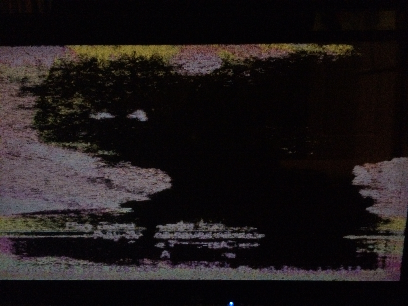

                        Replaced the board tonight and replaced the missing fuse in the one I received. The TV acts like it turns on, then turns off and doesn't allow me to power it back on until I pull the power and reset the process. At no point do I get a picture though. Any ideas?
                        • jasonflippin
                          • Jan 2014
                          • 52
                          #32
                          Re: HP Plasma PE0000
                          Ok, it made a liar out of me. It turned on, here was the display I got. It is still very dim and was splotchy when I first turned it on. Eventually the black splotchiness cleared up and the picture was just very flickery and dim. Here is a picture on startup and then once running. One other thing to note, the heat sink on the Zsus board I replaced still is not getting hot or even remotely warm. I rechecked the fuses for any blown after and none of those have blown. I feel like I'm learning slowly but surely, thanks guys! Anyway I am stuck once again, so looking for some ideas?

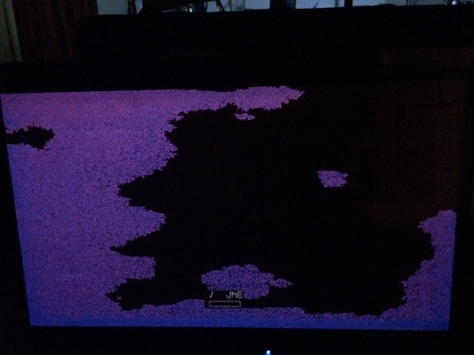

                              Okay does the picture still look the same with the Z sus disconnected
                              • jasonflippin
                                • Jan 2014
                                • 52
                                #35
                                It does not, occasional light spec flicker, but I can never make out anything or see what input I am on. And just to clarify there were 5 connection points I unhooked on the Z sus, 3 white connector plugins and 2 bronze colored ribbons that must connect into the plasma screen itself.

                                  What are the heatsinks doing after 15 minutes of running is Z still cold or the Y cold?
                                  • jasonflippin
                                    • Jan 2014
                                    • 52
                                    #37
                                    Z is cold Y gets pretty warm
                                    • freakaftr8
                                      • Oct 2012
                                      • 3743
                                      #38
                                      So now either we need a scope to check waveforms from y and z or that z board you ordered may be faulty. I'm betting on that more so. The IPM should be warm to the touch.
