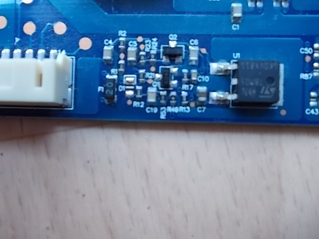

    Akura APLDVD2YR2688FDV Inverter Board
    The Inverter Board is MIT68013.60 Rev 7.
    Full sound etc through both Aerial input and Scart.No picture,and no backlight at all, not even a quick flash.24v going to the board from the PSU,and what looks like a BL on voltage as well.
    The Inverter Board shown,as 2 fuses in the middle of it (not shown) which both test good,But as you can see from the photo it looks as though there is another fuse shown as F1.This measures open on 'beep' Diode test, and very high resistance on ohms test.The marking on the board also shows a D1, which obviously has never been fitted,and the F1 shows a marking of 20 on it !!! so the question is...is this a fuse and if so what value does the marking 20 signify?? Any help appreciated.

    Re: Akura APLDVD2YR2688FDV Inverter Board
    Yes it is a fuse think its 1.5A 63 or 76v - I will just check
    EDIT
    Yes - second one this week!
      Sound like a good job for this morning...as things usually come in threes...expect another one this week.Thanks for that.....must remember to use 20 in the Lottery at the weekend !!!
        Yep, very commonly failed fuse, just cannot handle inrush current.
          Replaced and working as it should ...
