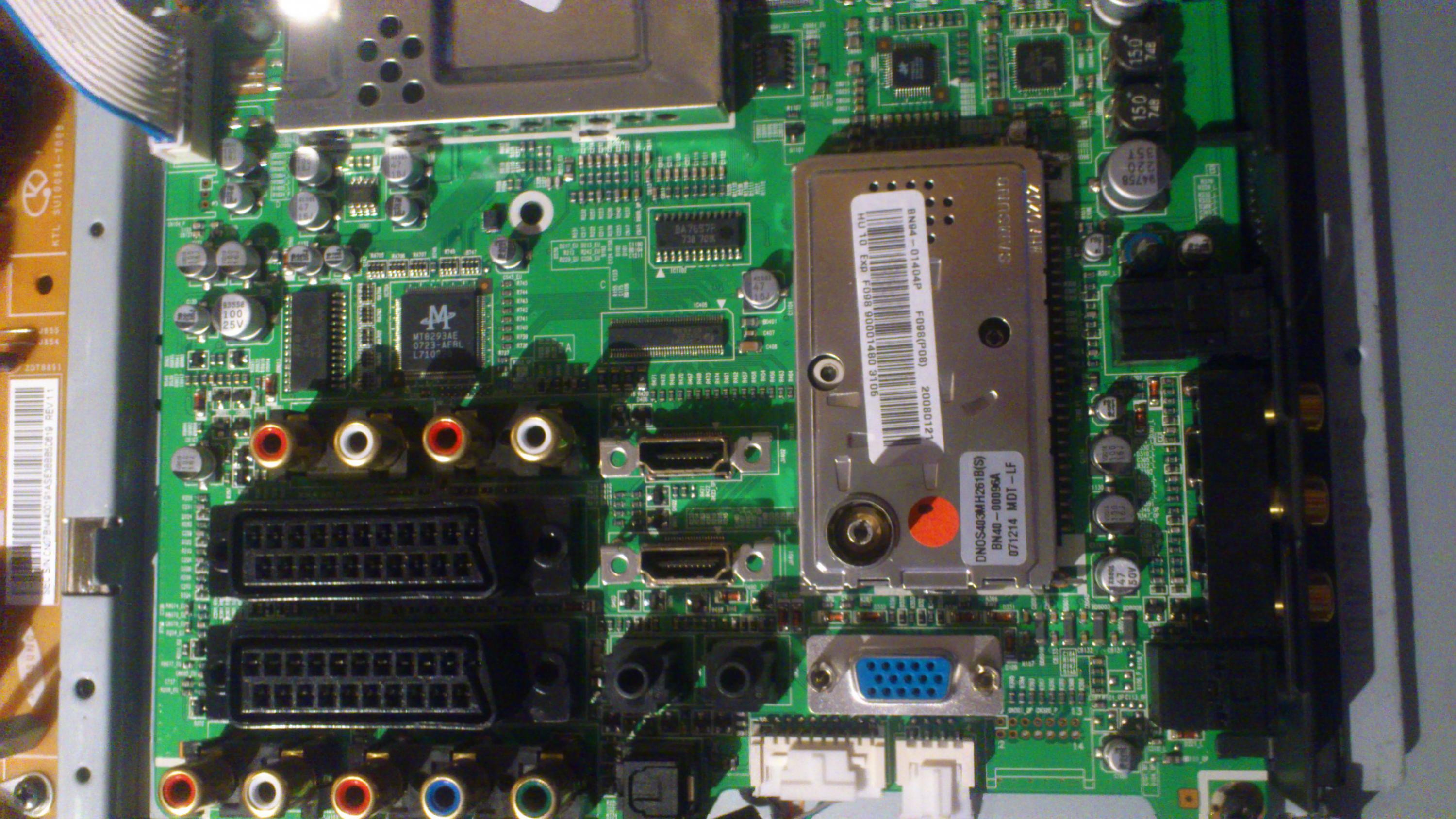

    Hi everybody hope you are all well.
    ok, i have a samsung le32s86bdx/xeu here,(not the model i stated on the title! i missed a bit)
    When i first turned on the set it powered as i should, the picture was fine backlight fine ect, then after about 30 sec the picture started to brake up, the back light started flickering untill the backlight went out.
    Now when i power on the set i get the sound from the speakers for a bit but no backlight.The tv cycles from standby to on with no backlight to off and again continuous.
    After opening the set i see no bad caps(looks like they have been previously tested as the tops are marked with a pen!)
    iv checked the outputs from psu, they seem fine,well maybe a bit high as the power to inverter is 27.7 not the 24 stated.
    Im wondering, would this mean the main board is at fault? or is the higher reading from the psu causing the fault?
    Any ideas?
    thanks in advance, Charlie.

        ok. im having a steady 27.3 v to the inverterboad yet the backlight remains off.
        I have visually inspected the transformers they look ok, iv checked the small fuses they test ok.
        ill fully test tomorrow when i have fresh batterys.

          Post good clear pictures of the boards, model number of the power supply board BN-XXXXX????
          Also check your batteries of your meter, when batt is low, the meter read out will be higher than normal . The backlights will not come on until the inverter gets the BL_ON (or INV ON) from the main board. You can try disconnecting the cable between the power supply and the main board to see if the backlights will come on, it may have built-in pull up resistors on the power supply board.
            Re: samsung le32s86bd main board or psu fault?
            Many backlight inverters have an over voltage circuit which engages after about 26V to shut off the inverter.

              OK-
              The reading i get from the rail from psu, leading to the main board (after fresh battery in meter!)
              1 n/c actual 0.0
              2 13v " 12.2
              3 13v 12.2
              4 gnd 0.0
              5 5.3 5.2
              6 5.3 5.2
              7 5.3 0.0
              8 5.3 0.0
              9 gnd 12.0
              10 gnd 0.0
              11 gnd 5.2
              12 12v 3.4
              these readings seem odd where ground is getting 12v?
              im wondering, is whats printed onm the psu what is ment to be coming out that rail?
                      Unplug the main board, do you get 12V and 13V stable?

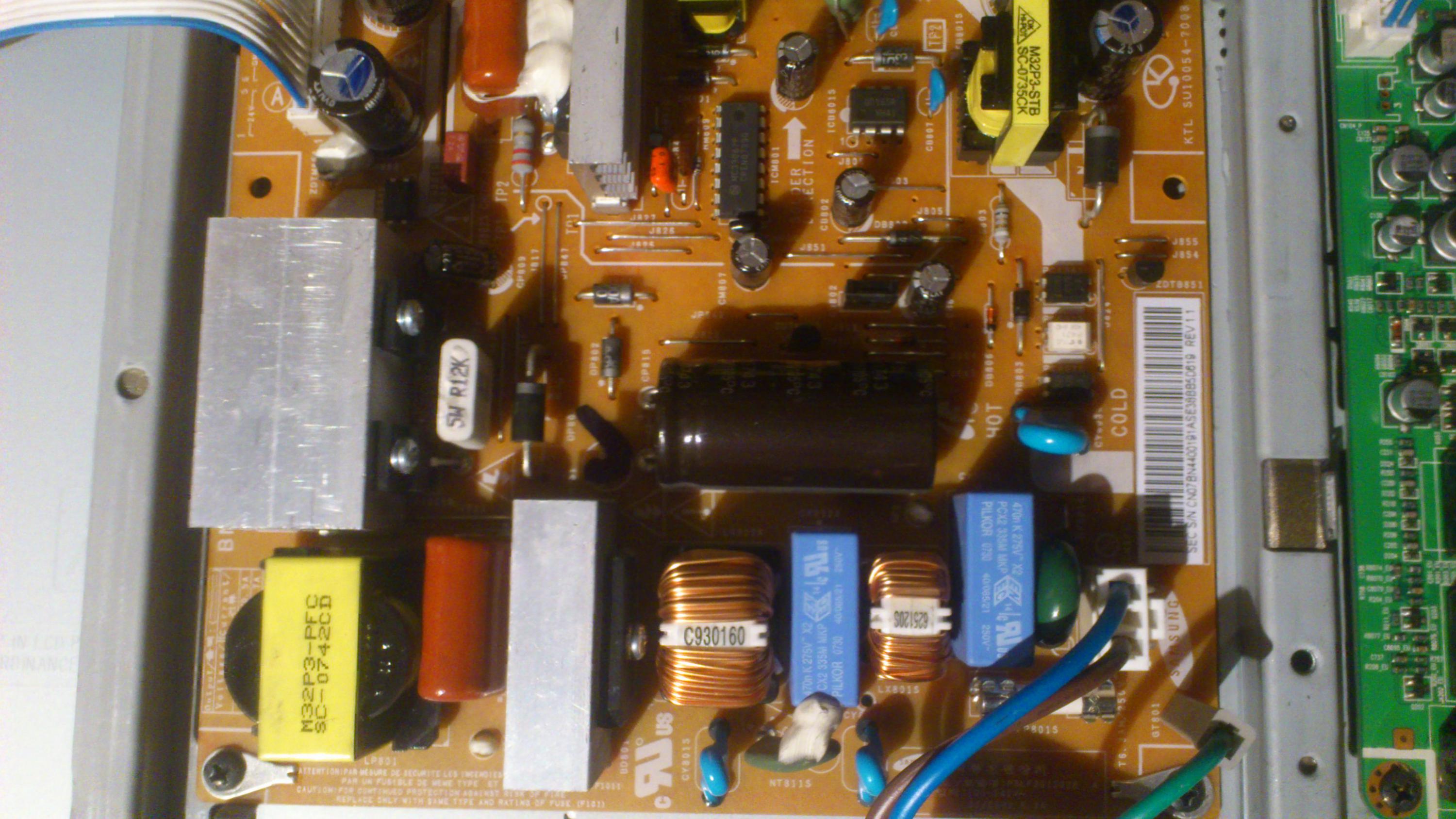

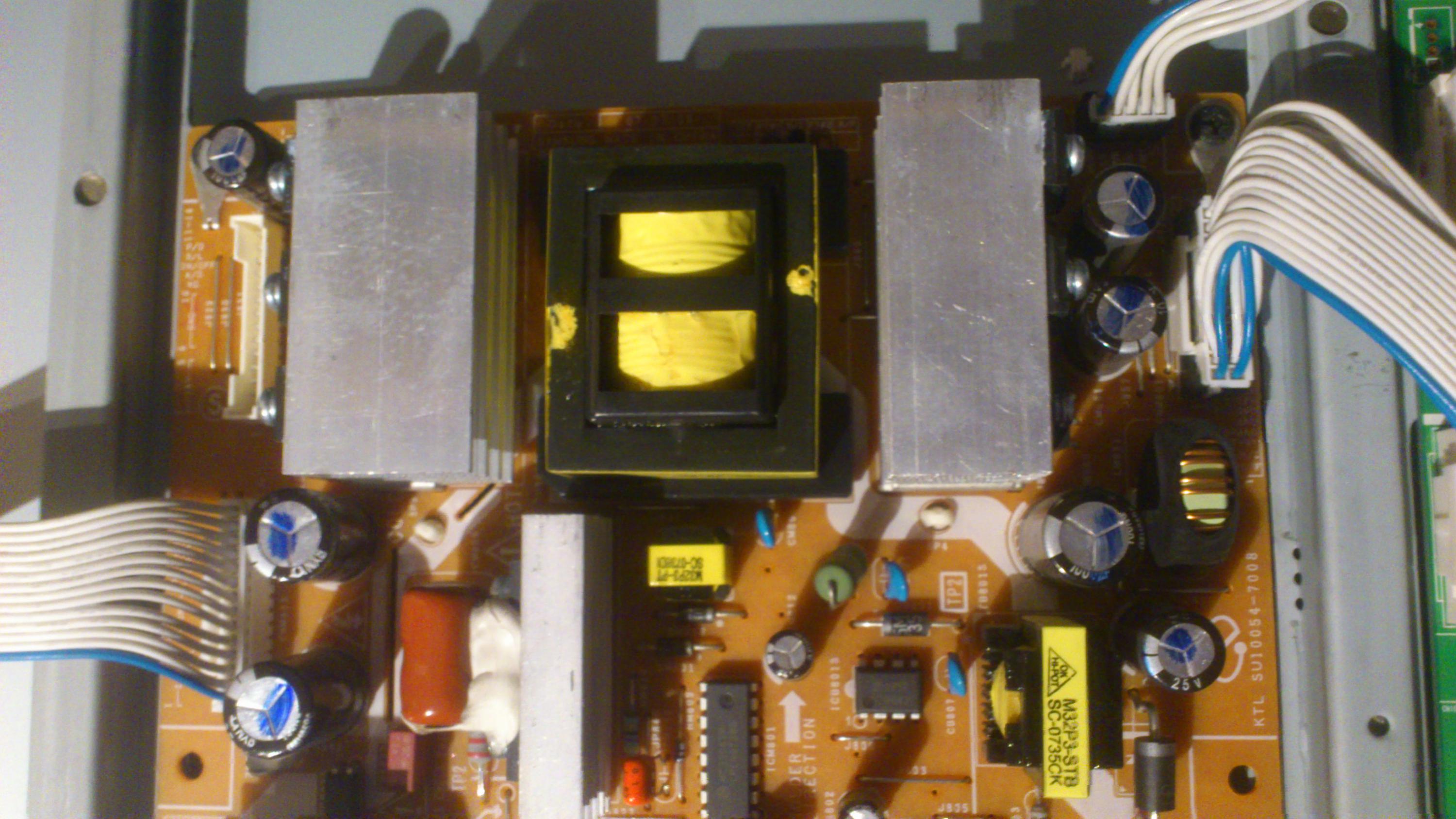

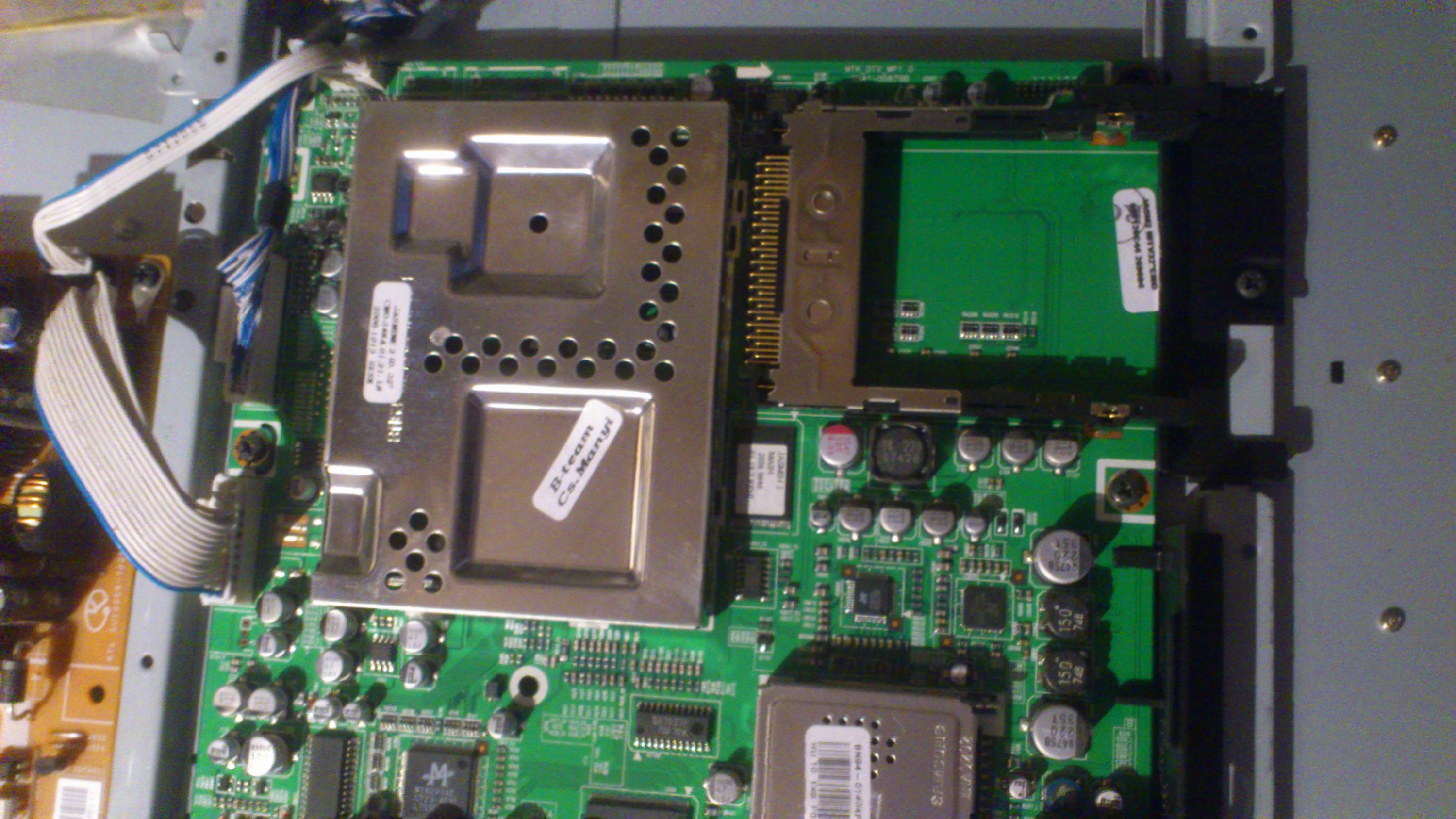

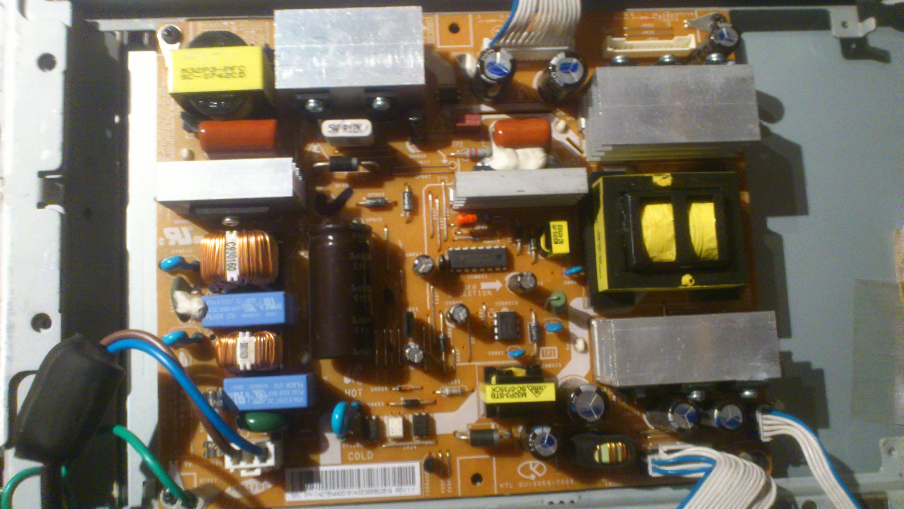

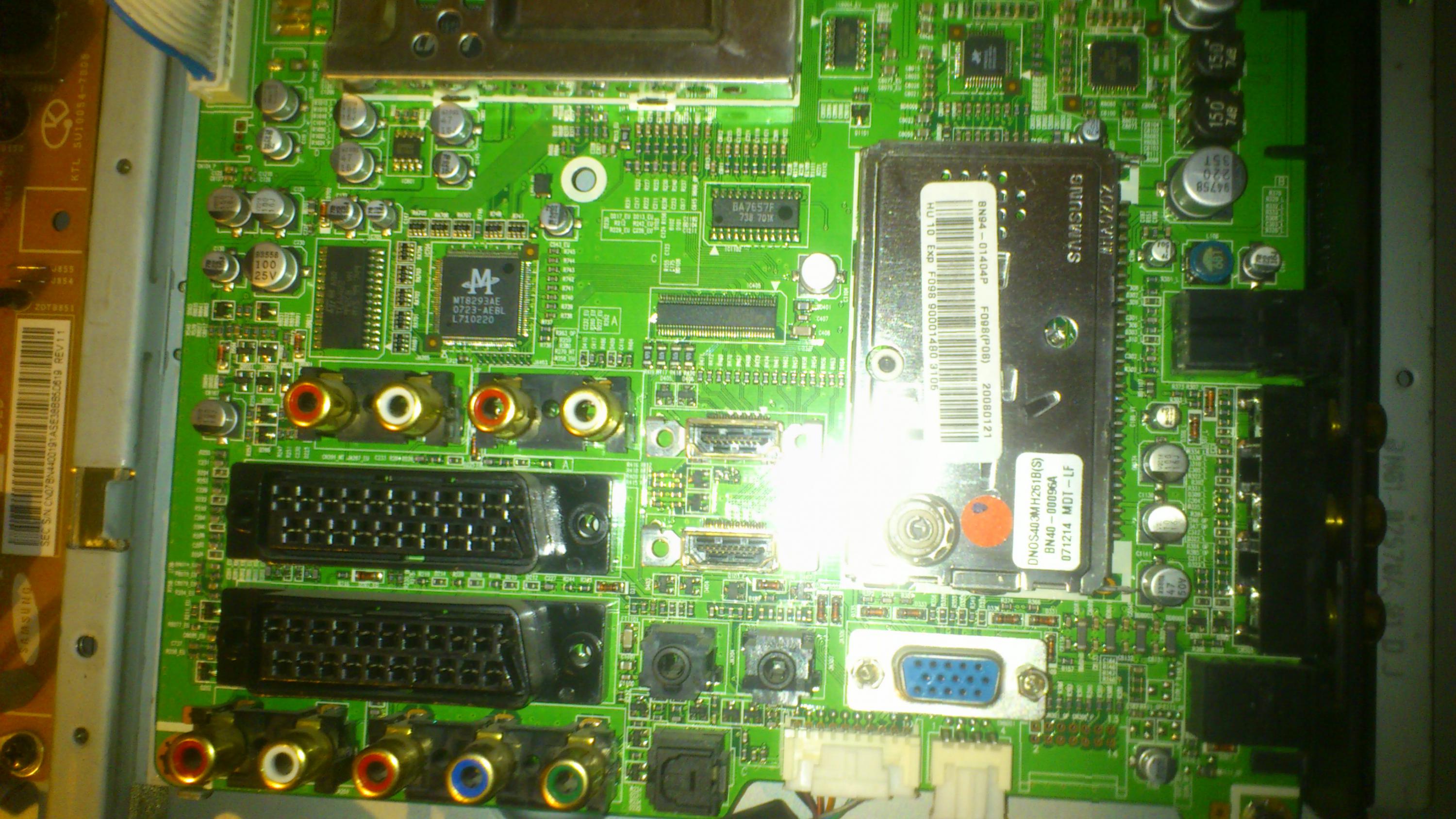

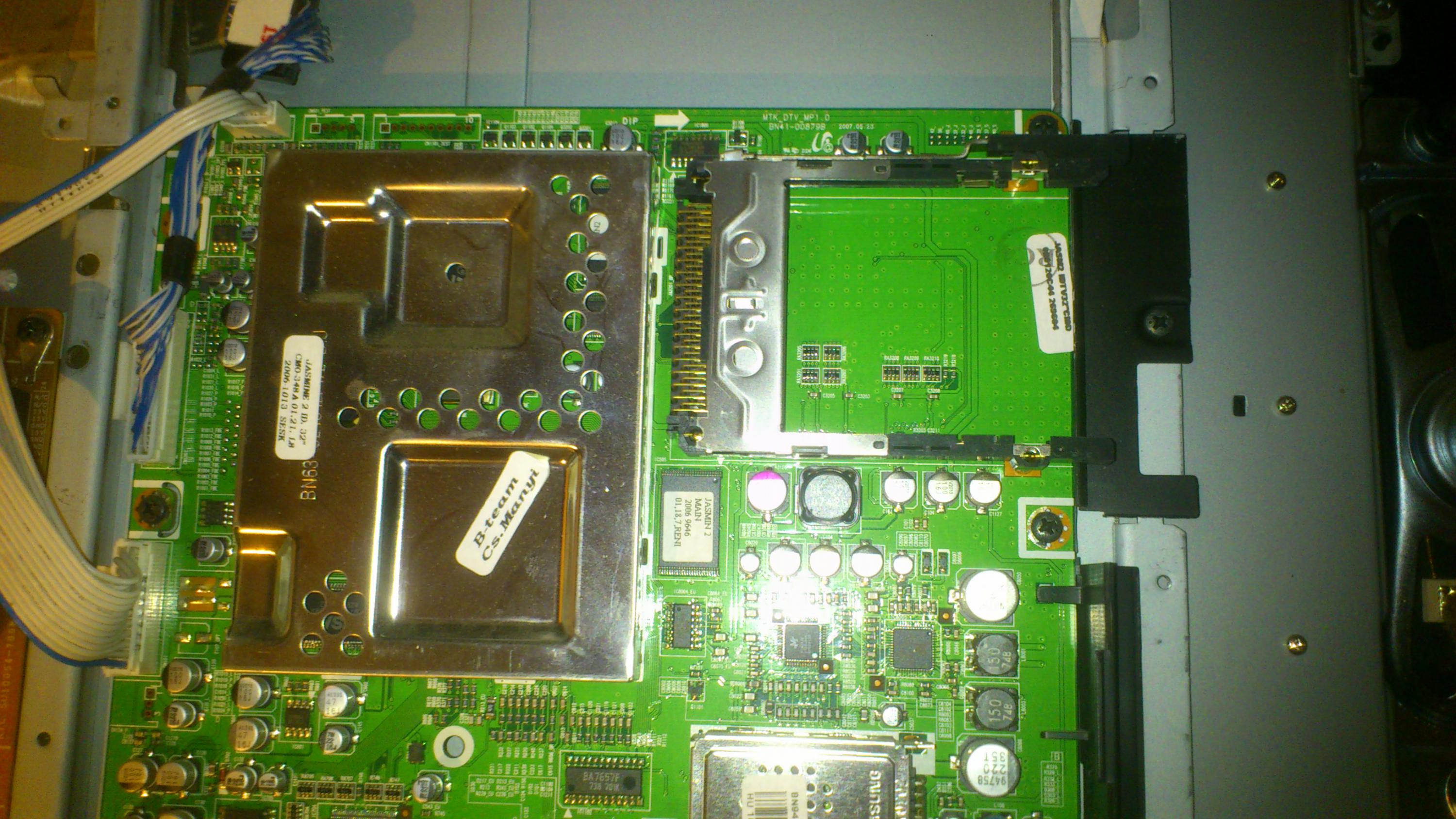

                          Still not providing us the pictures and the model number of the power supply board.
                          Can we see the pictures of this connector? Is it double-row pin? It is missing the ps_on , bl_on (inv on) label, etc.
                            do thewse pics help?
                            ill a\dd more wehwen im back, im getting dragged shopping!
                                  Tv still cycling with no backlight now.
                                  When the tv is cycling i dont have any output from oth b/l output from the psu although the pin next to it called the on/off has a 3.5 the 24v detect also has 5.4
                                    Ok. The tv has been cycling for 10 min now the backlight has come on. The b/l pin now has 5.2 v.
                                      that sounds like cap issues,have you heated the board to see if the fault dissapears?
