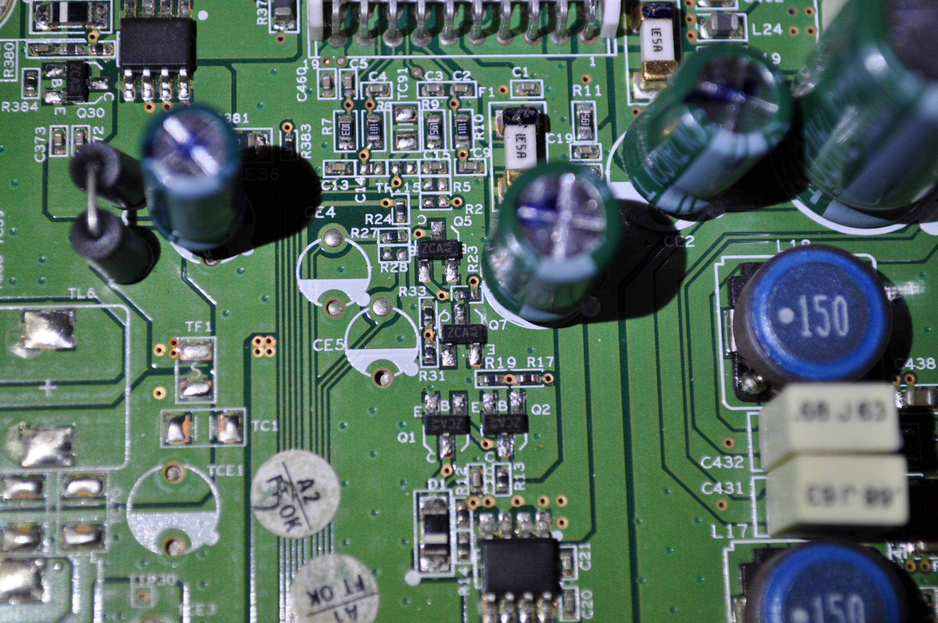

What DC do you get at the Base of Q2 with ref to chassis ground? It should toggle. If you check the resistance between the Collector (Middle pin) of Q2 to the #1 test point, does it show 0 Ohm?
12K is way high. I do not think we are at the right transistor for driving the PS_ON. I expect direct connection from #1 test point to the Collector of Q2.
Looking at the picture, that Collector of Q2 is connected directly to the Base of Q1, the Emitter of Q1 is connected to ground so the Voltage on the Collector of Q2 can never swing higher than Vbe of Q1 which will be only arund 0.6~0.7V and that make sense what you are seeing. So I still do not believe we are looking at the correct point of the board.
Looking at your marked test points, it looks like test point 4 (left side of R1) has a copper trace connected directly to test point 2.

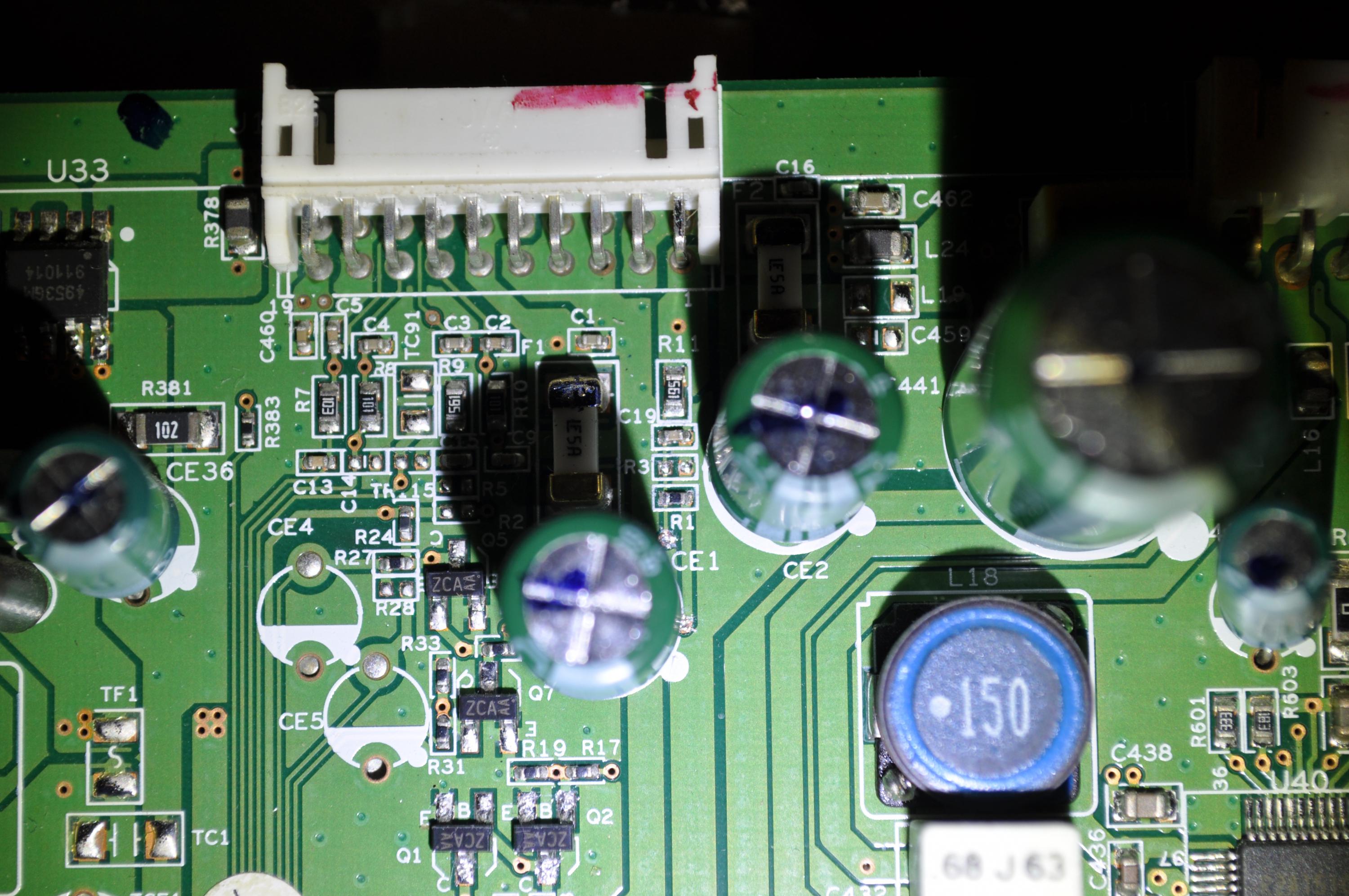

Can you draw out the connection from pin1 of that connector to see what resistors are in the path of that pin 1 connector? Pin1 for sure is the PS_ON pin?
I see R11, C19, R3, R1 in the area of the PS_ON pin.
You are correct R11 C19 R3 (although there is no resistor present at R3)and R1 are in that path. I do believe pin 1 is the standby pin If I test to the standby pin on the PSU I have a solid short.
OK, Connector pin1 is connected to the top end of R11 (561), the bottom end is connected to the left side of C19, the right end of C19 is connected to ground so this is the noise filter cap. Bottom end of R11 is also connected to the left side of R1 (no printing on the body) which is test point 2 (test points 2 and 4 are connected together). According to your test it has about 24 Ohms reading to the Collector of Q2 which does not make sense. The right side of R1 is connected to ????.
As the way the Q1 and Q2 are connected, Collector of Q2 can never go up more than 0.7V.
So find out the value of R1 and trace out to where both ends are connected to, it should be connected directly to a Collector of transistor some where.

Emitter of Q5 nad Q7 are tied to Ground. Collector of Q7 is Connected to Base of Q5, so the Collector voltage of Q5 cannot go up any higher than 0.7V.

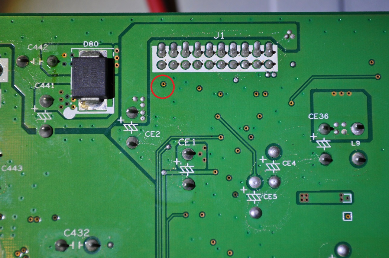

You can also see VIA (round copper pad with very small hole, just above "R11" printing) by the pin 1 connector, it must be connected to something if they put a VIA there.
But it must be connected to the trace on the bottom side of the board, on the bottom side, does it have any traces going some where else or just pin1? I am running out Idea since I do not have the board in front of me.
OK, it does not look like it goes any where.
I am thinking about modification to get the PS_ON signal since we cannot find out exaclty where the transistor that generate the PS_ON is.
Can you tell me againg the DC voltage on the Collector of Q1 and Q5 when the TV is off and when the TV is on?
