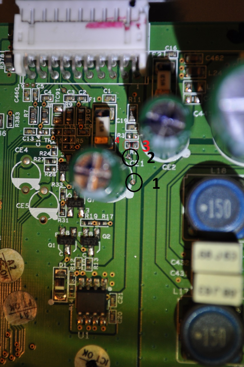

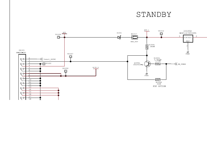

Re: Vizio sv421xvt
See POST 11, the transistor may be leaking (low resistanace between Collector and Emitter). I would trace out the connection from the PS_ON pin to see if it ends up connecting to the Collector of the transistor some where on the board.Last edited by budm; 01-06-2014, 05:00 PM.Never stop learning

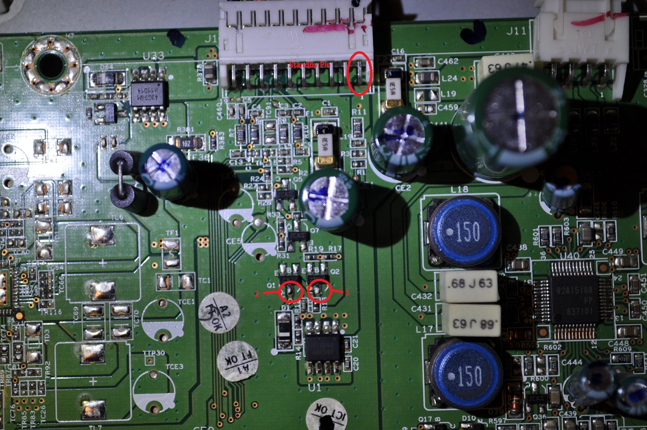

Re: Vizio sv421xvt
Ok on the attached picture I have traced the voltage .680VDC (same voltage on standystandby pin) to the collector of transistor marked 1 (Q2) when on button is pushed. Collector of 2 (Q1) is 0 when power button is pushed. When power button is pushed again (turned off) Q2 goes to 5.112VDC and Q1 goes to .0042vdc
Re: Vizio sv421xvt
Is the PS_ON PIN connected to the Collector (middle pin) of Q2? It looks like there is resistor in series with the PS_ON PIN.
"I have traced the voltage .680VDC (same voltage on standystandby pin) to the collector of transistor marked 1 (Q2) when on button is pushed. Collector of 2 (Q1) is 0 when power button is pushed. When power button is pushed again (turned off) Q2 goes to 5.112VDC and Q1 goes to .0042vdc" This statement does not make sense since you are seeing 5.112V. The circuits of those two transistors are correct, when Q1 is ON, Q2 will be off, when Q1 is OFF, Q2 will be ON.
Are you sure that the PS_ON is traced back to Q2 Collector?Last edited by budm; 01-07-2014, 04:11 PM.Never stop learning
Re: Vizio sv421xvt
If the PS_ON is generated by Q2, check Q2 Collector voltage, it should swing high (3~5V) and low (<1V).
Or we may be looking at the wrong section since it looks like Q2 (Collector) is connected to the Base of Q1.Last edited by budm; 01-08-2014, 04:50 PM.Never stop learning
