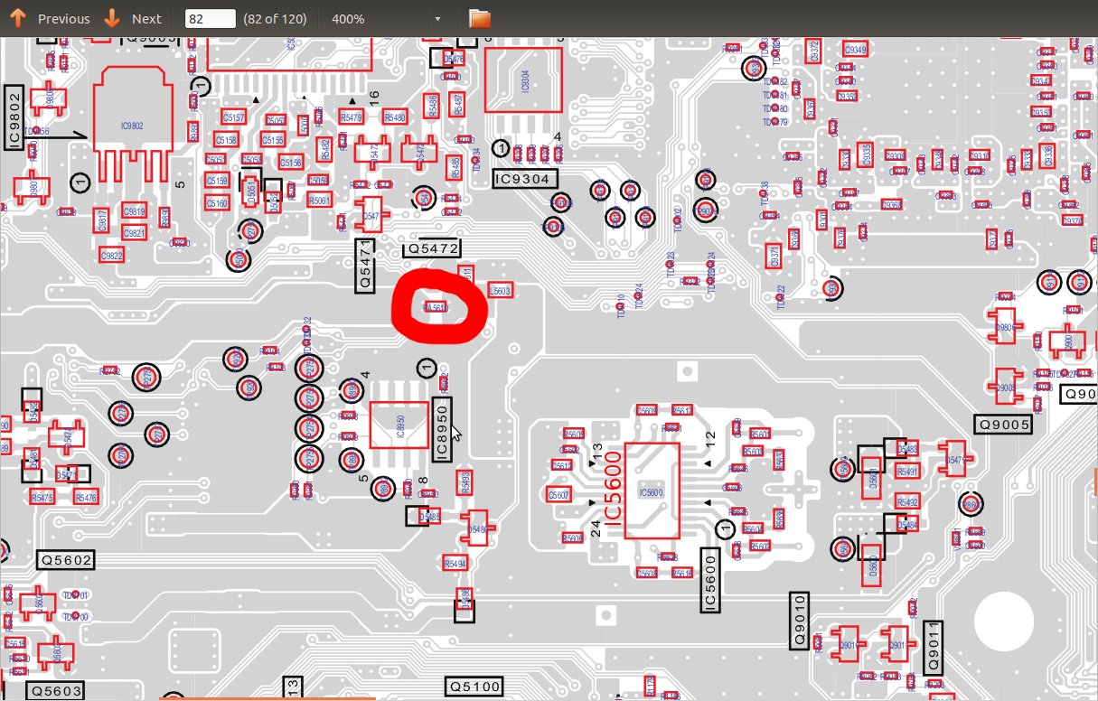

    So 15V always dead? Not changing as TV turns on? Just need to confirm that.

        #123
        Re: panasonic tx42-p42x20b
        no 15v is allways dead
          #124
          There is a fuse PA5610. It's not marked but I've highlighted it in the PCB print. See if you can locate it and check if it is open, also the voltages on both ends, red on each end and black going to chassis. Expecting ~15V if all is well with fuse. See attached.

              #126
              fuse is open circuit but whats caused it to blow a good spot tom some good fault finding tips in this thread
                #127
                Check from the ~0.4V end to chassis ground on ohms. Hold the reading for several seconds. Is it zero, or near zero?

                    #129
                    OK, set your meter to the 2000 ohm range. It looks like this: 2000Ω. The "Ω" indicates ohms.
                    The TV should be off and unplugged.
                    Then put the red probe on the side of the fuse which is measuring low voltage (about 0.4V) and the black probe on the chassis. Record the reading you get, after letting it settle for five seconds.
                    If your meter shows a single "1", i.e. the same as not connecting the probes, this is "open circuit".
                    • adamp91gvm
                      • Jan 2014
                      • 699
                      • uk
                      #130
                      it just says on 1

                        #131
                        if i put both to the chassis it goes to 0
                          #132
                          OK, so probing the FUSE to CHASSIS the multimeter reading doesn't change from the reading you'd have if you just don't touch the probes anywhere or on anything?
                          If so, the fuse could have randomly failed. You can replace it.
                          I can't find the rating of it, but it's stocked by Encompass for $1.08.
                          http://www.encompassparts.com/item/7...4022A0031/Fuse
                          What is printed on the device itself?

                            #133
                            there is a blue x on the fuse is there a way to bridge this for a few seconds to test if its gone?

                              #134
                              they dont ship for under $200 u think maplins might be able to get them
                                #135
                                I am making a guess here, but I think 4A/32V will work, I do not see this line exceeding 1~2A under normal operation. If your multimeter has a 10A fuse built in you can try using the 10A mode to measure power usage. Post a pic of your meter to confirm.

                                Can you post a picture of that fuse to confirm dimensions? Make sure other components are visible so I can get a sense of scale. It's most likely 1206 type.

                                  #136
                                  ill order some now but if there is only 15v coming into the board from the ss could i not just solder it over ?
                                    #137
                                    No, you risk damaging wiring harnesses or other parts of the board. See above for both pic requests - DON'T order until dimensions confirmed!

                                      #138
                                      i just took a quick risk got a wire bent it in to a horse shoe shape and put it on both ends and turned it on and BOOM THE TV COME ON amazing thank you so much your a true gentleman !!!!! but it was only v quick and im ordering fuses now i know it was i risk but i had to try :s
                                        #139
                                        Uh, OK... Lucky you :P
                                        Just make sure to install an actual fuse!
                                        Since it works, the current it is drawing can be measured and a fuse can be sized.
                                        Pic of meter please
                                        and of fuse

                                          #140
                                          what so do the loop again turn it on and measure whats going through the loop ?
