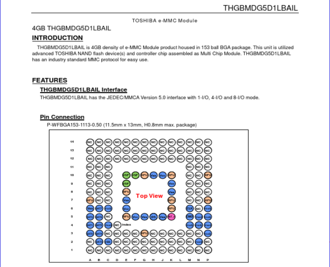

    Originally posted by Diah
    this related to ThinQ AI.. funktion
    instead of NOR / Sspi they used this.. if you get it out from the circuit you will see howmany pins are used 12-16 only... how it come eMMC work with just view PINS
    All necessary contacts are used, as with all eMMCs.
      as you wish & like.... i am wrong.chesrs

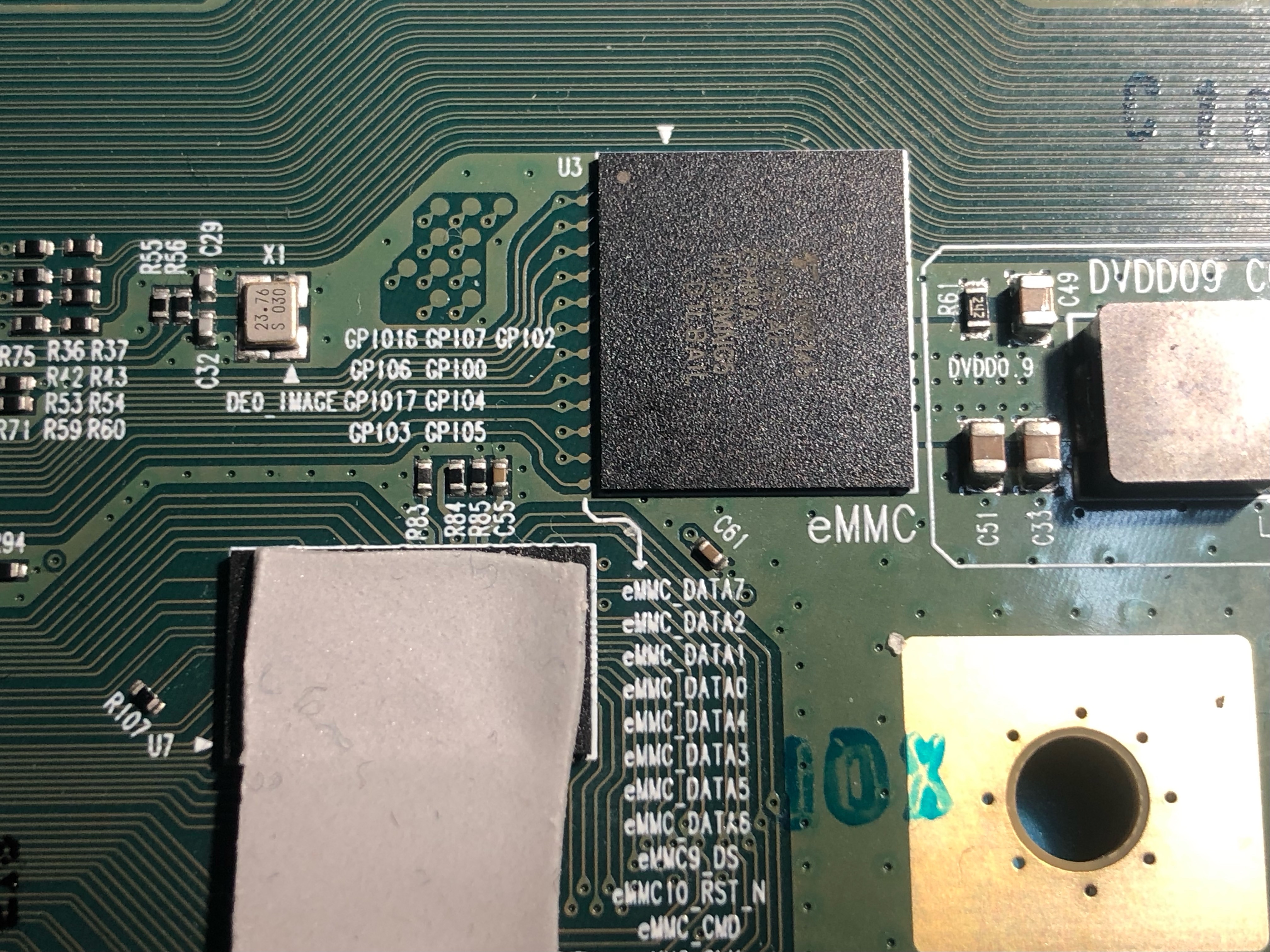

          i don't know from where you got this wrong INFO about OLED T-CON ? there are NO eMMC on T-CON at all...
          The attached picture shows the eMMc chip on my T-CON board, just to clarify your inaccurate statement. Click image for larger version
ID:	3203243 What I hope to do is find a way to test the eMMc chip and maybe even learn how to clone a good eMMc.

            why don't you start with the easyest things? Reflowing the ram chips / emmc..
