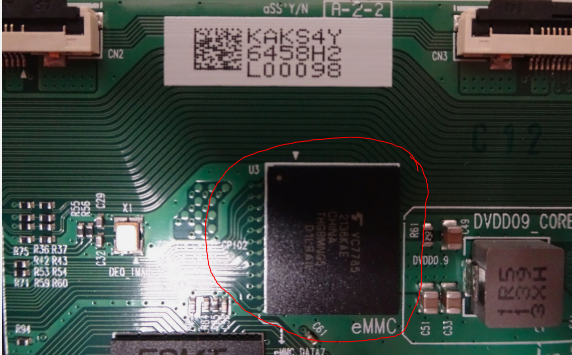

                                    i don't know from where you got this wrong INFO about OLED T-CON ? there are NO eMMC on T-CON at all... and the it Function not much different from LCD TV. the one things different on OLED it got to VCC T.CON 12VCC & > 21 OLED VCC which it power the cells. no more or less,,, it had RAM and SPI / NOR and CPU. any way... if you are repairing TV... you should have under hand some other type of power boards... for example i have one from Vestel.. i jumped it as standalone so i can use it always fas external supply for 3.3V, 5V , 12V and 24V. so i can test any TV / screen.. MB... T-CON with it... thought this boards i will never put it as replace at any coast.. so you need to look round you may have one with this specification range.
                                    • lotas
                                      • Jan 2016
                                      • 4854
                                      • Russia
                                      #58
                                      Originally posted by Diah
                                      there are NO eMMC on T-CON at all....
                                      What is this then?
                                      • Diah
                                        • Feb 2013
                                        • 6560
                                        #59
                                        Originally posted by lotas
                                        What is this then?
                                        this related to ThinQ AI.. funktion
                                        instead of NOR / Sspi they used this.. if you get it out from the circuit you will see howmany pins are used 12-16 only... how it come eMMC work with just view PINS

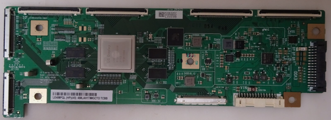

                                          #60
                                          just let the T-CON driver boards and the OLED module connected nothings ells with them, fed them with 12- 24V and you will see the screen if it fault
