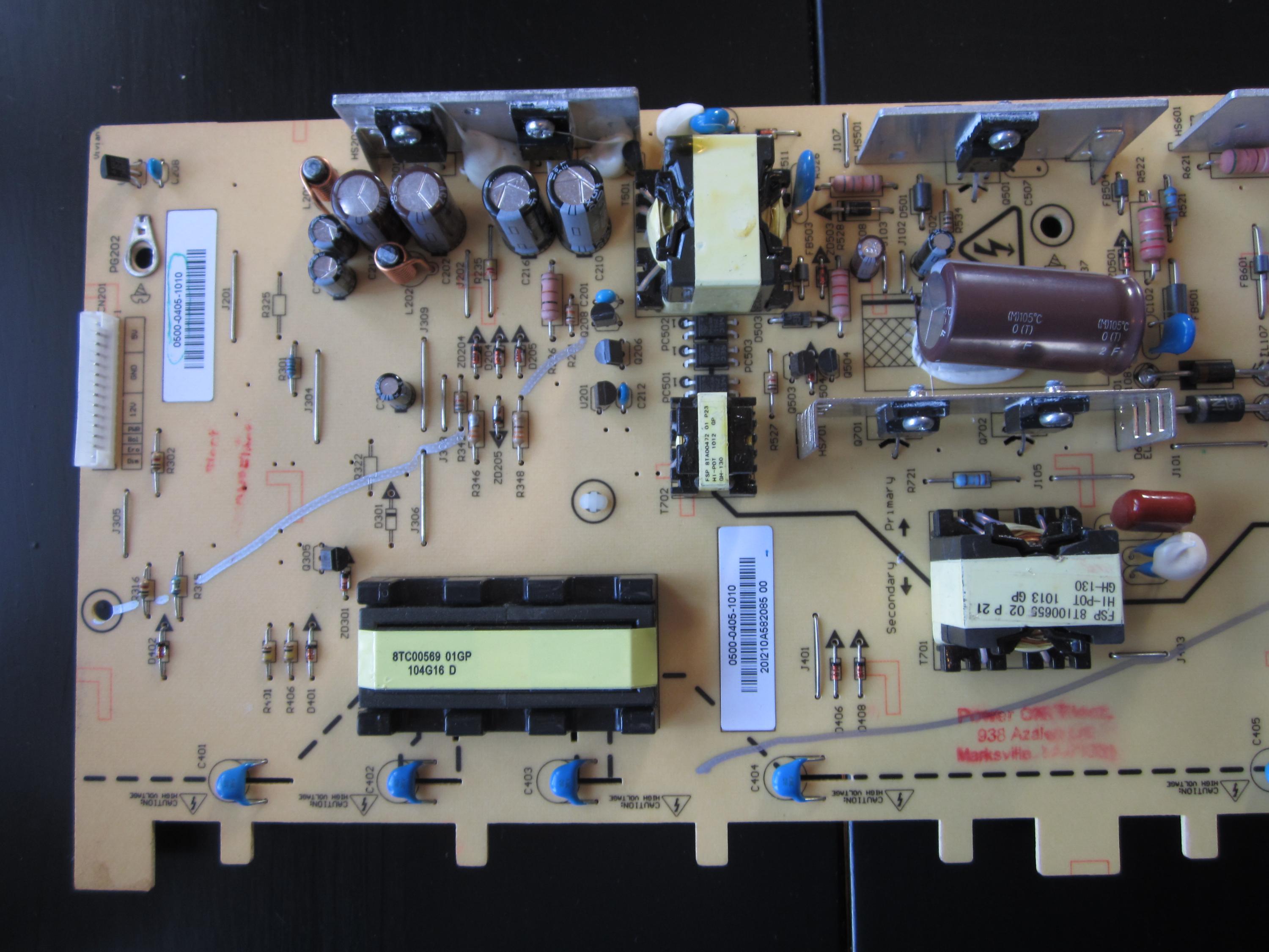

    A picture of the inverter board might help - if its a long board post in 3 or 4 close up pictures

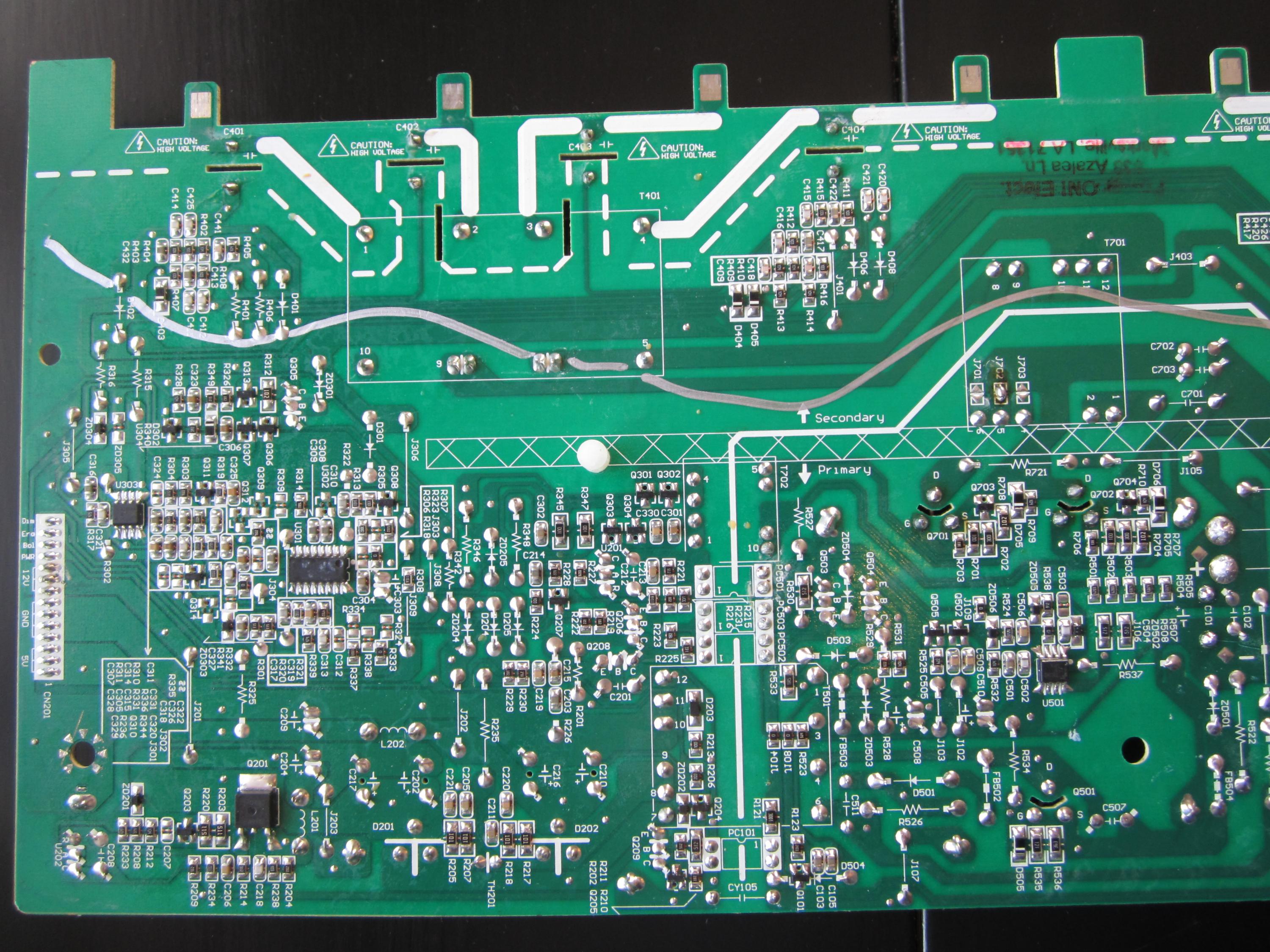

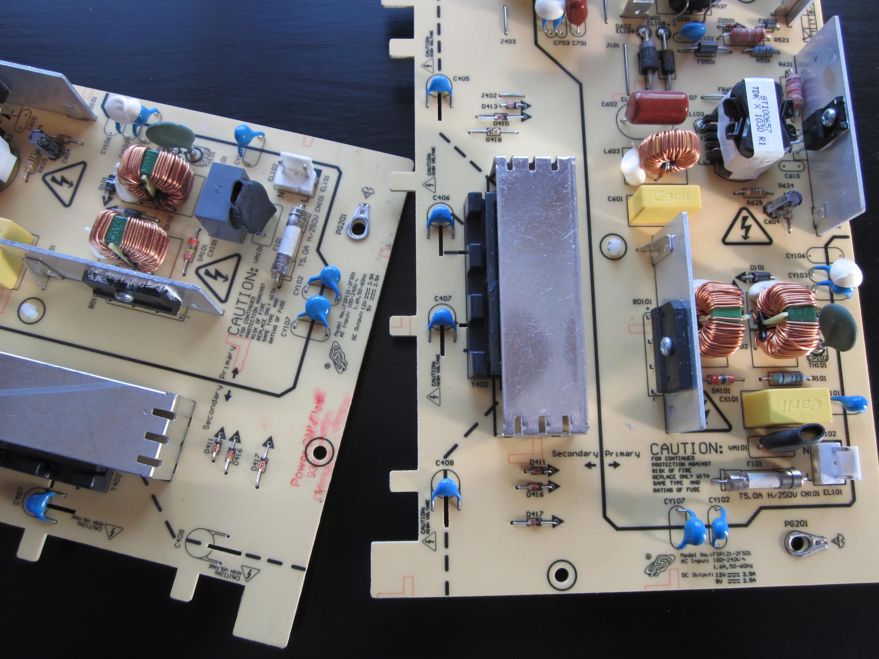

      Here are some pictures of the board. I discovered what had happened with the original board upon closer inspection and have attached a picture of that as well.
      On a closer look I found a component missing, location labeled C408 (first attached image) on the new board, but not sure how important it would be. It might have been there at one time by how the soldering remains on the back of the board.
      See anything else unusual with the replacement I had purchased? Would it still function properly with this missing?

        Many times there are different revisions made to the board to correct problems. I have run across this myself. Slight differences in board may not work in same set with a different revision or version number. Not the answer your looking for but it is a possability.

          the missing component labeled C408 seems to be part of the balancer circuit for the ccfl tubes, guess its value is about 15-30pF at 3kV. Take one out of your old board and solder it in place on the new one. It seems to me that C408 is an essential part for detecting bad ccfl´s...?
            Re: Vizio E320VL Backlight Issues, Inverter board?
            That is the ballast cap for the lamp, look at the other 7 blue cap to get the value.
            http://www.shopjimmy.com/vizio-0500-...t-inverter.htm
            So some one worked on this TV before you got it?

              Thanks for the help everyone. No the tv has not been worked on before. However the board that I purchase appears to have been tampered with. I'm going to work on getting it returned. If not I will replace the cap and hope there isn't other problems that are associated with this board that I don't see right off hand.

                OK - if you are successful in returning perhaps we can troubleshoot the old board. Are those small smd parts burnt - can you see what value is on them.
                Before you return the "new " Board see if you can see the values on there.
                or measure them- see if they are the same as the ones on the old board.
                If you can not return could borrow the cap from the old board and fit it on the new one.
