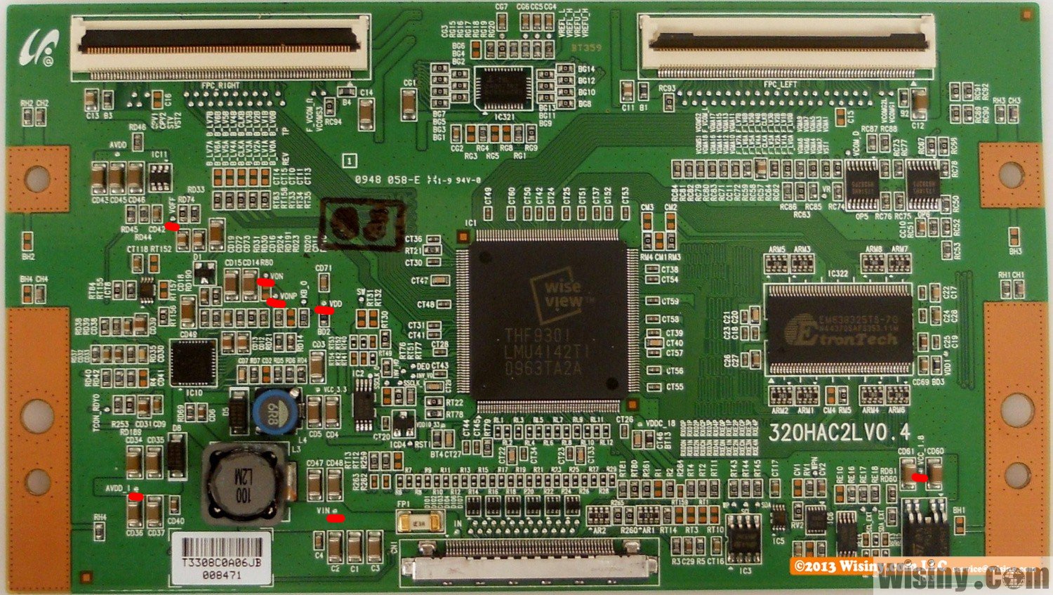

    hi just picked on of these sets up it uses the vestel 17pw25-3 psu and a 17mb454m-3 main board now the problem all psu outputs are spot on as per scheme the back lights are lit up ok and stay on i have 12 volts on t con fuse both sides so where do i start trouble shooting the sound is also fine.

          just no picture at all back lights are all lit really bright sounds great 12 volt on each side of t con fuse now just read this on another site!!
          To let you know...This is a universal test, any time you are trying to determine between a bad main board and a tcon/lcd panel if you disconnect the LVDS and reconnect it with the backlight one...if the screen flickers you have a bad main board, if it does not you have a bad tcon/lcd.
          yes when i reconnect the lvds with set on the screen flashes various colors. so whats your thought are they correct a bad main board.

            Well as it flashes colours when you reconnect the lvds ,from what you just said it could be a main board fault. Check the connectors for bent pins then test the voltage regulators on the main board.
            Hows the connector from tcon to panel
              Re: digihome 32860fhd
              Do check the VGH/VON and VGL/VOFFE on t-con board. Also, no menu? All regulators on main board OK?

                  sorry tom just saw you posted no no menus nothing at all regulator results are posted this is the tcon i cant find the locations to test and i cant seem to find a really good pic so you can high lite them for me i will keep lookikg though
                  320HAC2LV0.4
                    See here -- check voltage on all points relative to chassis and note readings.
                      avdo 12.00 volts
                      voff 00.00 volts
                      von 00.00 volts
                      vonp 00.00 volts
                      vcd 3.4 volts
                      vin 12.00 volts
                      vcc 1.8 volt
                      so where does the von voff voltage generate from?

                            T-con is not working. VON/VOFF is a sub supply generated off AVDD which should be about 15~16V. It is, however, vaguely possible that a control signal from the main board to the t-con is missing. Can you try checking any one of the VON/VOFF voltages when you wiggle the connector, just in case it is that problem.

                              yes tried the cables no change at all tom so before i order a tcon can i easily check the control signal from main to tcon or would i need a scope.

                                whats deceiving is that if i remove the ldvs cable whilst the set is on and reconnect it i do get some sort of a picture on the screen only for a second but its there thats whyb i was thinking main board?
                                  Schematic:
                                  Which socket is present, on last page? CN3, CN4, CN401, CN402, CN403?

                                    CN3 looks that one sorry tom edited counted pins in socket now
                                      What's panel number e.g. Samsung LTA32#####?
                                      • vinceroger69
                                        • Mar 2012
                                        • 6714
                                        • uk
                                        samsung LTA320HAO2 using cn3 in your pdf
