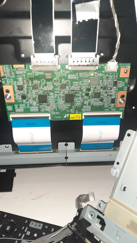

      That other reply to the post said maybe emmc is bad. Wel. old tcon was not good. The tcon processor chip was bad. no voltage was present there beside 12v..i sent that to the garbage last week.
      With this replacement tcon all voltages are present. picture is of the new tcon.
      https://i.postimg.cc/g24SQtZc/20240104-205331.jpg

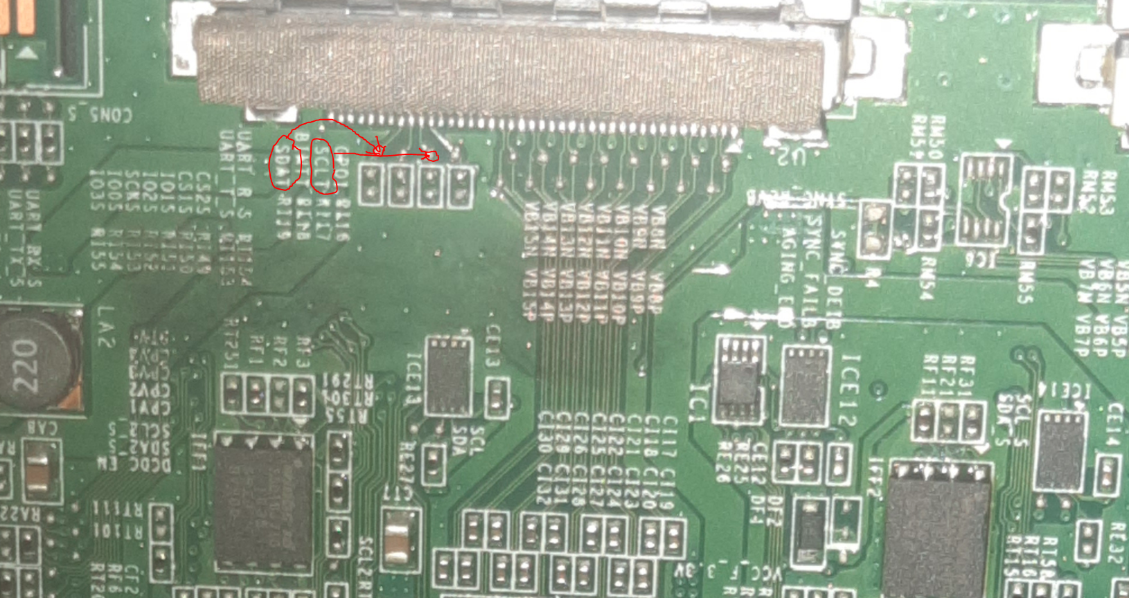

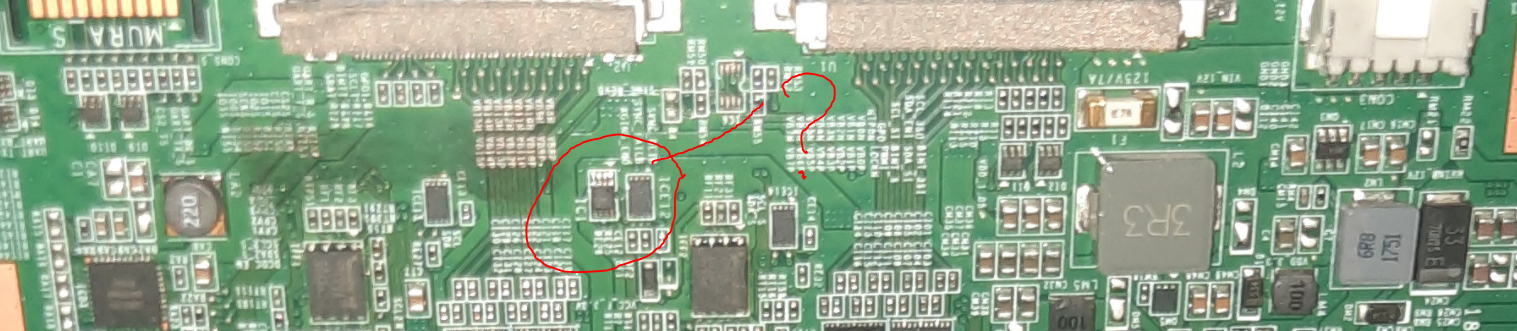

                You transferred spi flash winbord, this is not the same, you needed eeprom, where the key was located, ID t-con.
                Rather, any of these, their markings are hard to see.

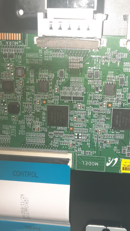

                  what.. winbond is the eeprom right. ? or there is another chip...? which one is it ? i will dive in the garbage container..

                    #29
                    these are all the ic chips it has.which one has the id's..?
                    https://i.postimg.cc/cJxm2hFc/20240104-215425.jpg

                      #30
                      You can determine which pins from those chips these control points SCL_T, SDA_T are connected to, I just don’t see the markings of these chips, everything is very unclear.

                              #34
                              all photos not clear... please upload clear photo on yours OLD and the new T-CON... and photo on whole back the TV showing how all boards connected..... you may have during your work damaged section on power boards of 12V rail of t-con support
                              please upload here dont use external server

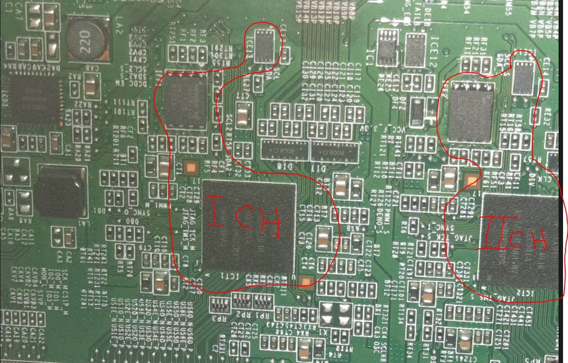

                                #35
                                There is no need to change these two large Winbonds, leave them in place, you need to change the eeprom, it should be one small one with 8 pin, nothing is visible from your photo.

                                      #38
                                      You have a dual-processor T-con and each processor has its own spi flash and eeprom, where all the settings for the panel are stored; they cannot be touched or mixed up!
