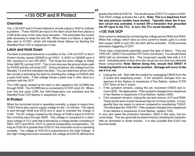

    I am repairing a Sony KV32fs12 which tries to start up and then stand by light displays 2 blinks.I have tested the flyback transformer and the HOT, and
    they have tested good.Can anyone offer any help with this problem?

              2 blink is the +135 OCP and H Protect to help determine which use this attachment,yes also what (freakaftr8) is saying a defective IC702 can cause this issue also
              Ron Driver,BSEE,CET,ISCET,NESDA
                          I have tried all that is contained is this attachment and the same problem is still present,very good information.
