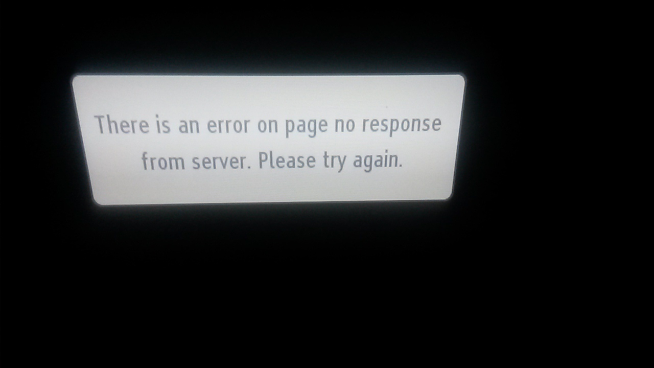

    Unfortunately Toshiba took all there TV firmware updates down a while back and I would like to put the latest core update for this main board on this Toshiba TV set as I am having a few issues accessing the Smart TV functions. Does anyone have access to the original firmware update for this UK model please?

      I was aware that Youtube wouldn't run. However I cannot access the Smart TV portal at all using the Home key! So hoping this will resolve. Just requested permission for access to the file from you via pm.

        you don't need to update as it will bring nothings... just try to upload other brand profile section to urs via service menu usb option

          I have already tried using SwProfile_patcher_kurulumsuz to add extra features. However as stated previously my issue is trying to get the Portal to the smart features. It brings up an error 'There is an error on page no response from server. Please try again'. So I believe there is software corruption as if I do first time installation it will reboot but just constantly flash red and green. After 5minutes I turn the TV off which finally brings up first time installation screen.
          I am going to get the screen panel files before I use the files arizanotlari has kindly provided above sometime tomorrow. I am just making sure that if there are any issues I will cover myself!

            SwProfilel.. will not effect on main sw. or RC, so the idea to use other brand SwProfilel from vestel direct, because toshiba stooped paying licensees fee of YouTube and others app on smart hub
            as soon you have access on root vestel shell you can have allot from this hub

                  I have updated the core firmware and indeed as Diah stated it hasn't resolved the issue of getting to the Smart features Portal. It has however resolved the issue of allowing First time installation without constantly having the green/red led flashing constantly!
                  So making some progress
