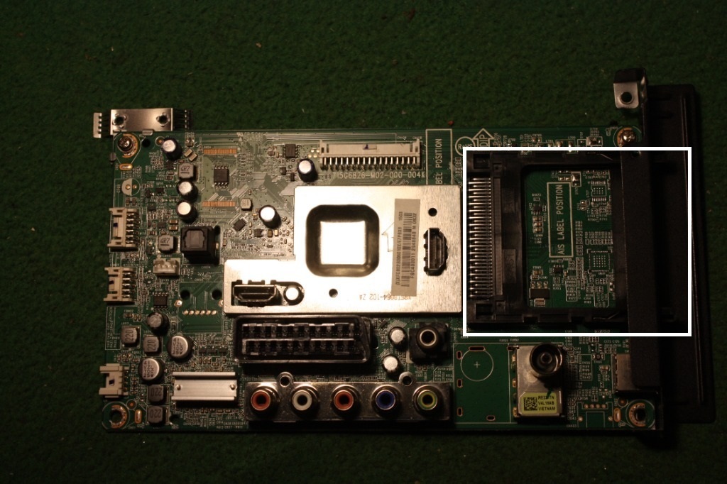

    Tv Sharp lc-40ld270e
    Hello everyone, I have this SHarp TV model lc40ld270e, I have it in storage for some time; When I turned it back on, it initially had a bluish screen, I replaced the LED strips and the image returned to normal, but it appears that there is something else worse; it turns off and on by itself; and the message that is in the attachment appeared, if anyone can help I would appreciate any idea or help, thank you

    A factory reset might get you up and running again.

      Hello, I have already done a factory reset and the problem continues, thank you for your contribution

    A question do you have any cards plugged into the PCMCIA type slot as this may possibly be causing the issue, that could be used for satellite or pay per view. Remove the card if you have one plugged into it. See attached picture for the reference to the connection.

      Hi, the TV never had any card, it always worked with a telecommunications operator box, thanks for your contribution
