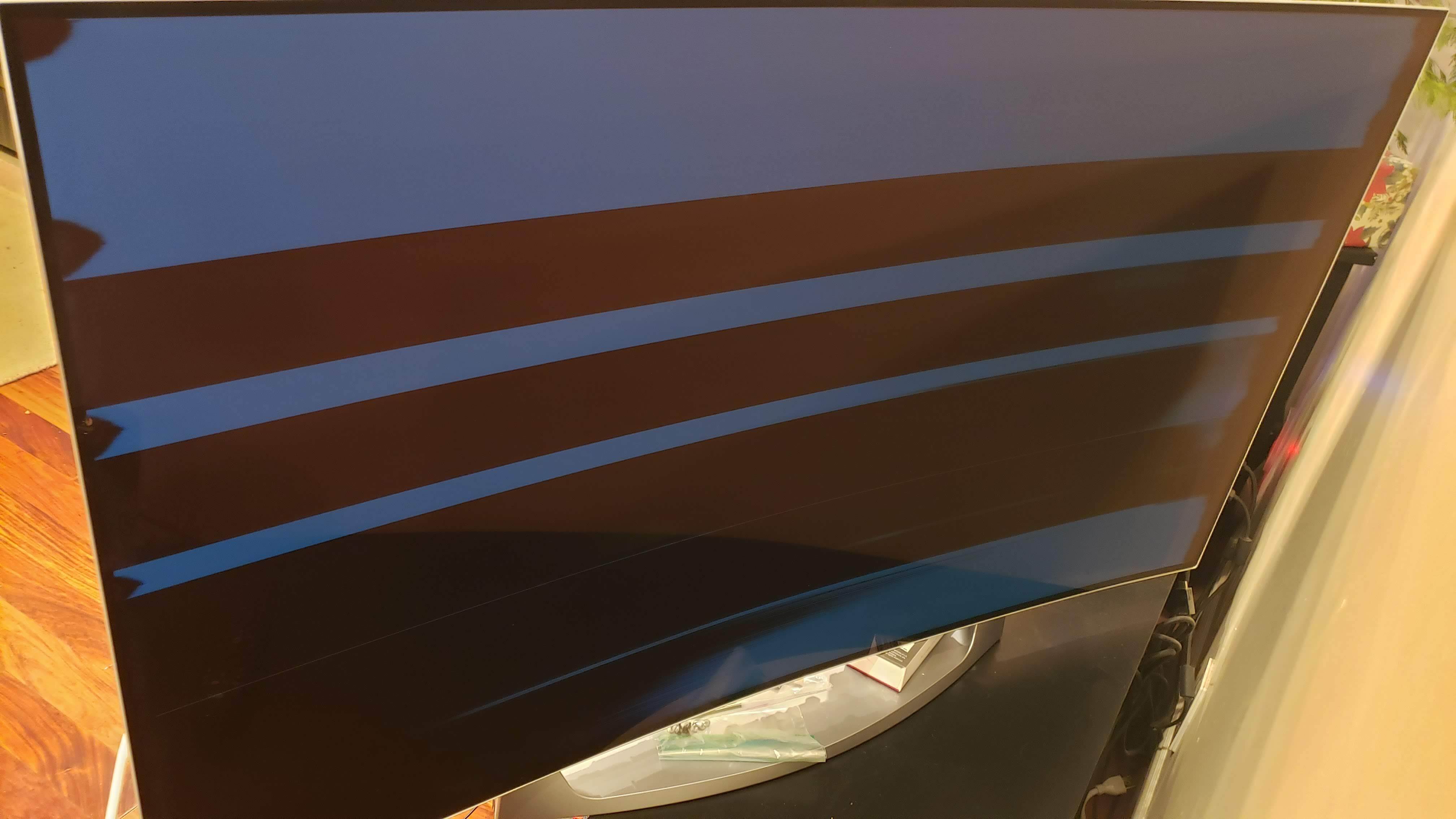

    It shows garbled washed-out white image on the screen; each time I power it on the image is a bit different. See the attached files.

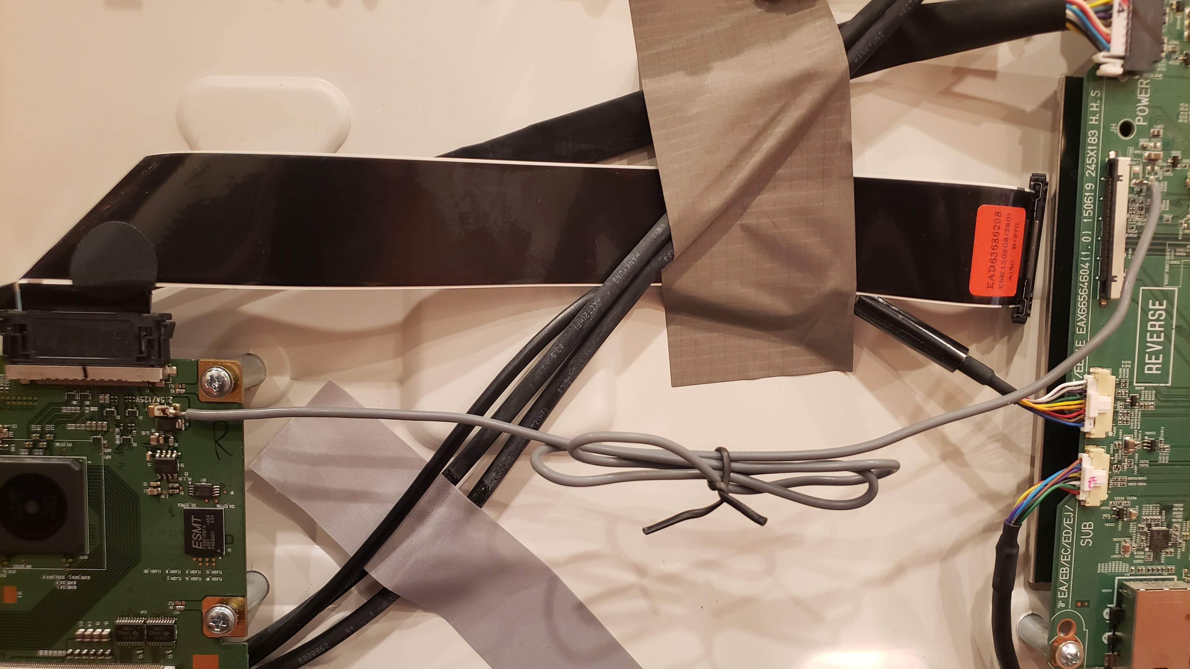

      I found a 12v pad near the t-con connector on the main board, traced it to the t-con board, then hard-wired it with a jumper cable. I hope that's the same 12v as the one on the power supply board...
      The picture looks a bit different, but is still garbage.
      Also: previously at every power-on the pictured looked a bit different, now it always shows this very same picture.

          You have done a different thing, you have to test if the 12v is present at that test pad because that 12v is switched , not good for me..

            Yes, 12v was present on that pad, and I got the garbled screen, as I already posted.
            Just in case, I wired 12v from the PSU to the 12v-input-from-the-main-board on the tcon board (as you ask), and repeated the test. The result is eactly the same: garbled screen.
            Interestingly, the garbled image appears when I connect the 12v jumper wire, and then remains on the screen even if I remove the wire.
