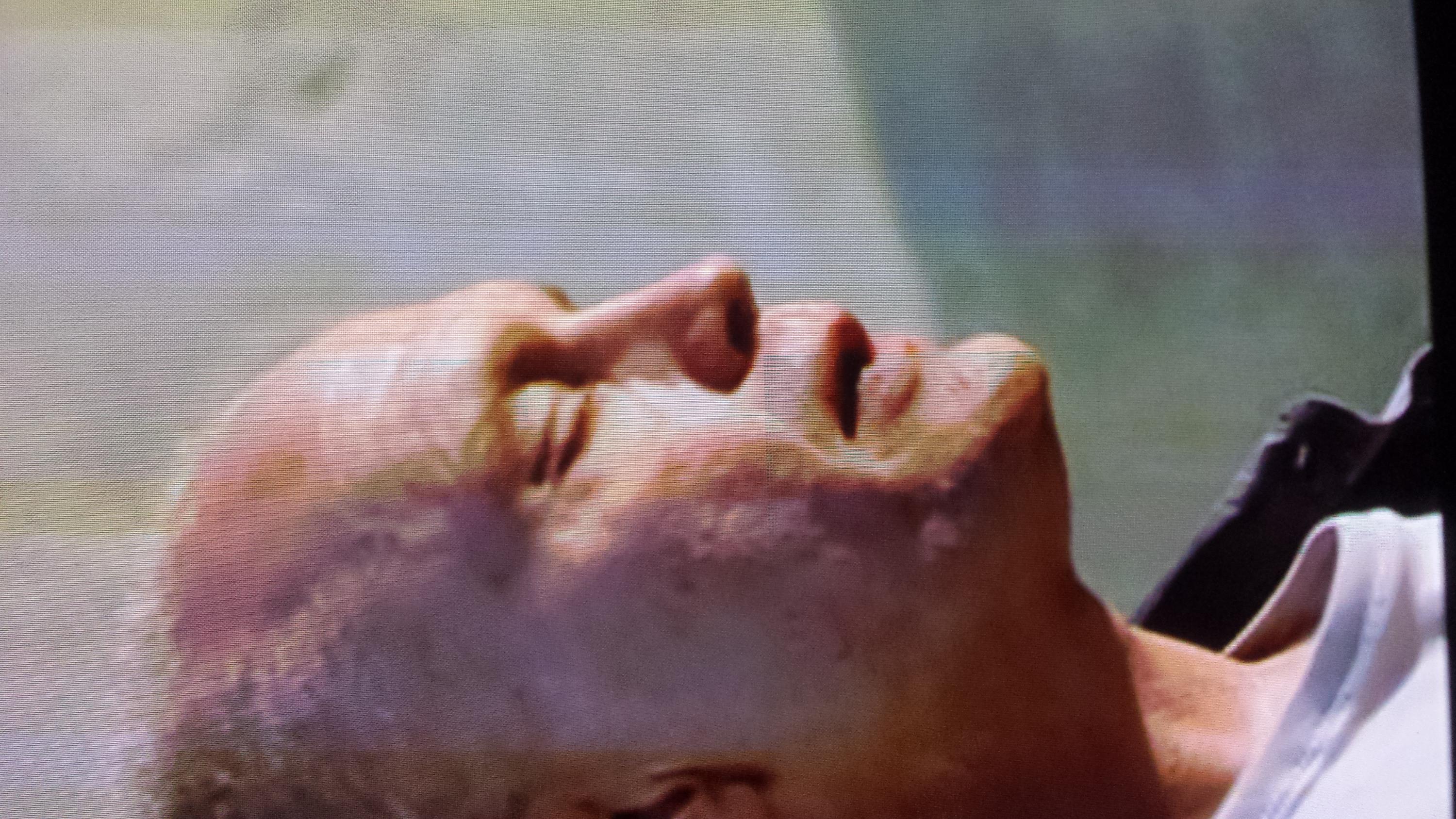

                  hi tom66 I have faded green band of colour vertical on my pannasonic g15 plasma any ideas how to fix
                  • millhouse187
                    • Dec 2013
                    • 3
                    • England
                    Re: Panasonic TC-P60S60 New and no go
                    picture has a green band vertical can see it on the guys face cant see it all the time ?

                      millhouse187 - it's easier if you start a new thread for your problem so people don't get confused about two different issues.
