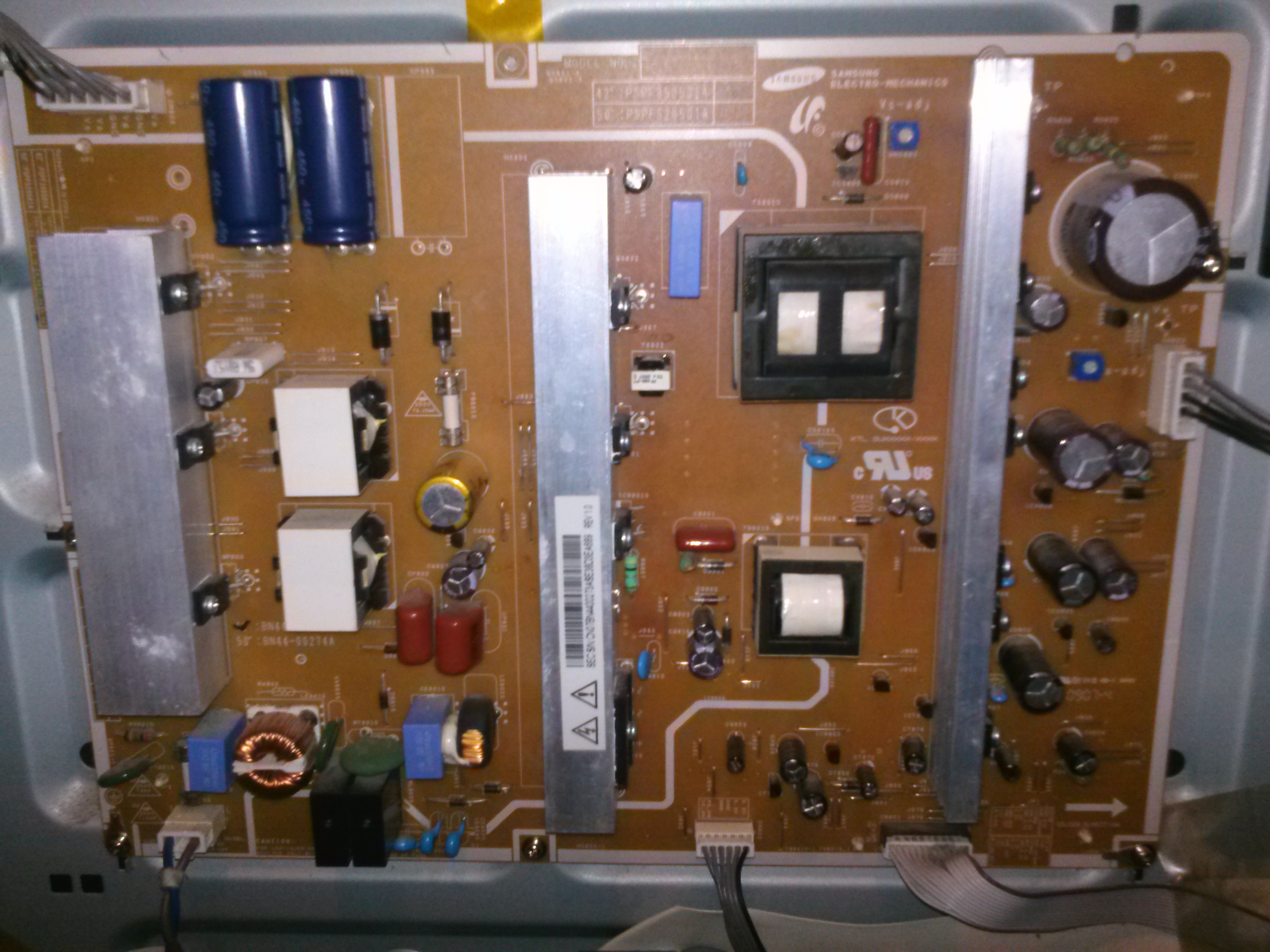

    Hi Guys
    I purchased this Samsung plasma on Craigslist as is and it powers on and about 5 min later shuts off the attempts to power on then shuts off then powers on again and will stay on for a few seconds then off and repeats.
    I have inspected the power supply for bad caps and all look good i also looked for cold solder joints and saw 1 that appeared broken so i re soldered it but still same deal... i have also tried unplugging 1 board at a time x board y board and i guess t-con? board and main board and it still cycle loops. is it safe to assume it is a bad power supply? i do have a multi meter if needed i just do not know where to start. any help would be appreciated and any information u request i will do my best to supply.Thanks in Advanced

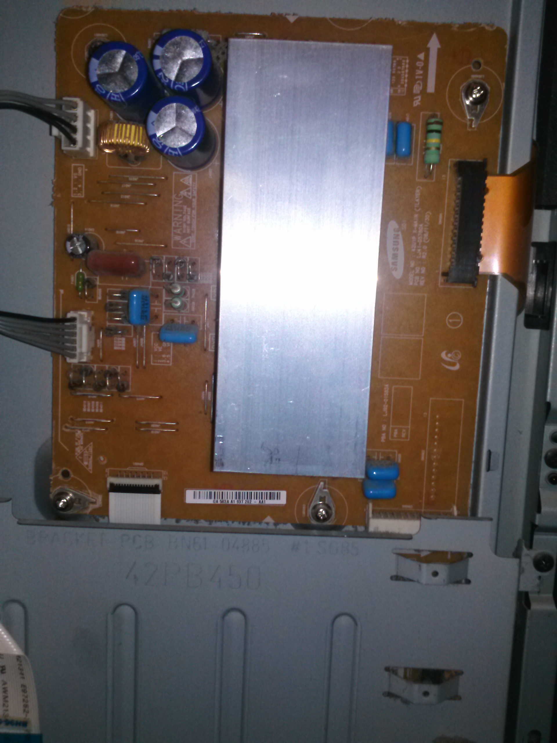

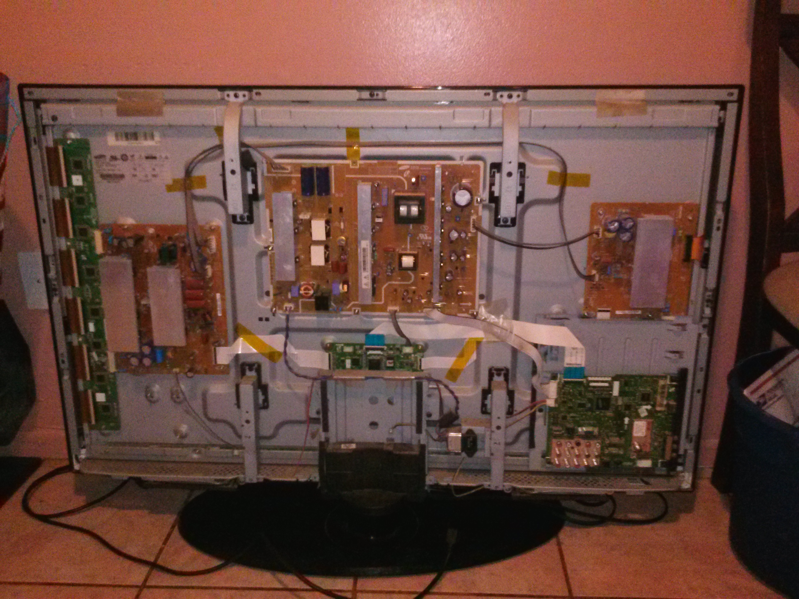

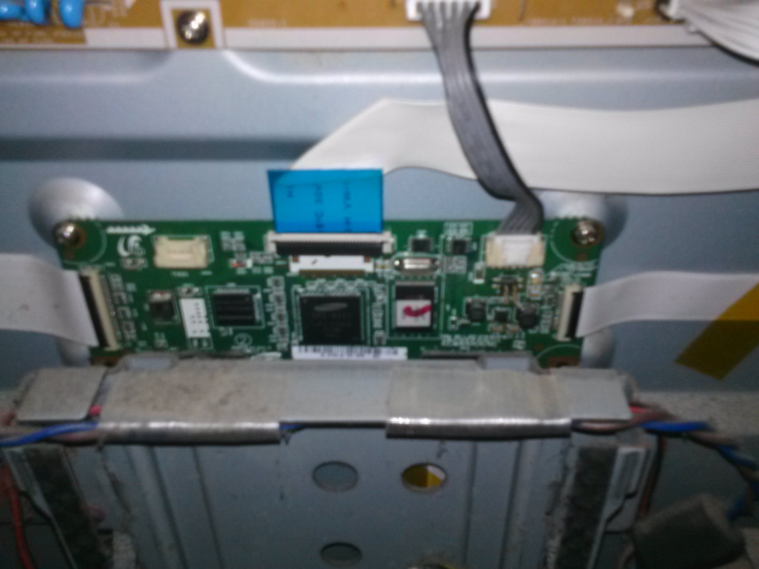

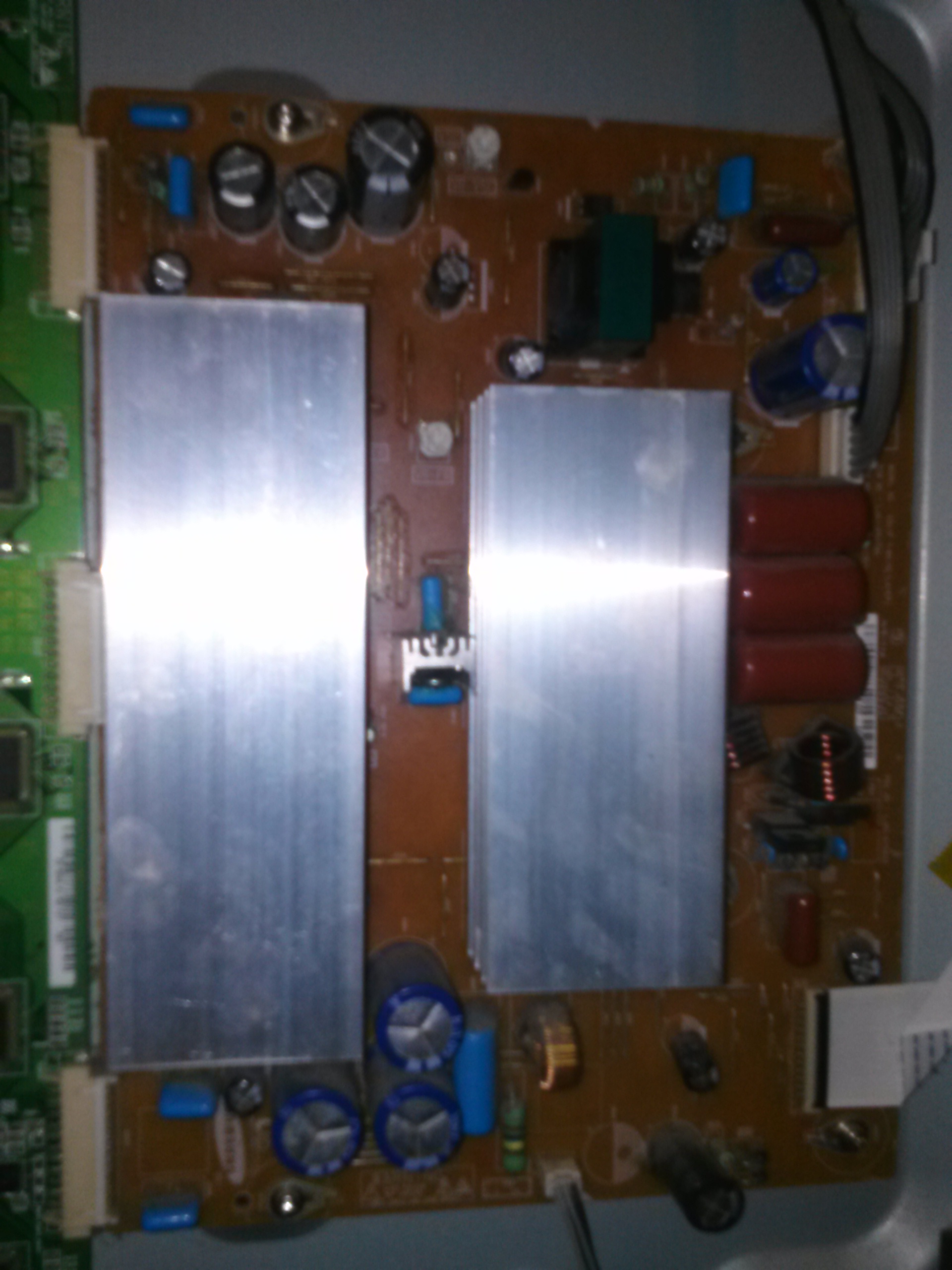

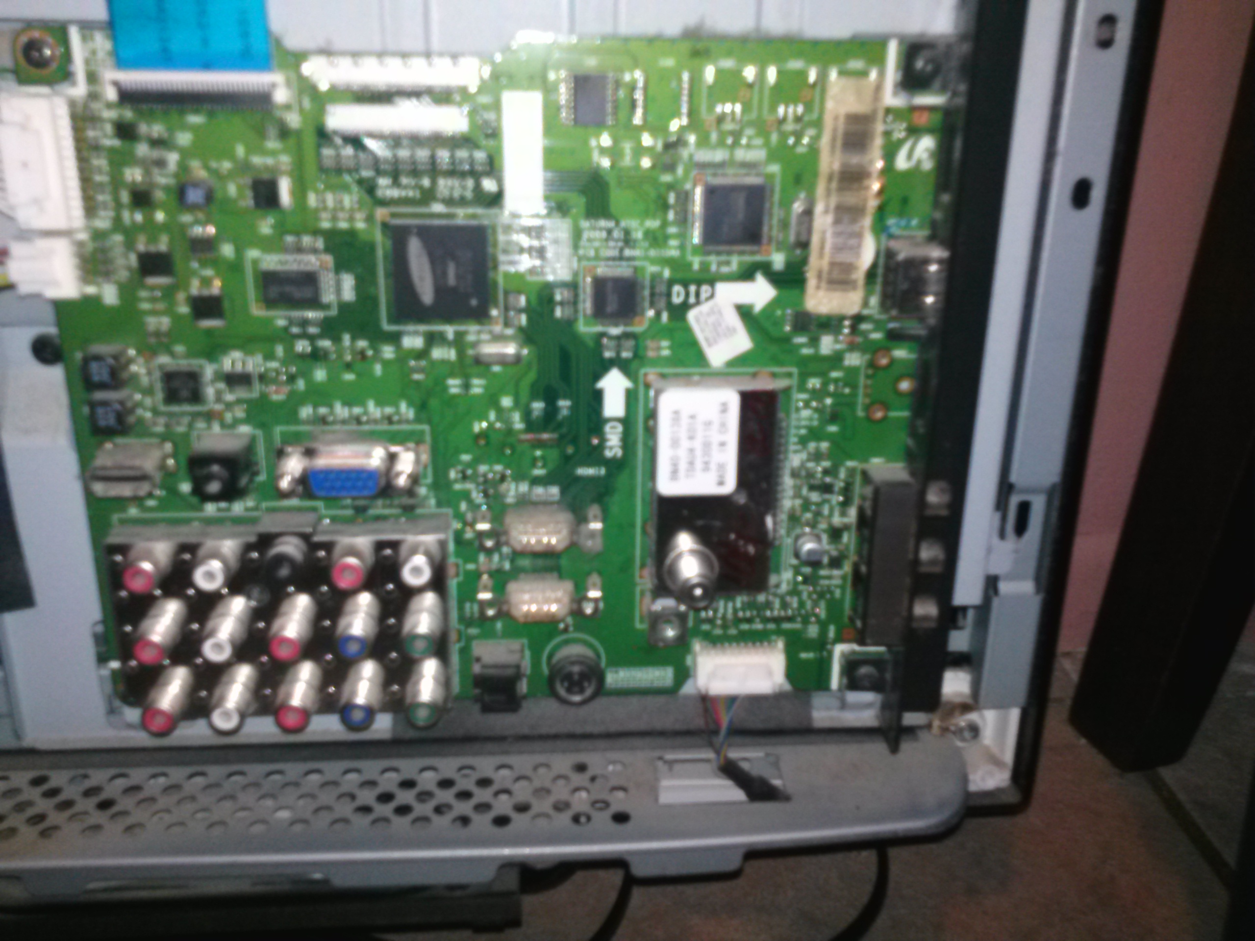

          ok i hit all heat sinks with the screw driver head and nothing happened at all i also took pics of the boards in case u need to see them

            Here are the pics
              Re: Pn42c450 power cycling
              Can you try with a hairdryer instead and see if you can make it shut down quicker by heating up parts? Focus primarily would be on the main board, control board and power board as before.

                i was actually just doing that i had the hair dryer on the power supply board on high and full heat and it did not shut off any faster than normal
                i will try the blower on the other boards now

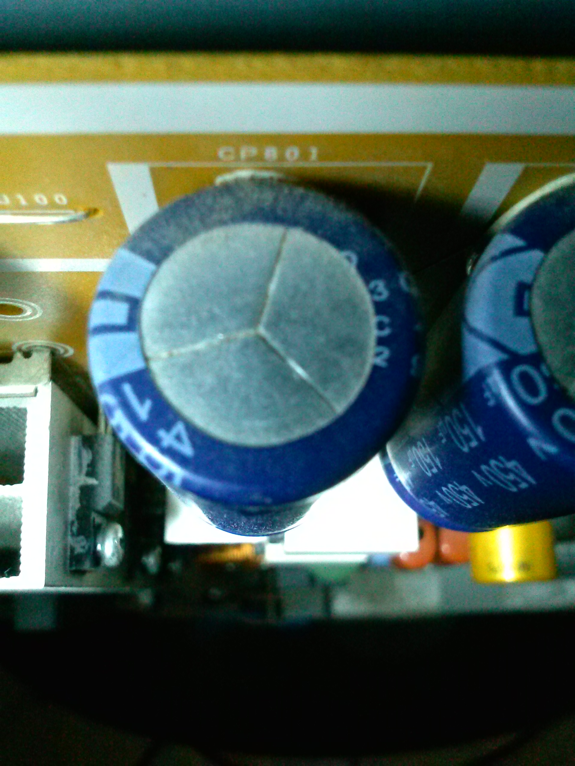

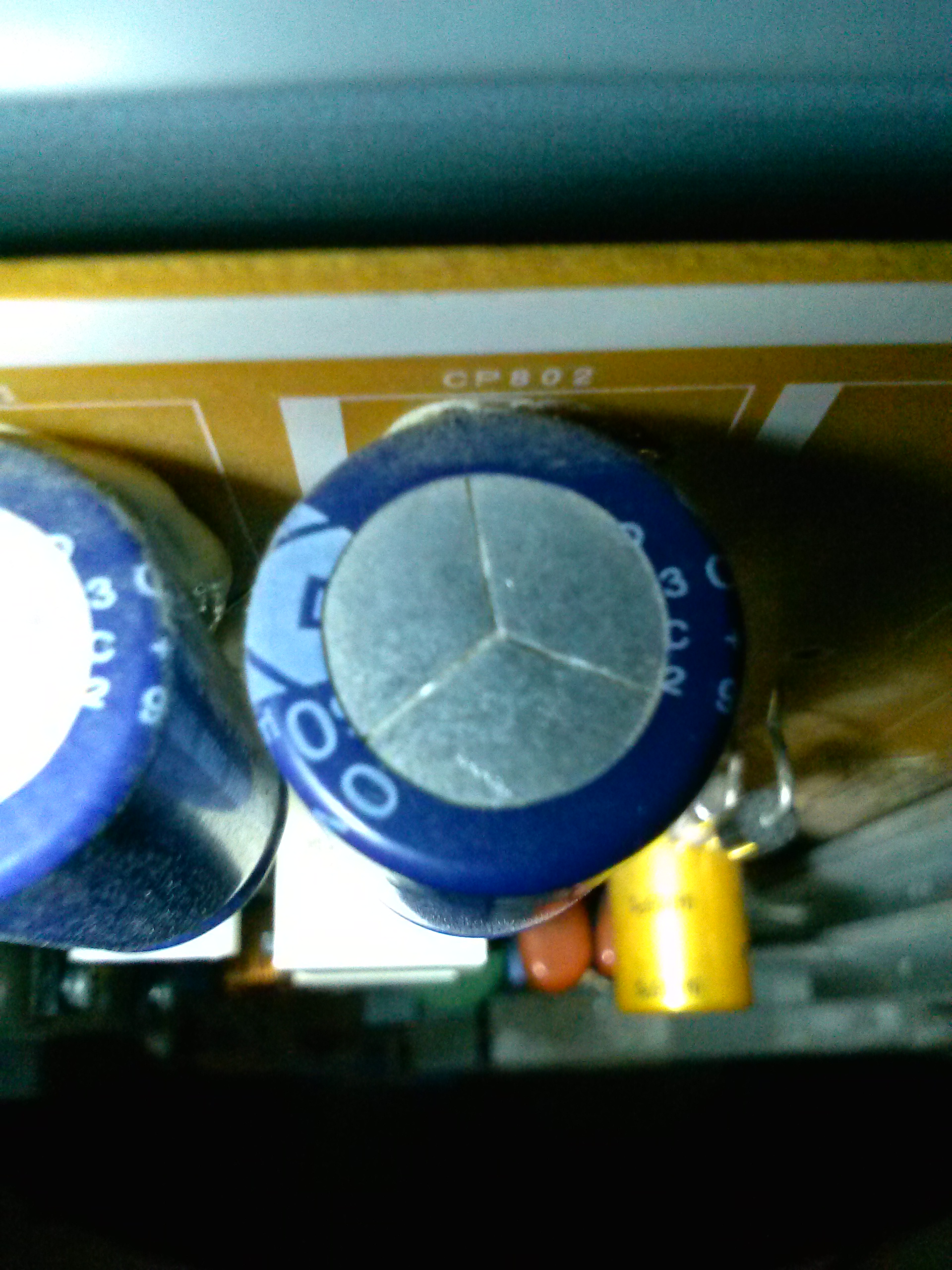

                Also if you would take a look at these 2 450v caps on the power supply in the pics below although not bulging, when i look at them in the i guess marcedes sysmbol lines instead of it being all solid metal connected like the rest i can actually see what i believe to b the inside of the cap that cruddy stuff but i see it only in those lines. u can see it in the pics could they b bad?
                  They look OK to me -- could just be dust.

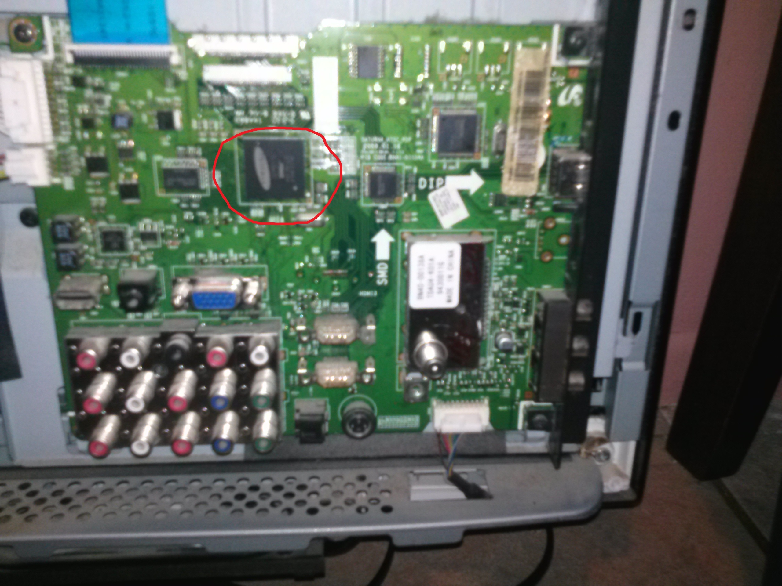

                    u are correct i cleaned them with a paint brush and it was dust.. i hit the blower on the main board. I assume the idea is to over heat the component causing it to fail? if so the tv did shut off faster when i heated the main board and will not turn back on its just power clicking
                      Wait for it to cool down and try again, but it seems like you have the common main board fault on this set.

                        i did and it definately shuts off much faster when i heat up the chip
                          Great, lead free solder strikes again... you can attempt a reflow (ala Xbox 360 RROD/PS3 YLOD) but the best overall fix is a complete replacement of main board, and adding a heatsink to that chip.

                              T board finally.came in i installed it and tv stays on. chalk up another one for Tom... good job mate... On a side note Tom i see ur in the UK.. do u know anyone in the Rfoc?
