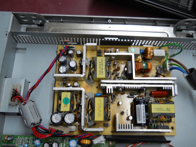

                    Re: Polaroid FLM323 Blue led, no video
                    This supply: Polaroid 846-240-H3CZZSH
                    In my pictures, the red circles are to inverter and are all 24vdc. The blue circles are the main board connectors. Red wires are all 24vdc and the one blue wire is the 5v ps-on wire.

                      • xyloeye
                        • May 2011
                        • 20
                        Power supply. My circles didn't show up. Upper left connector goes to main. Lower left to inverter.
                          Too bad, shopjimmy shows the bottom side of the board with the heat transfer pad still in place so I cannot see the trace on the bottom.

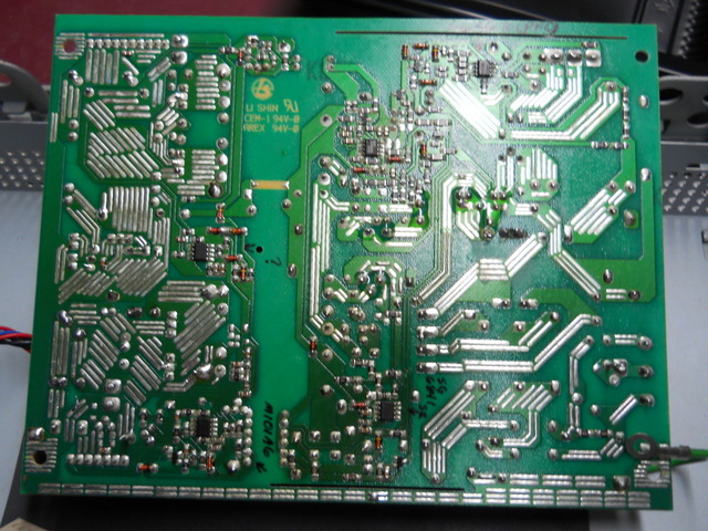

                          • xyloeye
                            • May 2011
                            • 20
                            Here's the trace side.
                              OK, I look at the FLM3232 pictures, after looking at the main board and I can see two switching buck regulators on the main board which now make sense that this power supply only has two outputs: one is the standby 24V power supply, another one is the switched 24V (turn on by the PS_ON PIN1 with the blue wire) for the inverter board. This power supply is same one as used in the FLM3232 I had with bad LCD panel.
                              So when you jump the 24VSTBY to the PS_ON pin with 5K (not 1K because the stby is 24V not 5V), the switched 24V and the PFC cap should go up. The inverter on signal and the Dim signal flow through the big multi-pin (50-PIN Centronix) on the chassis that will connect to the inverter board.
