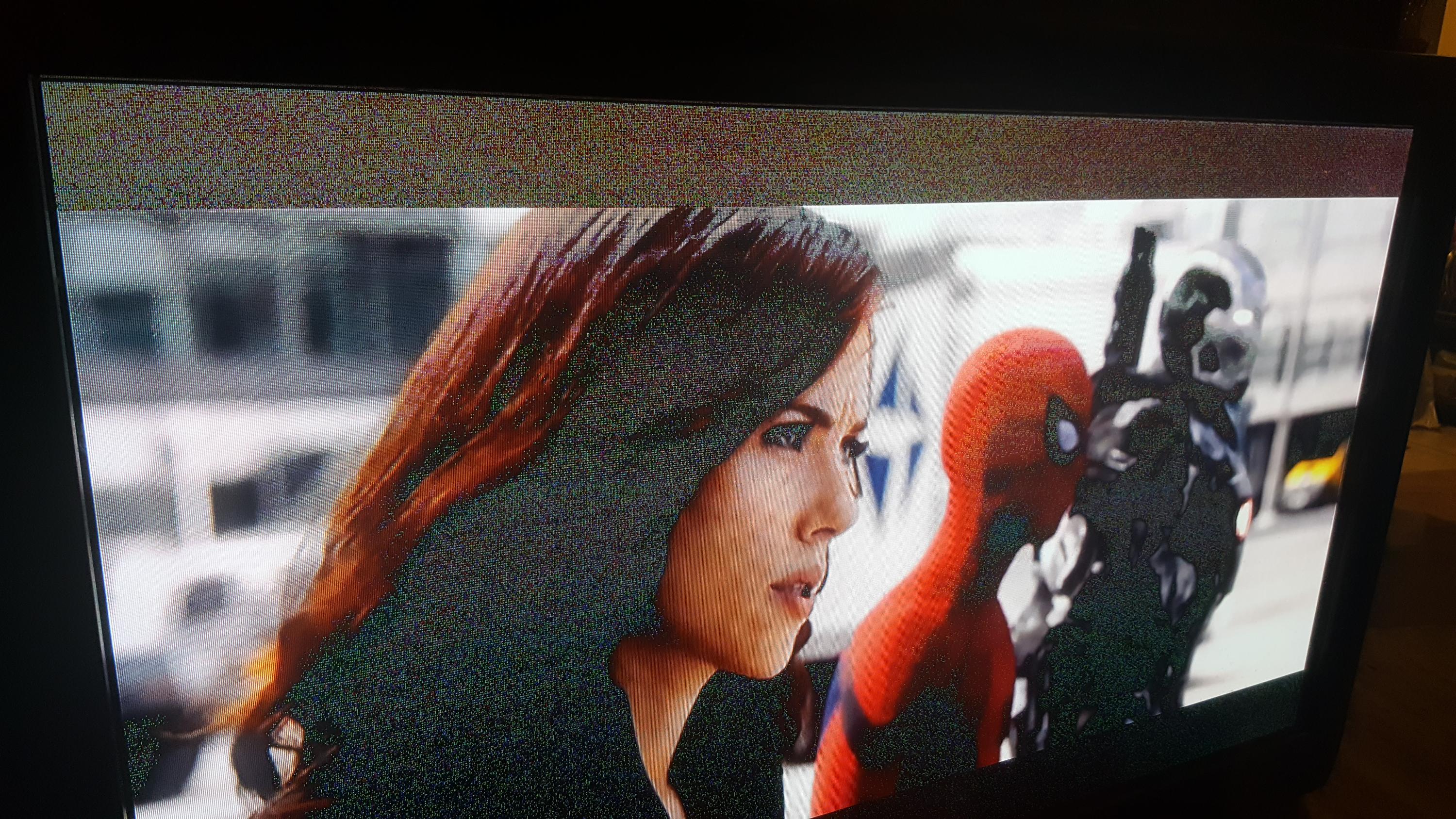

                • mbperez25
                  • Aug 2016
                  Re: Emerson PL-P42W-10A
                  pl-p42w-10a screen flickers from clear to fuzzy. any suggestions?
