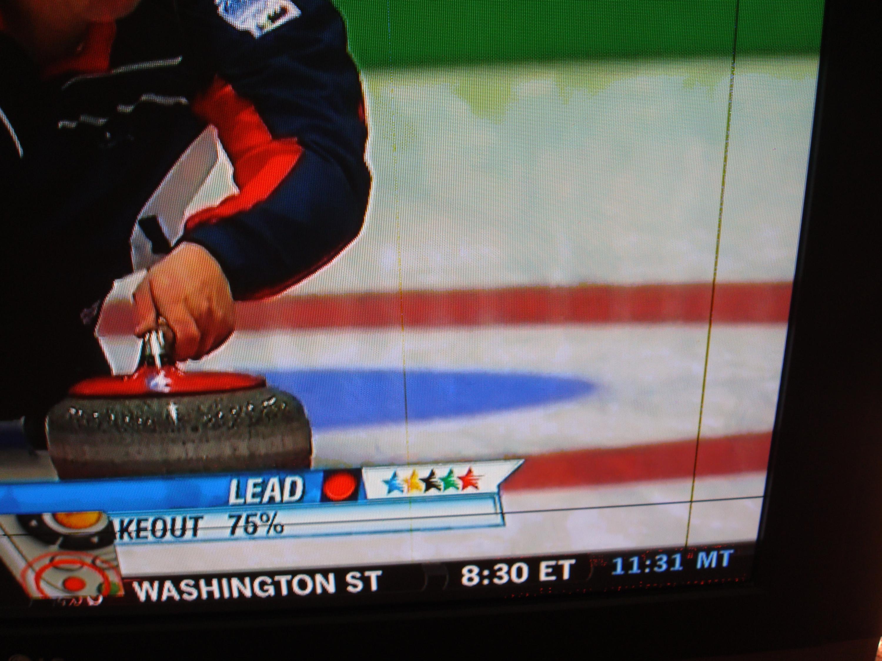

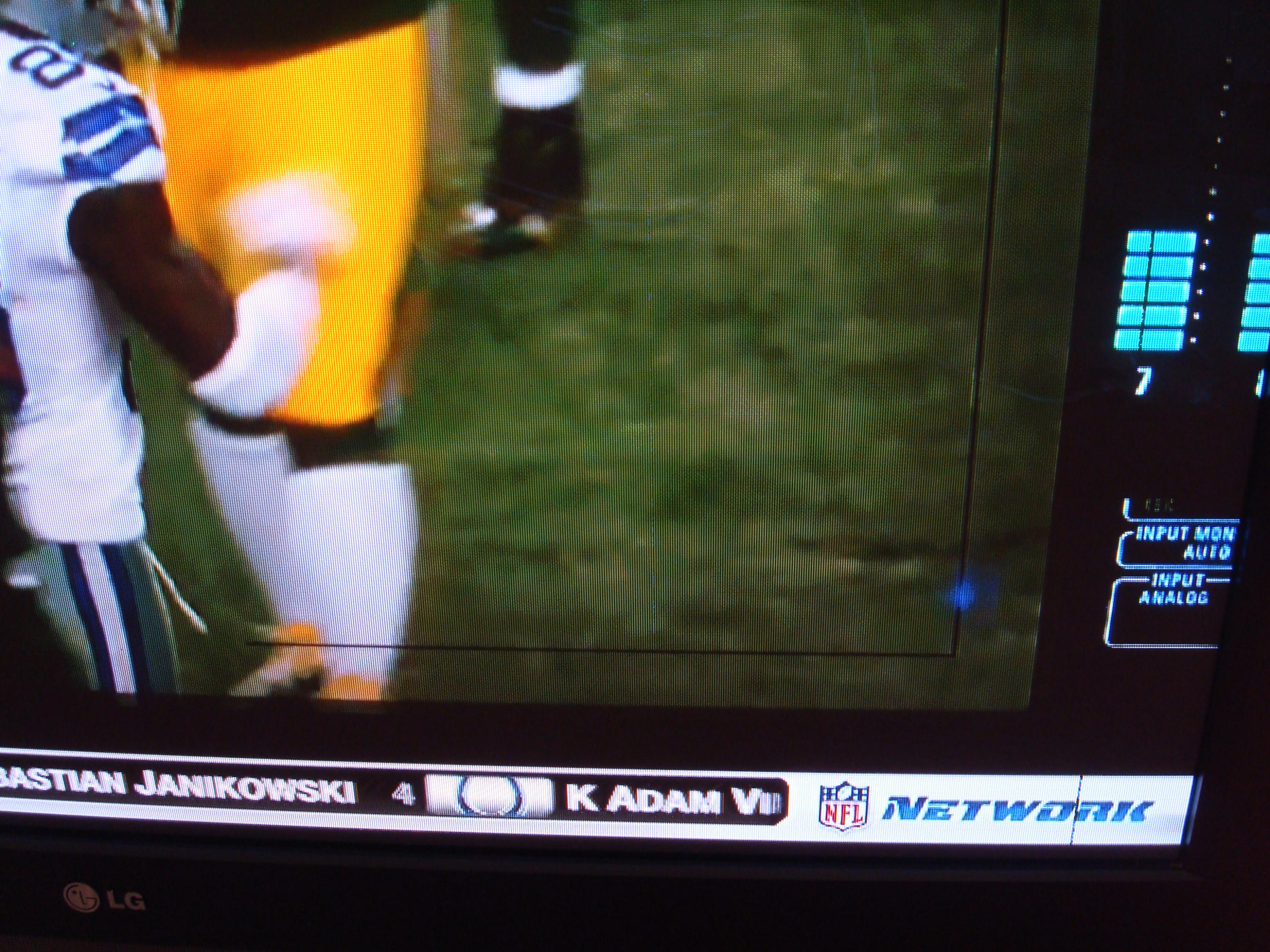

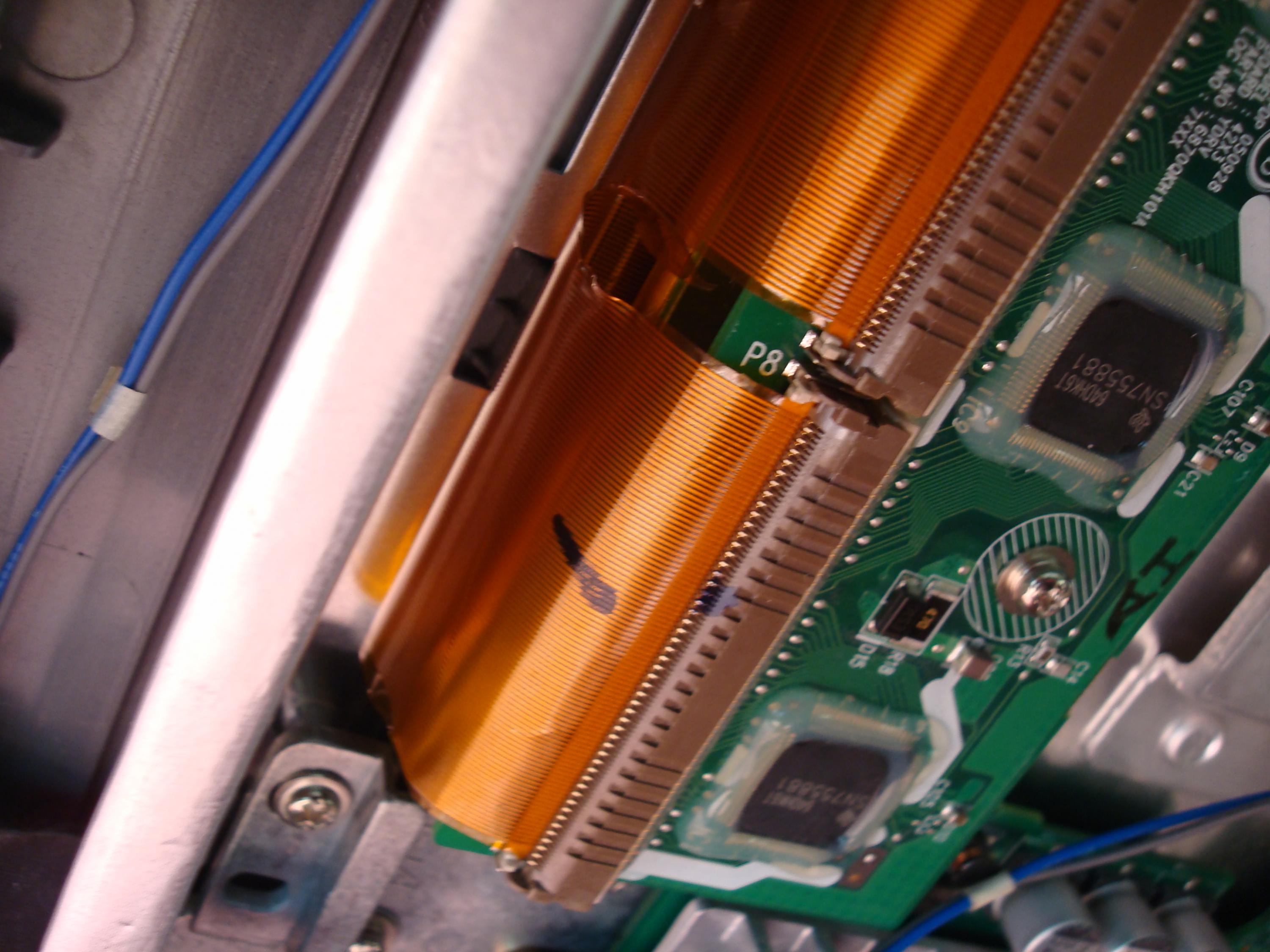

    Picked this up for $30 and a box of extra boards because this kid gave up on fixing it (red flag right there). Anyway, sound with no picture, blah blah. I read on here a hundred times, Y main and buffers. I replaced those and yes it fired right up with 1079 beautiful lines of HD video. However, I insist on all 1080 lines so I reseat the buffer cables a few time and still have one dead line. i notice now that the ribbon cable on the bottom is severed across one of the traces just about where the missing line is. I'm hoping this cable can be replaced or is this a deal breaker? Also have one black vertical line as you can see by the pics. Any advice, Godfathers of TV repair?

    Here's a successful repair to the Y-buffer ribbon, but it's an extreme long shot: https://www.badcaps.net/forum/showth...=Ribbon&page=2
    The vertical lines point to a panel issue.

        Someone was careless when removing the ribbons from the y and x drivers.. Have you taken a magnifying glass and lookek for cracks or a broken line in the cables? Creases in the cables or the sort? I have had luck repairing this fault before fut its not easy. However I have also made matters worse on another set I tried to repair this fault on as well and shorted out the whole x driver IC.. If you cannot find the fault in the ribbons, sometimes its just not worth it.
          Re: LG 42PC3D 1 lane severed on Y Buffer ribbon
          That intersecting fault to me looks like one bad pixel has damaged the connection to the others.

            Finally got my buddy over here who is an expert soldered and he rigged up a microscope on the damaged ribbon, scraped the insulation off 3 or 4 lanes of the ribbon. Then he soldered little wire jumpers across the damaged lanes. First he did one side and rtv'd down and let it cure for a day, then soldered the other side down and coated that with rtv. It took care to the horizontal lines but I still have one vertical line on the right hand side, black and 1 pixel thick from top to bottom. Re seated the cables all over the place many times but can't get rid of it. Don't tell me it's the panel after all this surgery.
              Sorry, those lines look like panel to me...
