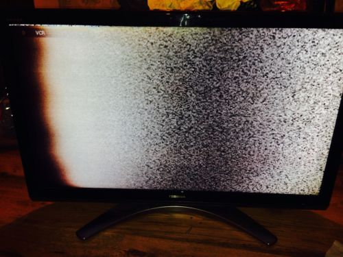

    Toshiba 47Z3030DB
    Panel Fault?

          Re: Toshiba 47Z3030DB
          Panel fault.
          These Toshibas are well known for this, have a 37Z3030D with another panel fault... argh....!
            I have a 47z3030 with same fault any one know if it is the T con
              It's the panel but you might be able to fix it by removing a tab driver
              https://m.youtube.com/watch?v=s7sFN7Iwx8Y
                Many thanks will try this do you know is T-CON BOARD 6870C-0072A is for this model?
                  I don't know.
                  But the fault isn't the T-con.
                    Please can you explain what the fault could be same a image at top when you swith Tv on after 15 minutes it goes and have no problem untill you stwitch off and turn off
                      When the connections to the gate/tab drivers fail, it can cause lots of odd picture faults.
