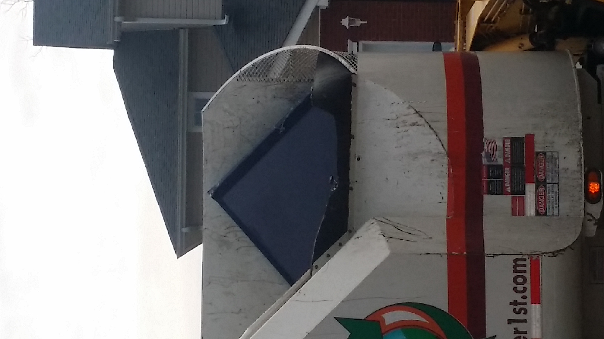

    I don't mean to jack your thread. but i just buried my LG 60in Plasma today due to a cracked display . I actually had to help the trash man get it on the truck. with that said i did take out the boards.(it was an organ donor) I was gonna list them on ebay till i saw this thread. My Model # was a 60PK750. not sure if the parts are interchangeable or not. if I can help I'd be glad to have the memory of my TV live on making others happy.....

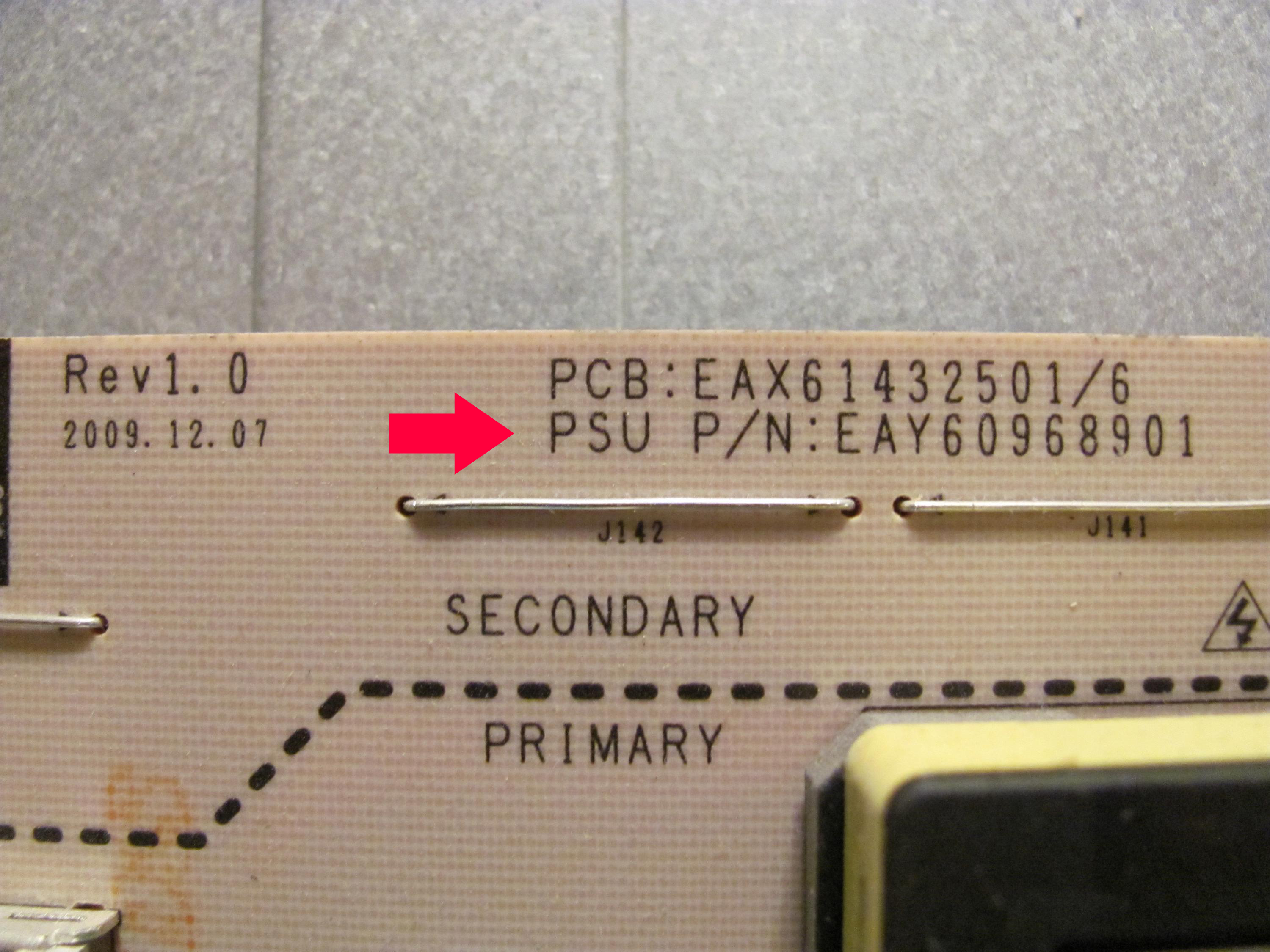

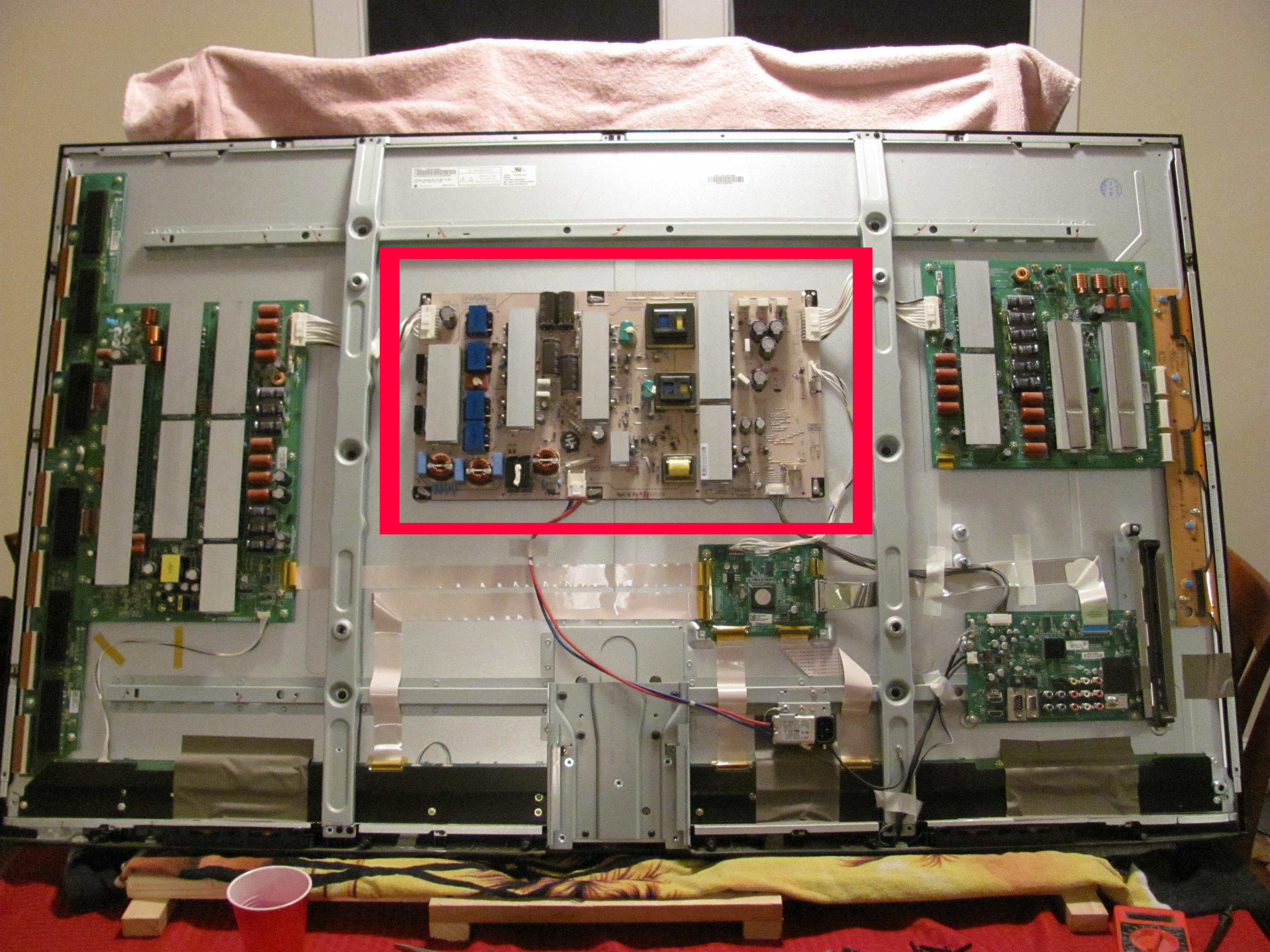

      @ 102mm thanks for taking the time to reach out! If you could take a peek at your power board to see if they're compatible, that would be great! The power board is the tan colored one that was in the centre of the panel. If you take a peek at the top of the board you should see 2 sets of numbers (pic attached) The top one should be the same except for the number(s) after the slash. The lower one should be identical to mine. If it is, they would indeed be compatible and make a good candidate for donation!!!
      I'm sorry to hear that your display cracked. How did that happen? Mine usually lives on a wall mound that extends away from the wall for access to the cables and such. Every time I pull it away from the wall, I can't help but imagining the mount failing and the thing coming crashing to the ground. They've got great picture but they certainly are heavy sons-o-guns…

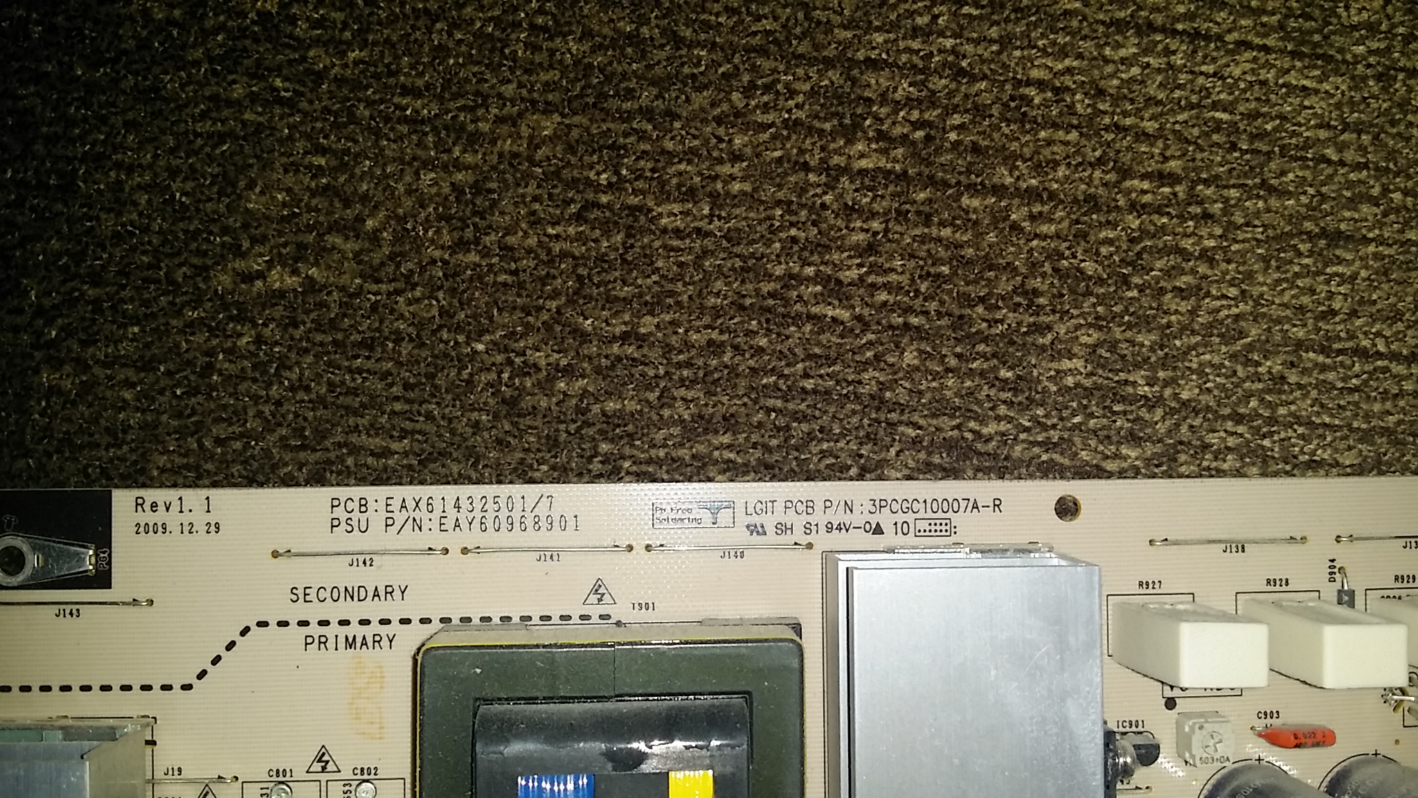

                                      Eay60968901
                                      My tv has a problem, it turn off immediatly
                                      I check the fuses and diodes
                                      A resistor 5WJ10 ohm is dead
                                      I can check anymore?
                                      I replaced the resistor and now works fine
                                        #99
                                        Re: Lg 60PK550 Problem
                                        Originally posted by rinoronie View Post
                                        Hello, I'm italian.
                                        i have a lg 60pk780 tv
                                        PSPF-L914A
                                        Eax61432501/9
                                        Eay60968901
                                        Yesterday I had same problem
                                        I replaced the resistor 5WJ10 and now my tv works
