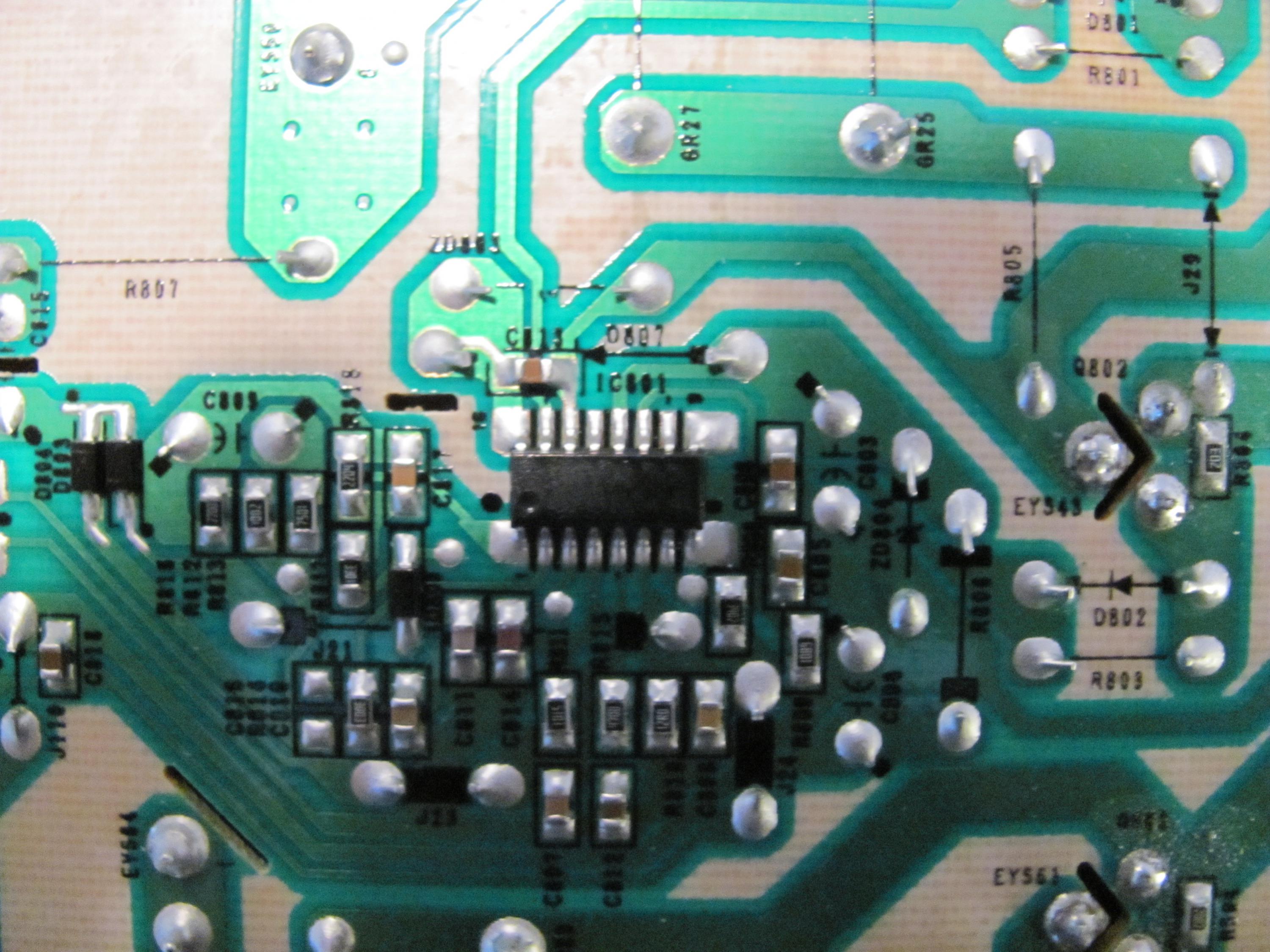

                      You should also replace the IC which drives those FETs, if there is one on that board, otherwise, they may fail immediately on power up. Picture of underside of board near FETs?

                        I'll snap a pic of the underside when I get home. What exactly is an IC?

                          Integrated circuit -- will be in charge of driving the MOSFETs.

                              This is the nearest IC. All of them are pretty dang small and are all soldered straight to the board. I'd have to get a hefty magnifying glass to read the markings on it.

                                That would be a suspect, I would advise replacing it.

                                    Okay. Got the parts. Swapped them out. Still works intermittently. Still makes clicking noise (though more static/click hybrid sounding) from the same area. I got a loupe and looked at the numbers on the IC. It looks to be an "ST" brand circuit There are two rows of markings one at the top that I could faintly and not concretely make out as "L6591AU"
                                    The other string of characters is below and to the right of the ST logo and is indecipherable. Nothing comes up in google for the numbers that I think are stamped on there. I'm wondering if I should just get a new board at this point. I found one on ebay here:

                                        Missed your post, but L6591 is probably the part #. Did you replace that chip yet? It can be difficult, but if you can remove it, then you can put it back on. No harm trying if you're going to get a new board anyway.

                                          Thanks for the reply. Googling L6591AU returned no results but leaving off the "AU" gave me what appears to be an AC/DC circuit with the same number of pins as the one on my board.
                                          http://www.digikey.com/product-detai...art_dkc_buynow
                                          I'll give it a go.
