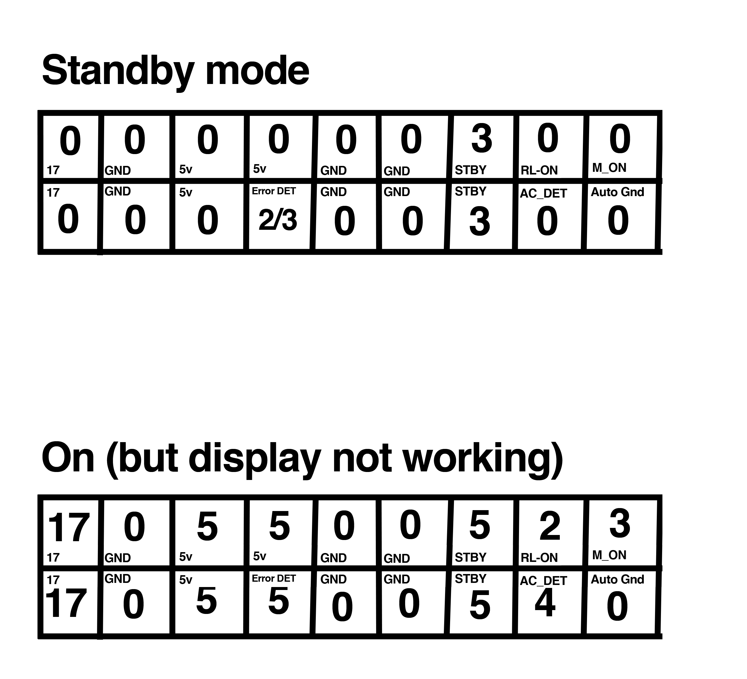

      Attached is a pic I made that documents the voltages I get coming off of the power board going to the main board. I used a needle as my positive probe and probed the pins in the jack itself so I could leave it connected. Does any of this information tell you anything? the 2/3v on Error_Det indicates that it was flickering between 3 and 4 v. I also took similar notes on all the other jacks coming off of the power board going to the Ysus Zsus and logic boards if that information would be useful.
      As an aside, while I was probing around on the Power board/Main board jack, The the relay clicked off and once I powered it back on the display worked. So I toggled it on and off a few times. After about 3 cycles, it went back to its dormant state. I may have accidentally bridged a couple of pins as I was probing, but not knowing what I did (if anything) I couldnt replicate the results. While the display was on, I measured the Zsus resistor on the board I had just swapped out and got a steady reading of 110v while it was on.
      Does any of this make any sense? ShopJimmy is sold out of the power board I need, and it's $160 anyway. Being $50 into this with a likely unnecessary Zsus board. I'd love to be able to fix this cheaply.

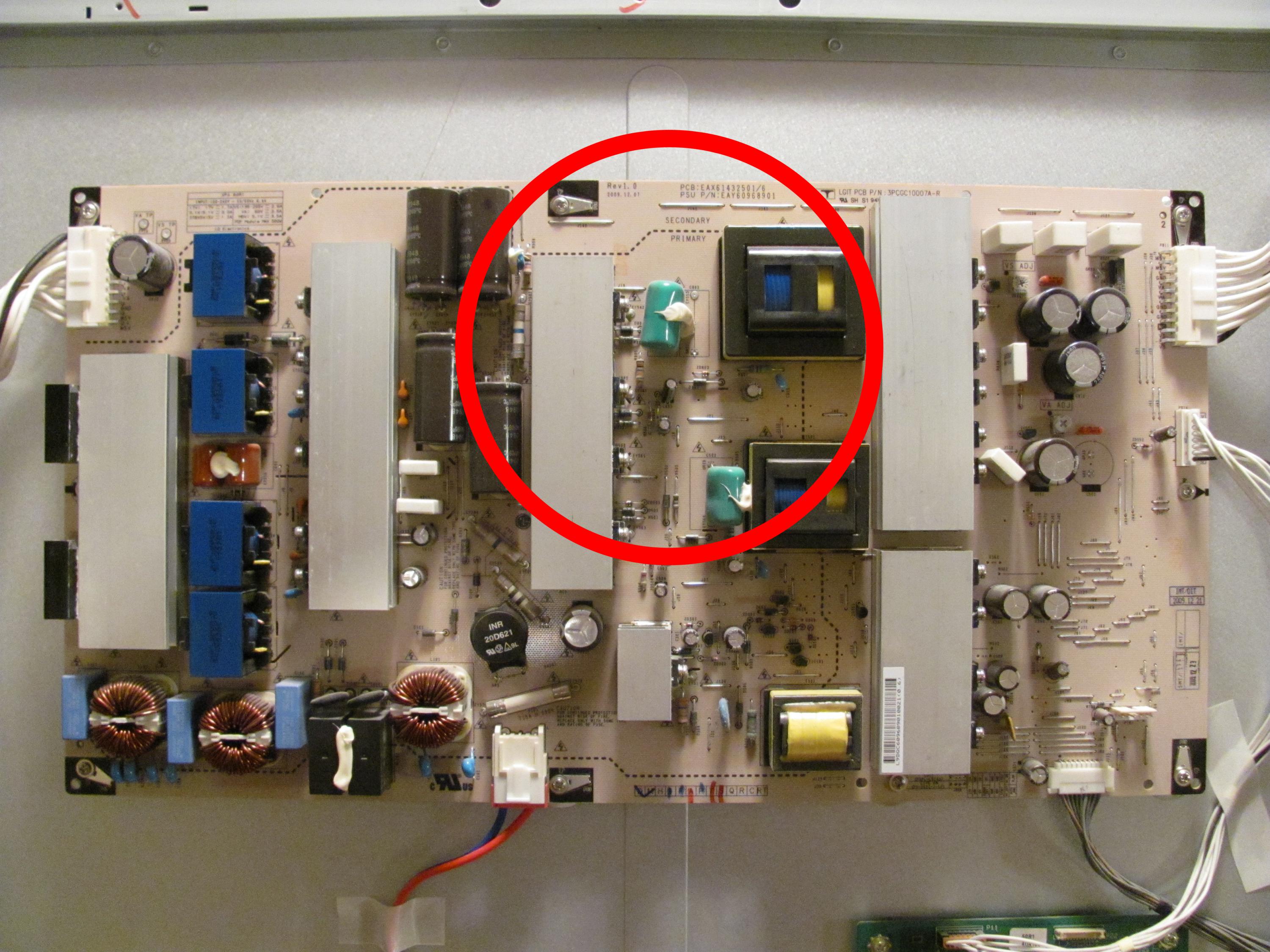

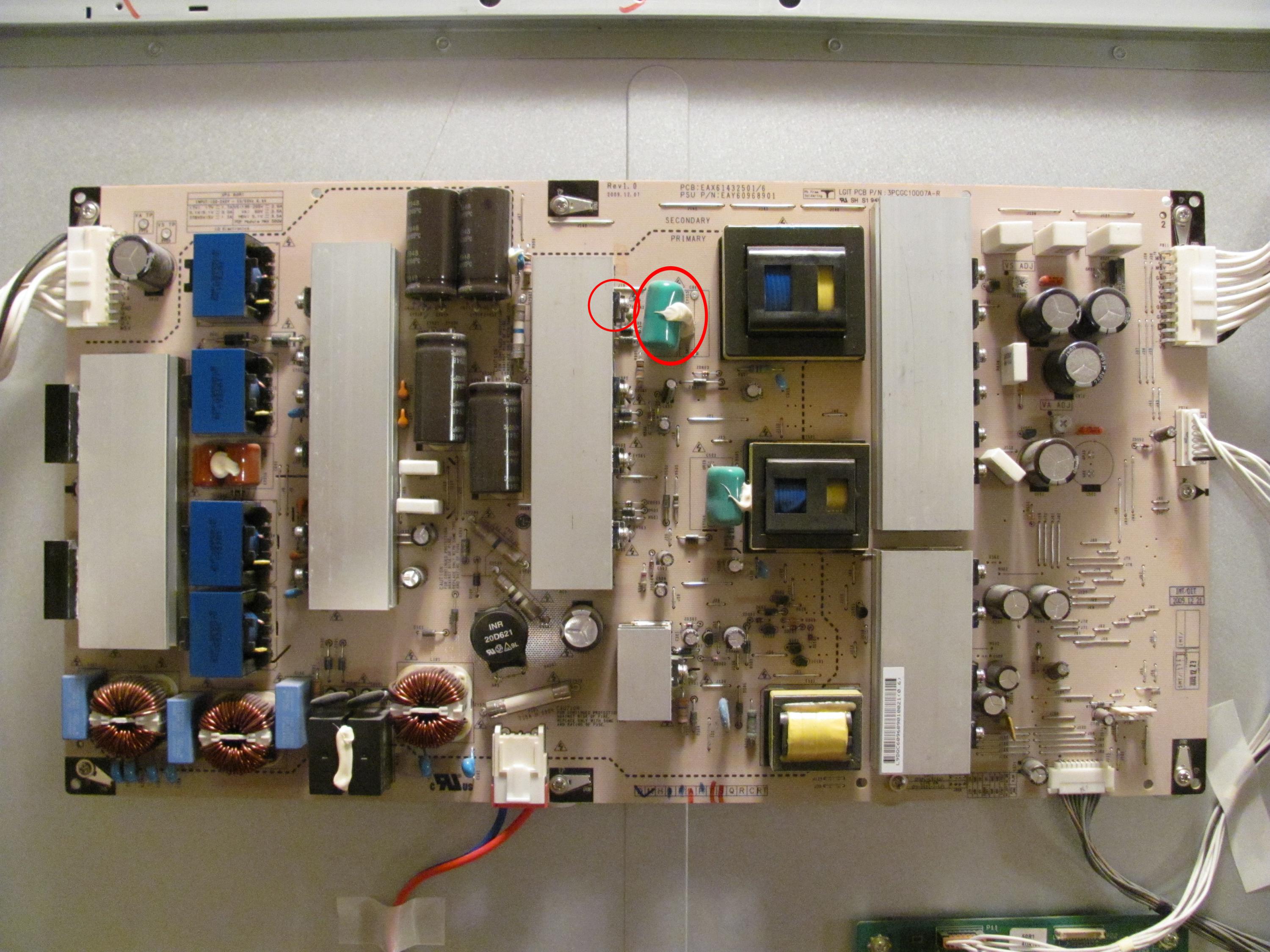

                    Update. I took the power board off and inspected the joints paying special mind to the voltage regulators. It was kind of difficult for me to discern which joints are good or bad, so I added a bit of flux and re-flowed a few of them. I also added some solder to a couple that looked a little skimped out. I plugged it all back in and nada. @Tom66 I also checked the capacitors closely and didn't see ANY bulging at all, nor did I see any of that brown goo that sometimes leaks from bad caps.
                    I proceeded to check the voltage regulators starting with the ones screwed to the heat sink where the ticking was coming from. I apparently have no idea how to check a voltage regulator. I was getting readings all over the place on both the input and output pins. One problem might be that my multimeter isn't auto ranging. I looked up the spec sheets on the 2 types of VR involved and both say that the input is +/- 30v but that didn't seem right to me when I checked it. I also may not be correctly interpreting the spec sheets.
                    Anyway...
                    When I checked the topmost VR, when I probed what I believe to be the input pin, the ticking noise sped up. Thinking that was fishy I tried heating up that VR by itself and after a minute or so of heating, I pressed the button and it turned on. I think I may have found the faulty component. @freakaftr8 does that sound probable?

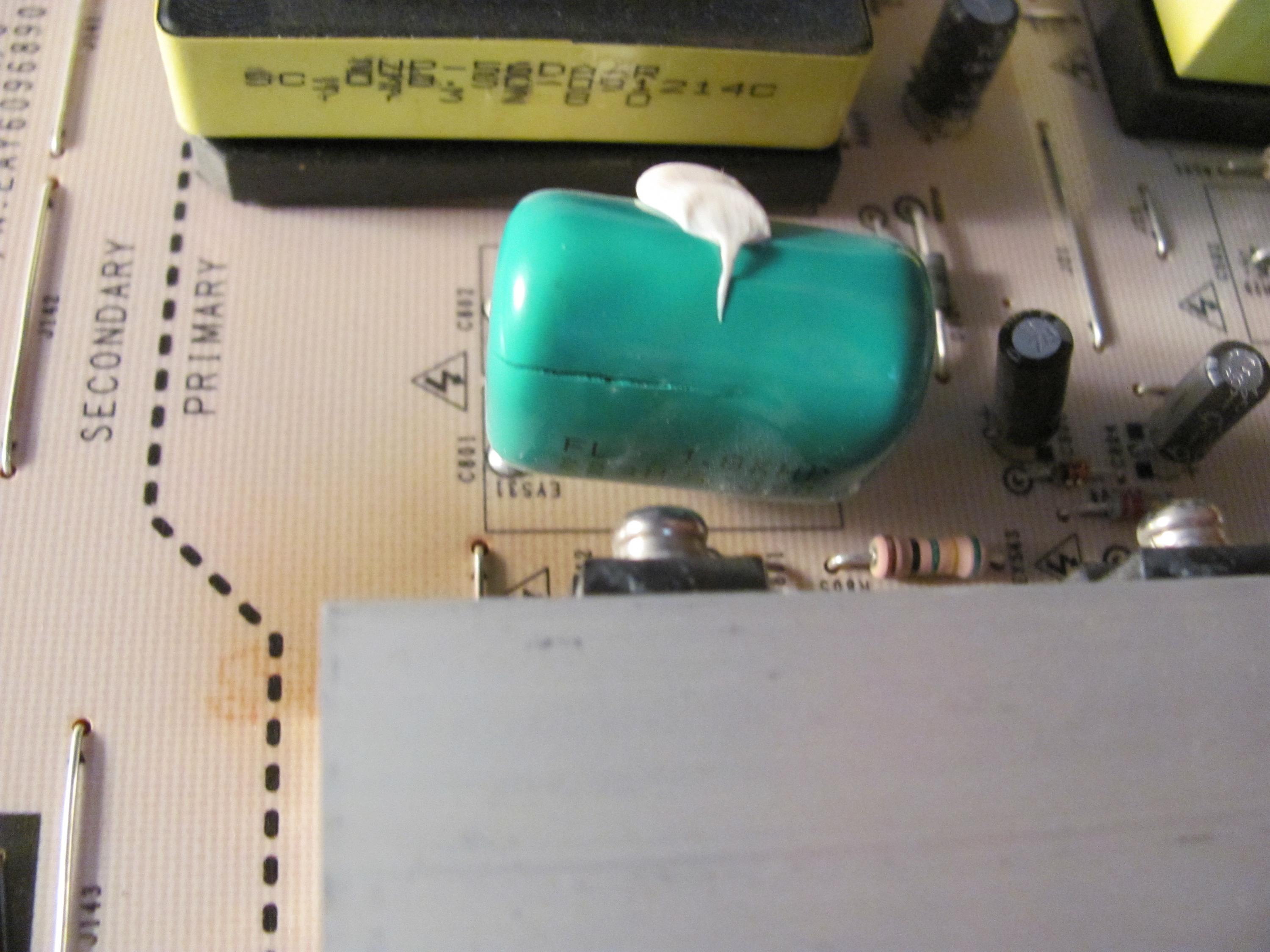

                    So now I have 3 questions:
                    1) Is it legitimately conceivable that a voltage regulator could emit a ticking noise?
                    2) If I order a replacement should I also go ahead and replace the neighbouring VR that is the same type, just for prudence's sake?
                    3) What is the turquoise colored component to the right of the VR and heat sink? I fear I may have damaged it during my over zealous heating of the voltage regulator. There is a little tear in the casing that I didn't notice before that looks like I could have melted it. It was pretty hot to the touch.

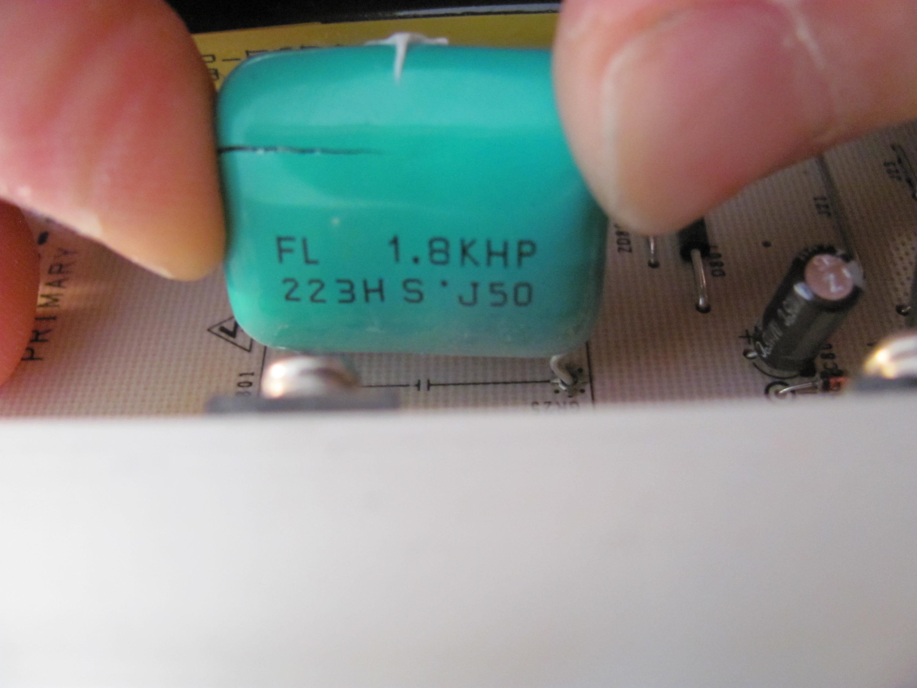

                      That cyan color component is a mylar non polarizrd capacitor. Can you take a close up pic of the voltage regulator? These LG power supplies are hard on these regulators. I have one here now with a shorted regulator. Different model same scenario.

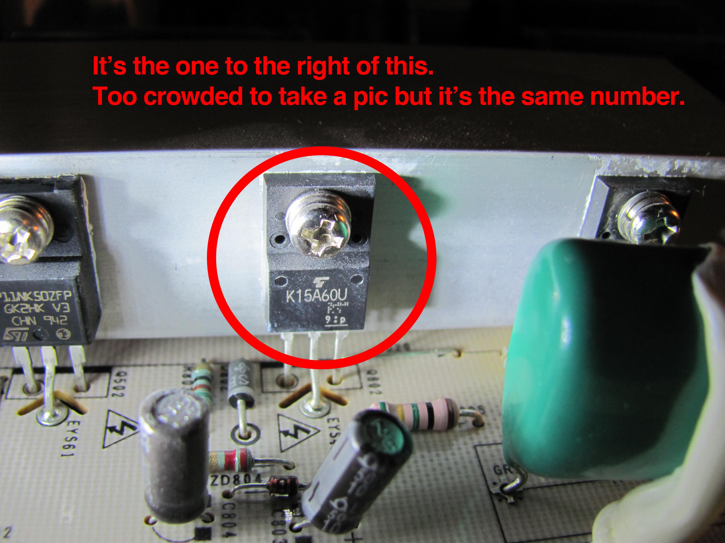

                        Attached are 2 pics. One is of the regulator. One is of the adjacent capacitor I may have cooked.
                        The regulator appears to be a Toshiba K15A60U. Mouser doesn't carry them but DigiKey does:
                        http://www.digikey.com/product-detai...eda_dkc_buynow.
                        Should I replace that capacitor just in case?

                          that capacitor looks to have a crack in the casing yes i would replace it and while you are it i would change the small 2 in front of the voltage regulator just in case as your doing a order anyway imo.

                            Agreed, replace all capcitors in that section to start, That mosfet is not a voltage regulator like I thought, instead it delivers the VS voltake to the sustain boards. I would more focus on the capacitors in the area to start.

                                  I REALLY hope someone can help identify that mylar capacitor. Somebody has to know what those marks mean!!!

                                      I'm stumped on that capacitor. I'm researching though.

                                        It may be a .022 if 1800v though don't quote me yet.
