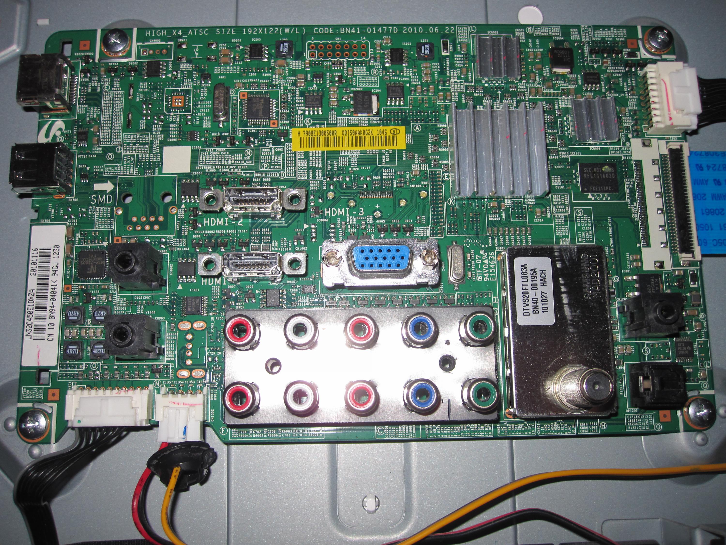

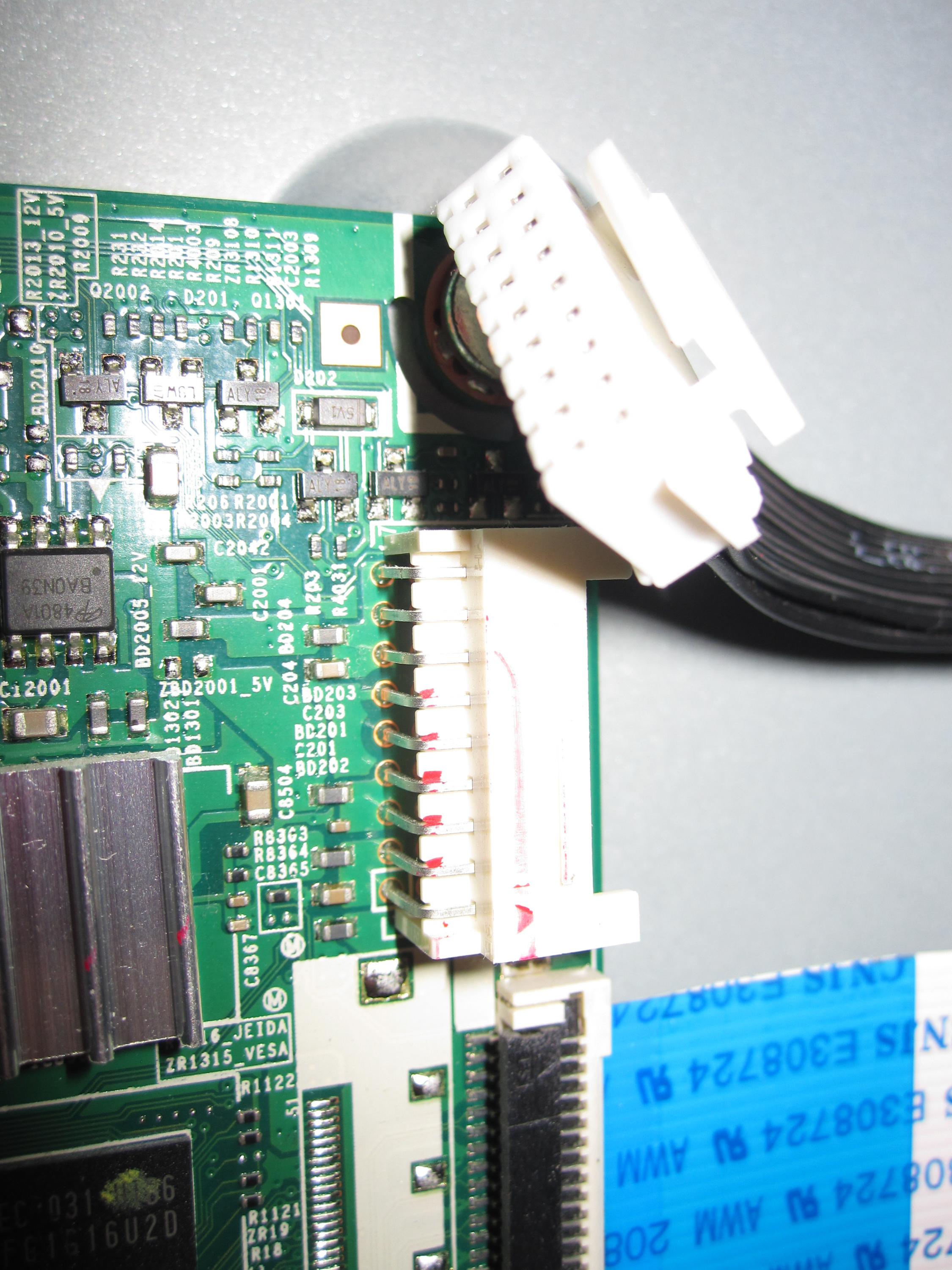

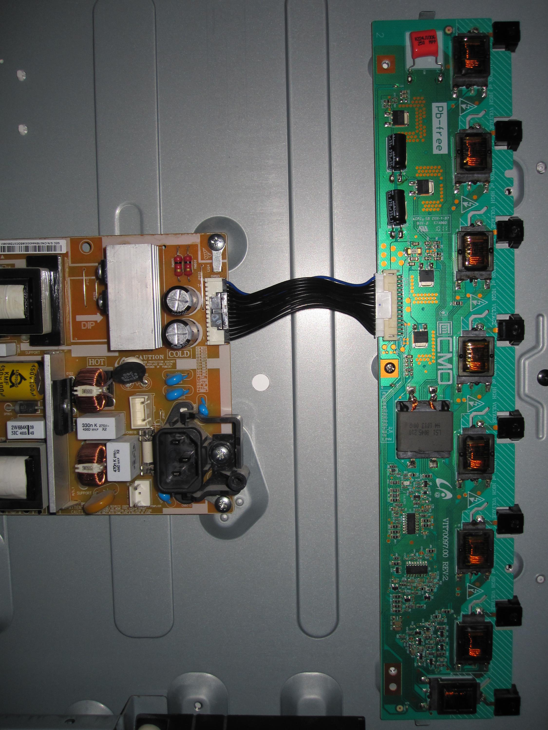

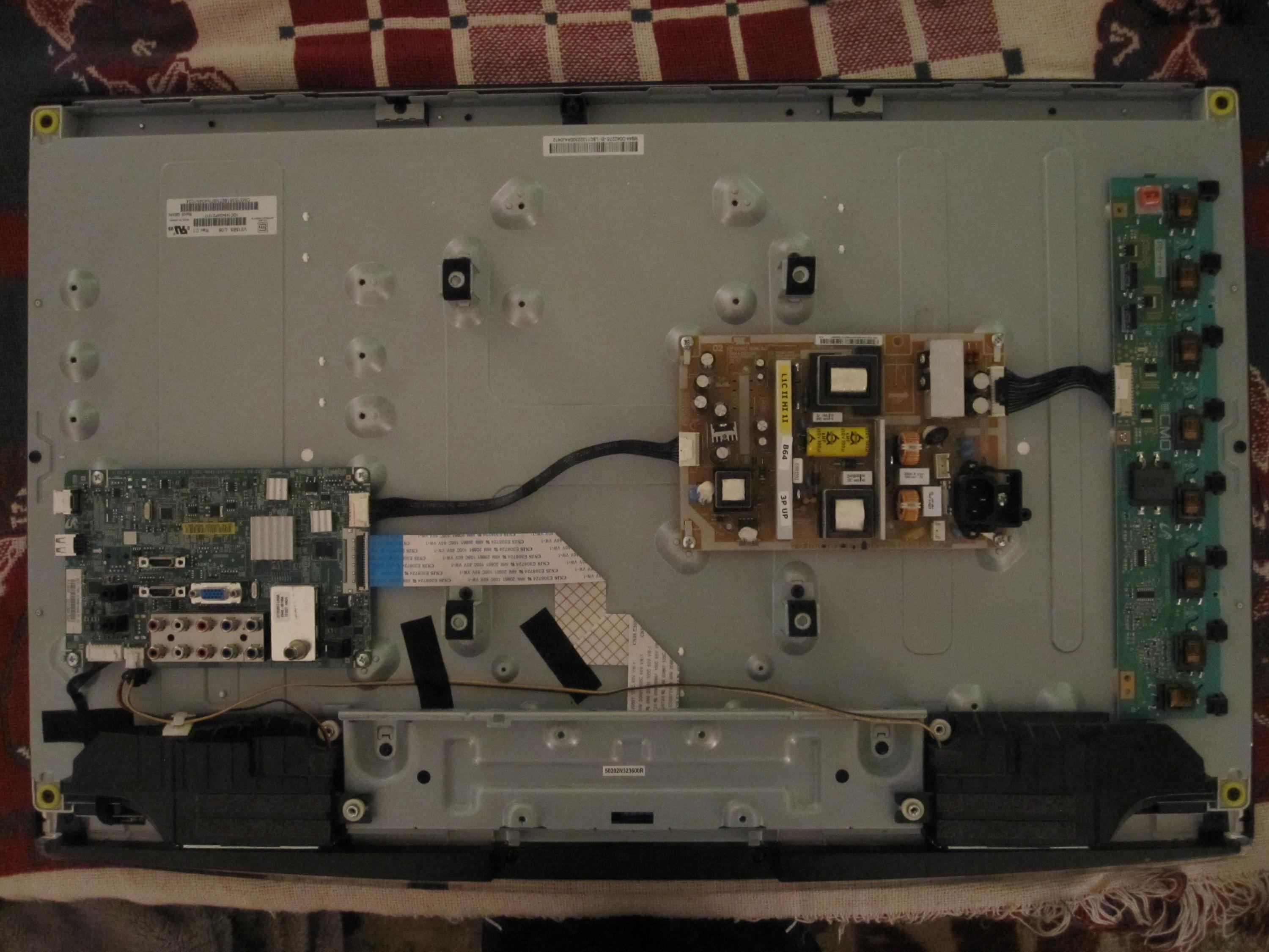

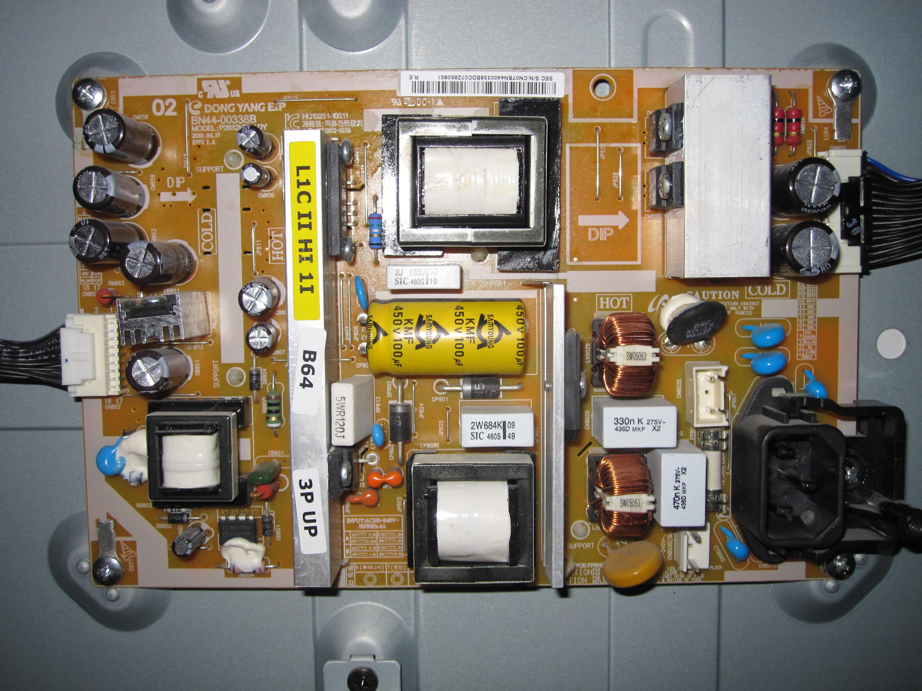

    Here's my issue:
    The TV turns the front red light on when plugged into AC. When the power is turned on, the TV does it's audio intro, but the backlight is not being powered on. I did the flashlight test and could easily see that the panel was displaying the source.
    At this point I had done enough research to hear the #1 reason for this failure to be the inverter board. OK let's order that, but wait I of course screw around some more and found something interesting. When I unplug the main board, the backlight turns on, but the source does not display. The panel not displaying the source makes sense, but why would the backlight turn on when the main board is unplugged? Maybe it still is the inverter board, but I just wanted to make sure before ordering it.
    I have visually checked the components and have found none to be showing obvious signs of failure. I did check the PSU to Inverter cable and found pins 10-14 to read ~26V. I did not get a reading for pin 3 (BLU_ON), but I may have read it incorrectly.
    Pictures are posted below of most of the components. If you find that another picture is necessary, let me know and I'll upload it. I'll troubleshoot components ASAP when asked (I do work during the day).
    Thanks for your help in advance.

    Re: Samsung LN32C450 - Audio but no video
    There is a pull-up resistor on the power board that turns on the backlights when the main is disconnected. Your main board is most likley where your problem lies.
      Cool. That would explain the backlights being turned on when the main is D/Ced.
      Do you know a method to test your hypothesis that it's the main board that failed?
        I guarantee its the main board... disconnecting it and getting the back lights shows this. The main isn't sending the signal for BL_ON.
        We can check with a DMM if you want further proof?

            Start a new thread... Post good quality pics of each board and one of entire back of set (so we can see all boards)

                    If it's not too intense I would like to diagnose this with my DMM, not because I don't believe you, but more as a hobbyist looking to learn more about these TVs. Let me know what I need to probe.

                      So, help us understand: no backlight, but you can still see image, but you DO have backlight when cable disconnected? You might be able to jumper the BL ON/OFF permanently to ON. This might cause the screen to flicker when the set turns on/off or changes sources, but it's not a big deal if you can live with that.
                        That's right tom66.
                        I don't mind a flicker. How would I go about jumpering the BL ON/OFF?

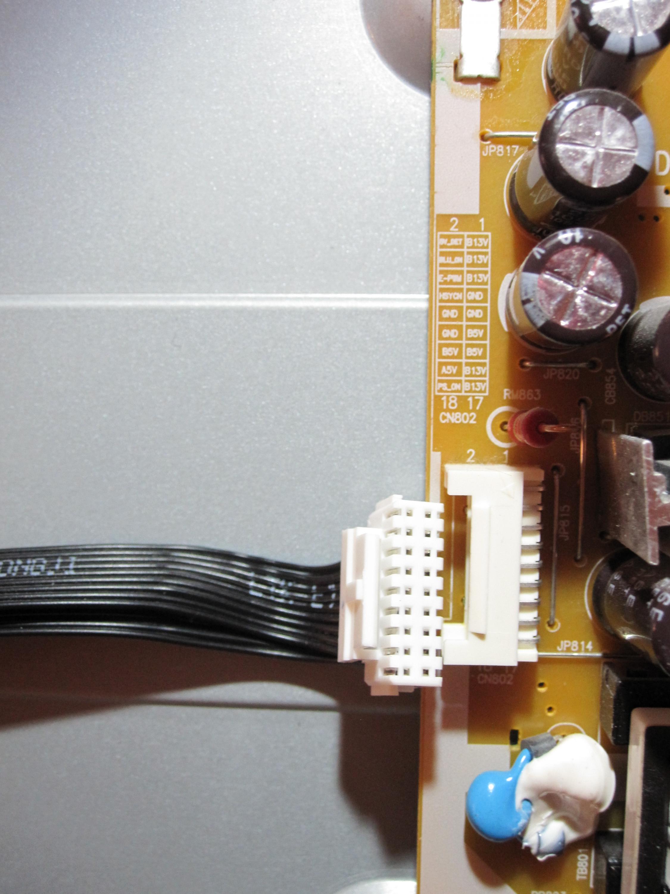

                          OK, post a clear picture of the label next to the connector between main and power board (on power board side) and of the connector assembly on each end. Simply disconnecting the wire for BL ON will cause the power board to pull the signal HIGH every time the TV is powered up so the backlight should come on.
                          • Aulus
                            • Dec 2013
                            • 27

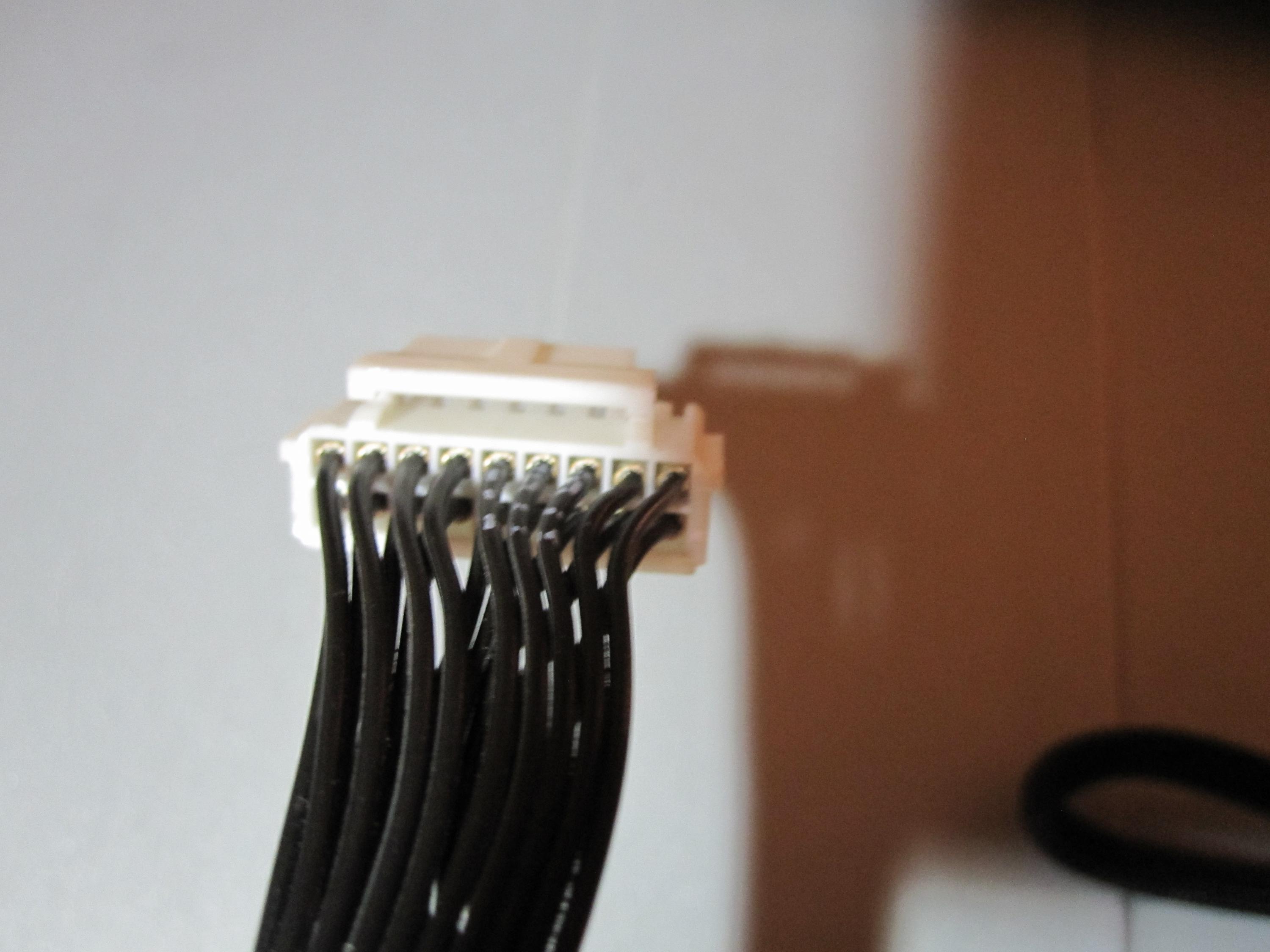

                            Ok here are the pictures, this is fun. Let me know what's next.
                            Can you help me with an amateur question? Does the pin diagram correspond to how the wires go into the circuit on the board? If this is the case wouldn't the power board side picture with the D/C cable mean that as I look at the connector that the 2nd pin down from the top right would be the BLU_ON pin #4? I'm having a hard time trying to describe from the picture where it's at.
                              I think it's the 4th wire, basically the wires are numbered in zig-zag fashion
                              2 1
                              4 3
                              6 5
                              8 7
                              18 17
                              Make sure to cut the wire such that it can be reconnected should the wrong wire be accidentally cut.
                                Yes that is correct.
                                  2 1
                                  4 3
                                  6 5
                                  8 7
                                  18 17
                                  Something odd happened and it wasn't that it works, hah.
                                  So now when I turn off the TV the backlight flickers once. This does not happen when powering on the TV. Also, when I plug/unplug the main board cable it flickers once. I am no longer getting the constant backlight upon main board cable D/C.
                                  Let me know where to go from here

                                    So no connection at all from PSU to main and now no backlights?
                                      Hmm, OK, connect the wire as usual, back to no backlight? Perhaps you had original symptom before, but it was intermittent? Check all bulb connectors, etc.
                                        Well that was correct, but now all of a sudden after unplugging the AC for a while it went back to turning on the backlight when the PSU-Main cable is D/C.
                                        The symptom that I've seen change is that upon turning off the TV it now flickers the backlight once, then stays dark.
