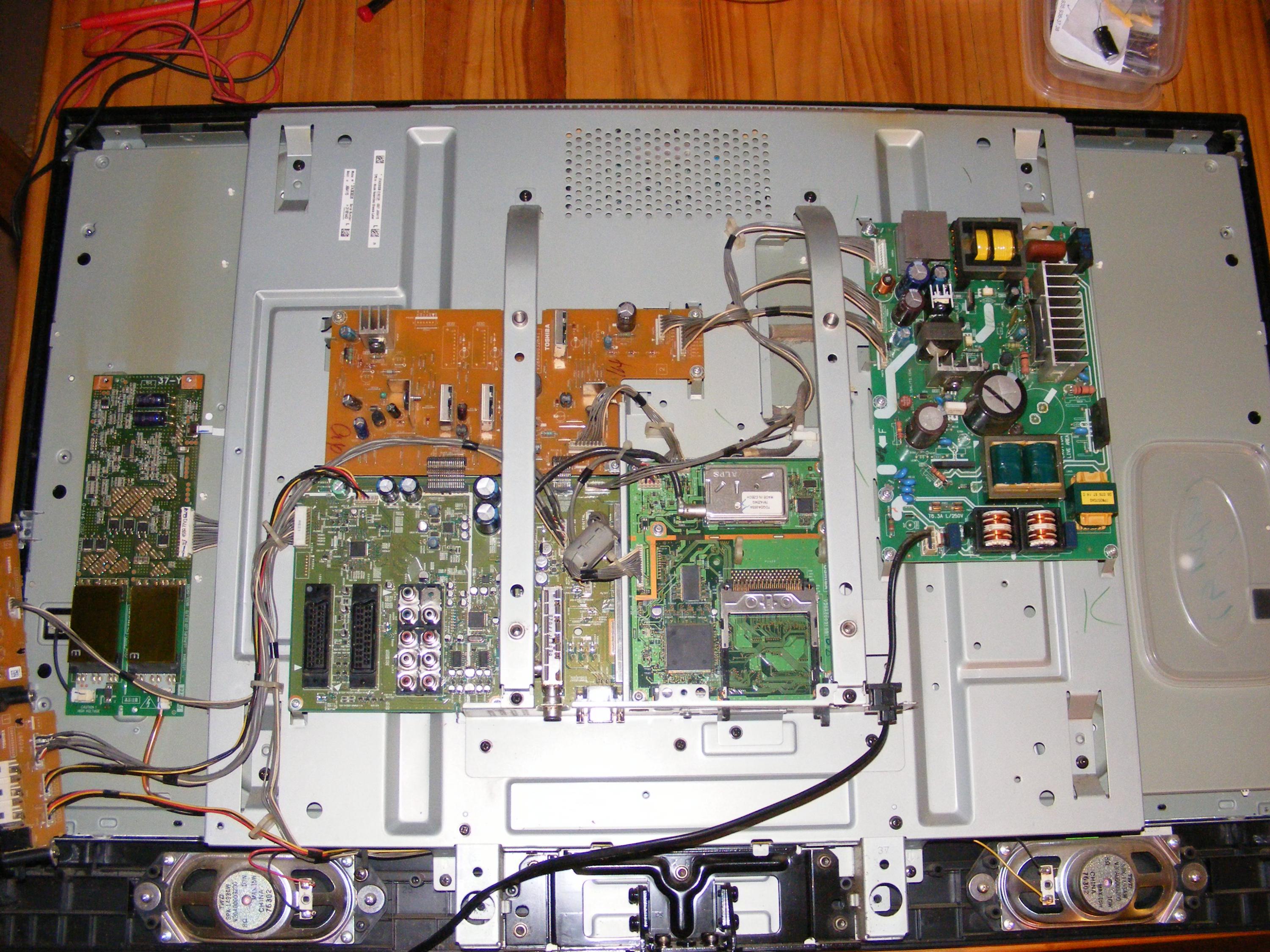

    Hi there,
    This old Toshiba clicks on from standby. Backlight does not light up, then about 10 seconds later the PSU relay clicks again and it shuts down.

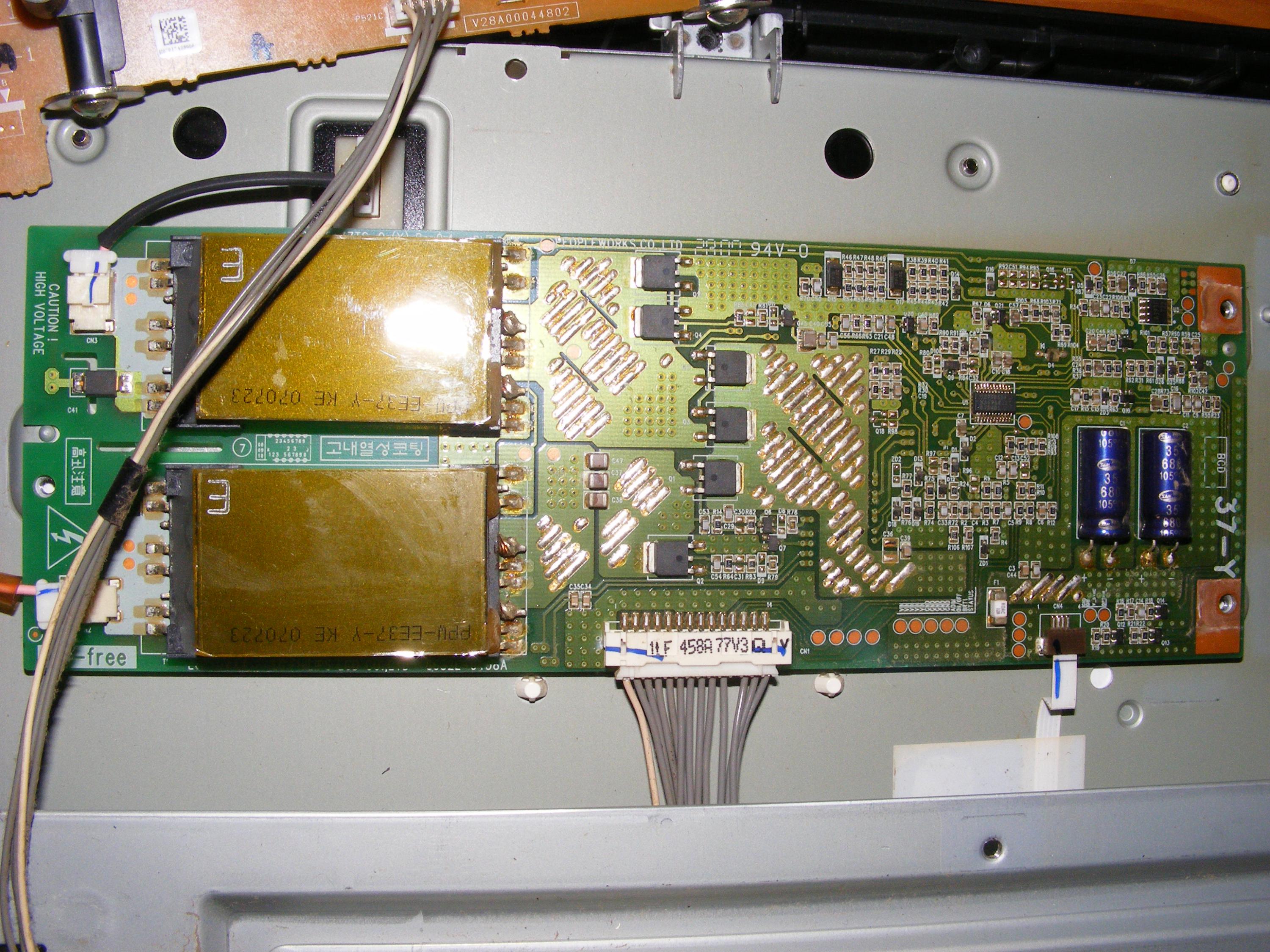

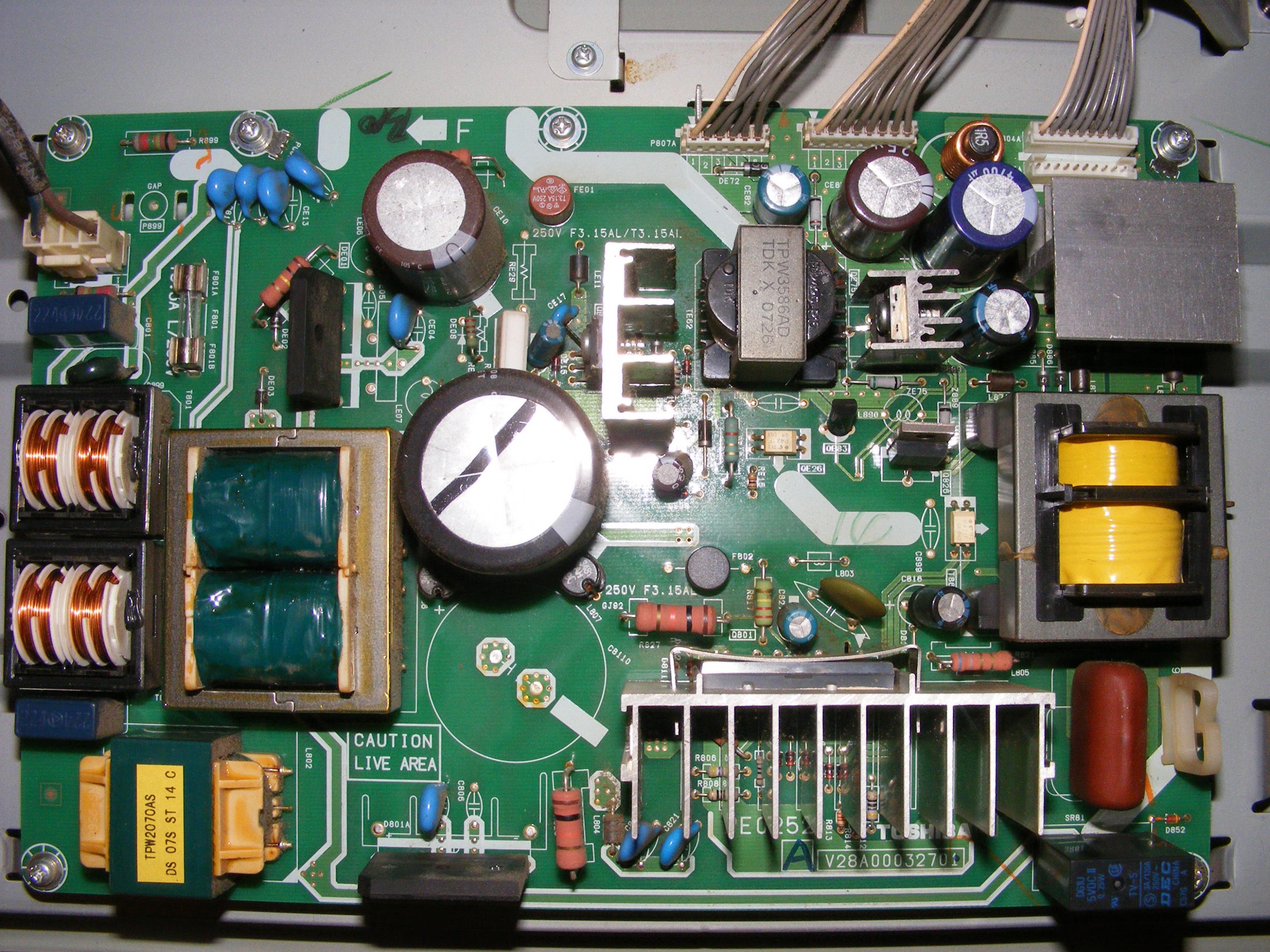

    There's 24V at the inverter board when it's on, and other voltages seem correct. How do I narrow down whether it's backlights, inverter, main-board or PSU causing it to click off again?

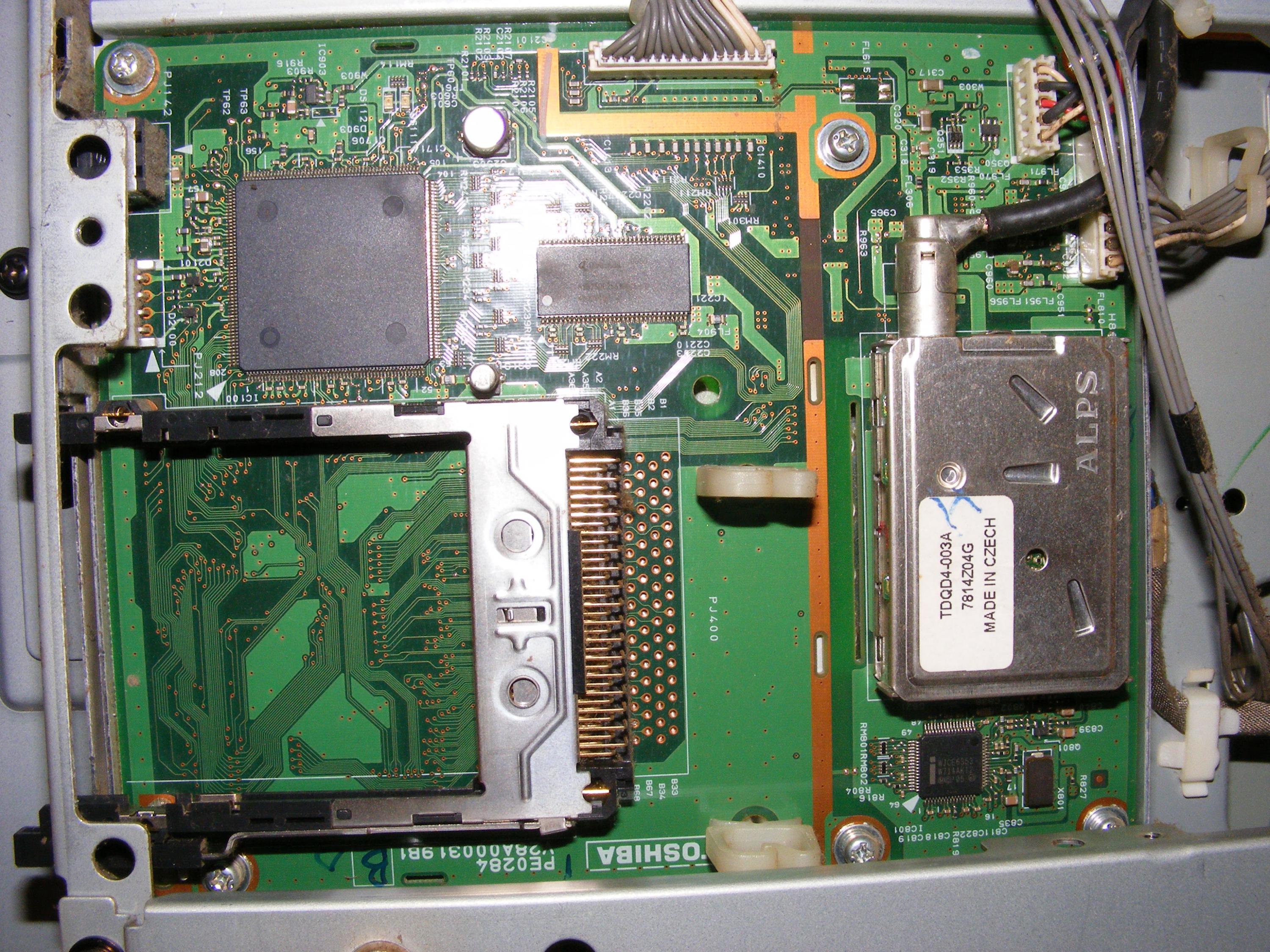

          With the digital receiver board disconnected I found that power stayed on, and managed to fire up the backlight with a resistor between 5V and on/off on the inverter. Glad I did because with the lights on I can see now that the LCD panel is cracked. Guess I'll be selling some parts again - the PSU and inverter at least. No way to tell if the rest works.
